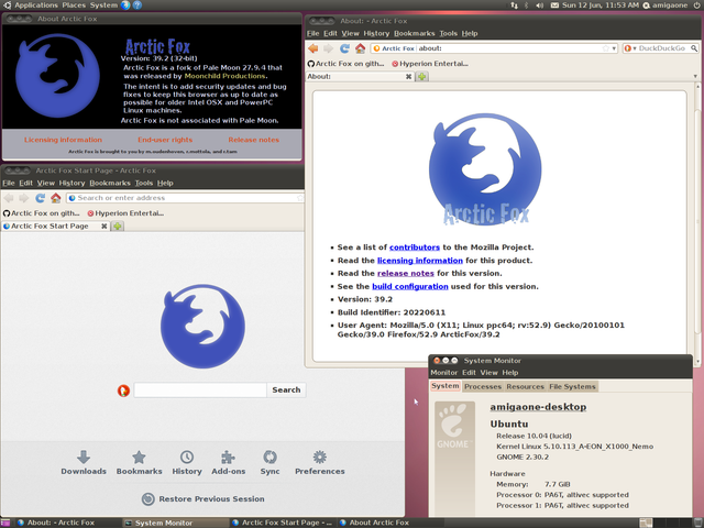

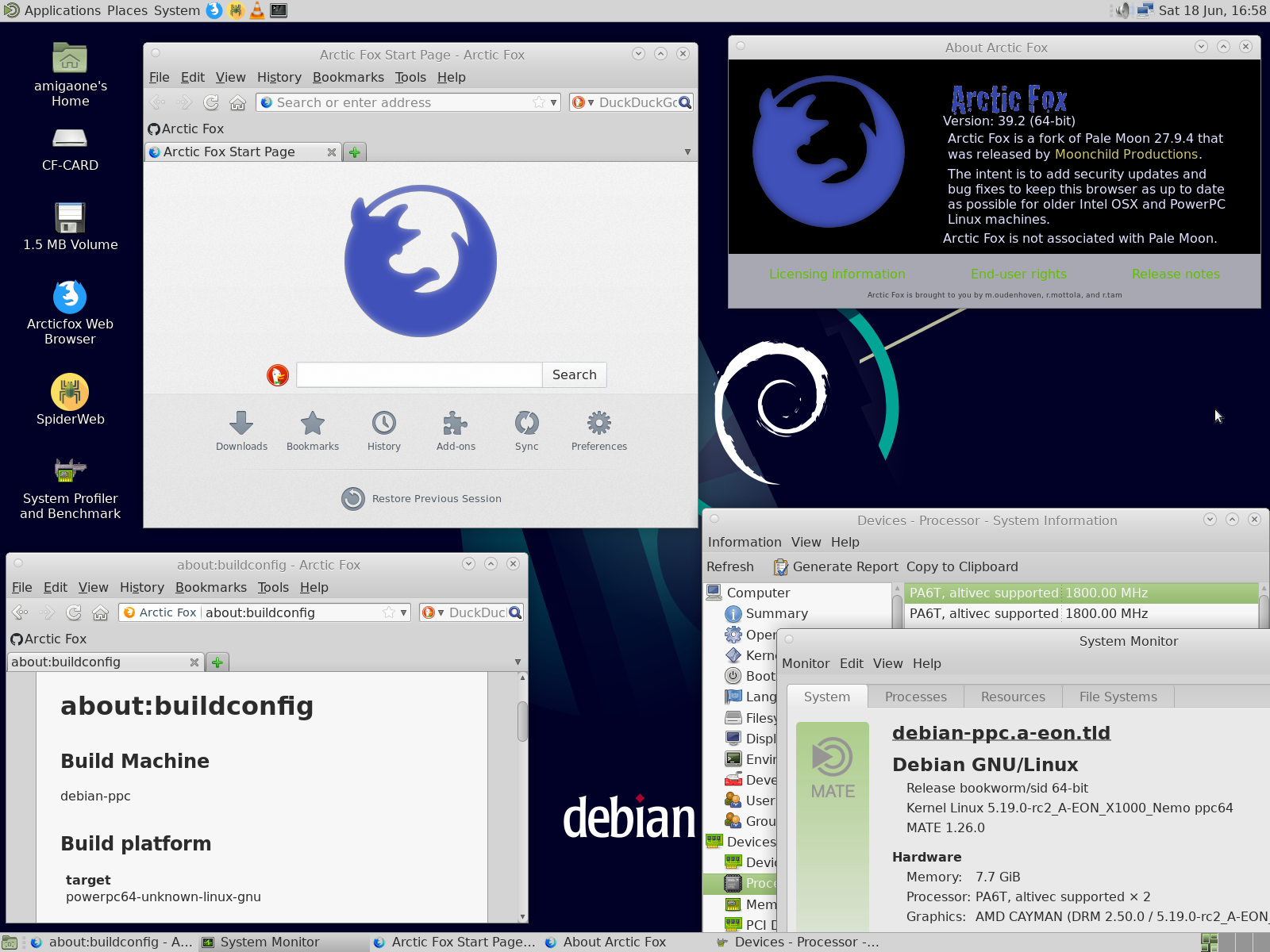

Compiling Arctic Fox 39.2 for PowerPC64 on Debian/Sid PPC64
Note: Arctic Fox needs gcc-6 to build. You can find it in the powerprogress repository.
  1. Code:
    su -
  2. Add the gpg key related to the powerprogress repository
    Code:
    # wget -O - https://repo.powerprogress.org/debian/conf/public.gpg.key| apt-key add
  3. Edit the list of repositories checked by apt by adding it to the /etc/apt/sources.list
    Code:
    deb [arch=ppc64] https://repo.powerprogress.org/debian sid main
  4. Update the apt database
    Code:
    # apt-get update
  5. Install the following packages with the following command:
    Code:
    # apt-get install build-essential libgtk2.0-dev libdbus-glib-1-dev autoconf2.13 yasm libegl1-mesa-dev libasound2-dev libxt-dev zlib1g-dev libssl-dev libsqlite3-dev libbz2-dev libpulse-dev zip python2.7 python-dbus-dev gcc-6 g++-6
  6. Code:
    # exit
  7. Code:
    $ cp .mozconfig Arctic-Fox-39.2/
    .mozconfig for PPC64:
    Code:
    # This Source Code Form is subject to the terms of the Mozilla Public
    # License, v. 2.0. If a copy of the MPL was not distributed with this
    # file, You can obtain one at http://mozilla.org/MPL/2.0/.
    export CC="gcc-6 -flax-vector-conversions -O3 -falign-loops=16 -falign-functions=16 -falign-labels=16 -falign-jumps=16"
    export CXX="g++-6 -flax-vector-conversions -fpermissive -O3 -falign-loops=16 -falign-functions=16 -falign-labels=16 -falign-jumps=16"
    export LDFLAGS="-latomic"
    mk_add_options MOZ_OBJDIR=@TOPSRCDIR@/obj-ff-dbg
    ac_add_options --disable-crashreporter
    ac_add_options --disable-tests
    ac_add_options --disable-debug
    ac_add_options --disable-updater
    ac_add_options --enable-mozril-geoloc
    ac_add_options --disable-webrtc
    ac_add_options --disable-safe-browsing
    ac_add_options --disable-parental-controls
    ac_add_options --enable-release
    ac_add_options --disable-necko-wifi
    ac_add_options --disable-eme
    ac_add_options --disable-gamepad
    ac_add_options --enable-dbus
    ac_add_options --disable-gio
    ac_add_options --disable-pulseaudio
    ac_add_options --enable-strip
    ac_add_options --enable-install-strip
    ac_add_options --enable-application=browser
    ac_add_options --with-branding=browser/branding/arcticfox
    ac_add_options --enable-optimize="-O2 -fno-schedule-insns2 -fno-lifetime-dse -fno-delete-null-pointer-checks"
    ac_add_options --disable-jemalloc
  8. Code:
    $ cd Arctic-Fox-39.2
  9. Code:
    $ ./mach build
  10. Code:
    $ ./mach run
  11. Code:
    $ ./mach package
    (Creates the self contained archive which you'll find in Arctic-Fox-39.2/obj-ff-dbg/dist)
Download: arcticfox-39.2.linux-powerpc64.tar.bz2

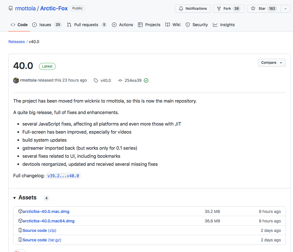

40.0 is released. Mac builds now available. The repository has changed hands finally. Get it here:
Cheers

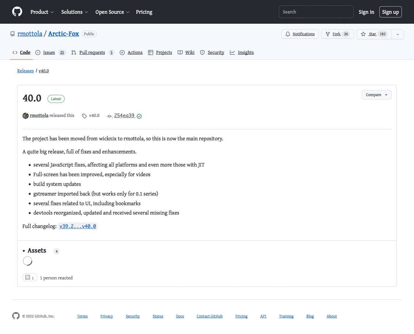

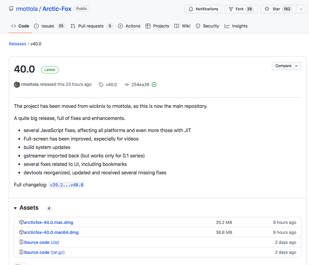

Sounds interesting, but pray tell me, after spending 10 mns looking for it, where's the download link (Mac) in that github jungle (maybe just me getting older...?)
Thanks, now that you say so I remember that's how things used to look like - except that now (in AF 27.11, but also in SpiderWeb, both 10.6.8) I'm only getting that churning wheel under Assets. I also remember that Github was giving some hassles, but in this case... that I should go and ask understanding soul to download it for me? Hmm...
Release 40.0 · rmottola:Arctic-Fox · GitHub.jpg
Maybe a Linux VM with a current browser is worth setting up for these cases. :)
You are perfectly right. I have one such in daily use to access the increasing numbers of sites related to money matters and other instruments of social control which make use, at least in my part of the world, of fancy “Two-Way Authentication” methods that just don't work in Snow Leopard (in the old days it was Wz stuff that didn't work in the Mac, so we had to use VirtualPC). Then, I have another Linux VM that I keep as a template of sorts, with Firefox installed and kept updated, for heavy downloads from sites that are likewise allergic to SnL. Trouble is, when you use a VM like this, it swells and swells and swells endlessly. There is a way of cleaning a VM's empty space using the Mac's Terminal, but usually I prefer to make a copy of the template and overwrite the one I've used when I'm done.
That's if I really need it, which is rarely. Now, in our case, a small download, I think it's a bit preposterous (and I would never have guessed) that AF for 10.6.8 should be hosted on a site that is not functional in a 10.6.8 browser.
Anyway, my daughter got it for me from her Catalina. Let's now hope that contrary to the versions that came after 27.11 we'll be able to get it going.
Reactions: Amethyst1
That's a very good point, and I absolutely didn't mean my response to come across as one of these "Just do this instead" comments that can be interpreted as being more... condescending than actually helpful. :)

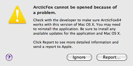

Just downloaded the hard-to-find version 40 (for 64-bit only), but Snow Leopard tells me:
"ArcticFox cannot be opened because of a problem.
Check with the developer to make sure ArcticFox works with this version of Mac OS X. You may need to reinstall the application. Be sure to install any available updates for the application and Mac OS X.
Click report to see more detailed information and send a report to Apple."
I would post the log report here, in case it's useful, but this forum doesn't want me to attach a text file...
