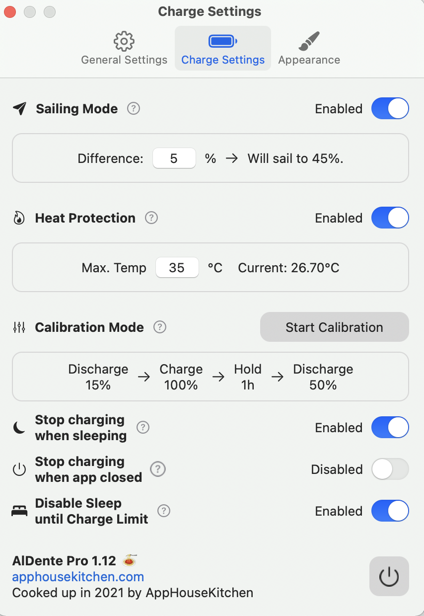

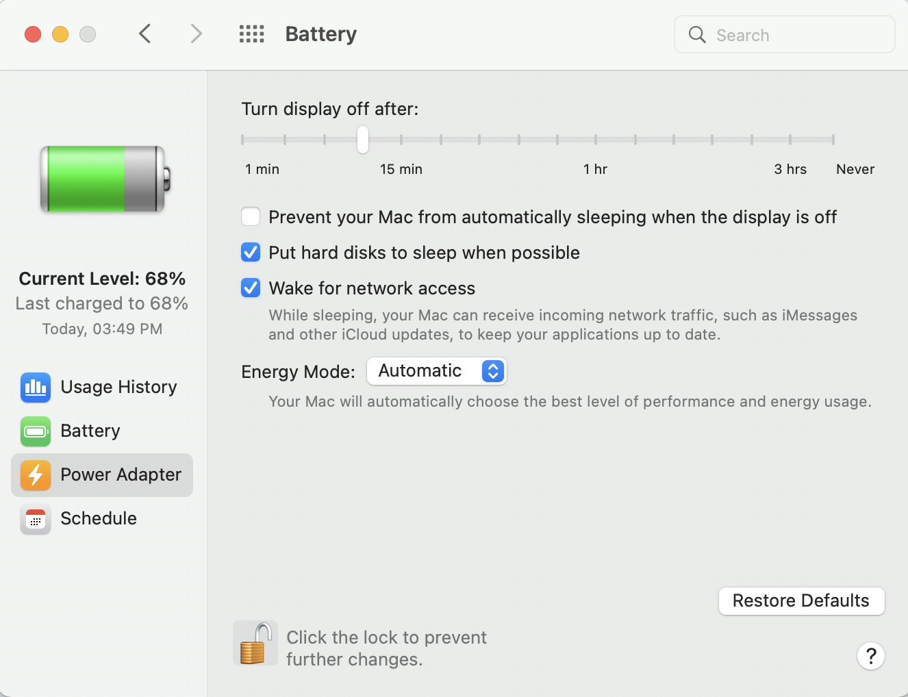

Hmmm, not so happy right now, a bit of a glitch.
I have AlDente set 50% and all was working well. I have the following AlDente configuration:
I did not power off the laptop. I did not sleep the laptop though I do have the following MacBook power settings:
I stepped away for a couple of hours and came back to find my laptop at 68% charge! WTF!
In addition, I noticed that when I went to us my laptop I noticed that AlDente was NOT in the menu bar but reappeared shortly thereafter.
In trying to figure out what the problem is I am wondering whether it is the "Present you Mac from automatically sleeping when the dimply is off" and/or th "Put hard disks to sleep when possible" that caused this to happen with the possible solutions being:
1. Leave AlDente configured as is and change the MacBook configuration by ticking "Present you Mac from automatically sleeping when the dimply is off" and/ or unticking the "Put hard disk to sleep when possible"; or
2. In AlDente enable "Stop charging when app closed" and leave MacBook configuration as is.
Would appreciate help on this and, if it is the MacBook configuration that needs to be changed, please be specific (as I do not want it o continuously charge beyond the 50% that I have set) \.
Thanks.
PS. Now discharging my way back to 50%! Yikes!
Thanks.
It seems to me that it's a bug since theoretically it shouldn't do that considering the settings. It should keep the device awake till it's 50% and be able to sleep. But before sleep it should pause the charging so it shouldn't be charging.
This is probably a bug that needs to be reported.

@white7561 , yup there is a definite glitch, it seems as though AlDente is shutting down when the laptop sleeps.
I am going to a) discharge the battery down to 50% and b) turn on enable "Present you Mac from automatically sleeping when the dimply is off".
I must admit that I am disappointed that the software does not work.
I mean it does work. But yeah some of the features still have bugs it seems. Overall I would still choose this than Apple's own Optimized Battery Charging :p

I know have another problem, I ticked the "Prevent your Mac from automatically sleeping when the dimply is off" but know the screen saver never engages and the display need turns off, WTF!
I am becoming less and less impressed with this software!
What? That option only stops the sleeping process when the display is off (apples option. Not AlDente's)
Are you currently charging to 50% when it doesn't want to turn off the display? If yes then it's prob your aldente option to keep awake till it reaches 50% . Since it's a wake lock.
It's not the software's fault, AFAIK if you want to prevent sleep temporarily. It will stop the display from going entirely from on to off. It's just how Mac OS handle those things AFAIK.
If you just want to prevent sleep but simultaneously allowing the display to turn off. Then just use the prevent sleep while charging on System Preferences. Disable the disable sleep option on AlDente so it won't keep the machine on a wakelock which will let the screen on until the wakelock is off
