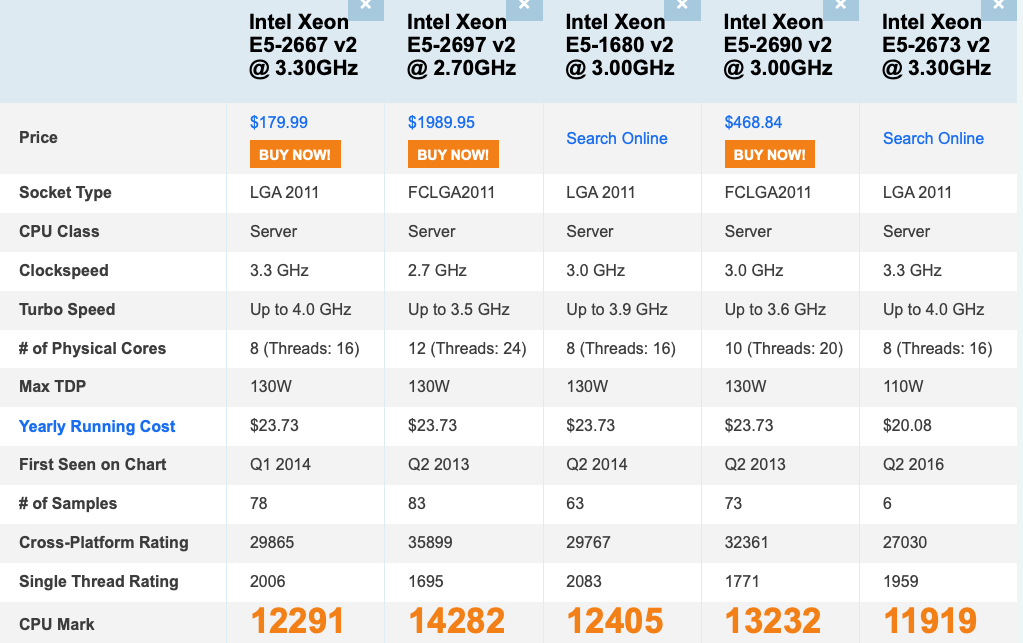

Thank you guys for this thread. I just picked up a late 2013, love the form-factor, but, not a fan of proprietary GPU cards. The CPU-well, mine comes with a base-model, so this has been great to see what can work. Not afraid to fiddle with it.
Has anyone tried the 2673 v2? It’s in the compatibility list for the 6,1 and has the lowest TDP at 110w. I’ve ordered one as I found one for reasonable money. I’m keen to see if it runs at a lower temperature than the 2667 v2. I’m guessing it will.
Reactions: ikir
Both CPUs have 100% same clock speeds and different TDP (-20W) on paper I wonder how?
Nobody did a a detailed test: 2673 vs 2667 unfortunately
