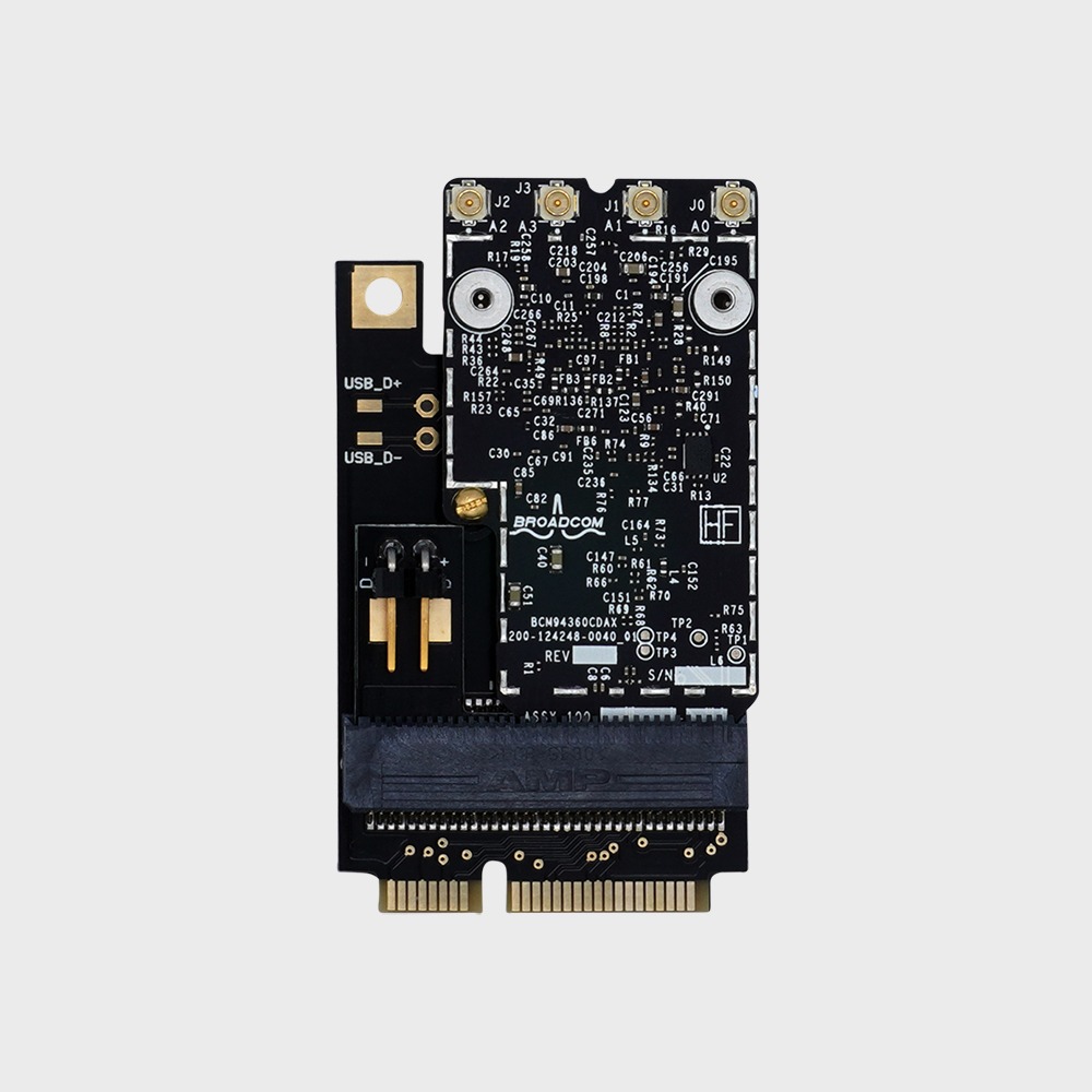

That was specifically to connect the factory BT module to a USB v2.0/v3.0 hub. not a BCM94360CD + adapter.Hi @tsialex
In your link before, where I can see the wiring for the adapter, there is only D+ and D- but you said we need to connect all 4 pins. On most adapters I have seen on ebay and my own one I can only see D+ and D- pinouts. Can you give me a hint where I can get ground and +5v from?
Eugen
OK, so do I only need to connect D+ and D- to an external USB v2.0 port in the configuration with BCM94360CD + adapter?That was specifically to connect the factory BT module to a USB v2.0/v3.0 hub. not a BCM94360CD + adapter.
If you get everything working, would you be able to post a tutorial of your steps?OK, thank you very much. I will try to connect d+ and D- to an external USB.
