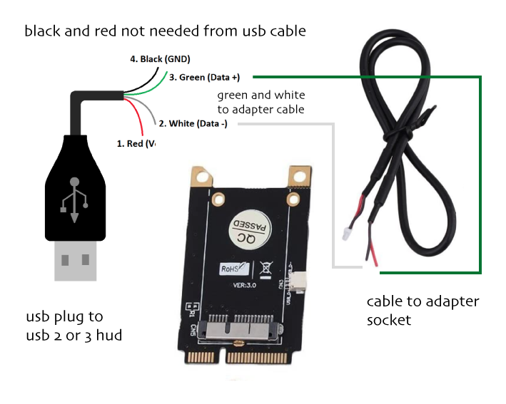

I used almost same for my BCM94360CD in mac pro 5.1, and got it working by using a usb a cable connecting the green D+ and the white D- from it to the wire that goes to the red and black that goes the mini PCI-e adapter. the usb cable is plugged in a usb 3 pci-e at the moment because I only use my mouse for now. On the adapter you can see which wire color is + or -

It would be very helpful if you can attach picture of wires so I can visually follow them?

See image attached I hope it will help.
I can't show images from the mac because all is build in already :), you have to route the usb cable out of the mac to connect it to the usb-hud.

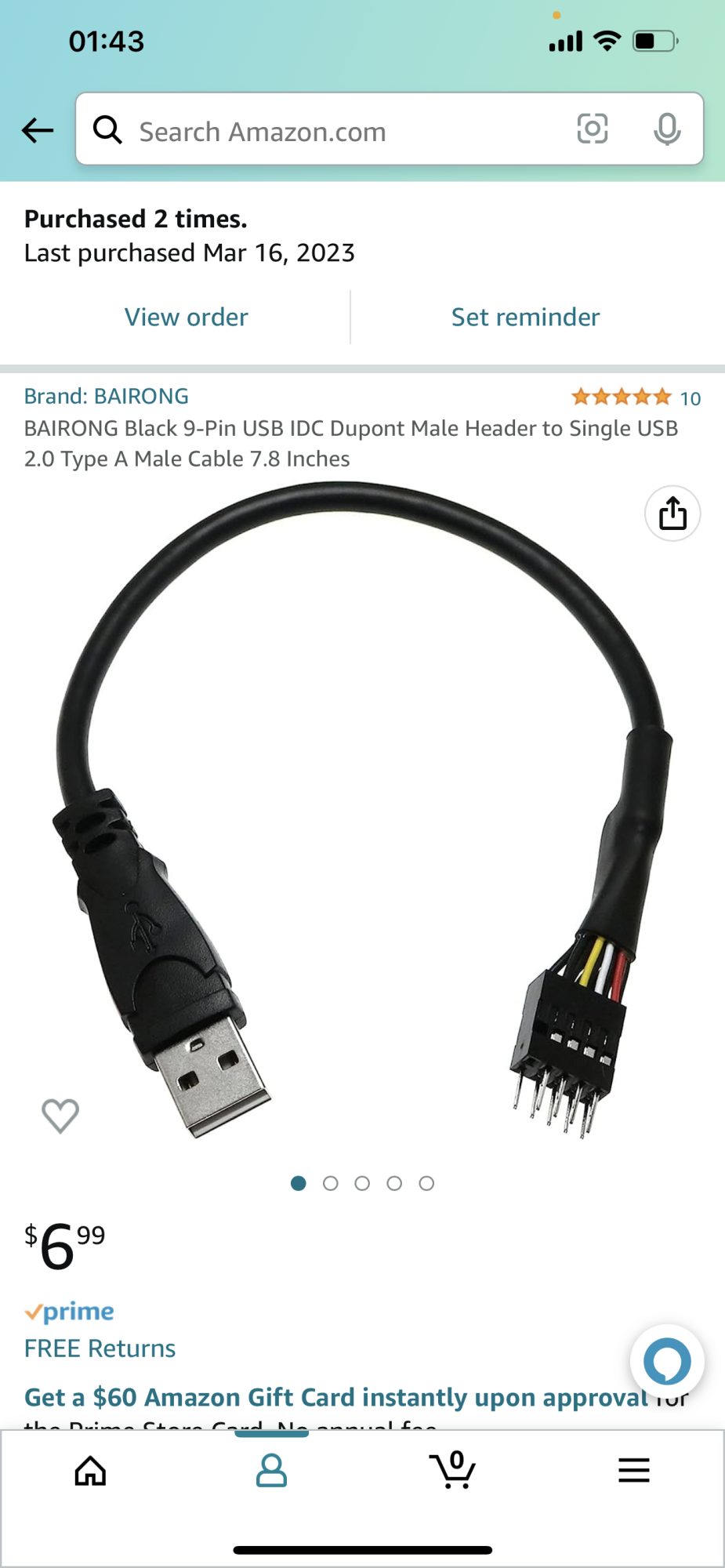

Install a FENVI FV-T919 PCI-E Wireless Adapter. Use the included cable with the FV-T919 plus an adapter cable from standard PC Motherboard USB header pins to USB A to connect to a USB 2.0 or USB 3.0 port for Bluetooth. I ran the adapter cable out of a blank card slot and plugged it into an external USB port. Others have successfully run it to an internal USB A port on a PCI-E USB 2.0 or 3.0 card.

I hope these images are self explanatory but you will need to order 2 sets of the external antennas as the FENVI FV-T919 card has 4 antennas ports on it.

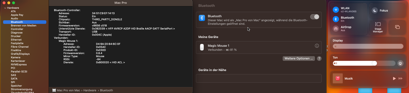

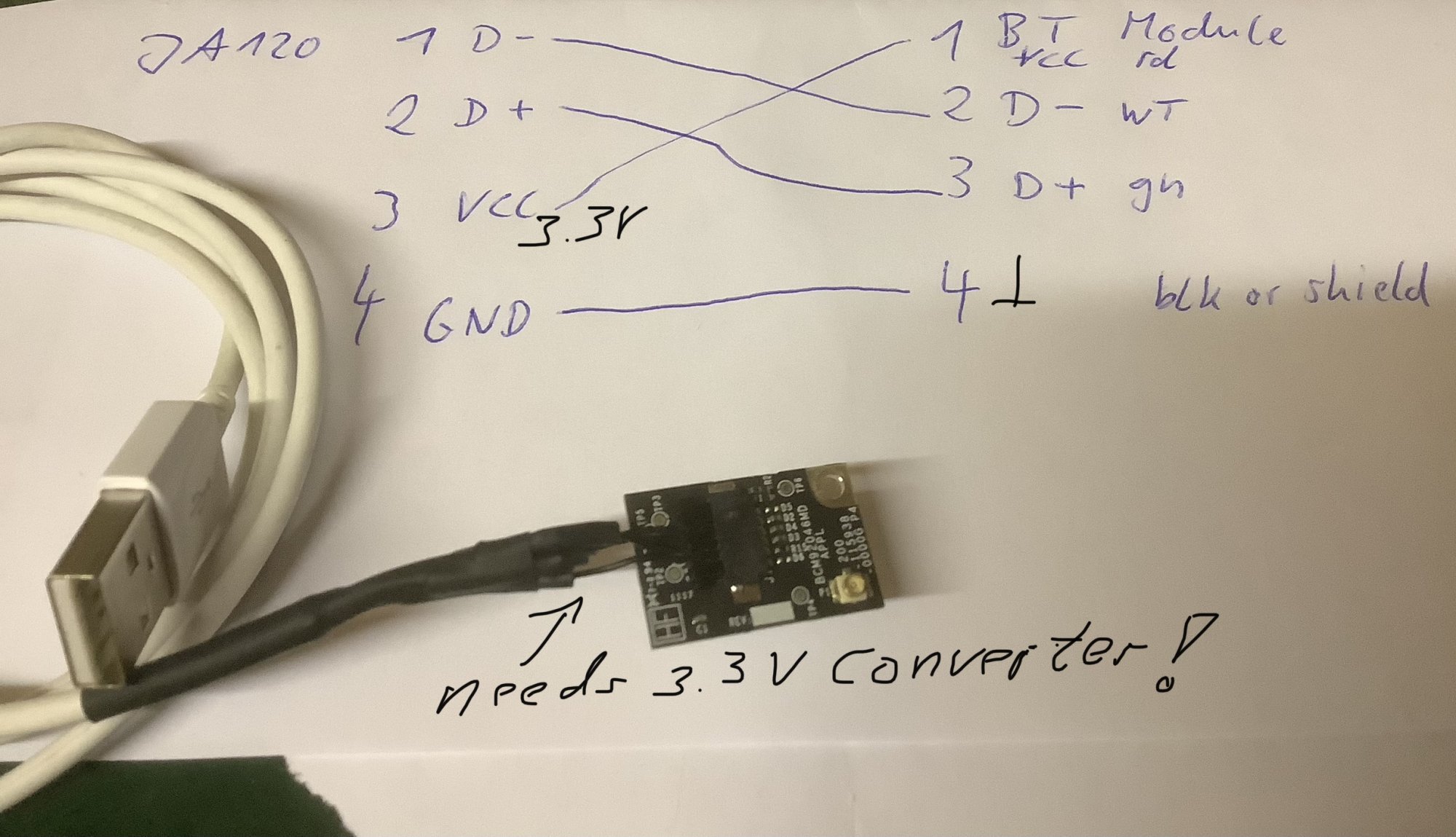

A workaound for the internal Bluetooth board is hooking it to a USB hub by attaching an USB cable.
EDIT: and, as @cdf mentioned, a voltage converter down to 3,3 Volts.
I tried it with 5 volts as I assumed as an USB device it gets 5. It worked but I guess it will not stand the higher voltage in the long run.
Notice that the original cable is not straight.
I just cut one cable I had from a dead backplane and soldered it to an USB cable.
I am on the road, provide a better picture, soon.
Connecting the original Bluetooth module like this is ill-advised because the standard USB connection provides 5V while the module is designed for 3.3V (VCC in your diagram) as provided by the internal header.
Reactions: Macschrauber
oops, ok :oops:
but anyway, it was not damaged nor getting hot.
