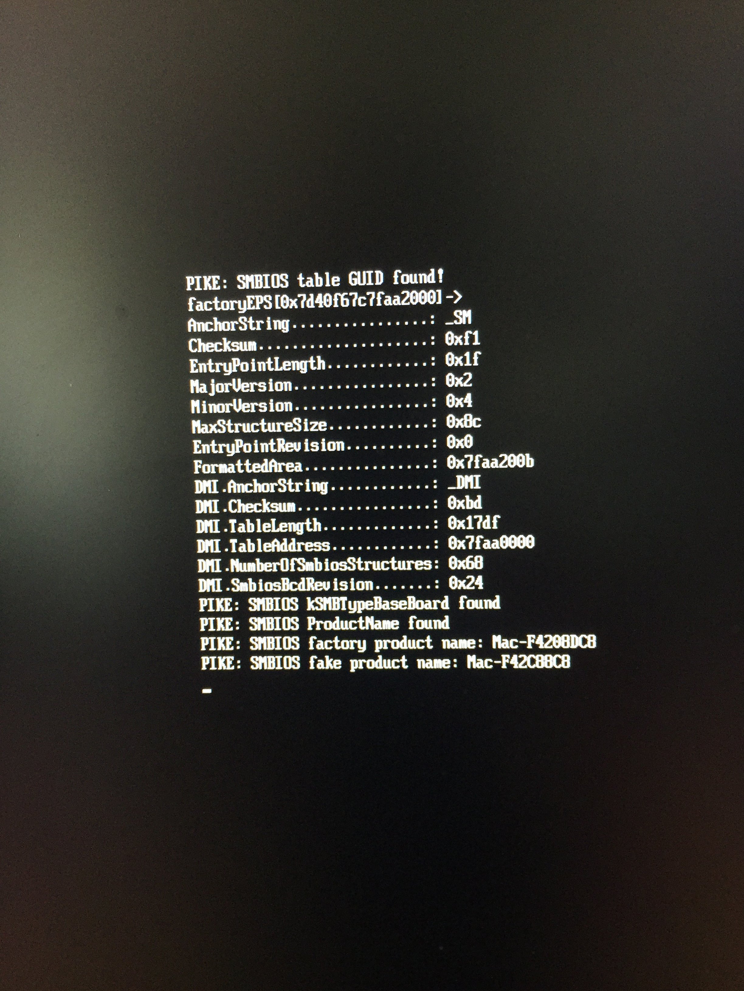

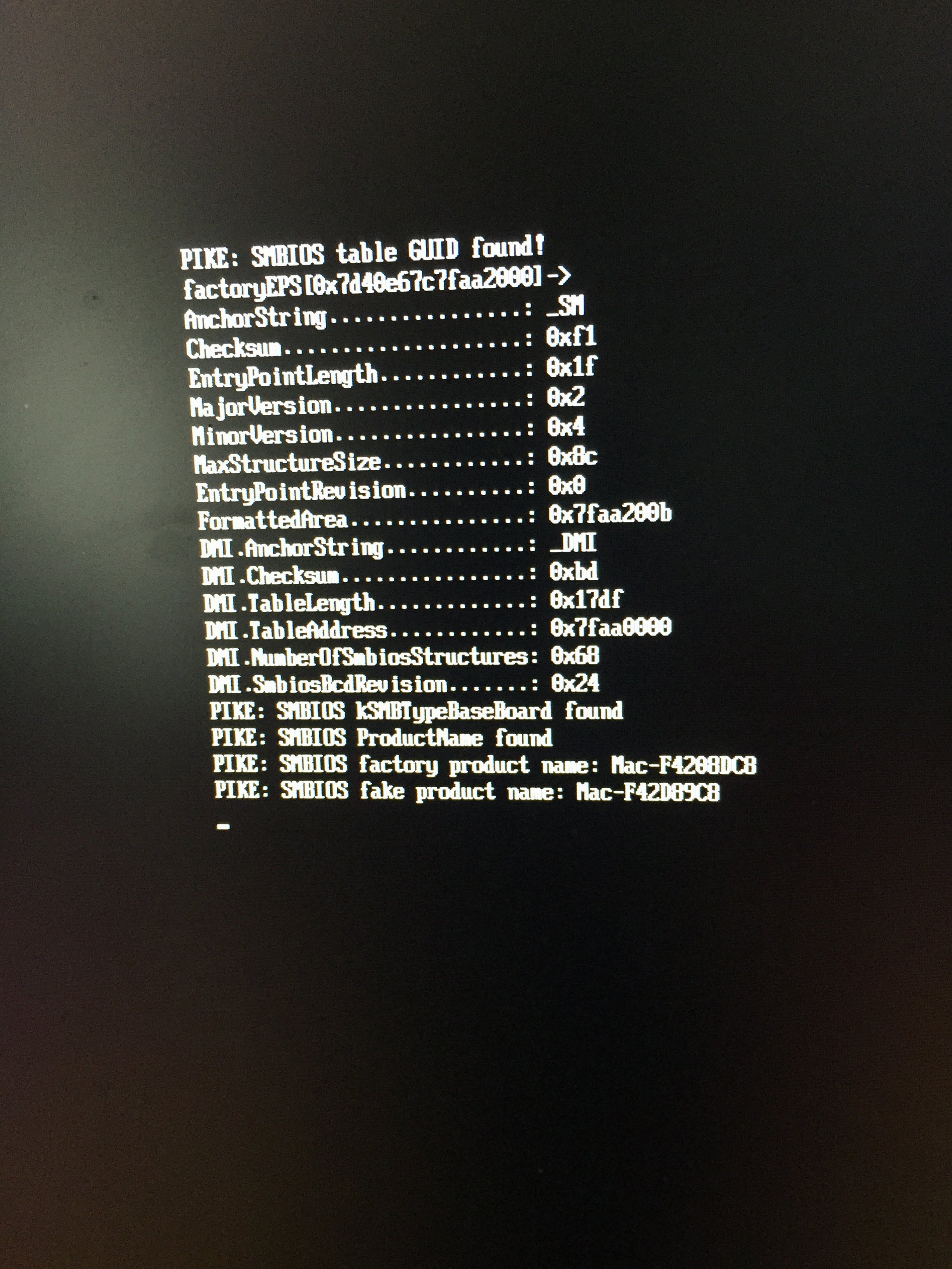

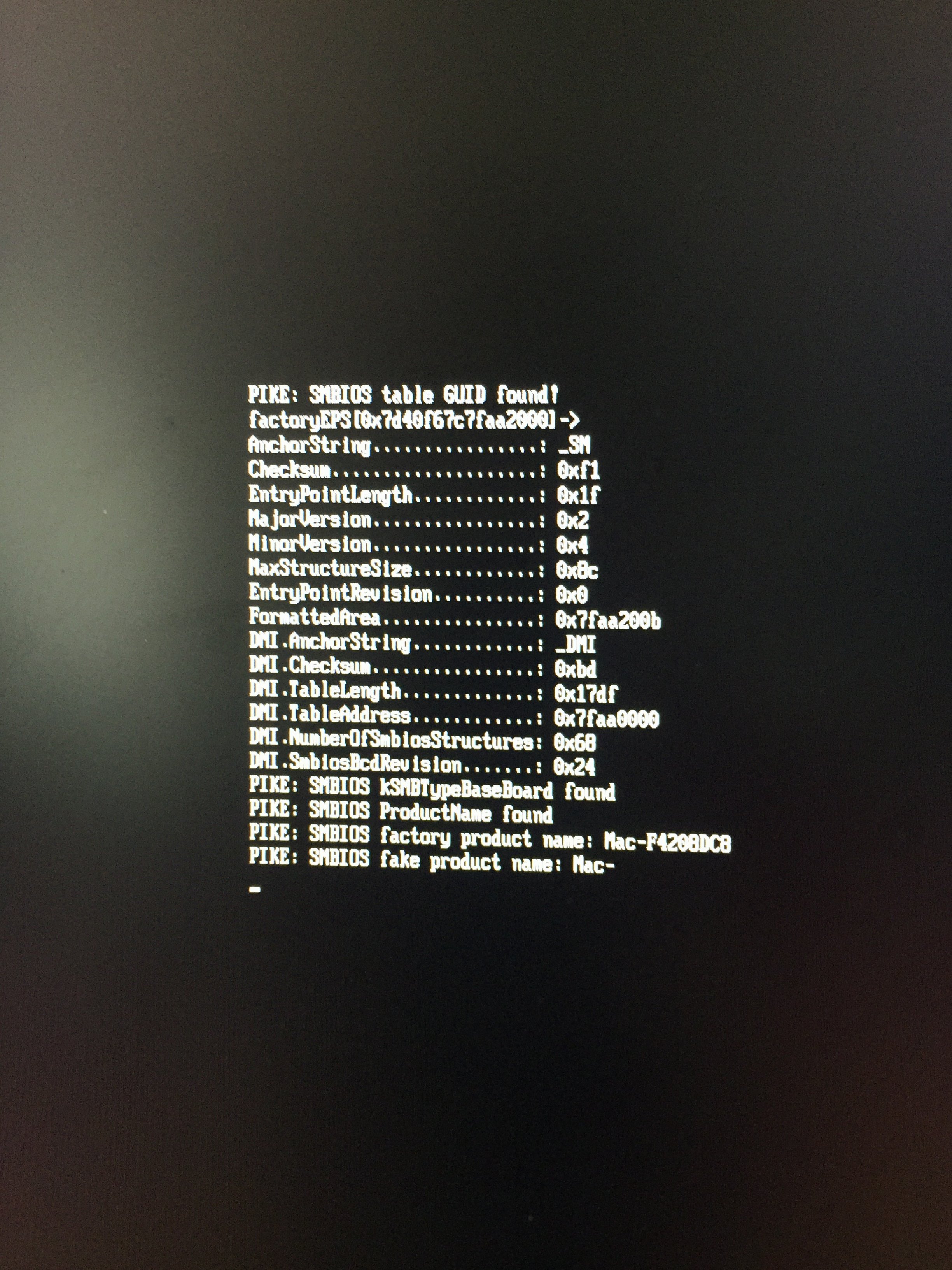

Thanks. New commit available. Please compile/test ioreg output.
Edit: Please test with the last commit (forgot to add a line).
Compiled, installed, and booted (output in a minute).
Just to be clear, I don't grep ioreg | grep very well; would you reiterate the commands I should perform so that I may get the correct info to you...? thx
Commit b1635694 output attached

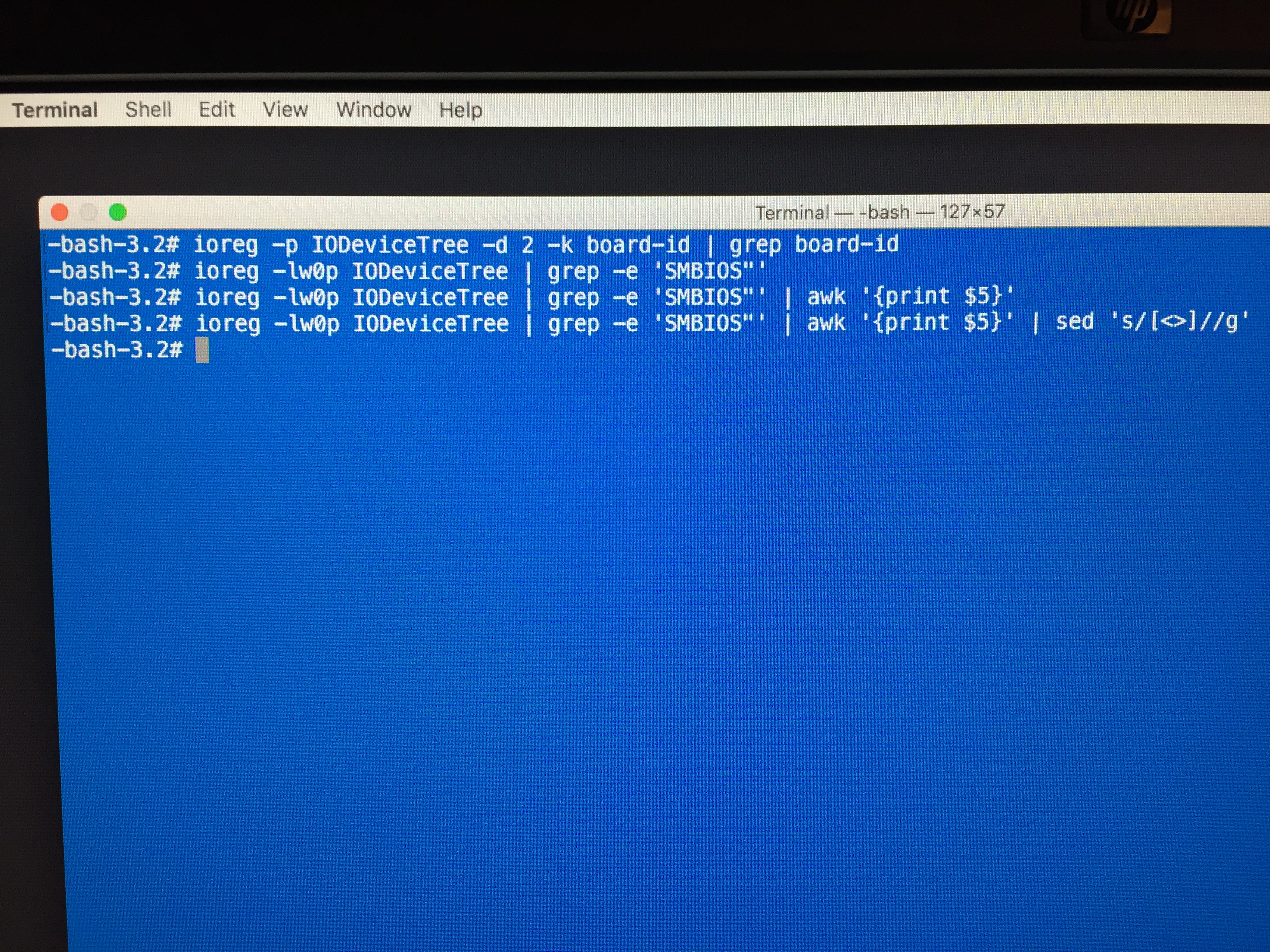

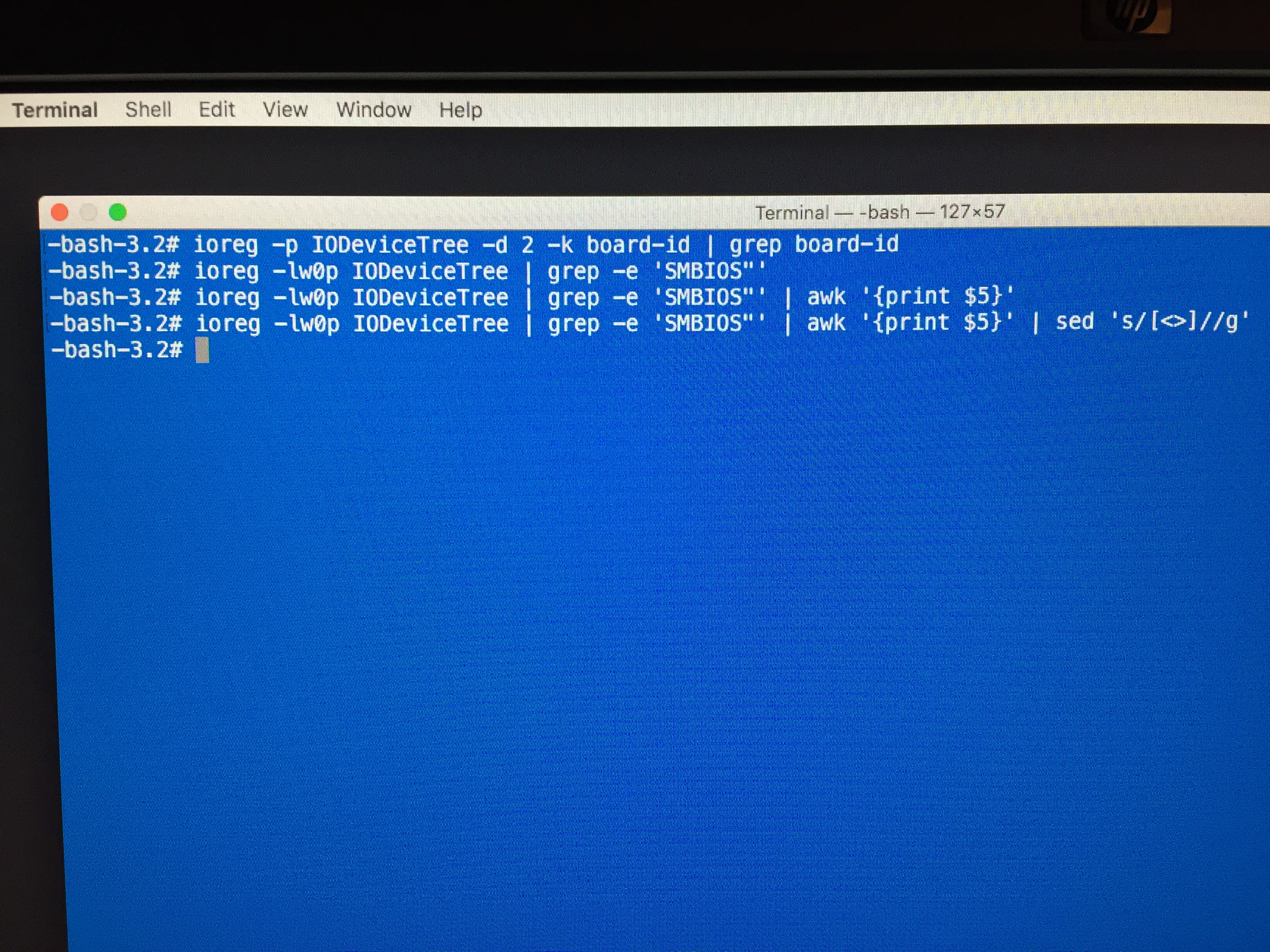

# ioreg -p IODeviceTree -d 2 -k board-id | grep board-id
# ioreg -lw0p IODeviceTree | grep -e 'SMBIOS" ' | awk '{print $5}' | sed 's/[<>]//g'
produce no output to #
# ioreg -p IODeviceTree -r -n / -d 1
gives me compatible = Apple002,1 & model = Apple002,1
(no change from previous)

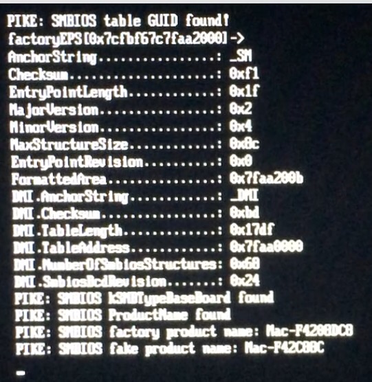

Open the file StdAfx.h and look for this line:
#define BOARD_ID_REPLACEMENT 0x3843383843323446ULL
Change that into:
#define BOARD_ID_REPLACEMENT 0x0043383843323400ULL
Compile and retest. I'll be back later.

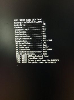

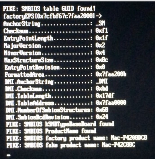

// #define BOARD_ID_REPLACEMENT 0x4634324338384338ULL
// (29) #define BOARD_ID_REPLACEMENT 0x3843383843323446ULL
#defineBOARD_ID_REPLACEMENT 0x0043383843323400ULL
Ok. We were missing a NULL (00) character. Now replace the line with:
#defineBOARD_ID_REPLACEMENT 0x0043383843323446ULL
And try again, and don't forget to report the output of ioreg. Thanks!

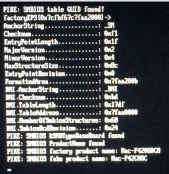

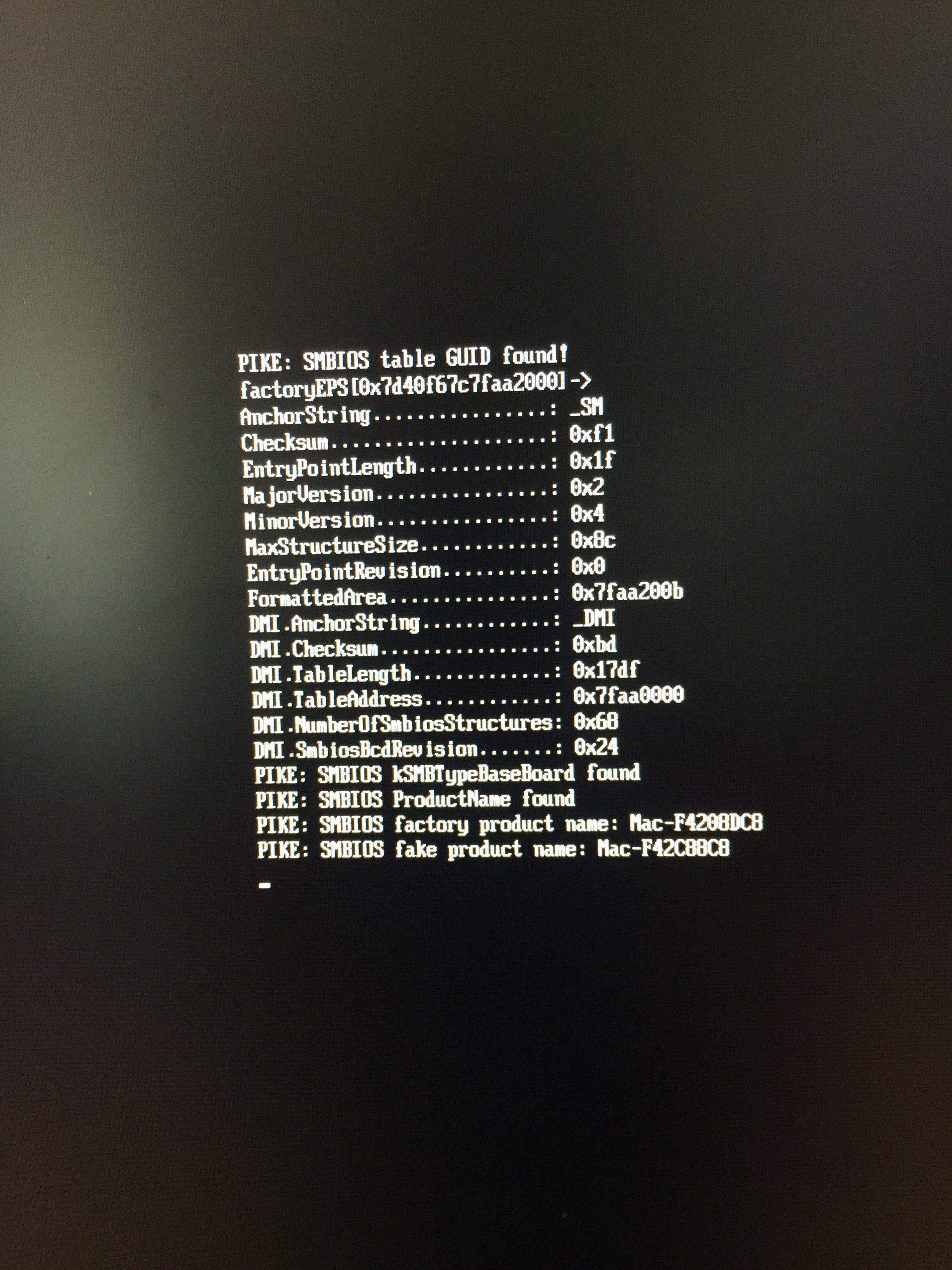

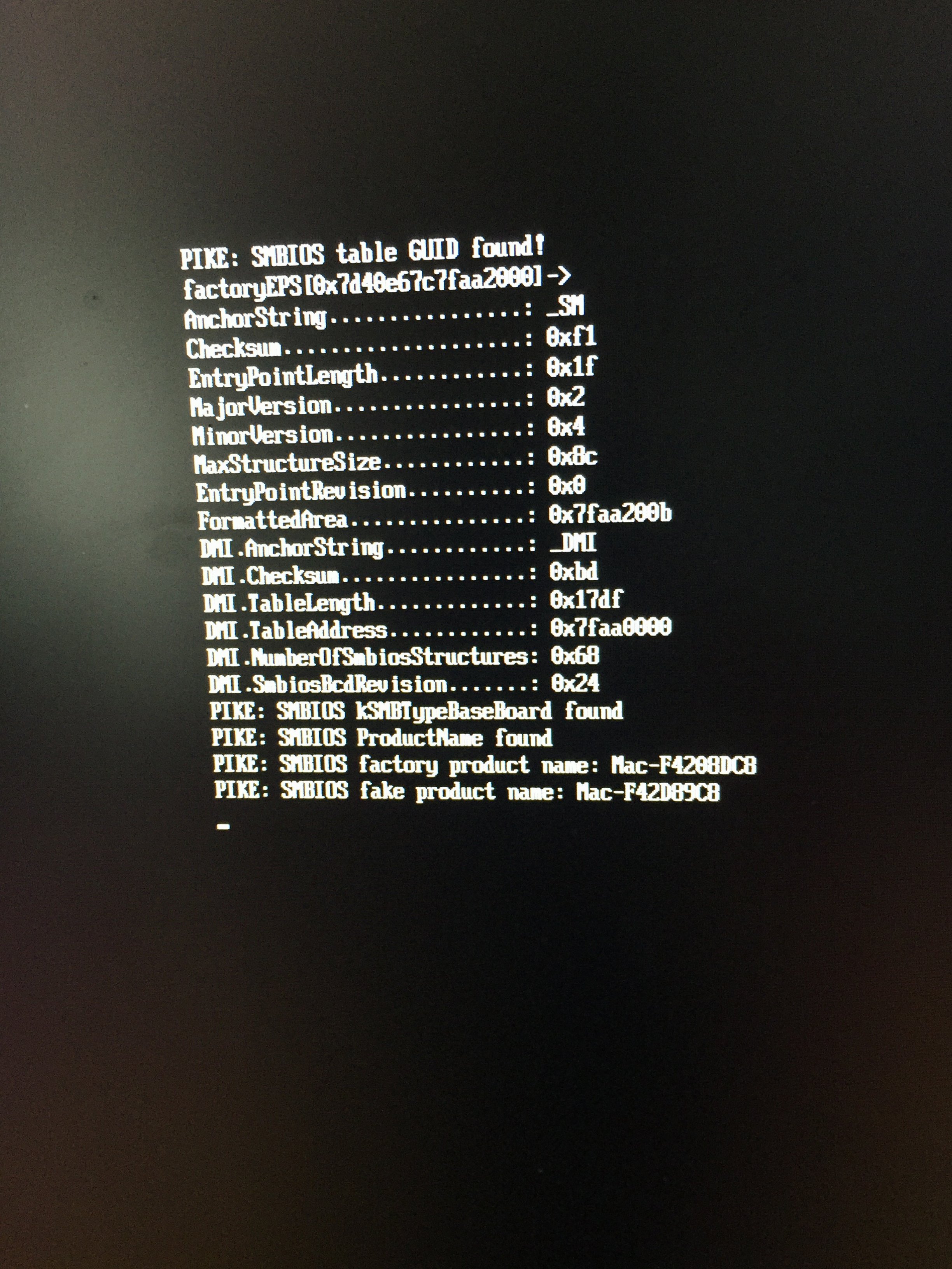

re-mod:
#define BOARD_ID_REPLACEMENT 0x3843393844323446ULL
-bash-3.2.splifing8# fsck . . . why did it have to be a hex convert backwards from ascii...crazy stuff, Pike (kudos that you're not insane (insane-er?) after all this).
And the ioreg output? How does that look now?
Edit: Wait, you have:
instead of:
#define BOARD_ID_REPLACEMENT 0x0043393844323446ULL
Without the terminator character (00) it will definitely fail. And it is backward because that is how it is layout in memory (64-bit pointer).
Also not going to crack/get mad/crazy/lose me nerve. I'm just doing this for fun while working on other stuff. Too bad that I can't test it myself, otherwise we would have been ready a looong time ago already.

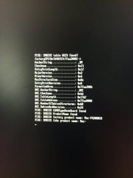

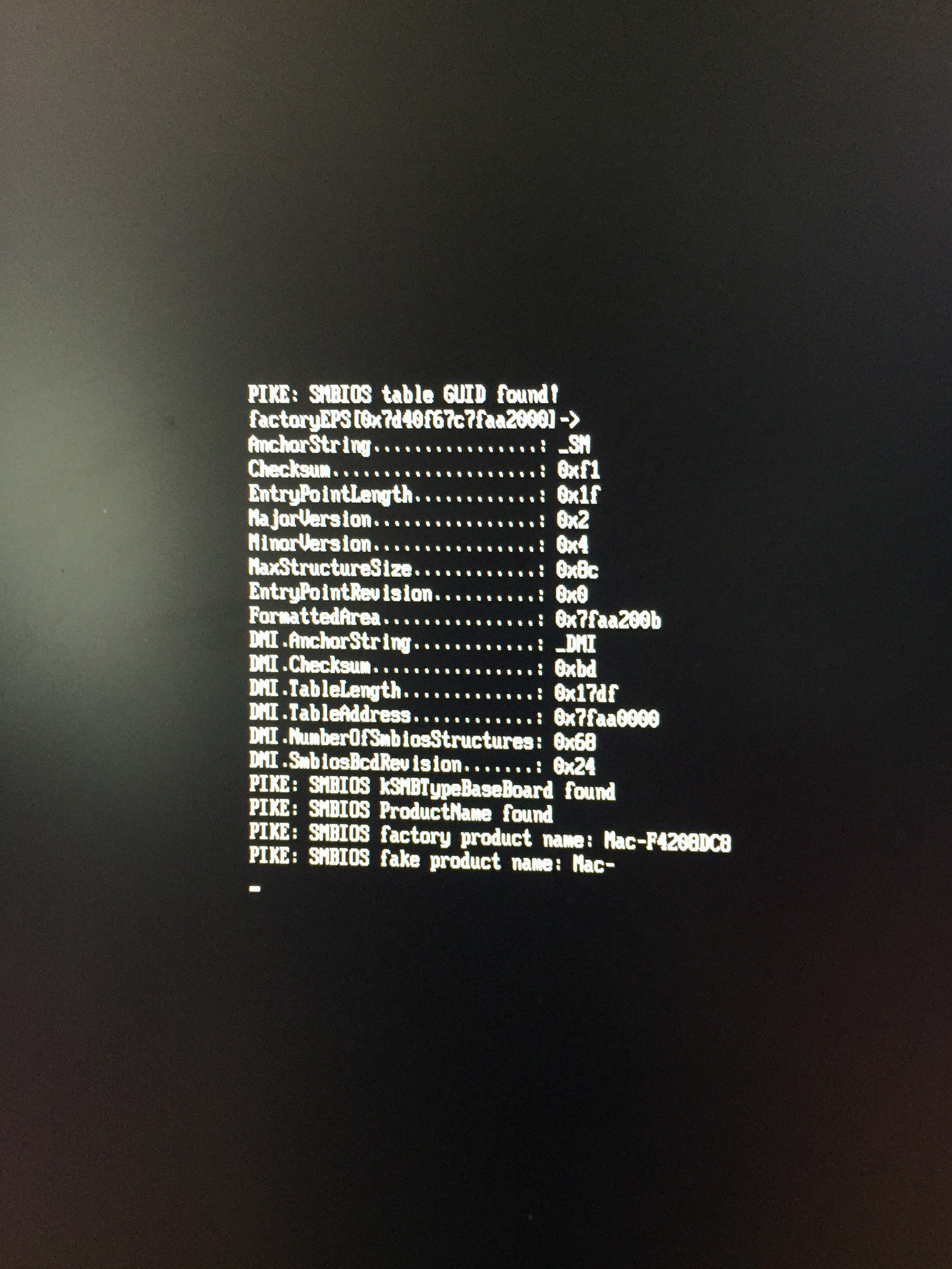

Aye; so, so much gets lost in the trans-lation/nation…I just learned more than I should probably know about hex <--> ascii conversion (and board-id, for that matter)…with 'Mac-' as my output from your previous request, I just picked Mac-F42D89C8 as teh fake id, compiled and booted (well-before you psoted your reply).
[edit]ioreg output from previous commands return null, every time[/edit]
I'ma gana go spend the evening with Mom in short-order…anything key that I try before I go?
Splifingate, can you make the #define change and create and post a build? Then I can check the ioreg output...
No thanks. You've done enough for tonight. Go have fun with mom. Take care 😉

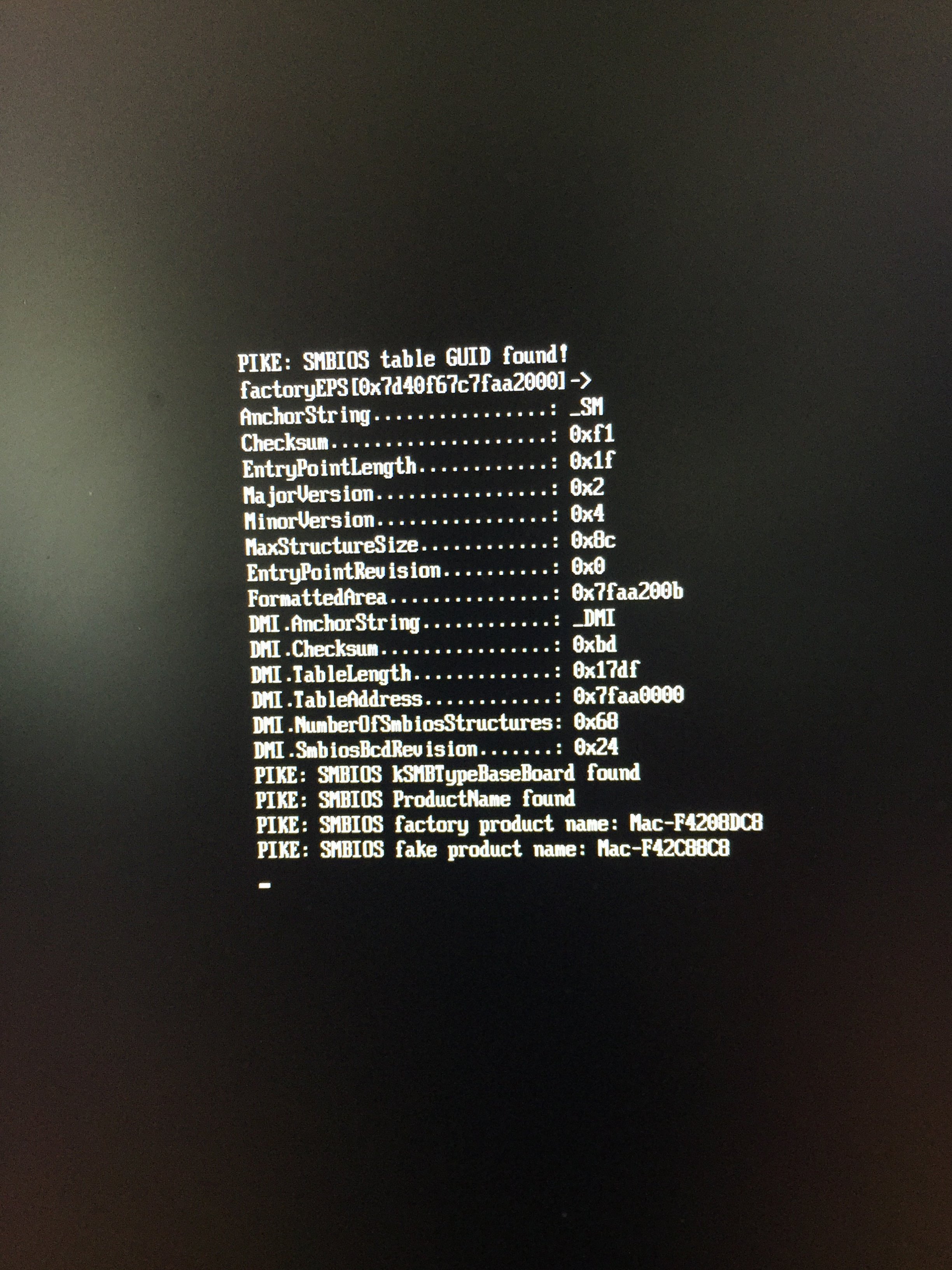

Attached is the debug output from the build splifingate just posted. Ioreg output follows:
EDIT: here is the ioreg output. Looks like regression.
Code:
-bash-3.2# ioreg -lw0p IODeviceTree | grep -e 'SMBIOS"' | awk '{print $5}' | sed 's/[<>]//g'
-bash-3.2# ioreg -p IODeviceTree -r -n / -d 1
+-o /  <class IOPlatformExpertDevice, id 0x100000111, registered, matched, active, busy 0 (143674 ms), retain 27>
      "IOBusyInterest" = "IOCommand is not serializable"
      "compatible" = <"Apple002,1">
      "IOPlatformUUID" = "2B12FE1B-1090-593B-B740-XXXXXXXXXXX"
      "IOConsoleSecurityInterest" = "IOCommand is not serializable"
      "system-type" = <03>
      "model" = <"Apple002,1">
      "IOPolledInterface" = "SMCPolledInterface is not serializable"
      "IOInterruptControllers" = ("io-apic-0")
      "IOInterruptSpecifiers" = (<0900000005000000>)
      "name" = <"/">
      "clock-frequency" = <00e1f505>
-bash-3.2# ioreg -lp IODeviceTree | grep board-id
-bash-3.2# ioreg -p IODeviceTree -d 2 -k board-id
+-o Root  <class IORegistryEntry, id 0x100000100, retain 13>

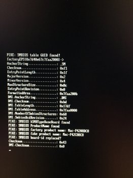

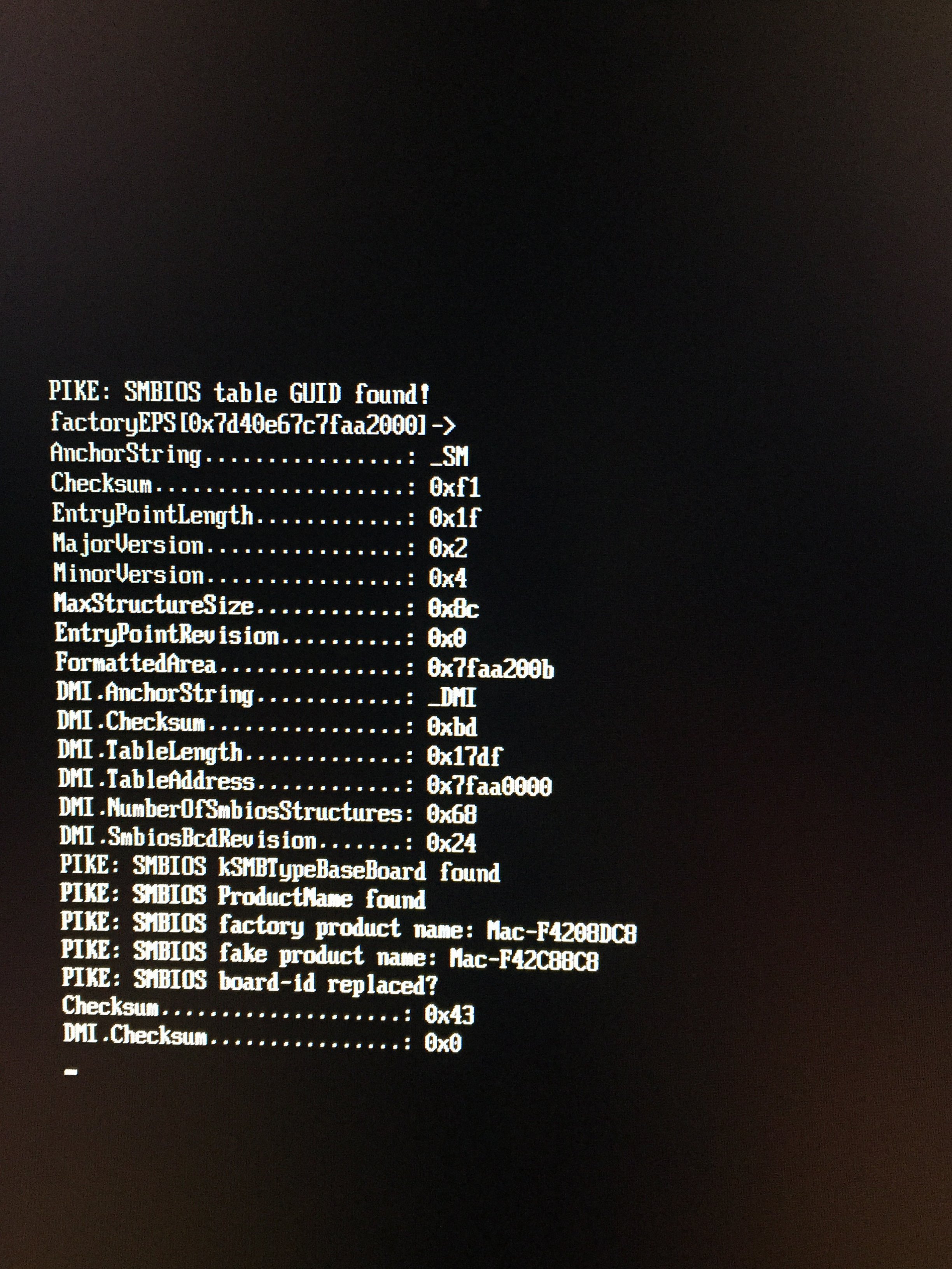

Here is an example of SMBIOS data (taken from a MacPro2,1):
"Apple Inc."00"Mac-F4208DA9"00
We seem to overwrite the " Inc." part here.
The table header is 4 bytes so perhaps we should increase the pointer with 4, and this is where someone with a compiler/test setup comes in handy.
Add terminator character.

commit 460310bd
No change in # ioreg terminal output.

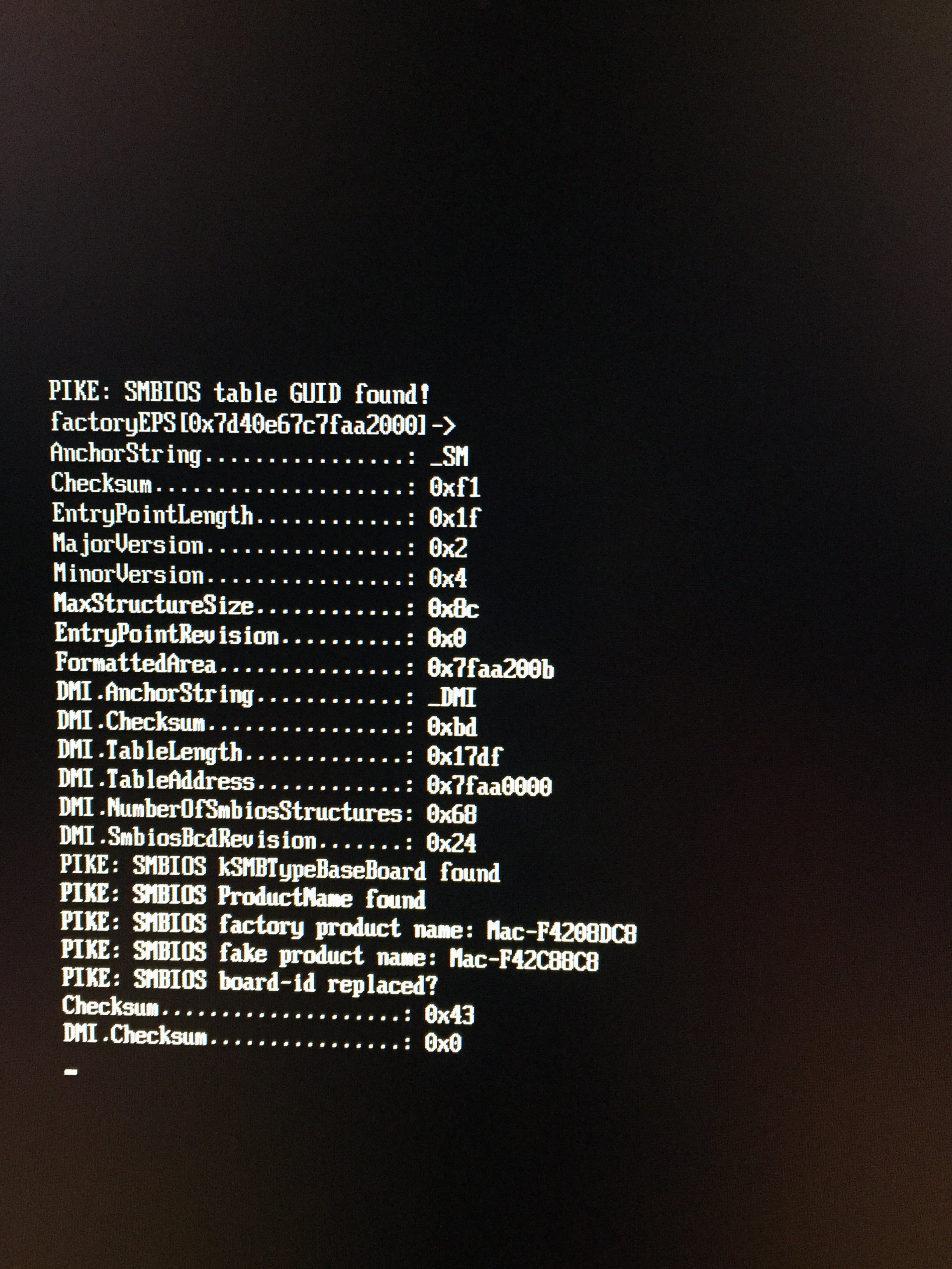

Pike, I did some debugging and found that the corruption of the MacPro2,1 node of the ioreg listing was being caused when the checksums were updated. I left that out entirely, and as we speak, my OS X El Capitan upgrade has about 2 minutes remaining... 🙂
How does one leave this/these out, if you don't mind me asking?
Sure, I commented out line 319 and 320 of PlatformExpert.cpp
The installer restarted the machine after it finished, and my fresh copy of El Capitan came up, instead of starting from the upgrading drive. I manually restarted from the upgrading drive, and OS X Yosemite came back up. On this drive, there is now a folder called "OS X Install Data", and the boot.efi file in the .IABootFiles folder on the installer drive was reverted, presumably by the installer app.
I am going to restart again now from the installer drive, after fixing the reverted efi.
The upgrade is finished, and I write this reply from El Capitan! I'm really pleased to have my Mac Pro 1,1--->2,1 upgraded. Thank you so much Pike!
I had to replace boot.efi in the usual places on my main volume after the upgrade finished.
Well, that is great, but that should point to a completely different memory location. No idea what is going on. Need to investigate this.
