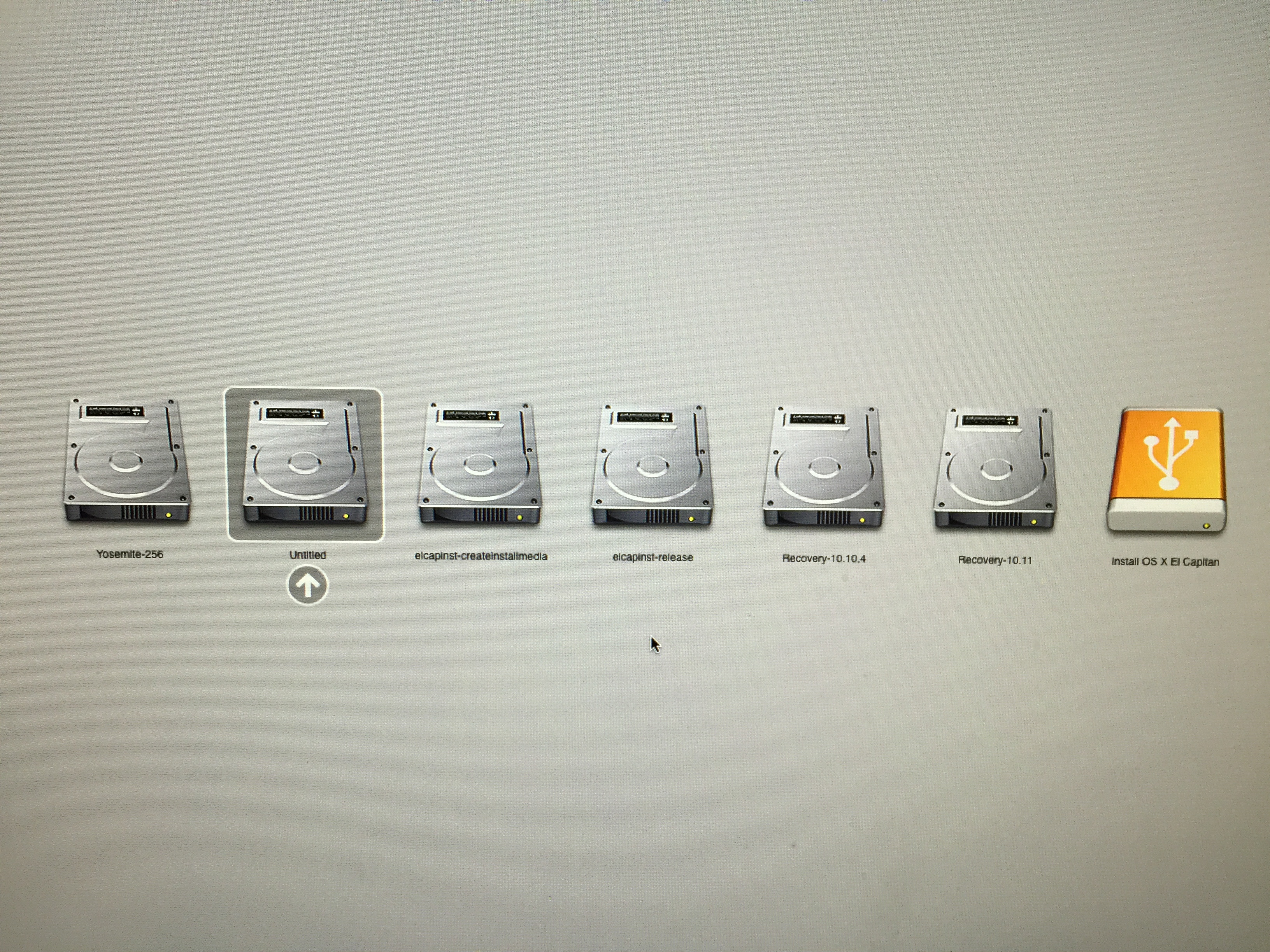

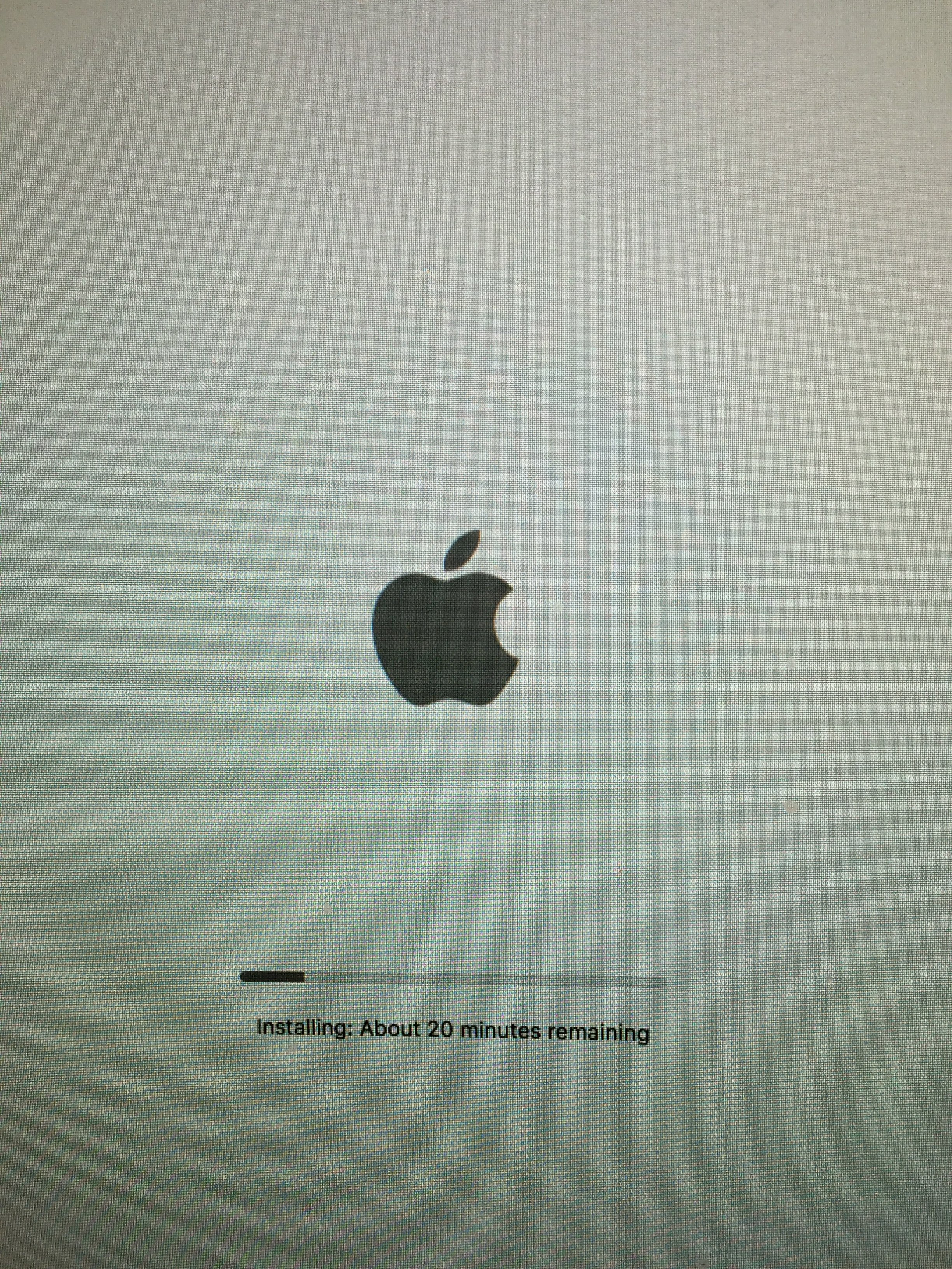

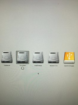

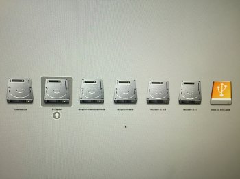

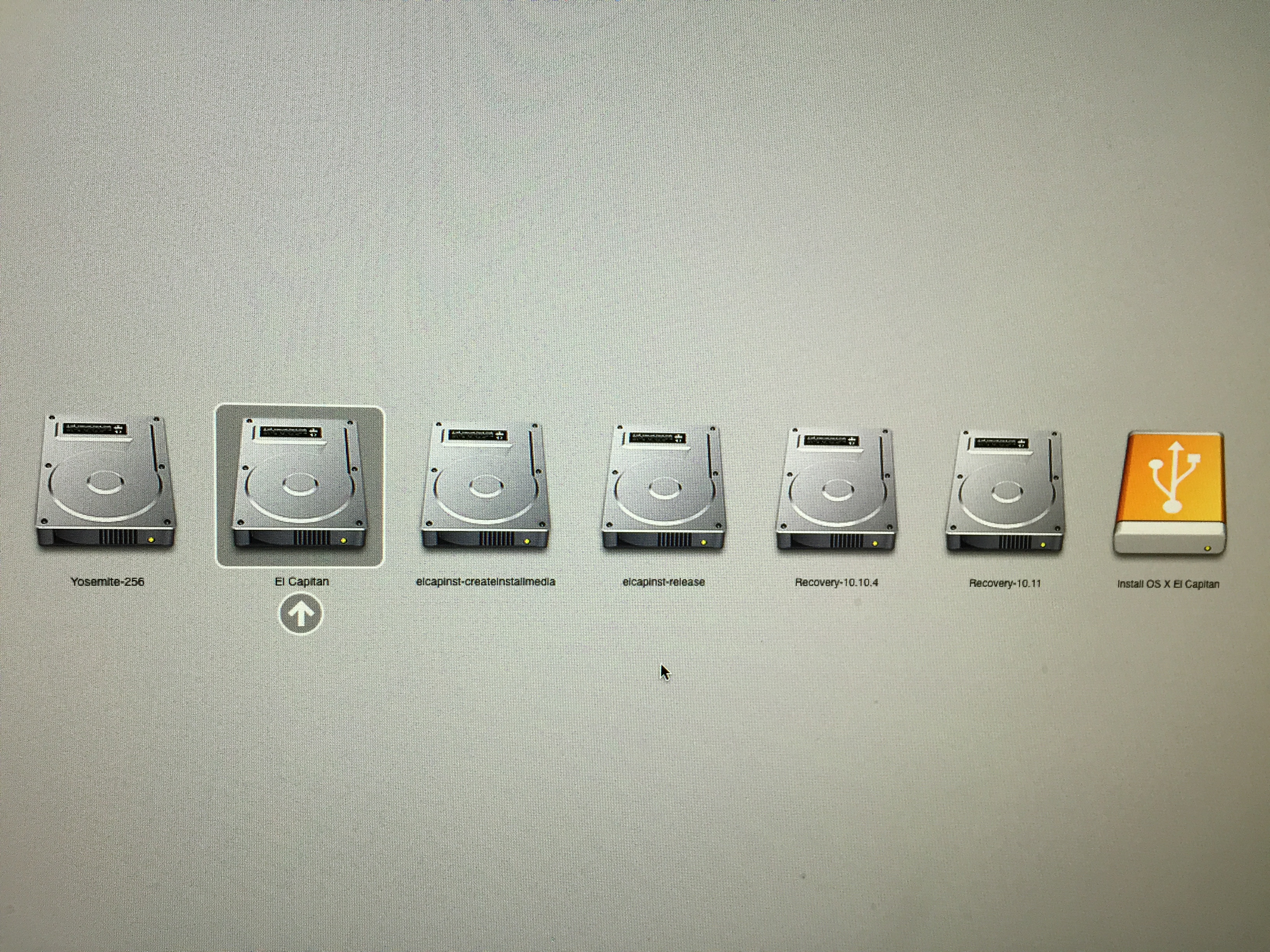

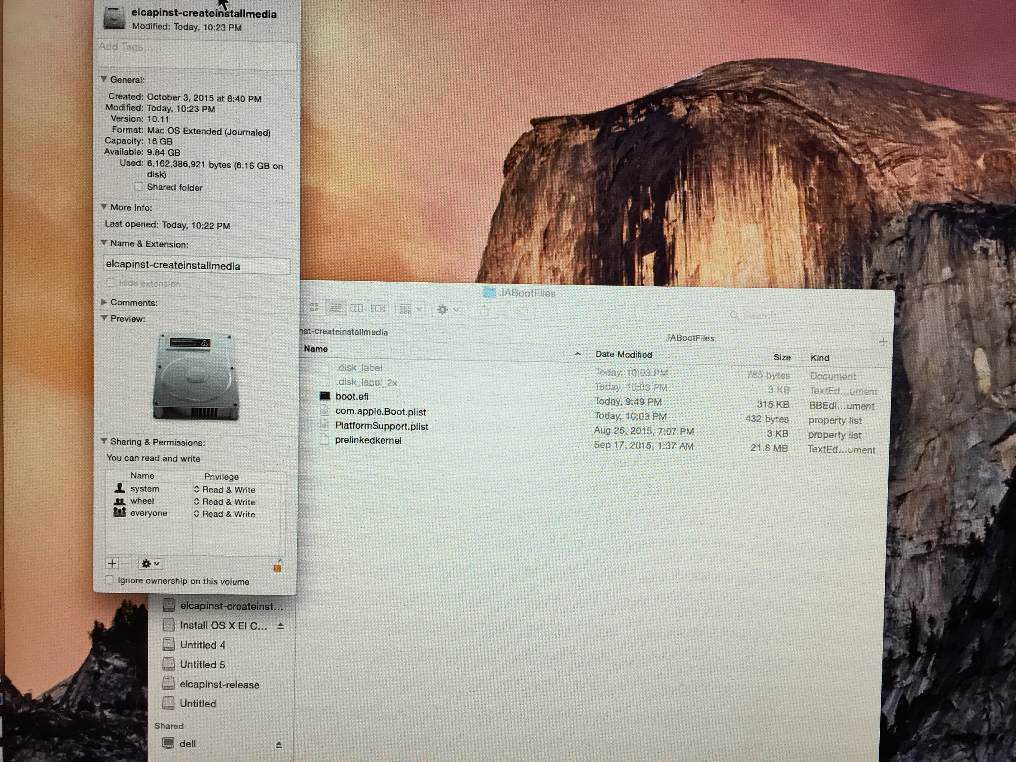

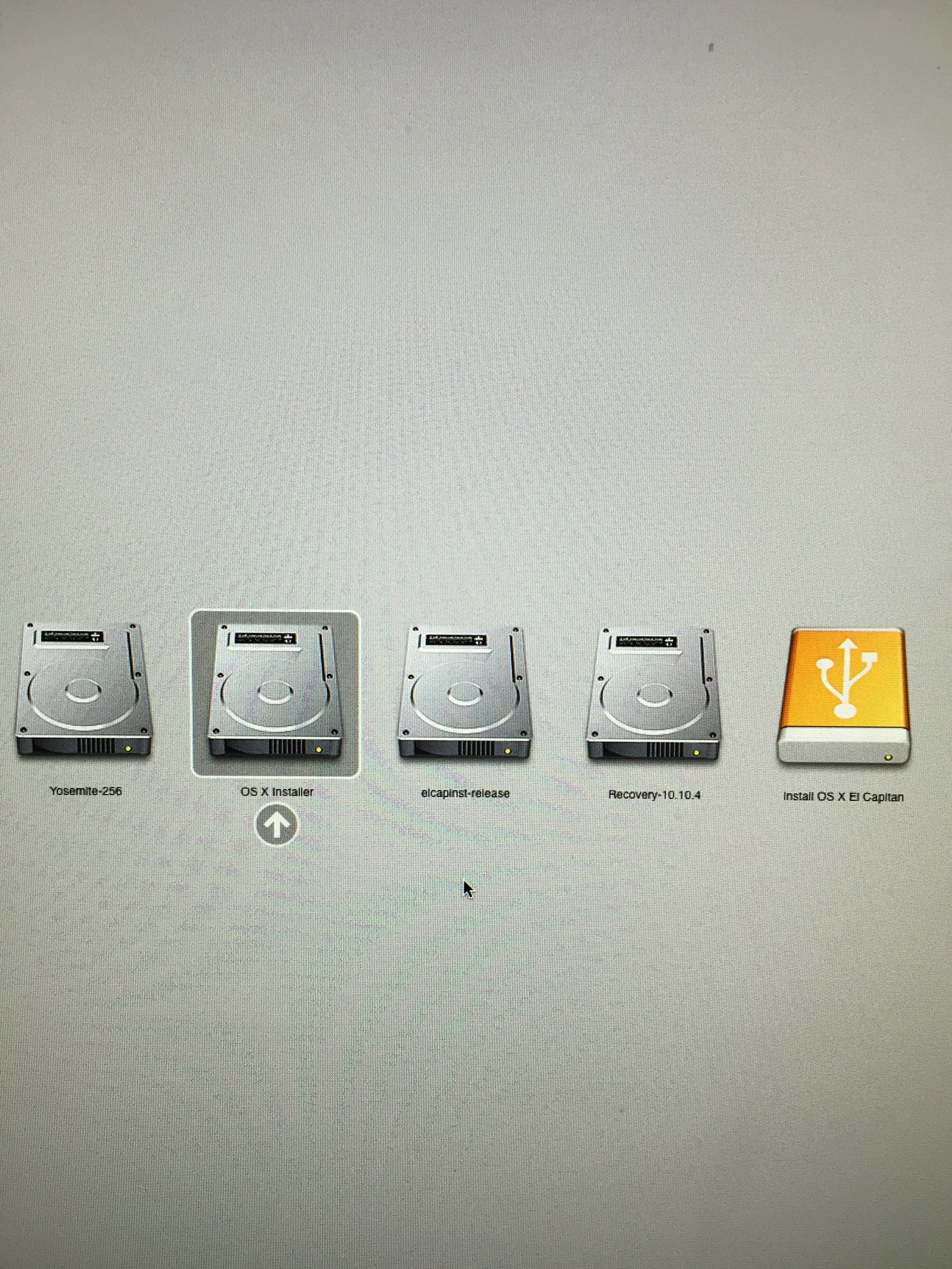

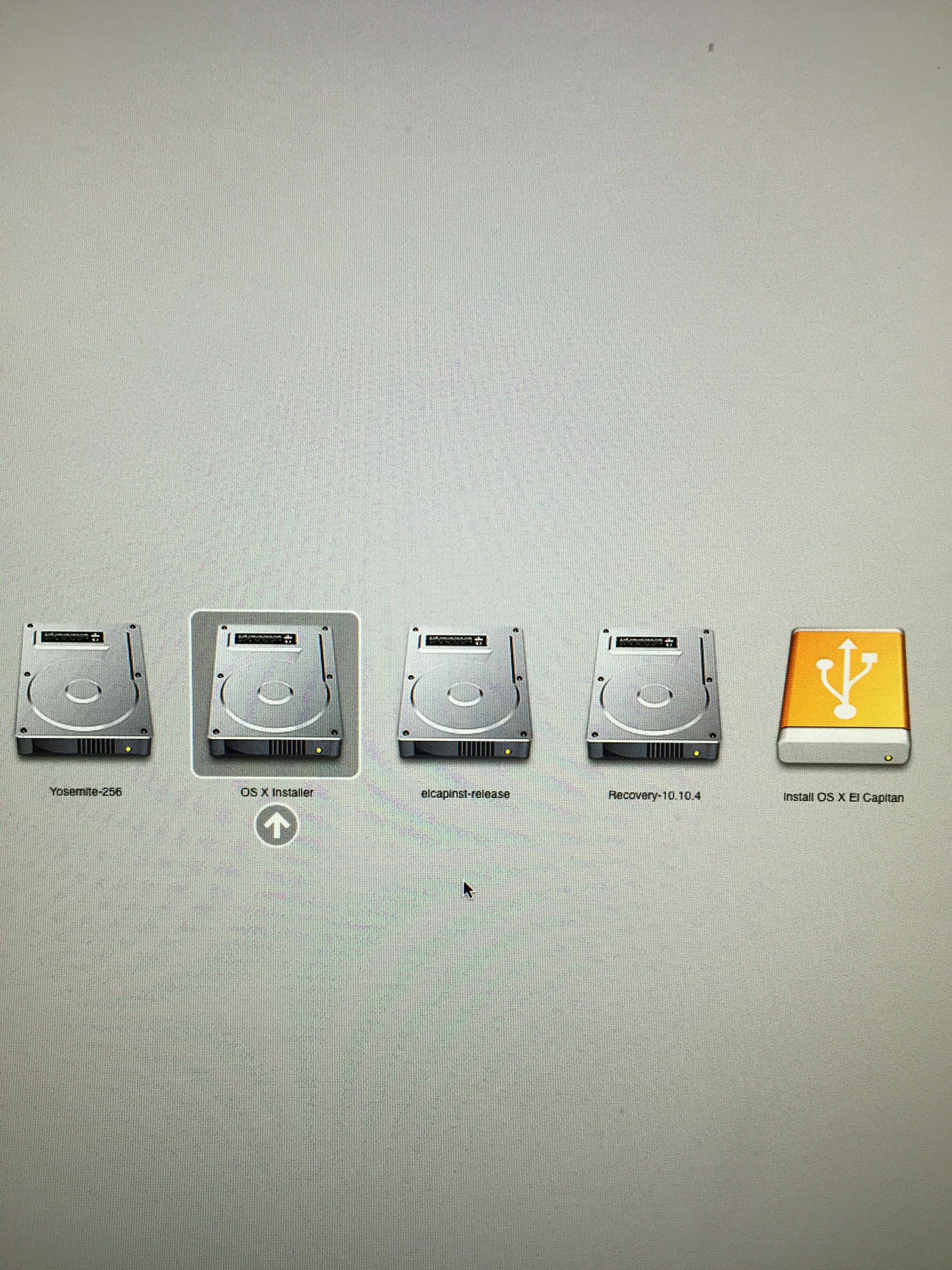

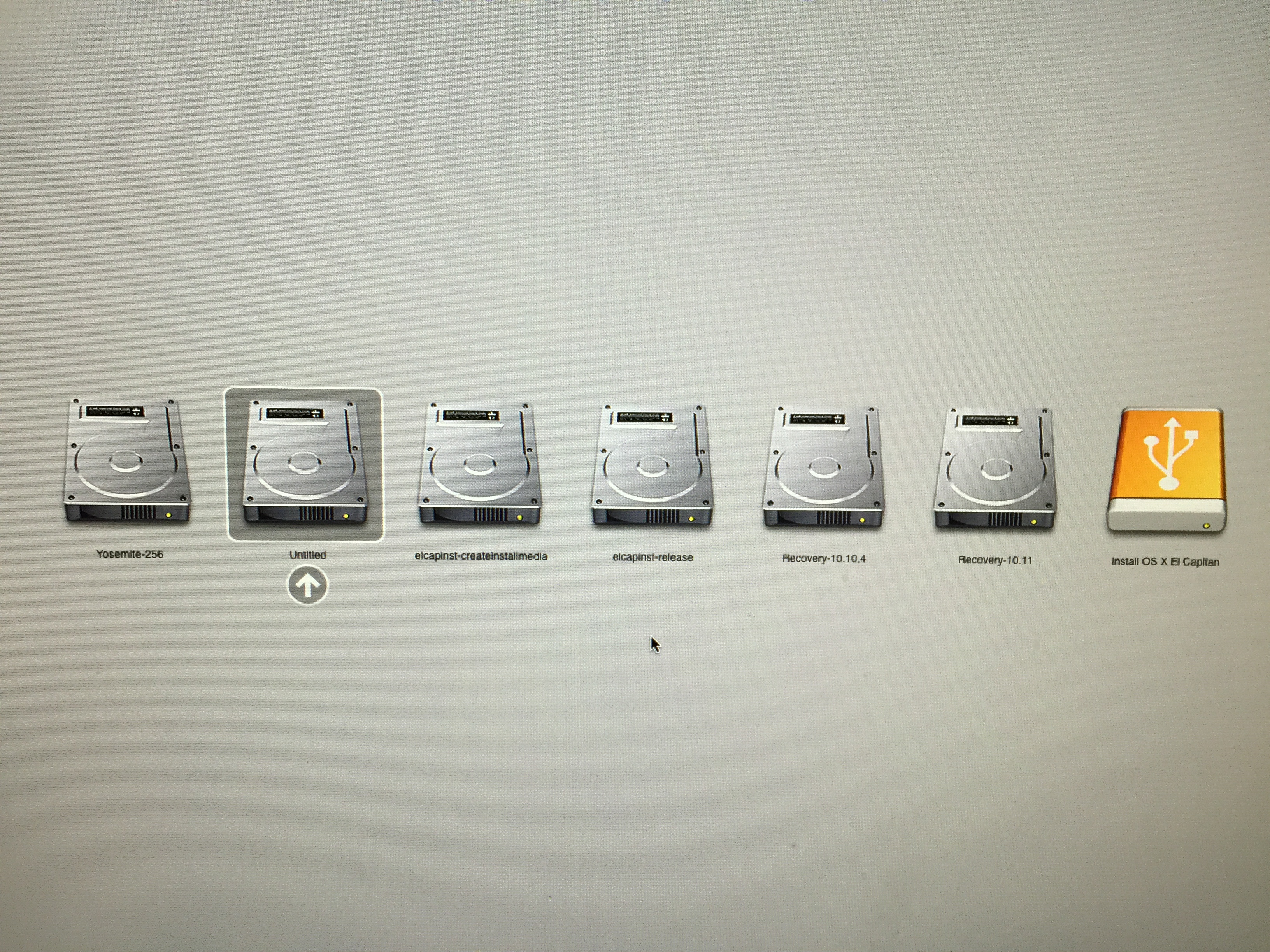

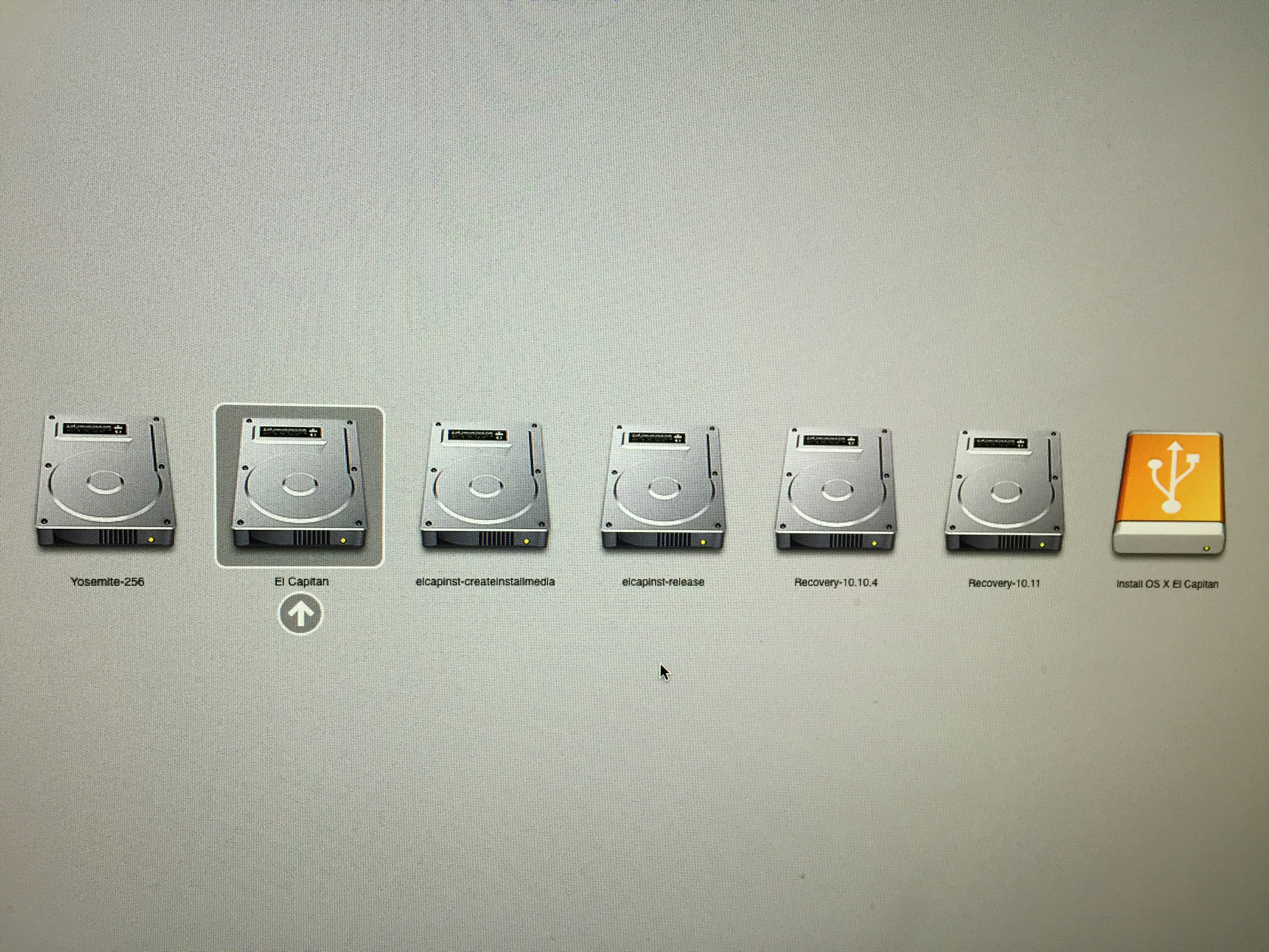

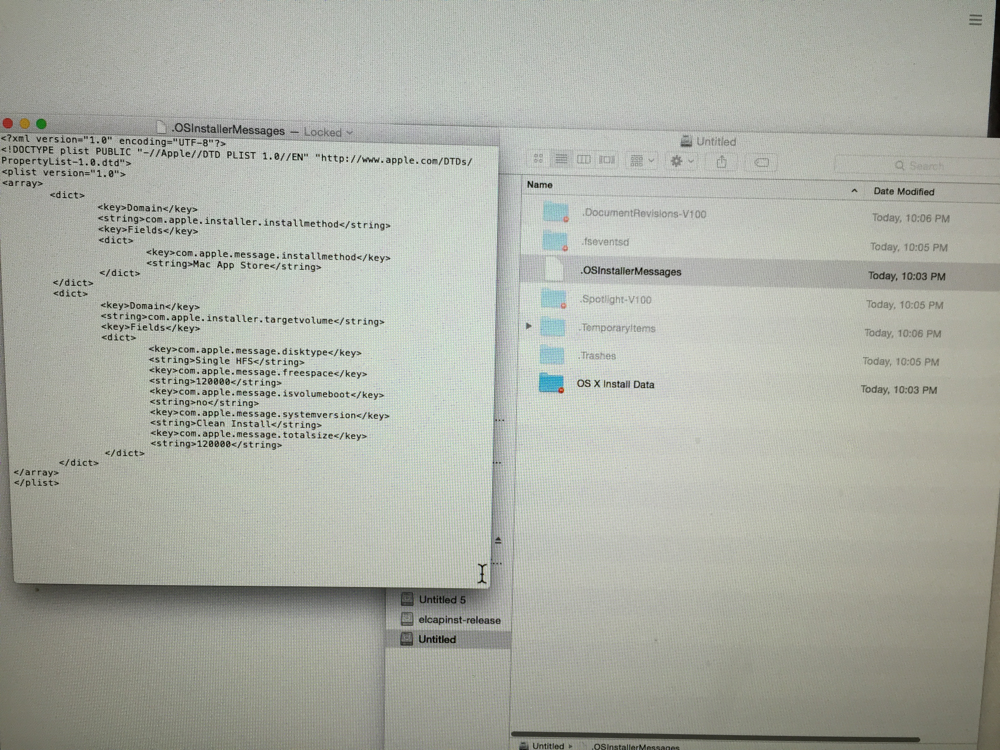

Option -> Yosemite (working install) directly after installer re-boot...

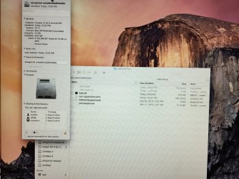

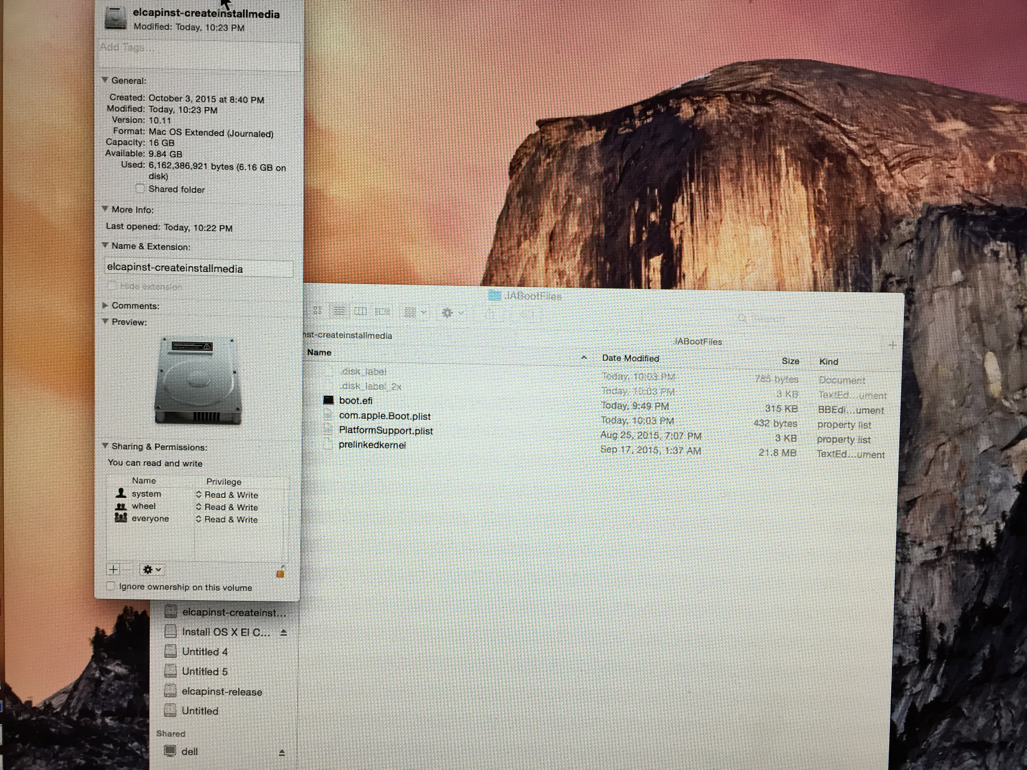

Contents are locked.
Deceptive…the ".IABootFiles" is in the original createinstallmedia partition, is modded after teh install process, and is locked from casual viewing/editing.
Allowed 'Everyone', and replaced the stock ~600kb boot.efi with the ~300kb from the compile of commit 460310bd.

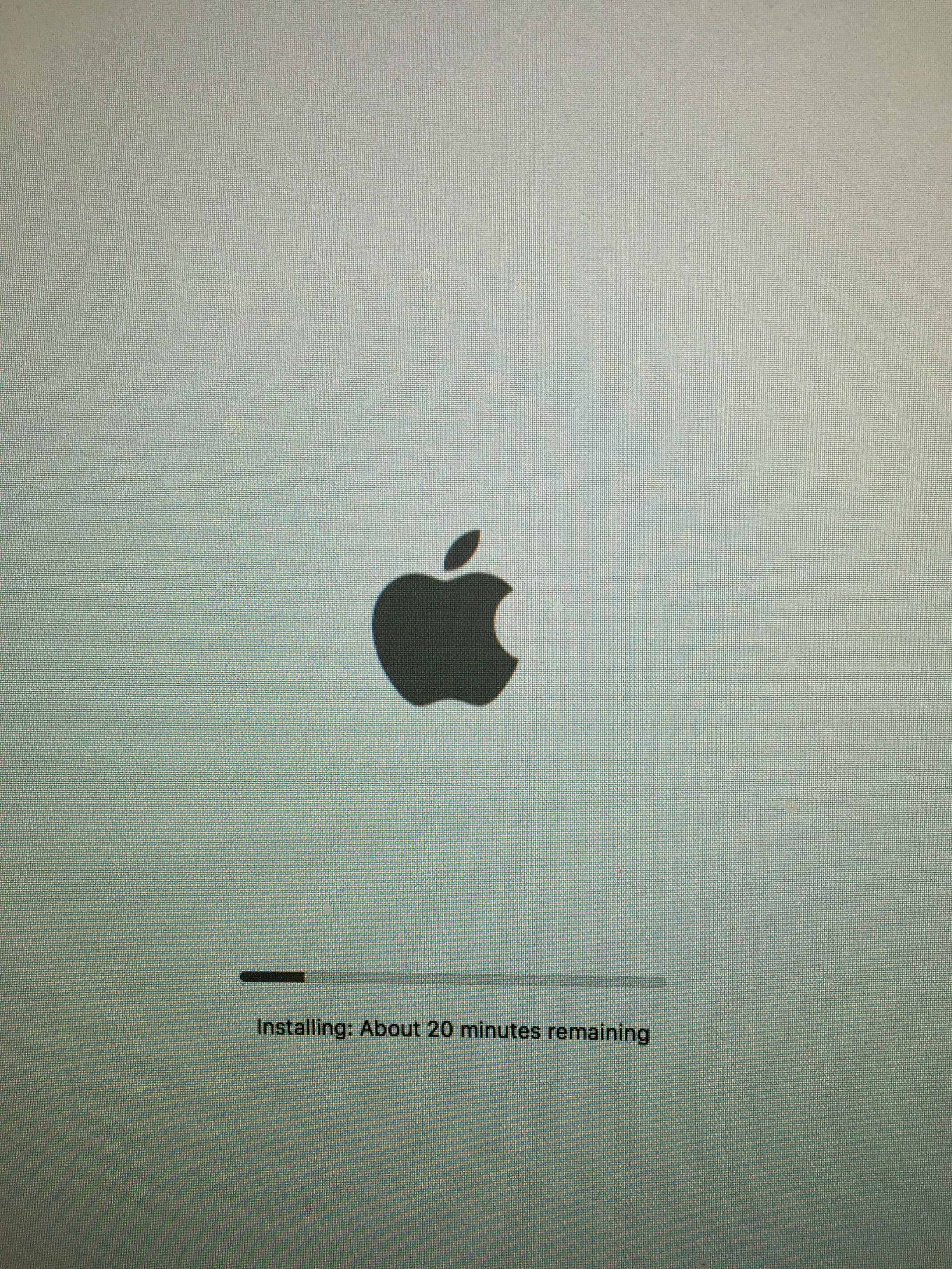

Re-booting, AIT…

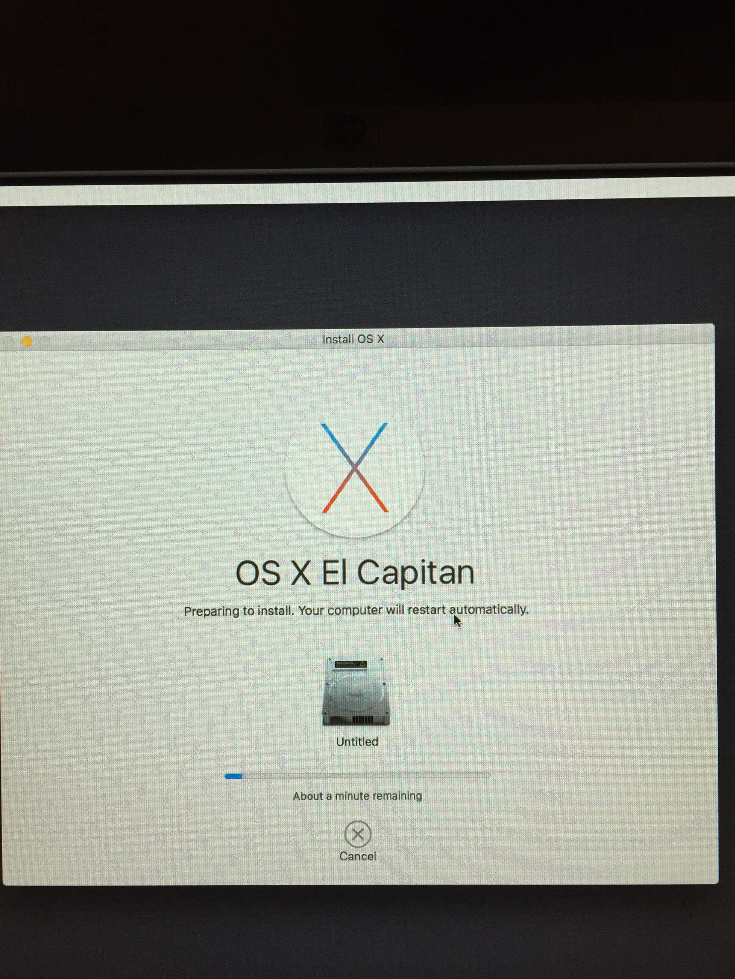

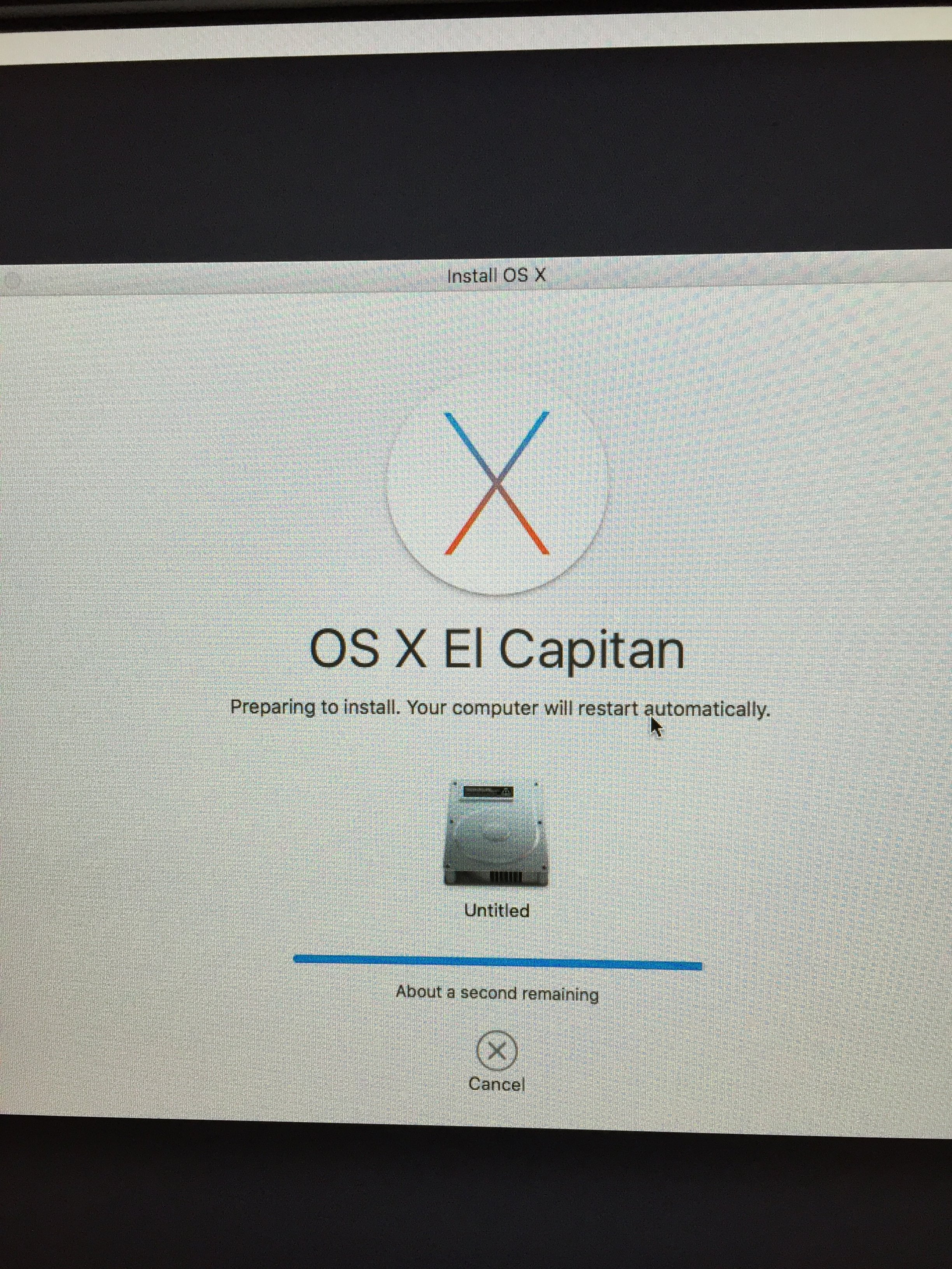

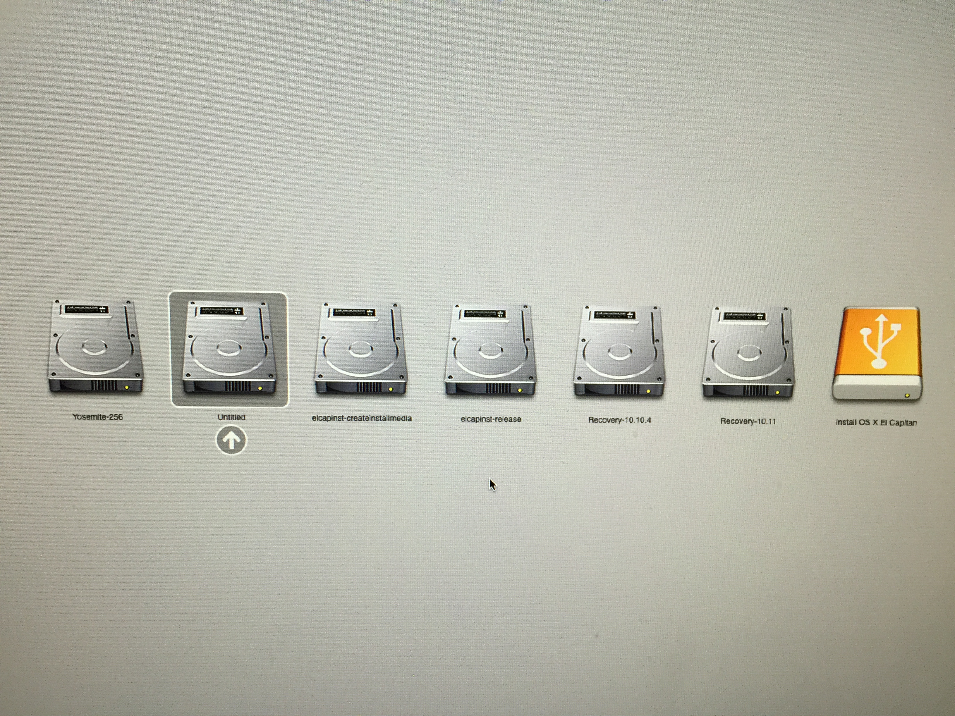

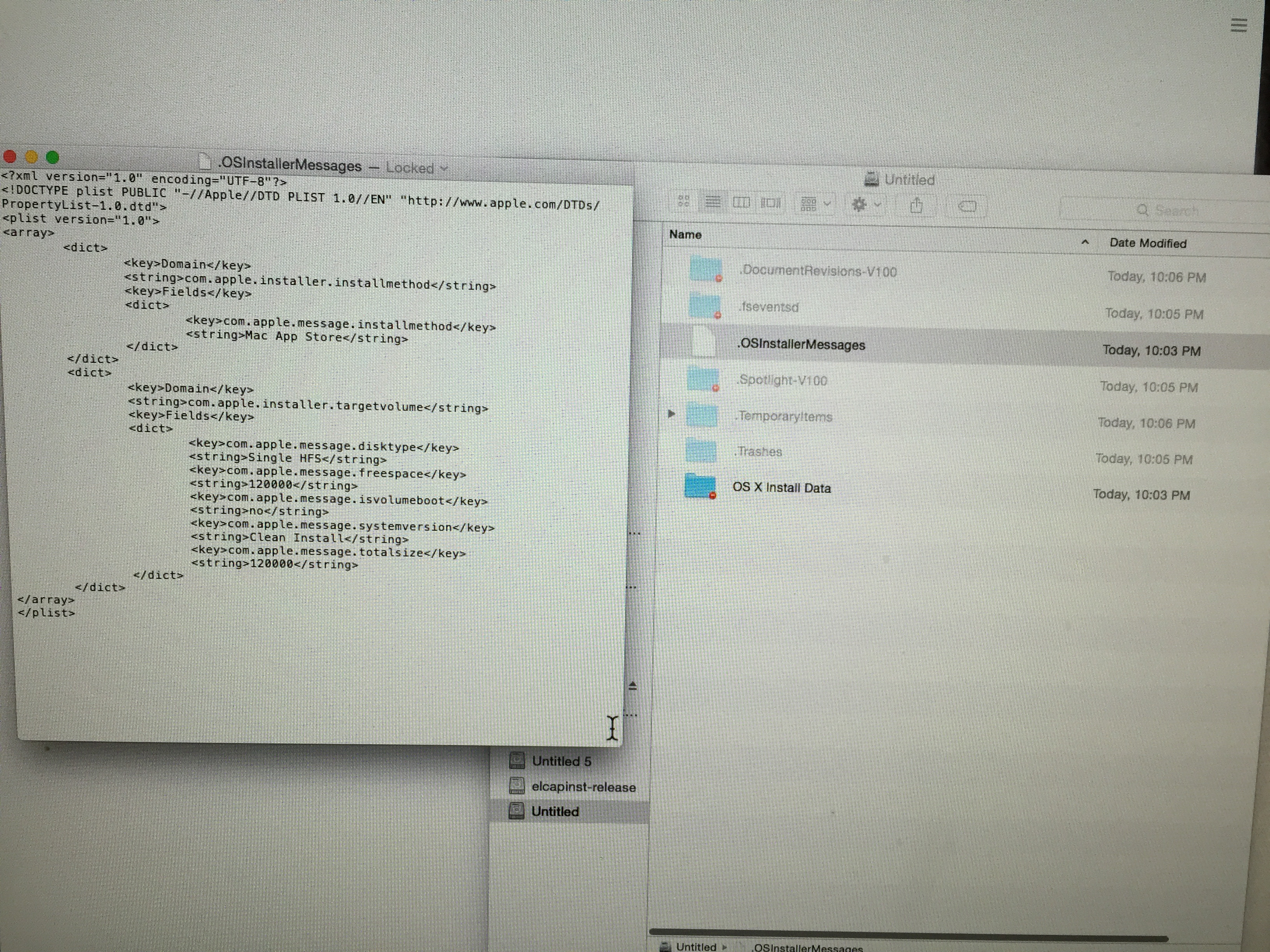

Re-booting, AIT…

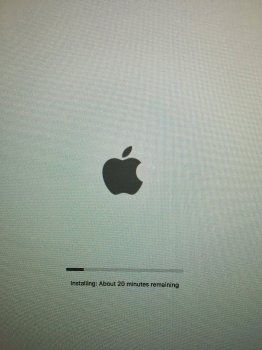

Doing its thing (BTDT).
Just wanted to verify.
Thanks for the pointers, @busitech 🙂

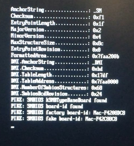

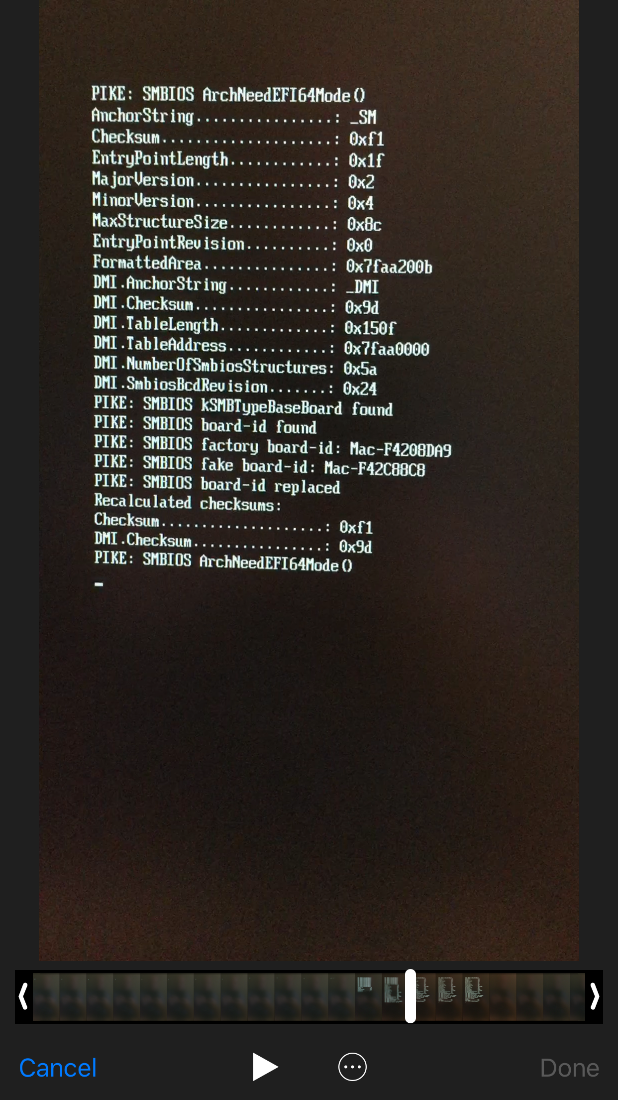

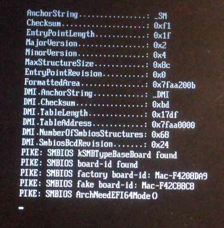

I think I understand these two checksums now, after reading a few pages (21-22) of the SMBIOS Specification. We don't need to update these checksums, because they should not be affected by the board-id change. The area of memory being checksummed is just the entry point structure, only 0x1F bytes, and the intermediate entry point structure, only 0x0F bytes. Correct?
Correct. We don't need it right now because, strangely enough... Apple allows us to poke memory locations that should be protected, and they can change this pretty quick, so we better be prepared for it.

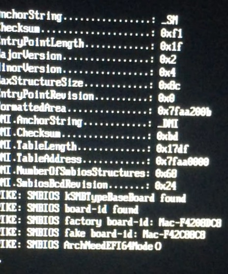

Are we still talking about the installer or normal boot?
Edit: I checked the last five commits and they cannot be causing this. The yard meaningless changes, though there are two other parts that may be failing. Please test this change:
-memcpy((CHAR8 *)startOfStringTable, (CHAR8 *)BOARD_ID_REPLACEMENT, strlen((CHAR8 *)BOARD_ID_REPLACEMENT));
+memcpy((CHAR8 *)startOfStringTable, (CHAR8 *)"Mac-F42C88C8", 12);
-startOfStringTable = Add2Ptr(startOfStringTable, strlen((CHAR8 *)BOARD_ID_REPLACEMENT), UINT8*);
+startOfStringTable = Add2Ptr(startOfStringTable, 12, UINT8*);

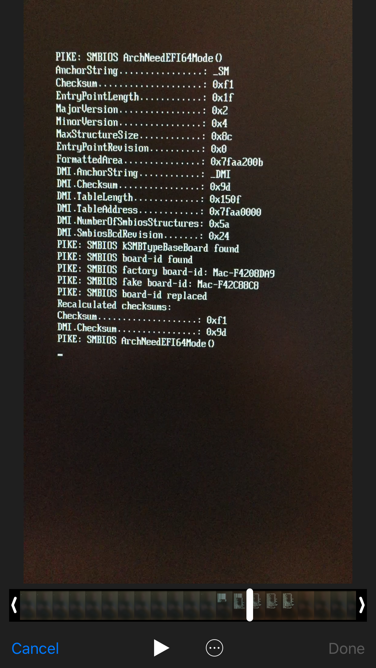

Also. Look for this if(ArchNeedEFI64Mode()) {
and add this line:
+CsPrintf(CHAR8_CONST_STRING("PIKE: SMBIOS ArchNeedEFI64Mode()\n"));
Note: Lines that start with "-" are current lines and lines with a "+" are new lines. Only add new lines without the "+".
New commit with changes available for compilation/testing.
I'm afraid I have no ability to compile/build your bootloader. I've been watching this thread for any opportunity to help test a new build, once somebody posts one, but that's all I'm able to do, unfortunately. Sorry.
No problem. Peter is here to help people like you. Thanks for testing the changes, and if the next version of boot.efi also hangs, then please report if you see this line: "PIKE: SMBIOS ArchNeedEFI64Mode()".

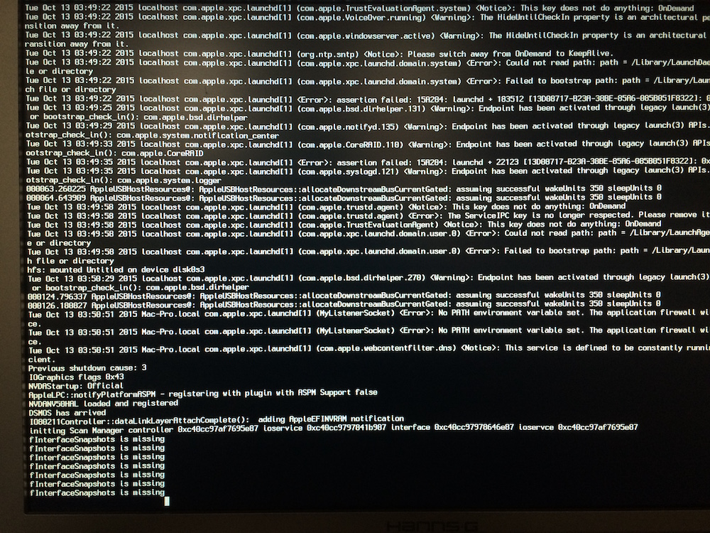

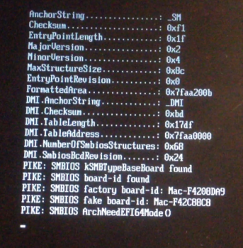

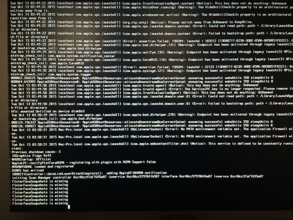

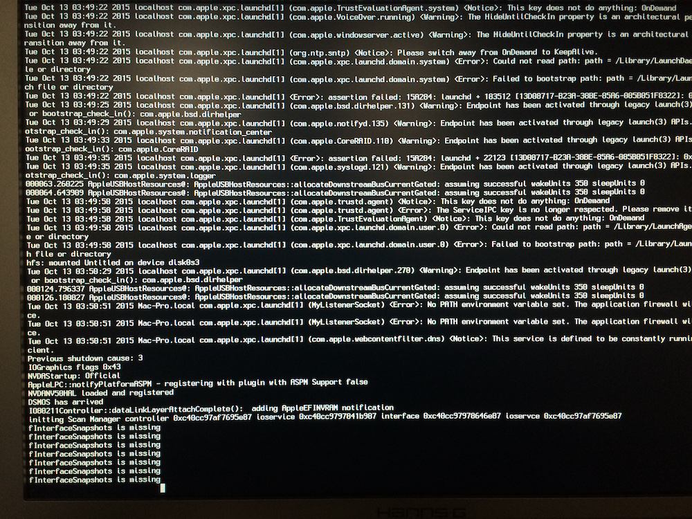

Here is a screenshot. Starting from the latest commit, I took out the code adding the null terminator, and went back to the hard coded board string. I too am hanging at Waiting for DSMOS now. I am going to erase my installer media, which was used previously, and retry with a fresh copy.

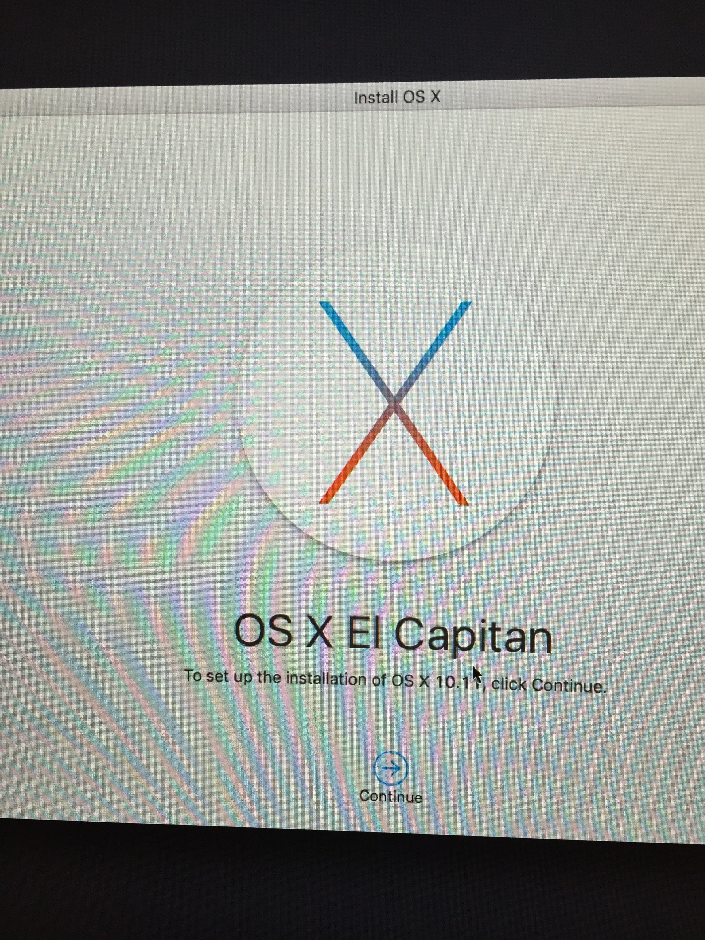

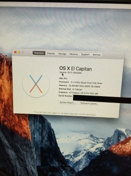

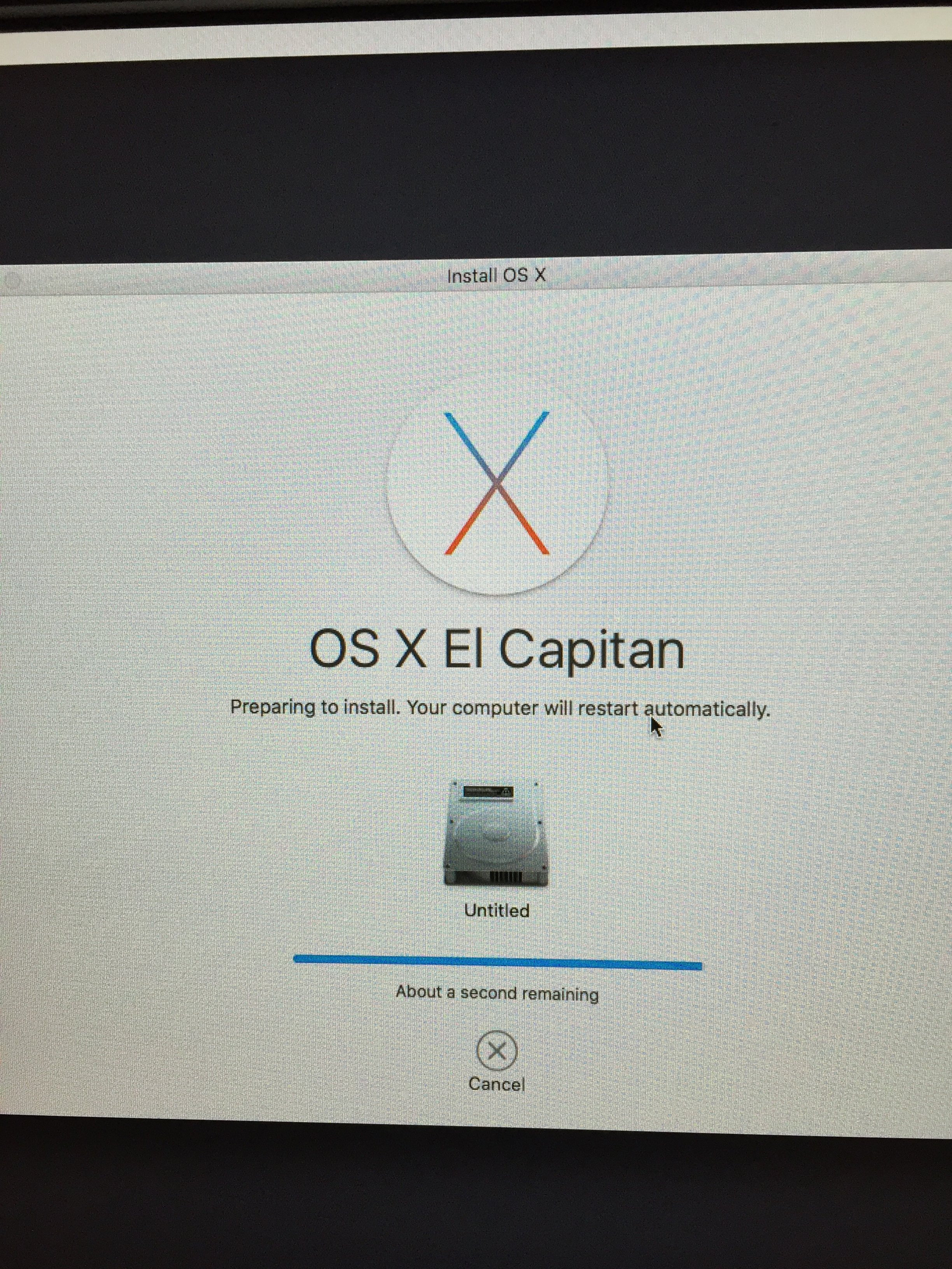

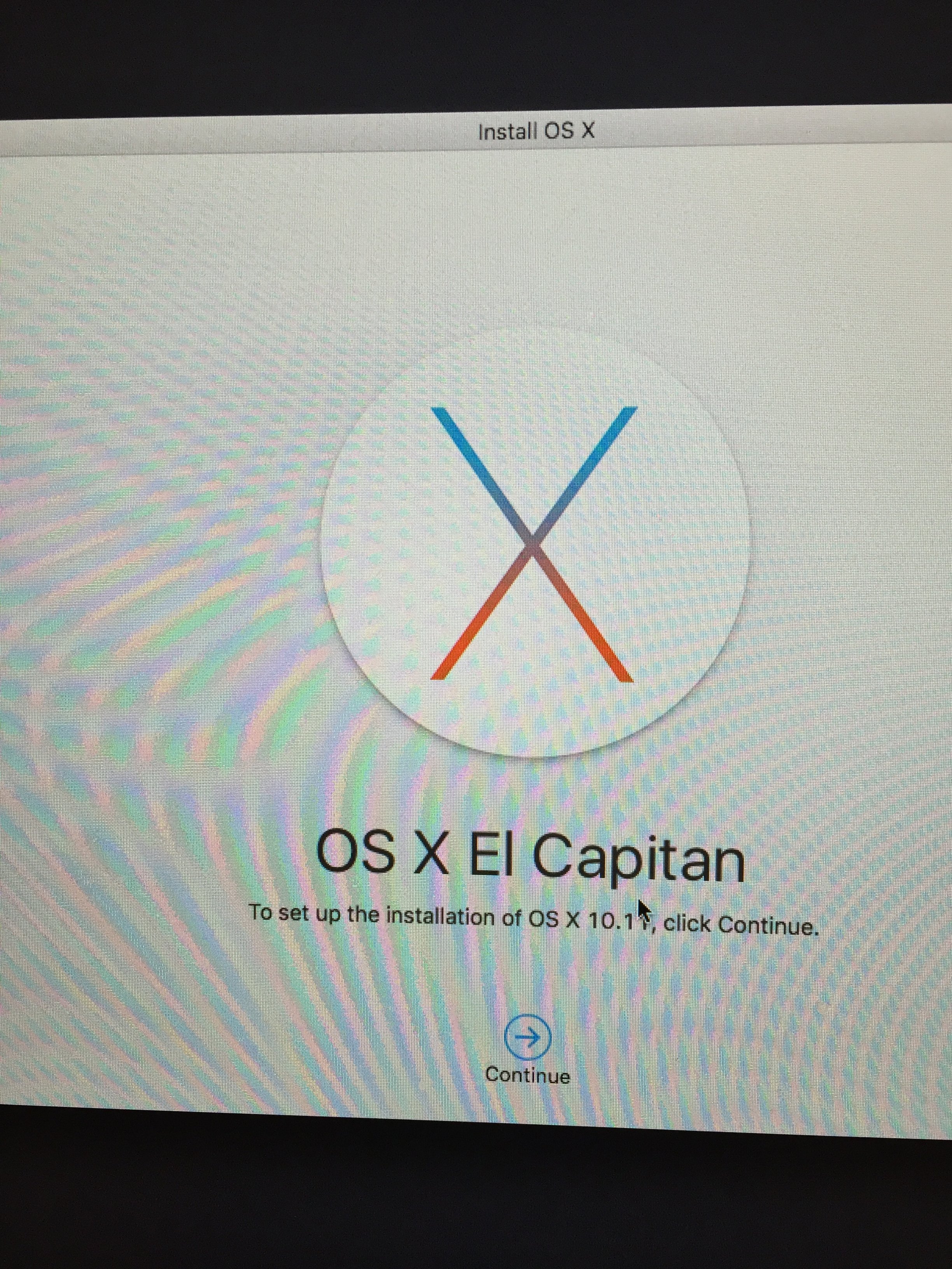

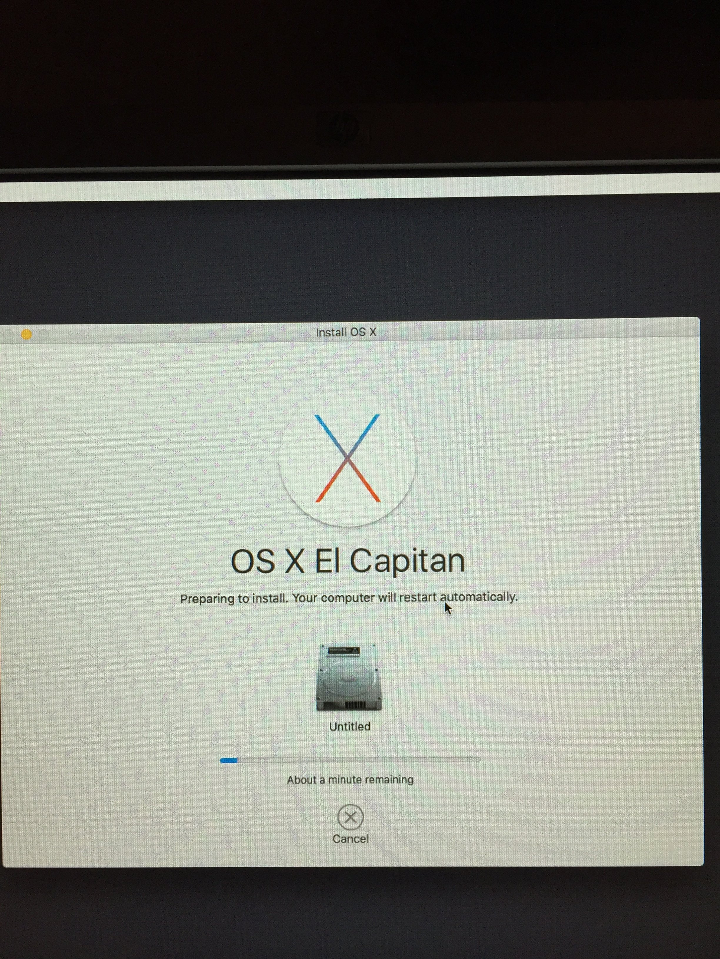

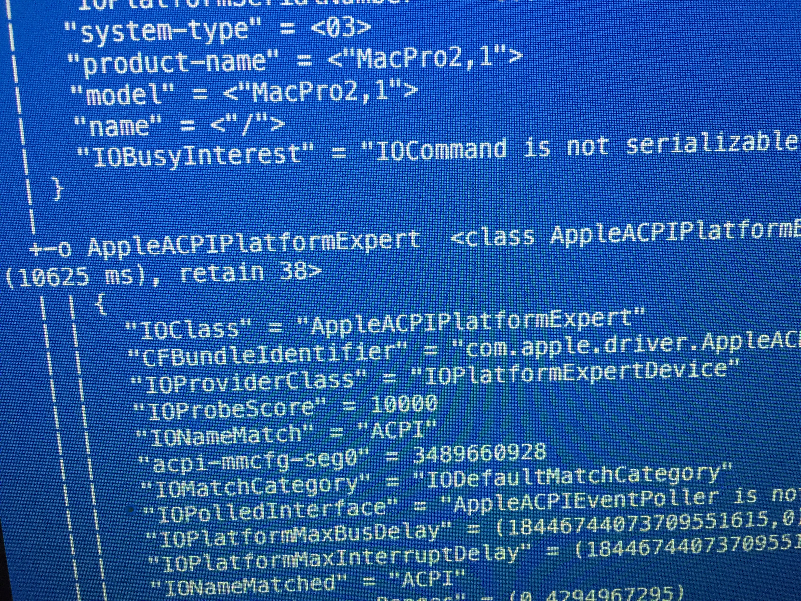

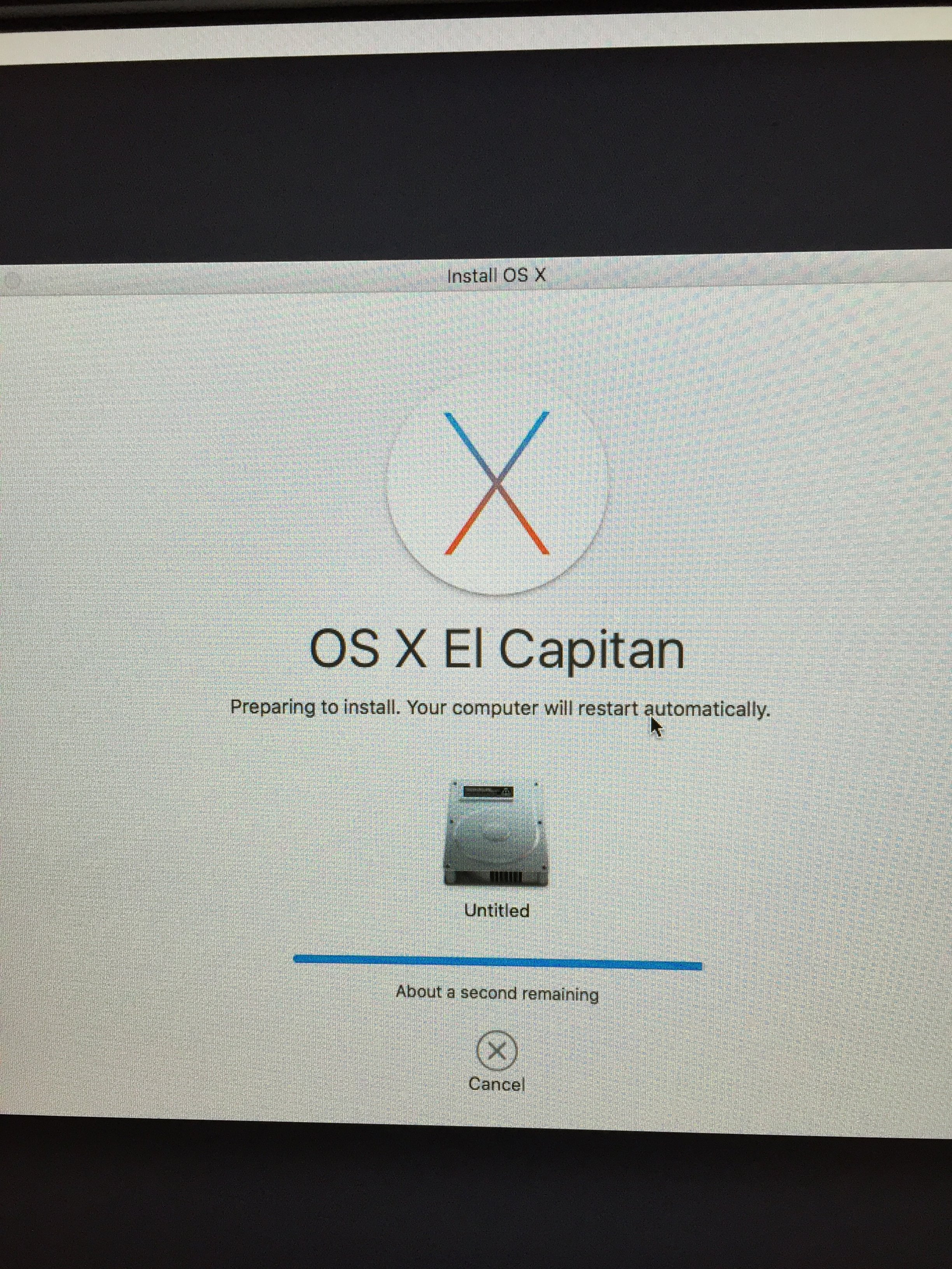

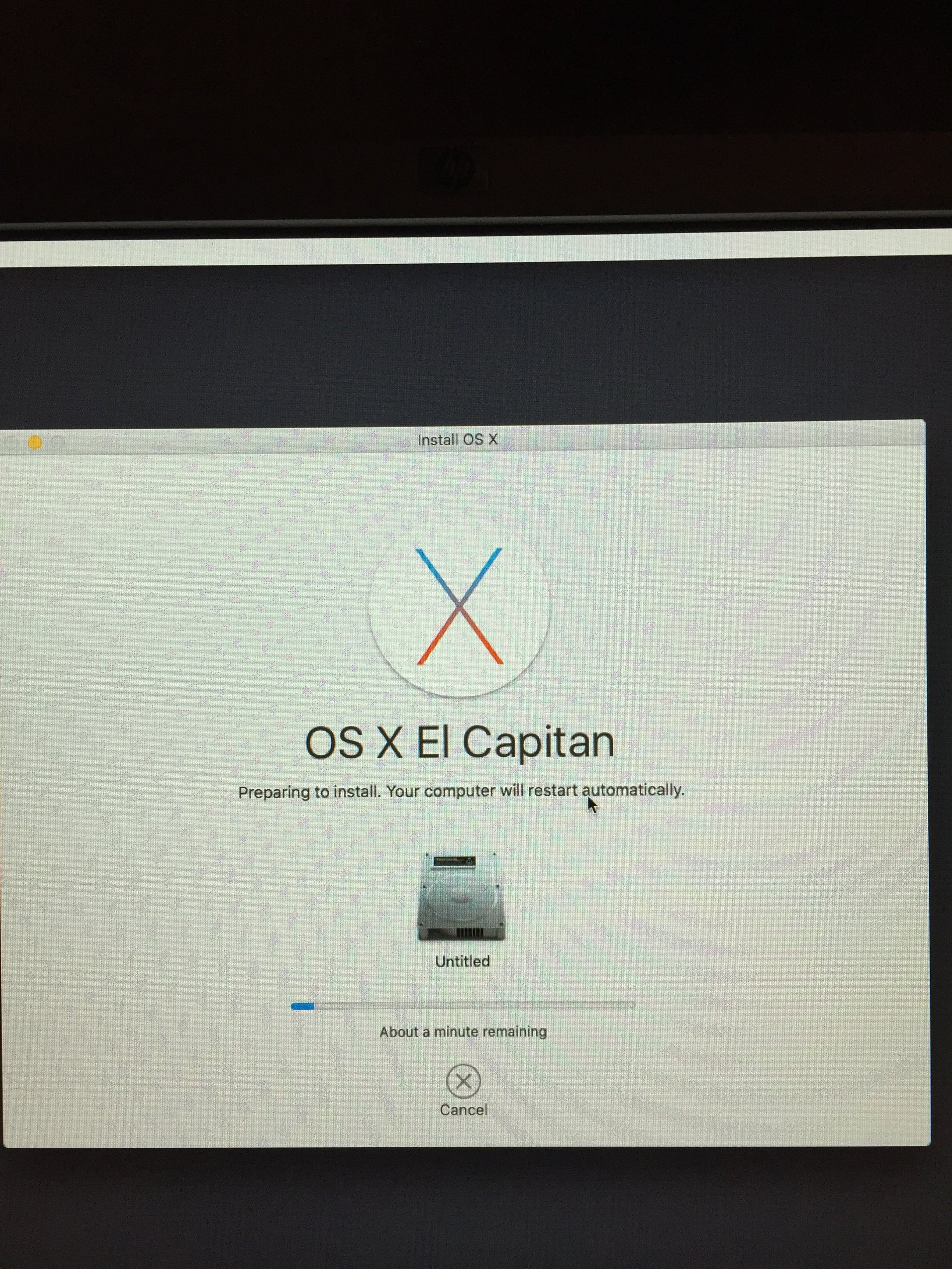

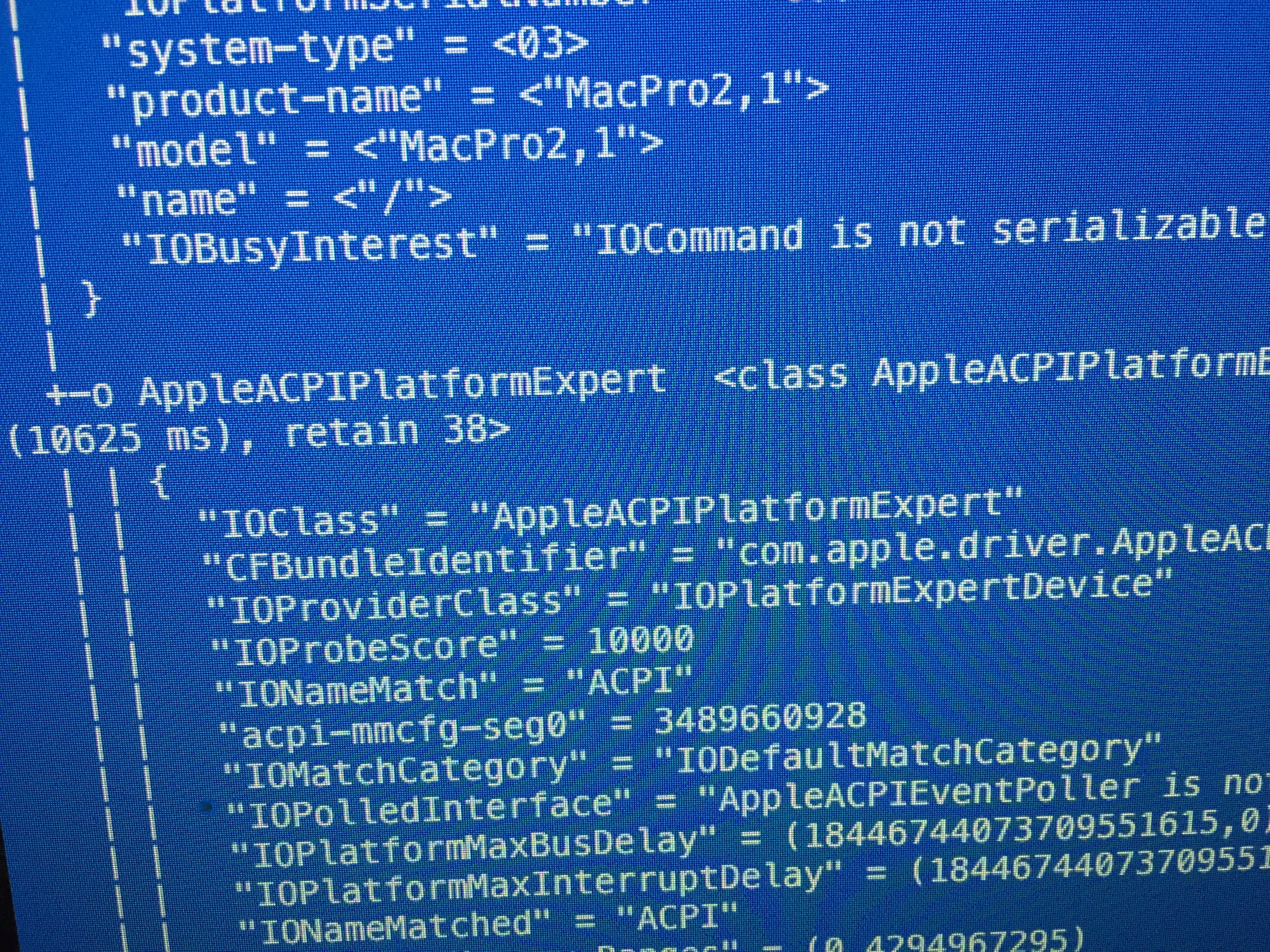

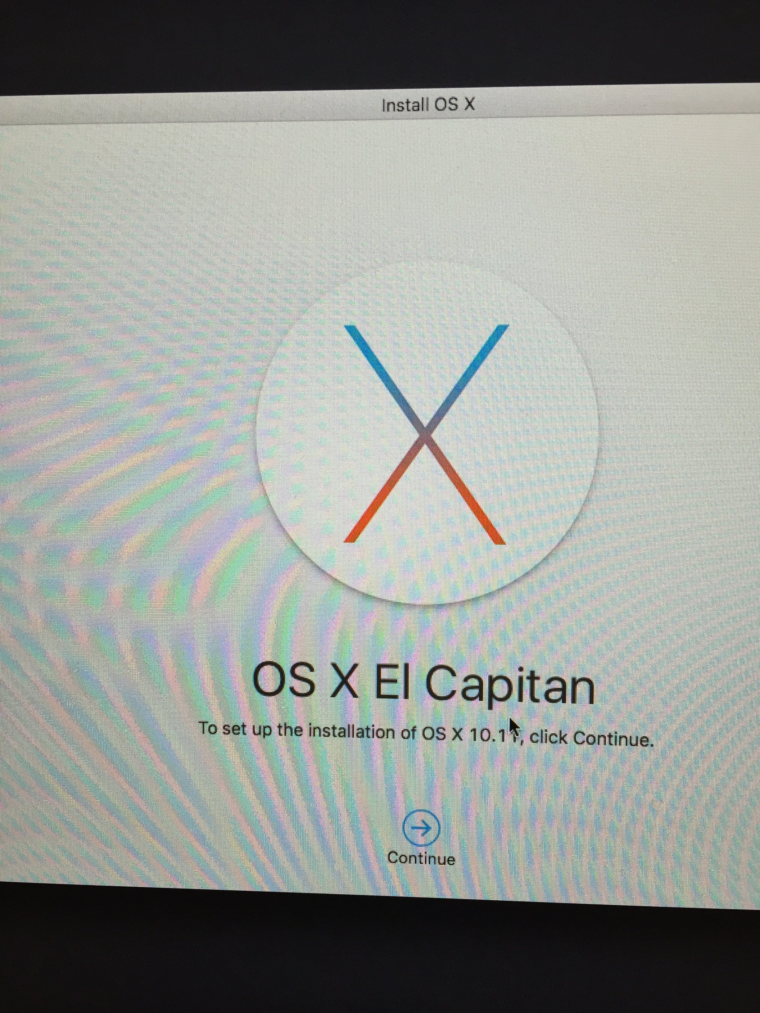

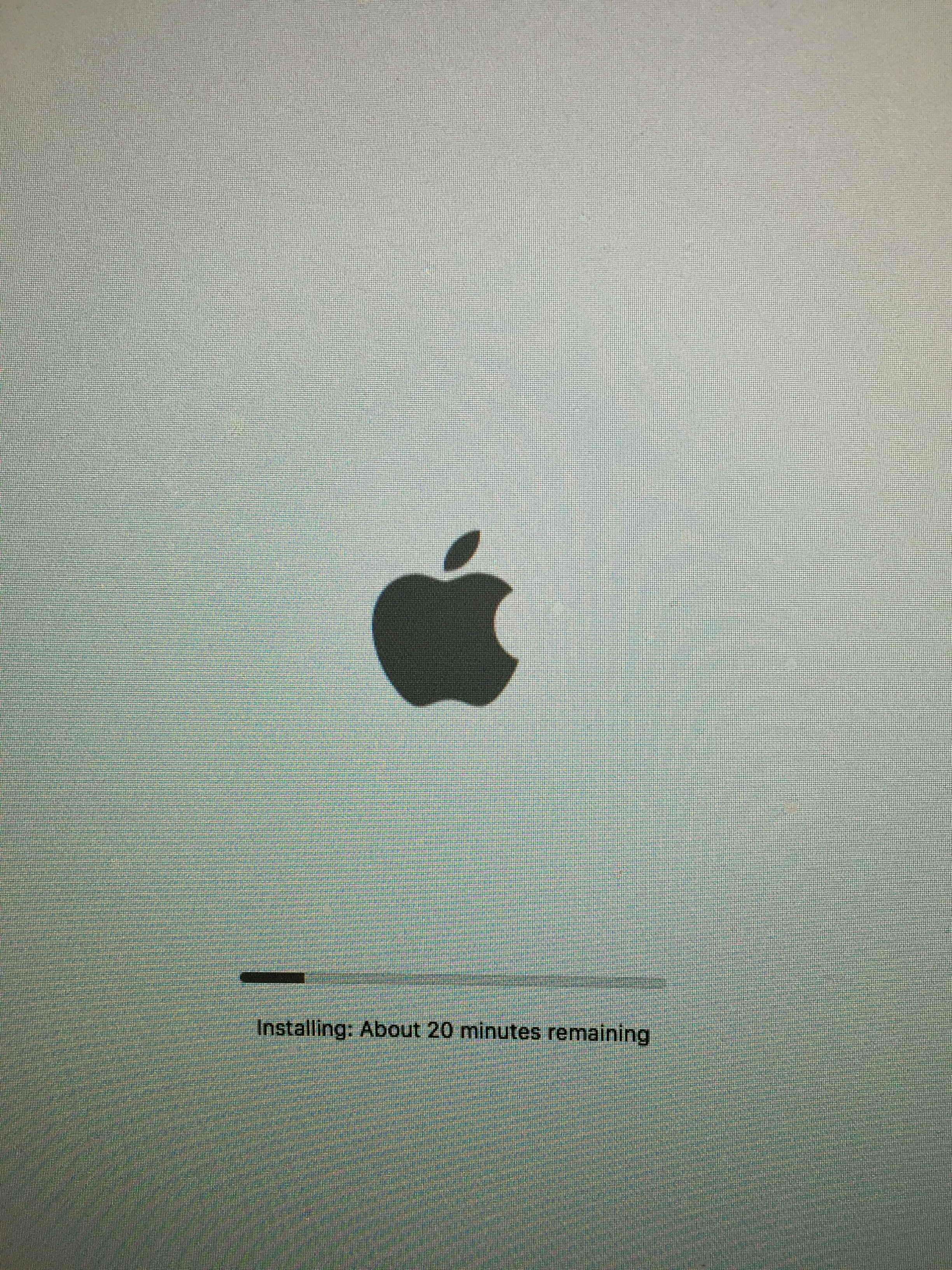

Build 0e193cd, no longer hanging. Reached installer GUI, and able to start the install without the previously encountered error ("OS X El Capitan is already installed on this mac"). Not enough time to completely test the install tonight.

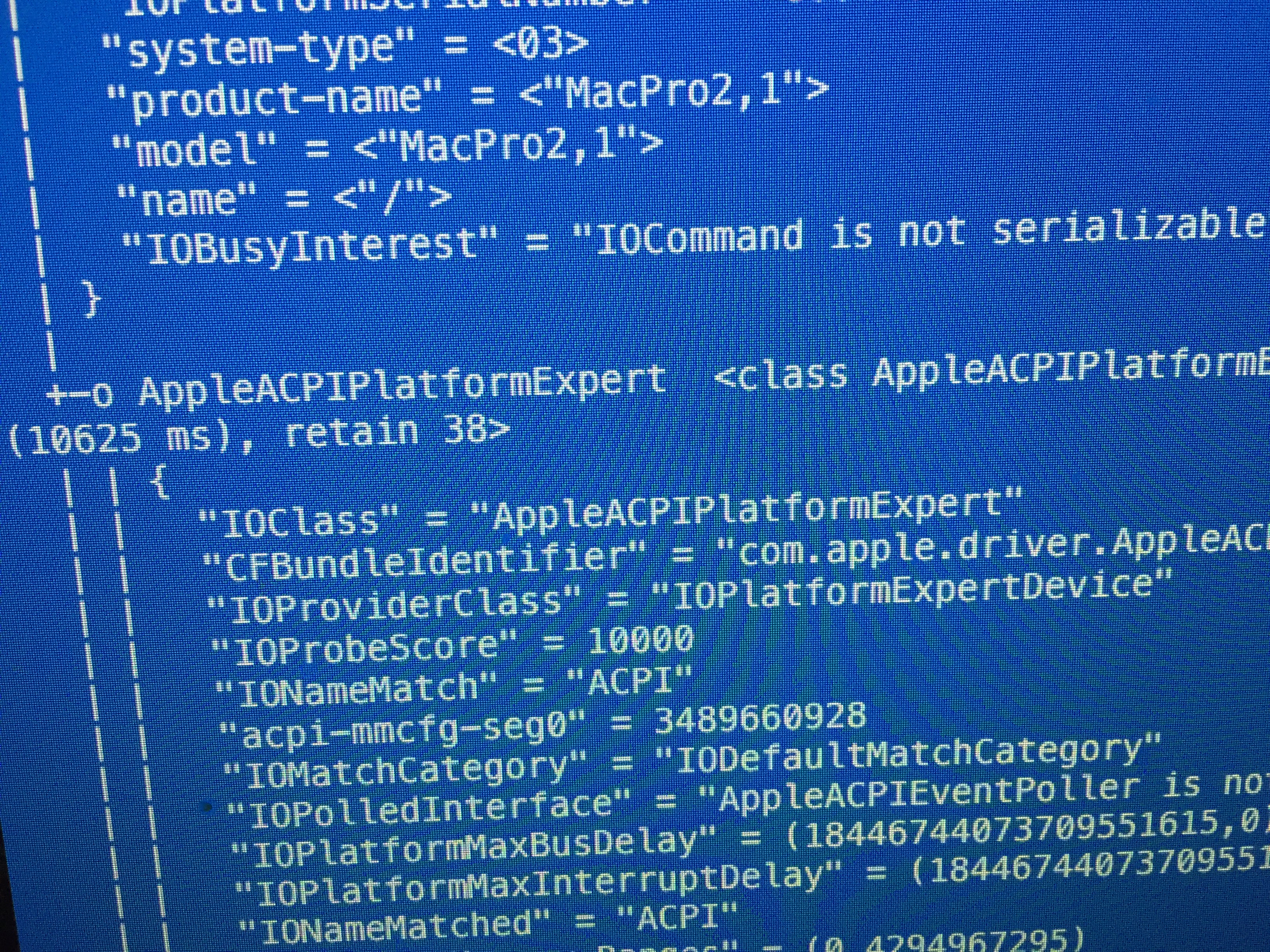

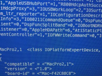

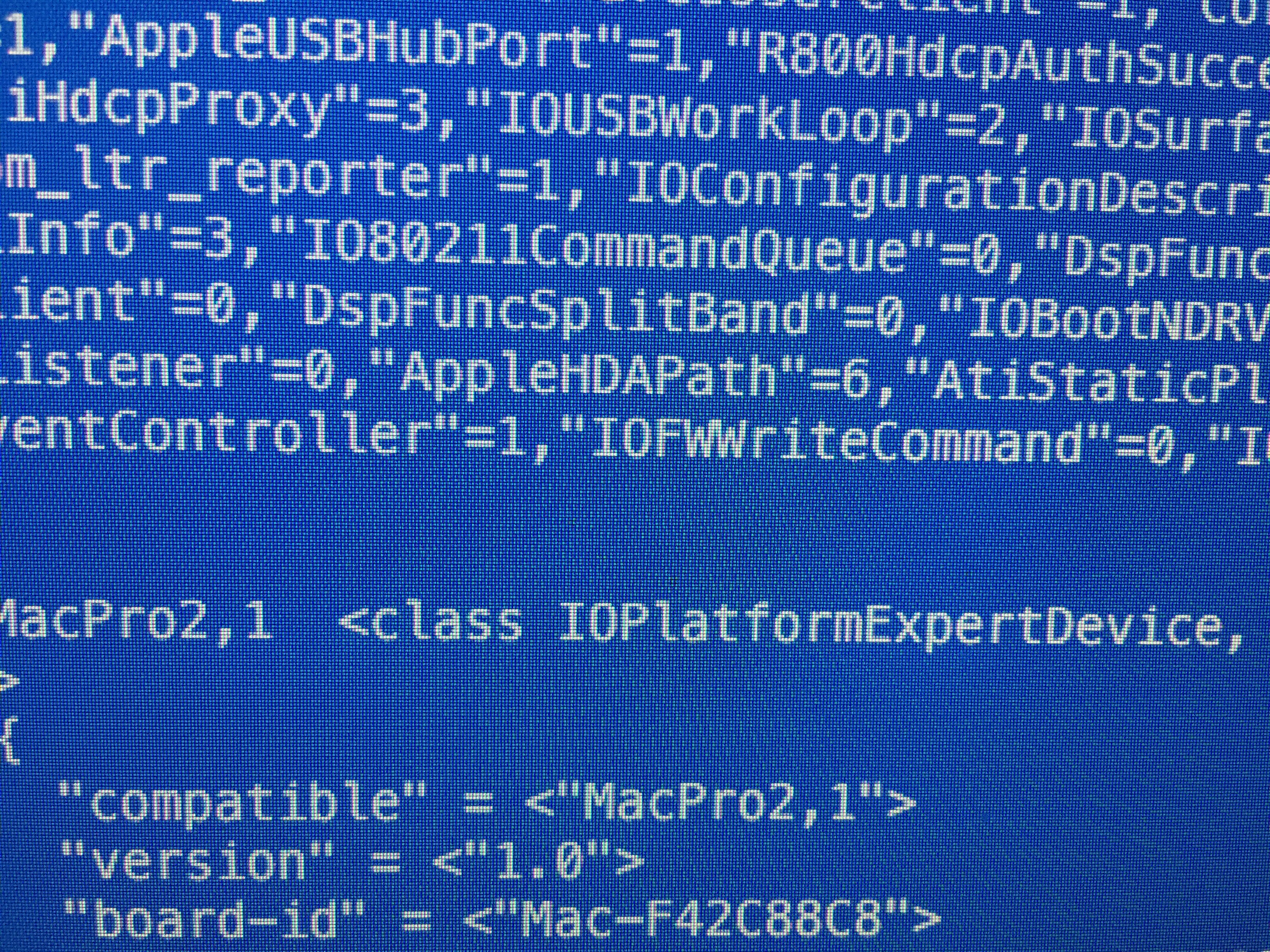

Also, ioreg command output now shows the correct product name, manufacturer, serial number, etc that were previously missing.
Still have "MacPro2,1" as model name, though.

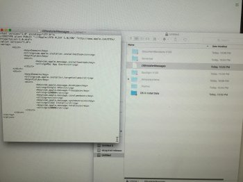

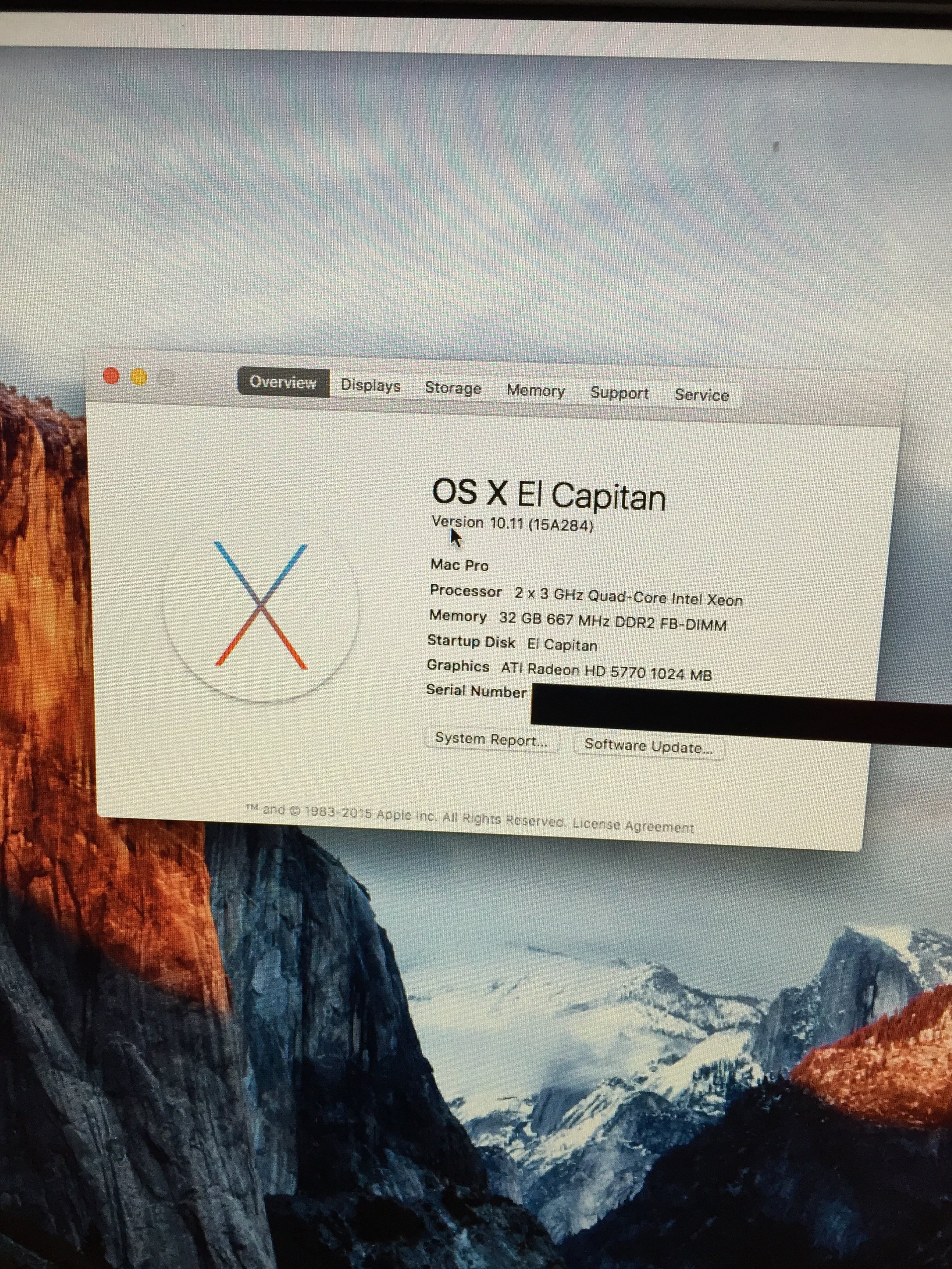

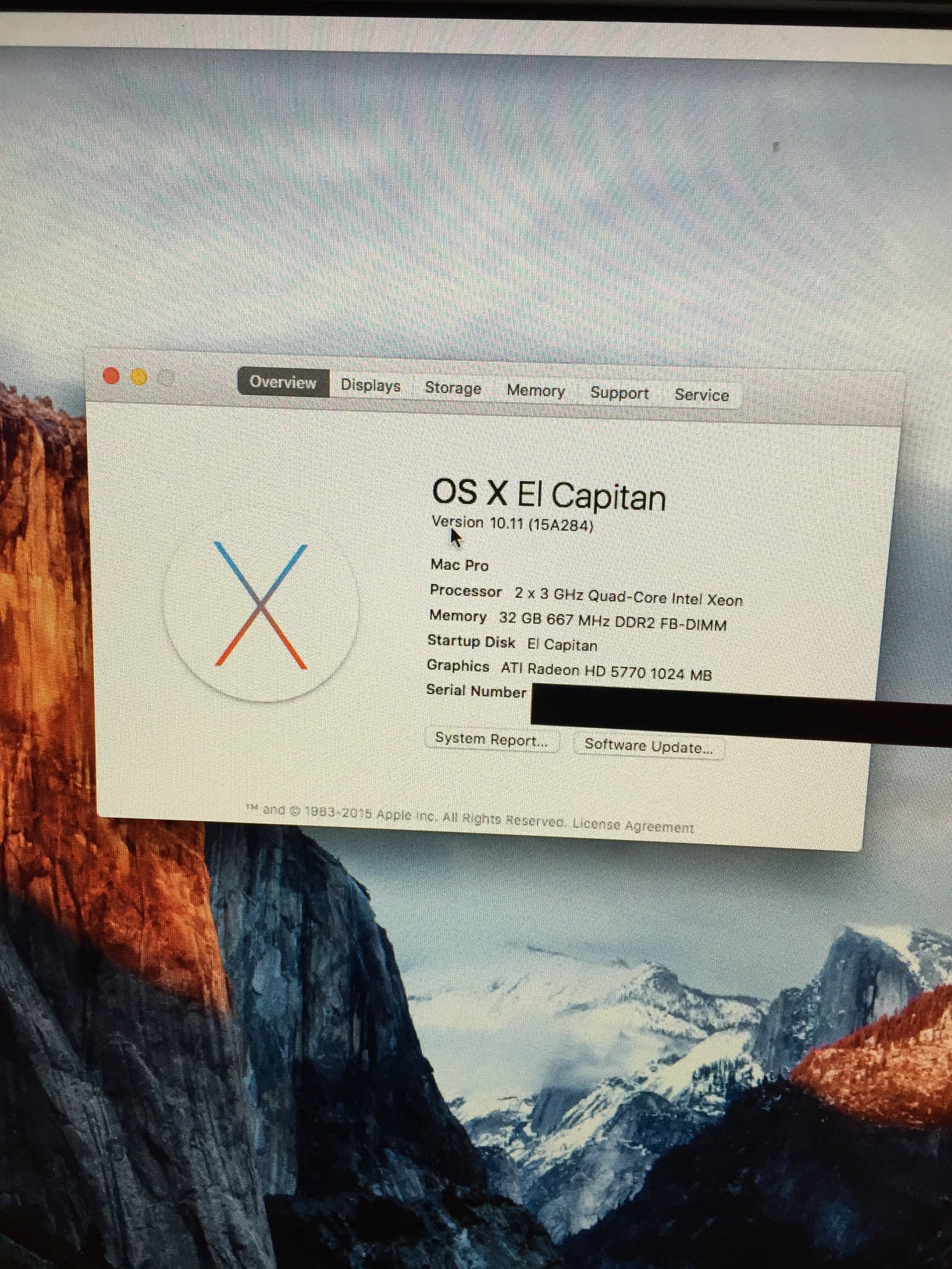

I am finally on El Capitan. Thanks to everyone, especially Pike, Peter and Mike.

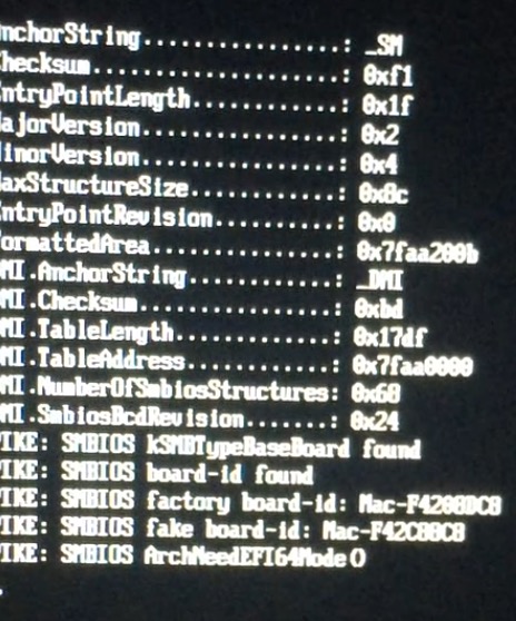

Latest commit worked flawlessly on newly created CIM. I had to replace boot.efi in .IABootFiles on first restart and in the usual places on the finished boot drive.

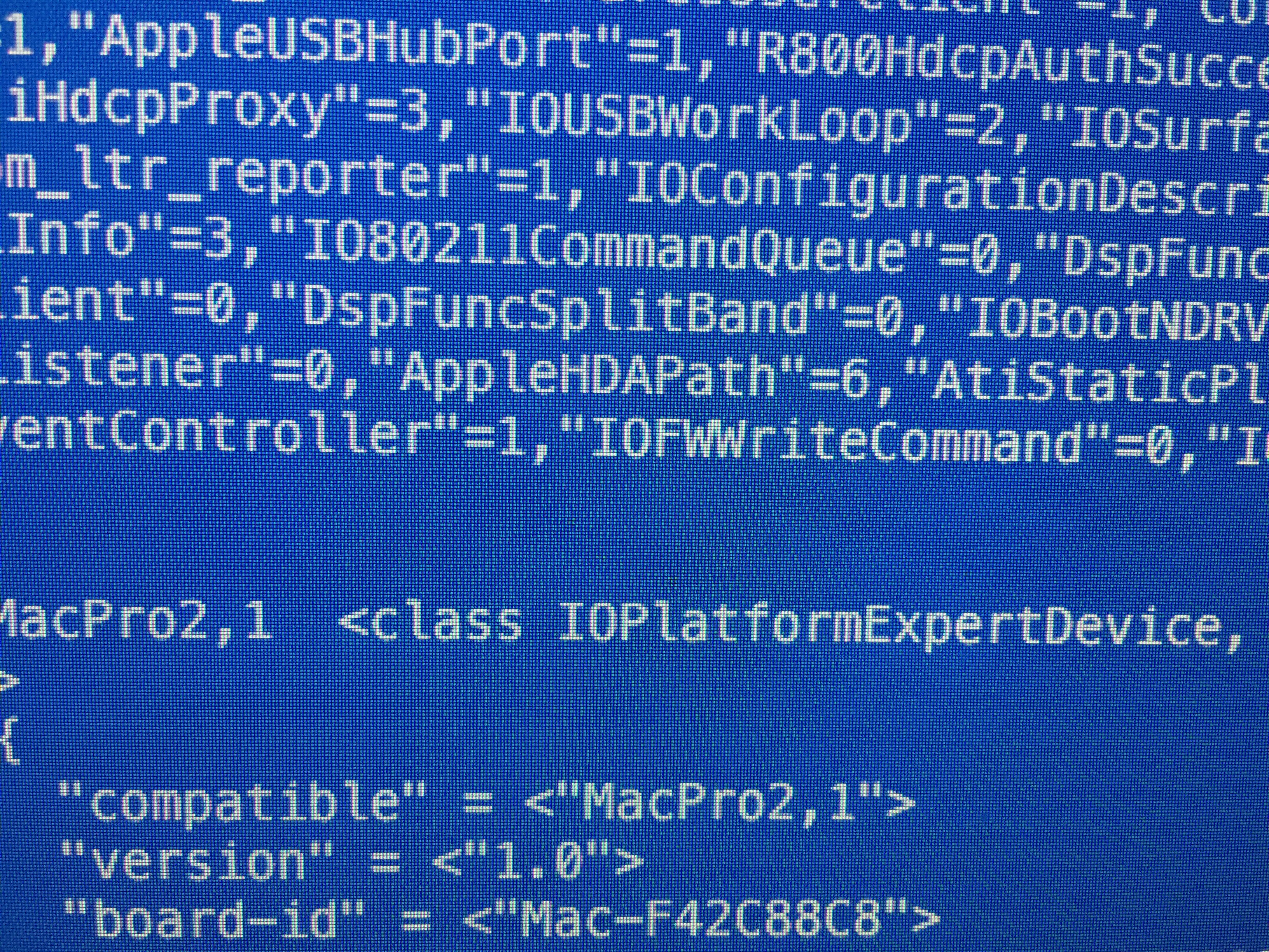

Board ID was changed to Mac-F42C88C8 and is still shown in ioreg.

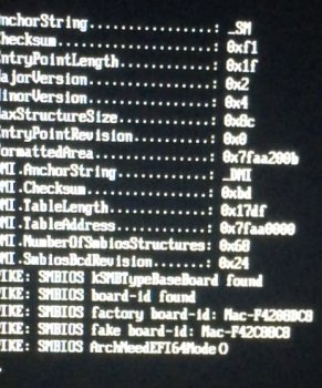

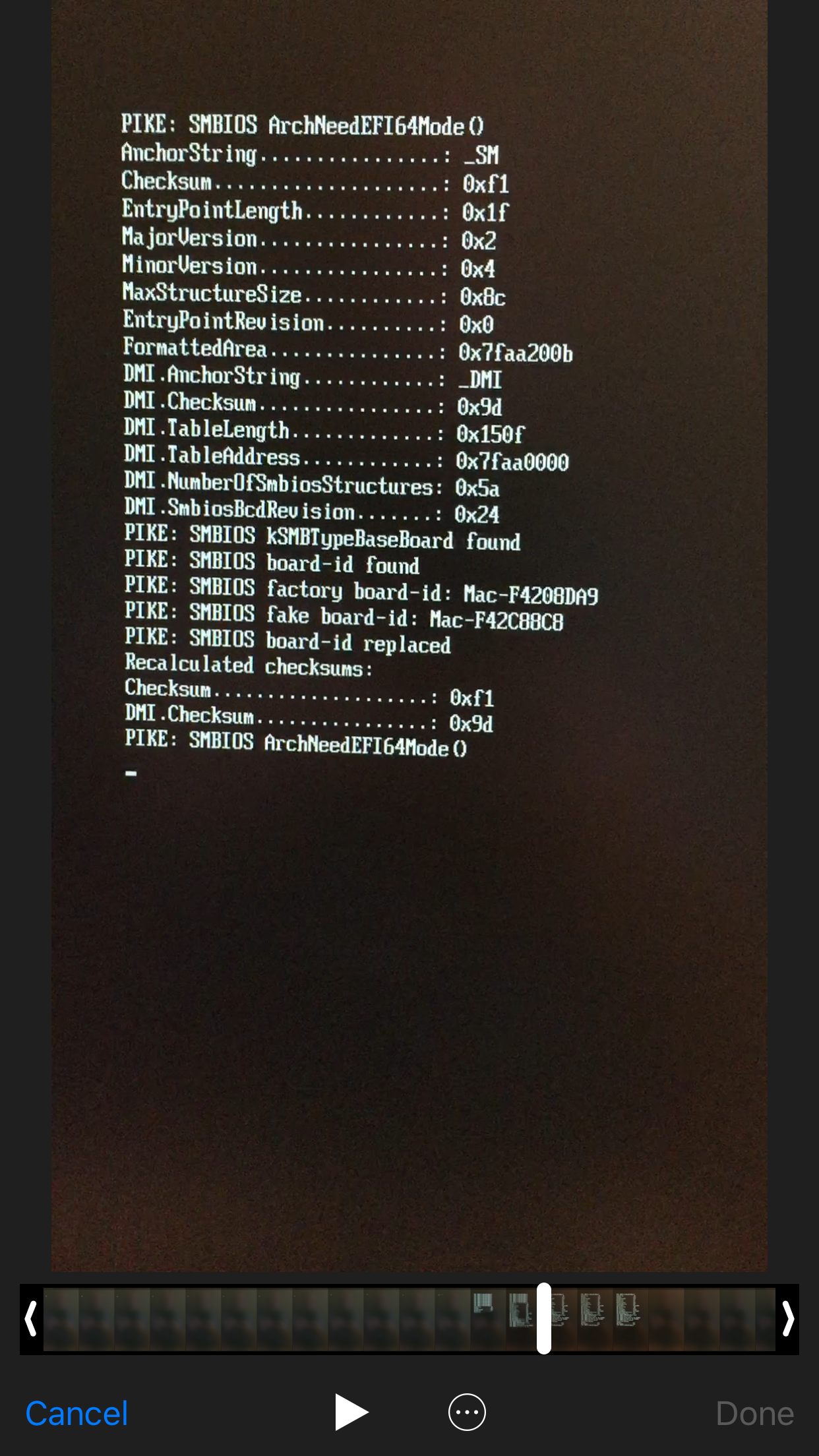

Here is the debug output:
