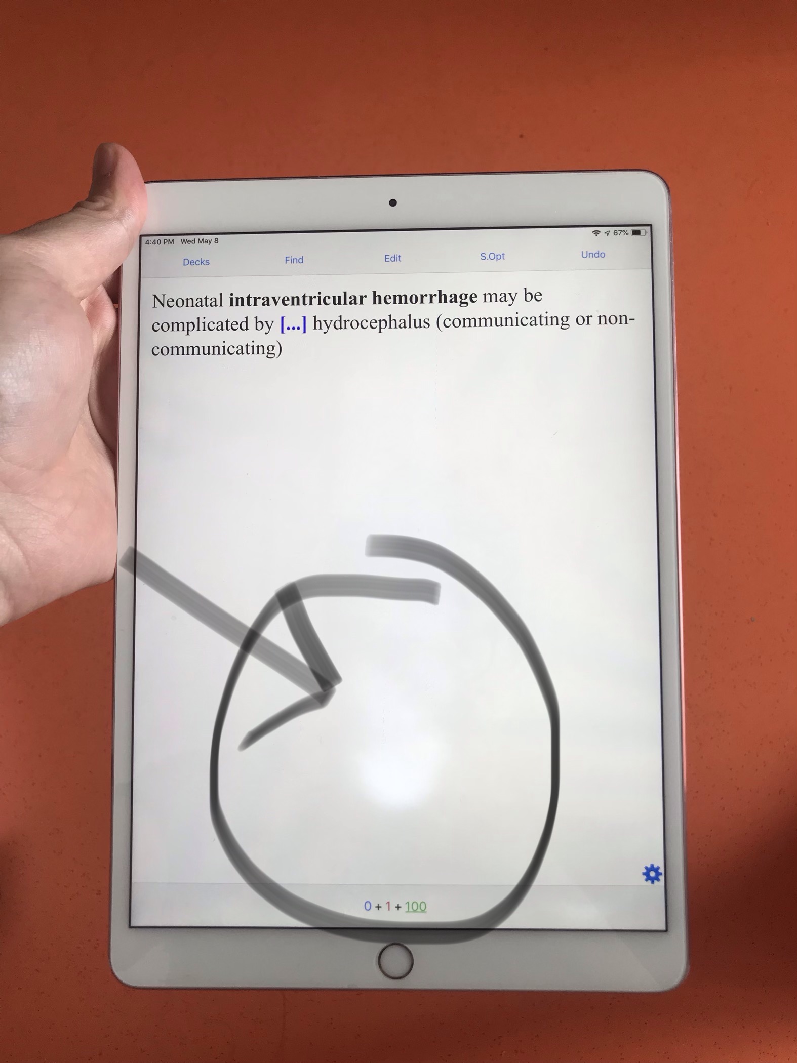

Just found out I also have this issue... Manufacture date was 2017-07-03 and I bought it around the same time that summer. Out of warranty. I really hope Apple does sth abt it... I really don't want to pay the $499 price
