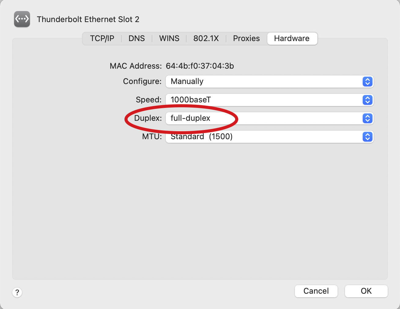

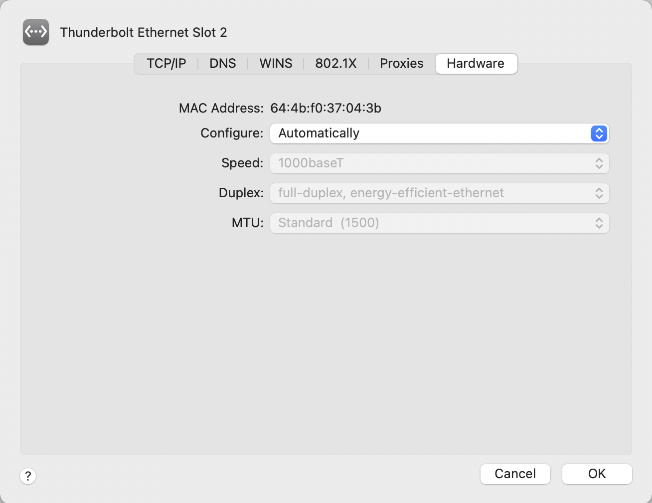

Just a quick heads-up to anyone having ethernet problems. I had no connectivity – my router was assigning me an IP address, but I couldn't go to any websites nor see any local network devices. Tried removing and re-adding the network interface, restarting my router and switch, rebooting computer, power-cycling TS4, etc.
Eventually tracked it down to a default setting of "full-duplex, energy-efficient-ethernet". Switching to manual, and changing this setting to just regular "full duplex" solved it.
(edit: also changed to jumbo frames after making these screen shots :) )
Thank you. This fixed it for now. I had to get it to reconnect for it to allow me to set it to full. I am surprised they do not have any software/drivers to download for this dock too.

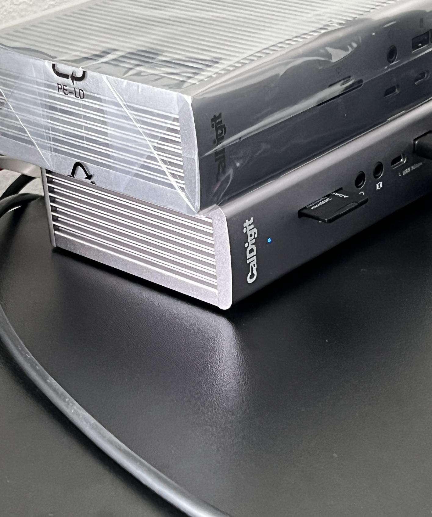

It has arrived. In meetings and todos all day so no time to try it out yet. Gotta keep the TS3+ running all day.
First thing of note that I was not expecting - the TS4 volume/footprint is quite a bit larger than TS3+. Will need to reorg slightly on the desktop I think...
Regardless, looks nice!
