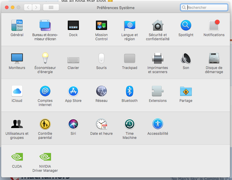

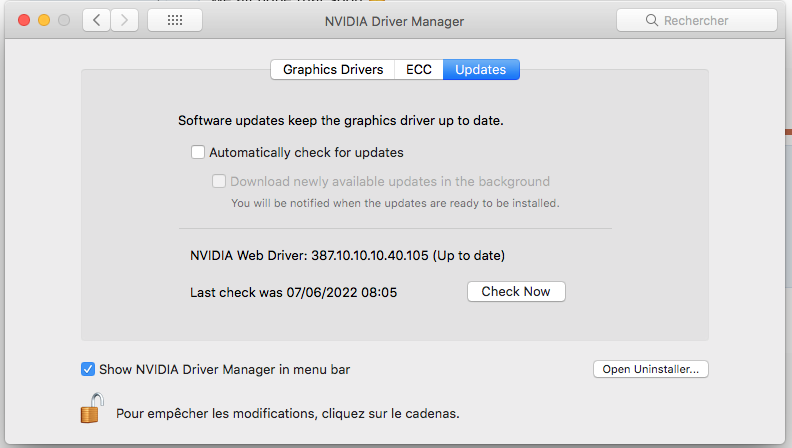

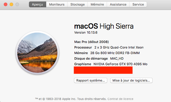

Everything is back but it seems that the graphics and all the effect are very bad . Screen freezing, laggy mouvement etc … no good 😌
should I change driver on 17G66 ? My driver is for 17G65
thanks
Very laggy ... no way to work as it is ... freezing screen, windows flashing etc ... but I get it work

Sorry for my english ? i'm a froggy . I ran HS on a mac pro 3.1. the problem is that I caanot patch the last build of HS because I cannot find it . I'm on 17G66 now. Before the Nvidia driver problem I was on 17G65.
I use the dosdude1.com pacth to make the HS compatible on my mac . It makes you a bootable usb drive installer.
The HS I can donwload is the 17G66 now . No update possible without the patch updater (dosdude1)
I'd love to go to the latest build of HS . But I don't know if my mac 3.1 2008 early version can be patch for that build.
