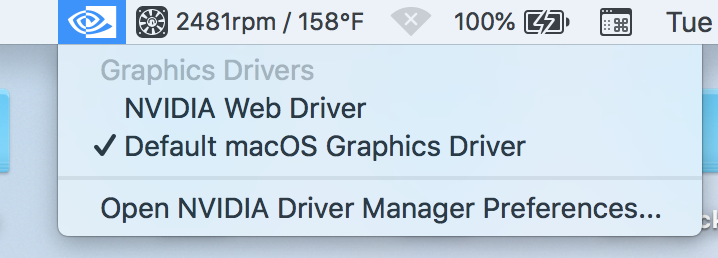

I did as instructed above. It works immediately. Restarted into standard mode, No Connection. nVidia icon is in top menu of desktop.
Went into preferences, nVidia Driver pane opened normal, allowed me to switch to Dedicated nVidia driver, away from 'integrated' Apple driver.

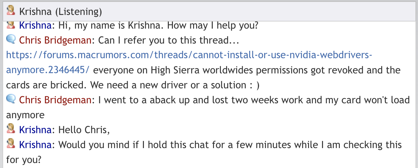

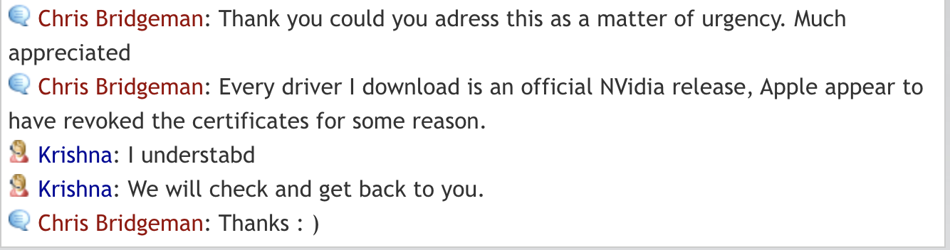

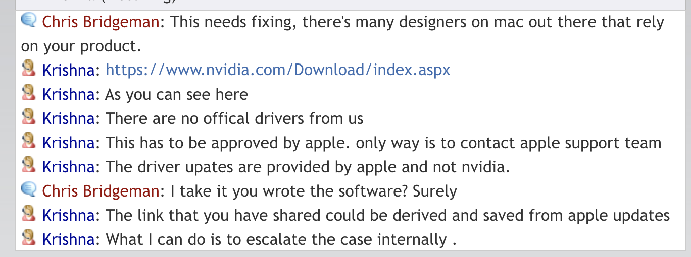

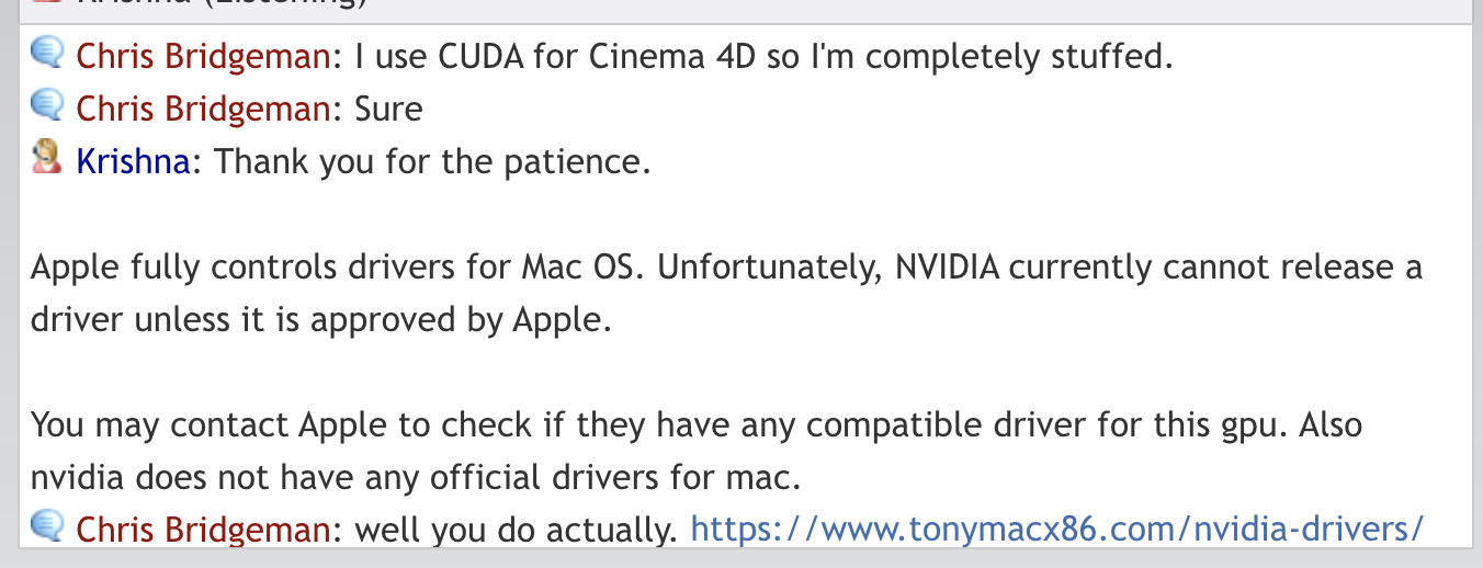

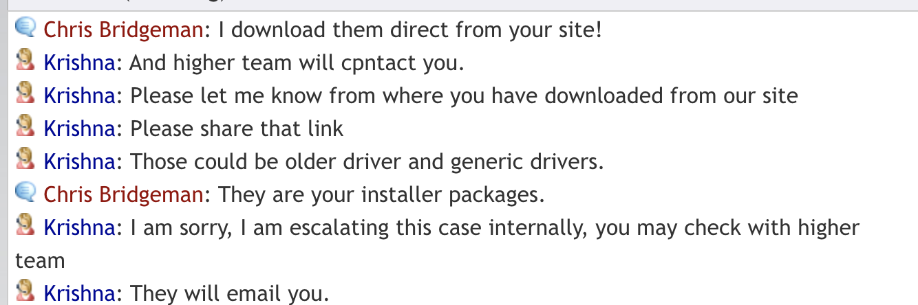

Damn, we are cooked. Even Krishna himself can’t do jack **** about it without addressing his Higher Team,I what on a cosmic scale that might even be?

Dayo
macrumors 68020
Dec 21, 2018
2,257
1,279
I’m confused.
He claimed to have tried the steps and it didn't work.
While I very well know from experience in supporting stuff that what people say they have done in such situations is often of next to no value (logs or it didn't happen is my motto), if he does say he has and it didn't work, then he needs to move on to steps that make sure there is no way anything can be present.
Not something being suggested for everyone across the board; just relevant to his case as it appears he must have the rot running deeper (if he took the steps correctly). Either way, taking those additional actions will definitely sort him sort.
