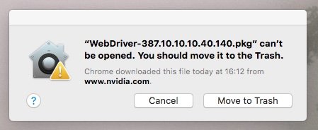

Well I couldn’t fix my main drive which is NVME. I completely gave up on the code signing and the date thing (I never understood why that would work and it didn’t for me).
So I did a fresh install on a SATA and I stupidly tried to run the corrupted pkg from my main drive and was then stuck with a similar message
So I wiped the SATA and did another fresh OS install offline with no other drives inside. As soon as the install was done I modified /etc/hosts following eierfrucht’s earlier post:
127.0.0.1 ocsp.apple.com
127.0.0.1 ocsp2.apple.com
127.0.0.1 ocsp.digicert.com
Then I went to the NVIDA site and downloaded and installed the drivers. Everything was working.
I cloned the working SATA to a spare NVME drive and all fine.
Then I used migration assistant targeting my broken main NVME drive and made sure System was deselected.
So far so good although I do have to reinstall some programs with kexts which aren’t working.

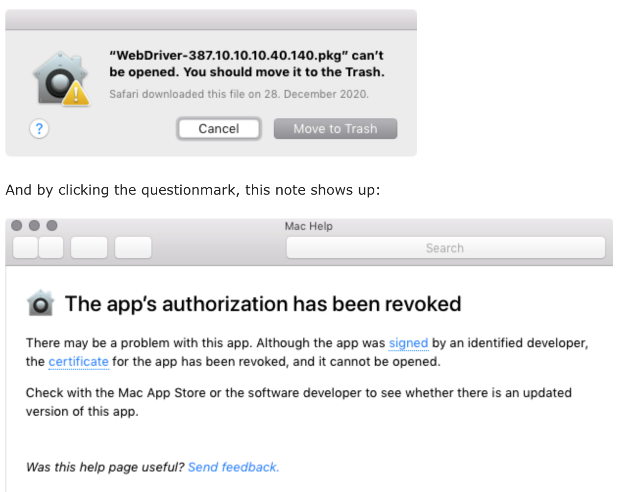

I had SIP disabled, but the code signing (as you mentioned) was useless because the kexts and pkg files in the installed were already blocked by obfuscated local reference(s) to the revocation. Not sure if it was in some hidden db or on the files themselves (since even on a fresh install, the corrupted pkg seemed to spread like a virus).
Date shift did not matter. I tried all combinations but the pkg wouldn’t open because Gatekeeper had flagged it. Removing from Gatekeeper quantatine allowed the pkg to open but would never complete the install because of the deep reference to revocation from one of the inner pkgs (see attached install log screenshot).

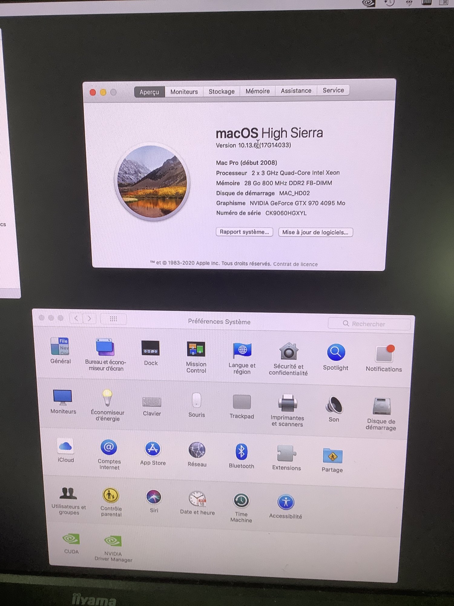

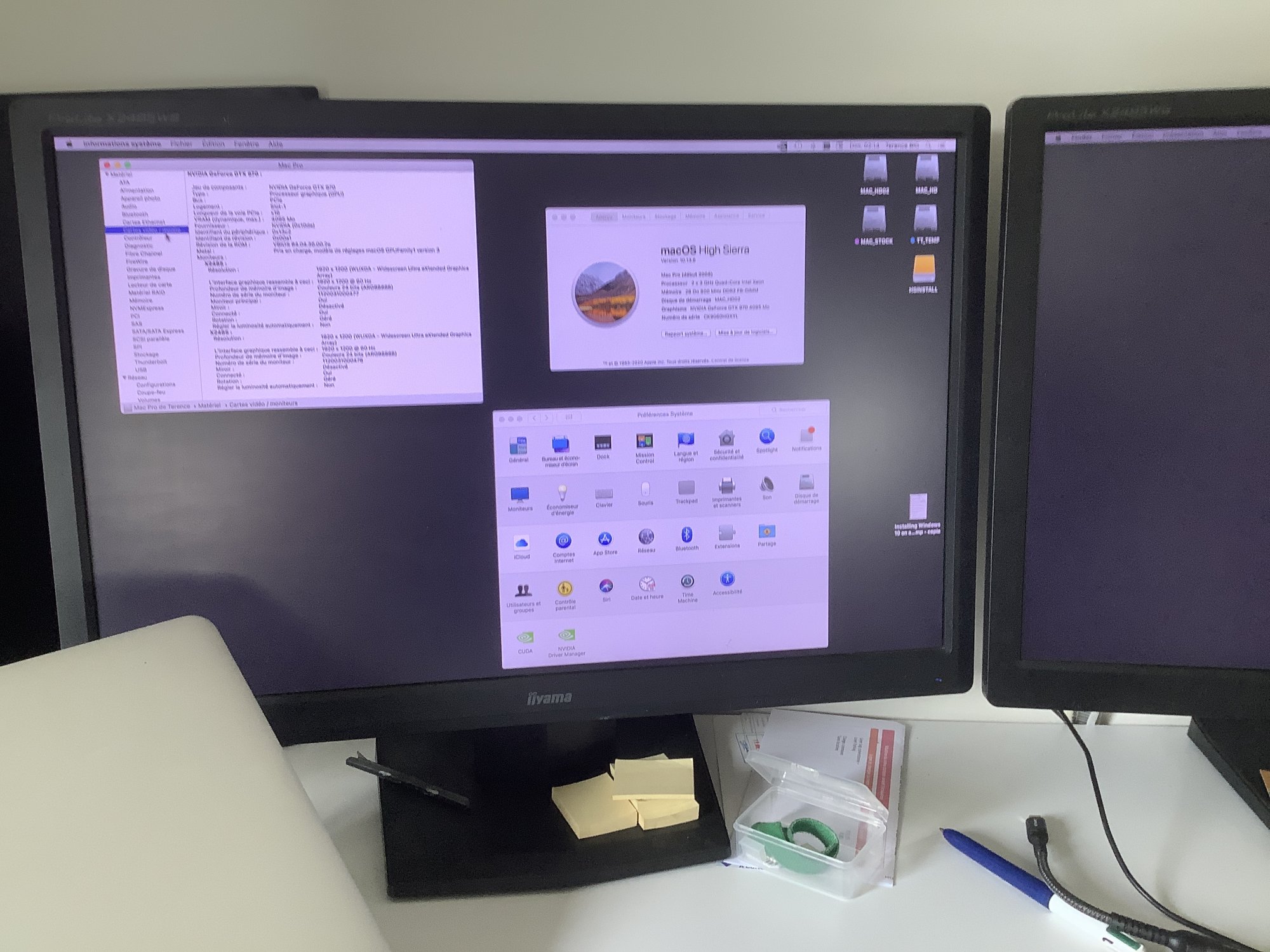

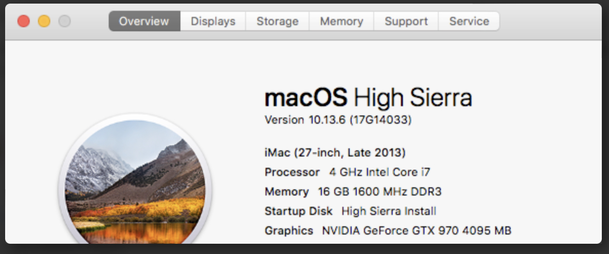

This time I totally succeed , not connected to internet for now . I’m making a carbon copy of the Sata disk on a SSD and then ….
the upgrade to 17G14033 made the thing , and then safe mode etc.
total succès for now . Crossing finger and thanks all of this big team . Gratitude 🙏
hope that other people succeed to
This time I got the gpu acceleration for sure . No more glitch or anything like that
big war for a stupid apple-Nvidia politic f…. Them
Mac pro 3.1 GTX 970 on Hich Sierra 10.13.6 17G66 (at the moment it crashed - Friday 03-06)
NvidiaWebdriver 387.10.10.10.40.105
Then I've tried many of all the things with that osx build but no way to solve it( 2 days) Laggy screen on 780GTX( supported but bad)
And I decide this morning, to make a copy of my boot disk and tried again an update for the HS. This time it succed
and i could patch it with the dosdude patcher ( booting on the dosdude usb drive patching and reboot) HS : (17G14033)
Boot again in safe mode and I've done all the process here:
, removed also the old nvidia webdriver and cuda.
With the script Takoviej mentionned, I cleaned the kext cache and other things
Installed the new webdriver and cuda for my build 10.13.6 (17G14033)387.10.10.10.40.139
Boot again
and voilààààààà 😉 😎

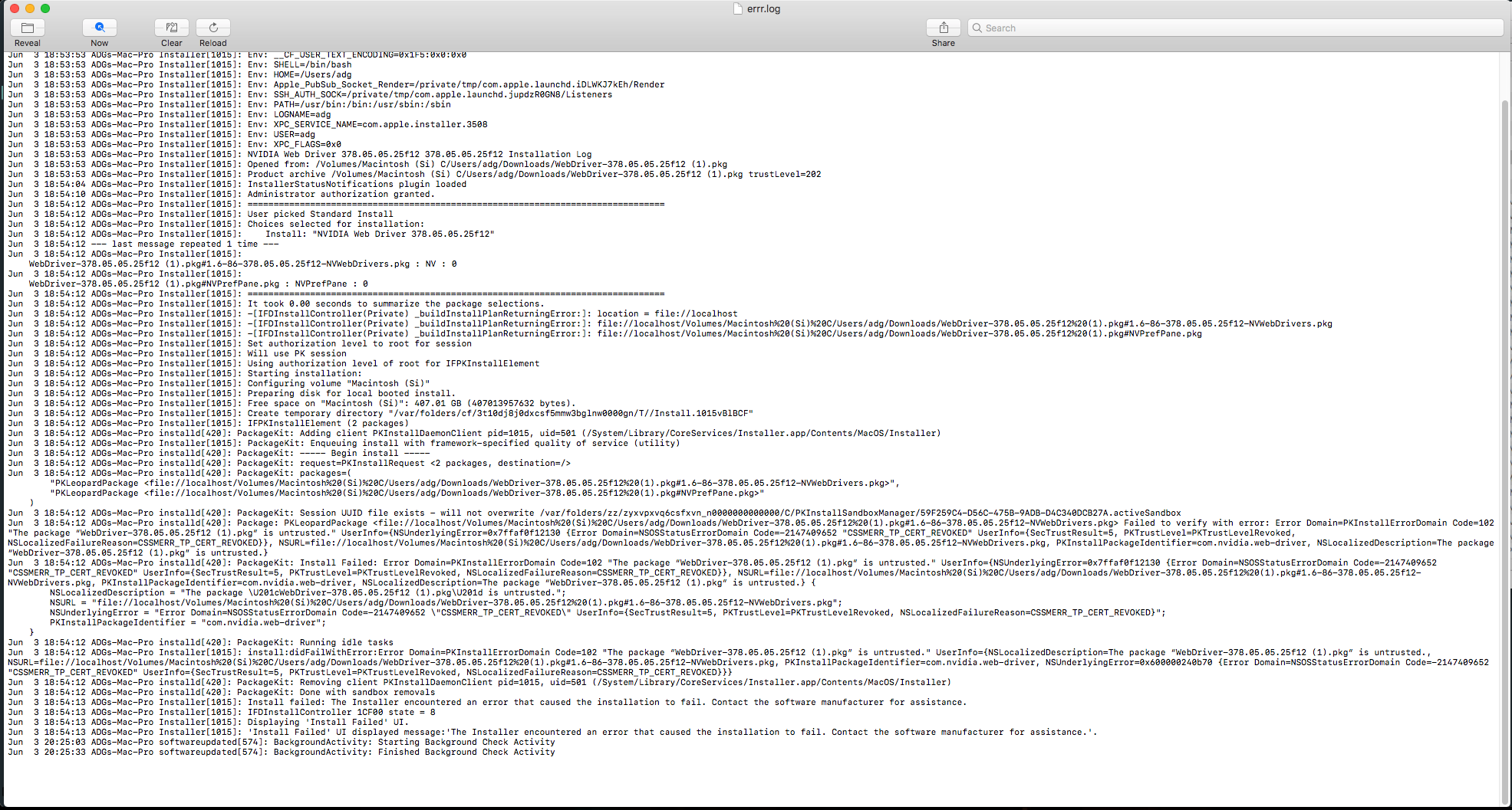

Apparently, when a pkg file is being installed (or at least some pkg files), the installation is done in a sandbox and in this case, the Certificate Revocation status is stored in an associated System-Access-Only folder here: /private/var/folders/zz. I haven't been able to look into the files there in detail but I am sure it includes other items or hashes that identify the file in question; which I assume is why the cert stripping attempts did not quite work as expected.
It is actually a temporary folder, a cache, but manually flushing it is definitely a bad idea as some items appear to sit there for a long time.
Every time you try to install the same file again, it hits this info and halts.

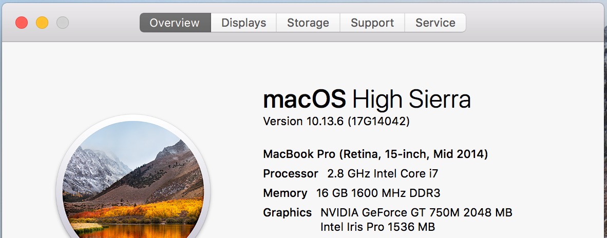

Yesterday, I reported this issue with CUDA drivers, and I'm still waiting for the answer. I hope they can fix it because their team is working on it.
I strongly suggest everyone report all the issues with NIVIDA drivers. They know about this issue and can see this thread on this forum. However, I'm not sure if it's enough for them to give this issue a high priority.
Nvidia chat
No, have issue with the nVidia Webdriver 387.10.10.10.40.140, and same as everyone

You are all removable cards world, I am MBP with internal nVidia GT750M.
I use the nVidia WebDriver to 'accellerate' my GT750 healthier than the Apple drivers. There never were any 'built-in' nVidia drivers for OS 10.13.6
I reset my NVRAM and SMC as had not done in long time, and machine had been running for a month straight.
Torrents, Blender, just dirty in general. Cleared Firefox browser cache, restart, was still slow, restart PRAM/SMC to be all nice and clear.
Was obviously a BAD Call.
I cannot find any of me with this problem. All I can find is you Pro guys (who are totally focused)
In regards to what is said above, and reading ALL of the 236445 thread link we are within I can say...
I had a spared MBP 2.8 with same GT750M, it was OFF before this started.
I started the machine yesterday June 6 , NOT Interwebs connected, waited 3 minutes, then connected Internet and all is fine.
Ran a draining Russian, over coded, crap, MMOG and the GT750M keeps working.
Shutdown, phsycially disconnected Cat5/6 cable, restarted, waited 3 minutes, plugged in Cat5/6 to router, and again all works OK.
I have not tried the 'solution'
(https://forums.macrumors.com/thread...idia-webdrivers-anymore.2346445/post-31142878)
that looks to have worked for most on the other thread as I am not a MacPro with removable card like you guys.
It is obvious that the Restart Connected is the issue. Regardless of Certifications, or kexts, etc.
I hope this helps someone make a decision in importance of what 'sudo' order is appropriate to fix this issue.
Or if the

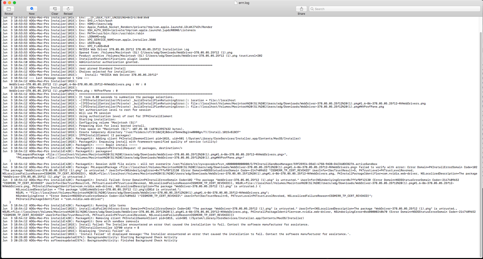

Been looking at things trying to understand what was happening with the varying outcomes seen and think I have finally figured it out.
It appears that there are two broad categories people can fall into:
  1. Those that did not try to reinstall the web drivers when they noticed issues
  2. Those that tried to reinstall the web drivers when they noticed issues
For those that did not try to reinstall, recovery was/is as simple as blocking OCSP (adding ocsp.digicert.com appears to be a red herring and it is the Apple one that apparently matters), clearing the OCSP Cache in /var/db/crls, rebooting and Bob's your uncle. You could do the date shuffle just for making sure all is ship shape.
Those that tried reinstalling however, simply dug themselves deeper in the quicksand and it needed a bit more to get out of the mire.
Options to get past this are (After blocking OCSP, going offline and clearing the regular /var/db/crls cache):
  1. Reinstall the OS and migrate your system data over. This apparently does not bring this cache along.
  2. Run a tool such as OnyX and hope it clears this cache
  3. Revert to a backup from before the sandbox file was created
  4. Reboot into Safe Mode. This apparently purges this cache
  5. The delete the contents of /private/var/folders/zz manually and hope you can still boot afterwards
Important thing is that OCLP should be blocked before any fix attempt. Best to do any fixes while offline.
I will update The Post on Page 4 Presently
