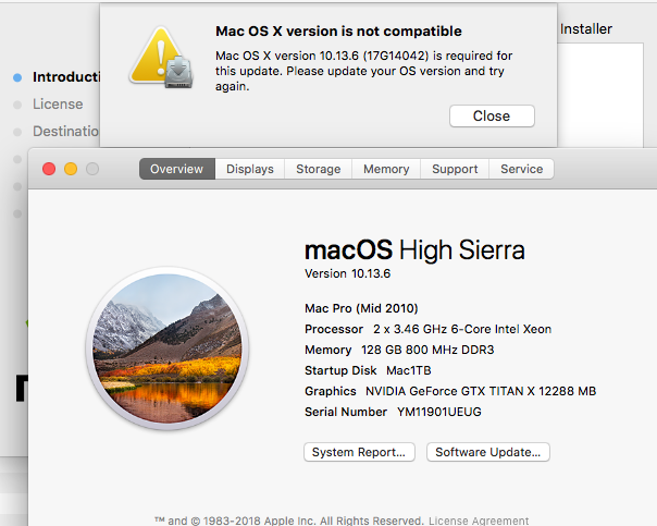

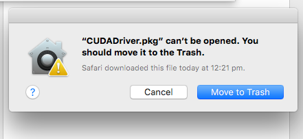

@Macschrauber @Dayo Ok.. so I used the automated scripts with the disabled SIP as per instructions .. I also upgraded to High Sierra 10.13.6 .. but I am unable to install Cuda.. or the MyWebDriver-387.10.10.10.40.140.pkg. .. would anyone know why this is happening.. When I try the package its saying I need to upgrade my High Sierra to 10.13.6 but that's the version I am already running.. I am also unsure if the Nvidia + Cuda drivers in High Sierra support the Pascal Titan X & 1080ti which I have been using ( were working ) w external power source, until things broke last week..
It is not only 10.13.6, but the other number should also match. There are many 10.13.6 versions.
You need to install all the security updates for 10.13.6, that will upgrade you to the version that is compatible with .140

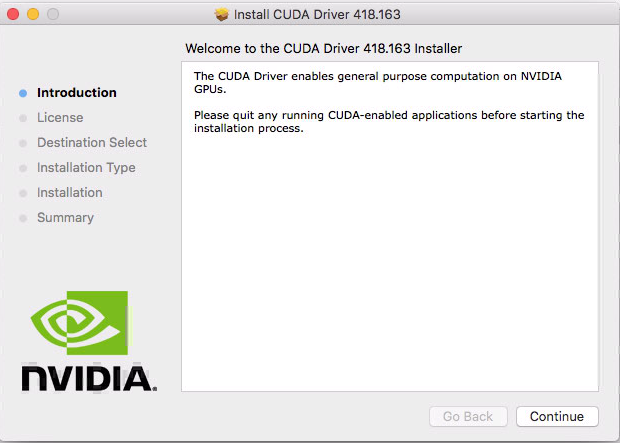

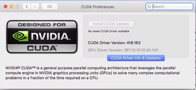

Ok! So it Seems I've gotten the Drivers to work with the security 2020-06 updates.. One final question. It looks like the GPU is now working w Drivers only - Not asking for the CUDA install as per what SIERRA used to do ( needed to install drivers and matching coda separately ) .. is this correct? Or will it prompt an install of CUDA later.. I'm very happy if I don't have to and it just keeps working.. + Huge Thank you to everyone for getting everything working again!
Rename the cuda driver package to match the Webdriver name and run the mod script over it.
Then start the modded cuda driver pkg.
I can make cuda driver mod script later or you edit it by opening the script with the script editor. Its just changing the name of the .pkg.

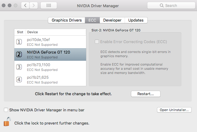

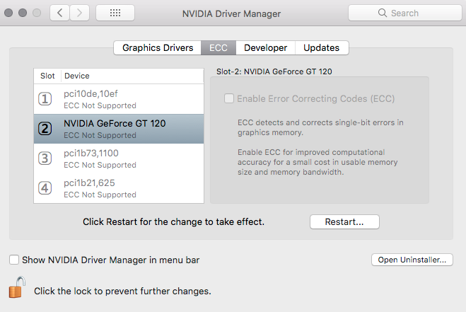

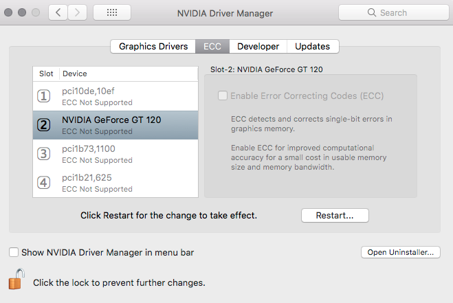

Thank you! This worked for me in a way that Nvidia Drive Manager appeared back in System Pref (I uninstalled it a few days ago) but it only shows Nvidia GeForce GT 120 (which was working the whole time). It doesn't show my main graphics card Nvidia GTX 1080 8GB, 2560 CUDA Cores (PCI slot 4).
What to do?
Do i need to install some other driver?
Thank you for all the support and wisdom!
The only nvidia cards that are supported by macos are the gtx 680 family (and those only up to Big Sur).....the others are not compatible anymore.
What to do?
Hard to say for certain from the info you provided, but it sounds like you simply need to re-instal the NVidia web driver.
What I said now applies to High Sierra as well, the drivers that previously worked do not work anymore...
This whole thread is about making the NVidia web drivers work for some specific NVidia cards. It’s not correct to say they don’t work anymore. These workarounds have worked for a lot of people, and I have made many systems work. A couple people have “reported” even getting a web driver directly from NVidia that doesn’t have the certificate issue. But also you are wrong. the web drivers still work perfectly well with Mac OS 10.10....and might with some other versions as well(I have only tested 10.10). There are also some NVidia cards that work natively without the need for the web driver(in which case they are still happily using their systems right now)...it’s highly complicated, but there are many guides on the internet explaining which cards are natively supported without the need for the web drivers...and of course it matters which version of the Mac OS you are running.....You have to research which card, which OS, what machine you are running....but in general...as you go above 10.13, extremely few NVidia cards work..all the way up to basically none.
