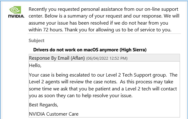

Yesterday, I reported this issue with CUDA drivers, and I'm still waiting for the answer. I hope they can fix it because their team is working on it.
I strongly suggest everyone report all the issues with NIVIDA drivers. They know about this issue and can see this thread on this forum. However, I'm not sure if it's enough for them to give this issue a high priority.
Nvidia chat
They should give it a high priority, otherwise it is going to be very bad PR for them because of a lot of very unhappy customers.

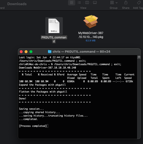

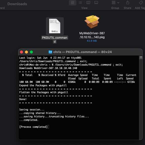

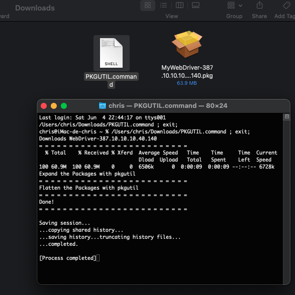

I remove certificate of this Package from Pkgutil command
but I can not test because I have no Nv card then No High Sierra 10.13
The command will downloads WebDriver-387.10.10.10.40.140.pkg then Unpack, repack
make sur you dont have the package in downloads folder, and Files folder because it will be deleted.
there is the script code
Code:
#!/bin/bash
# By chris1111
echo "Downloads WebDriver-387.10.10.10.40.140  "
echo "= = = = = = = = = = = = = = = = = = = = = = = = =  "
curl -L https://images.nvidia.com/mac/pkg/387/WebDriver-387.10.10.10.40.140.pkg -o $HOME/Downloads/WebDriver-387.10.10.10.40.140.pkg
# Expand the Packages with pkgutil
echo "Expand the Packages with pkgutil  "
pkgutil --expand $HOME/Downloads/WebDriver-387.10.10.10.40.140.pkg $HOME/Downloads/Files
# Flatten the Packages with pkgutil
echo "Flatten the Packages with pkgutil  "
pkgutil --flatten $HOME/Downloads/Files $HOME/Downloads/MyWebDriver-387.10.10.10.40.140.pkg
rm -rf $HOME/Downloads/WebDriver-387.10.10.10.40.140.pkg
rm -rf $HOME/Downloads/Files
echo "Done!   "
Attaching command ⬇︎
  • PKGUTIL.command.zip

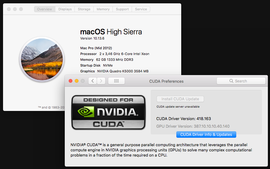

The last update we received was 2020.11.17 for MACOS DRIVER RELEASE 387.10.10.10.40.140 here: https://www.nvidia.com/download/driverResults.aspx/167083/
The corresponding last update for CUDA was with release of the CUDA toolkit ver10.2.89 here: https://developer.download.nvidia.com/compute/cuda/10.2/Prod/local_installers/cuda_10.2.89_mac.dmg
The CUDA toolkit (2.5GB) ver10.2.89 also contains the last supported CUDA driver (you can uncheck all other tools during the installation process to install just that driver alone)

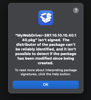

it allows installation now,
but system preferences will not start the nvdiia control panel (urges to re-open system preferences, but does not help) neither the kexts will load

edit:
executing
Code:
installer -allowUntrusted -verbose -pkg ~/Downloads/MyWebDriver-387.10.10.10.40.140.pkg -target /
as suggested by @Syncretics didn't work either,
will try again without running MyWebDriver by the GUI
edit2:
- rolled back to a High Sierra Version before Security Update 2020-006
- uninstalled WebDriver
- reapplied the download and patch
- same outcome, still get the cert error
if someone wants to try variants I modded the command from @chris1111 a bit
(use a more specific temp folder than just Files)
(runs the special installer command after download and modding)
Code:
#!/bin/bash
# By chris1111
pkgutil --expand $HOME/Downloads/WebDriver-387.10.10.10.40.140.pkg $HOME/Downloads/Files_MyWebDriver
pkgutil --flatten $HOME/Downloads/Files_MyWebDriver $HOME/Downloads/MyWebDriver-387.10.10.10.40.140.pkg
rm -rf $HOME/Downloads/Files_MyWebDriver
echo "Download and modding Done!   "
echo "starting the modded MyWebDriver, so admin password is needed"
sudo installer -allowUntrusted -verbose -pkg ~/Downloads/MyWebDriver-387.10.10.10.40.140.pkg -target /
I just hope nobody had ~/Downloads/Files folder there before, lol...
