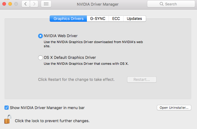

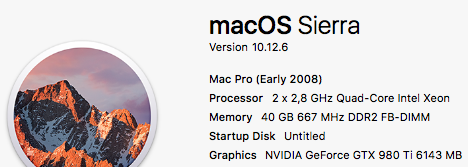

Reactions: Ammok and Stieber
Thanks this worked.
Could install webdrivers in safe mode after 'crlrefresh rp' with current date, then setting date back. Works after rebooting normally, even if connected to the internet. Thank you!
