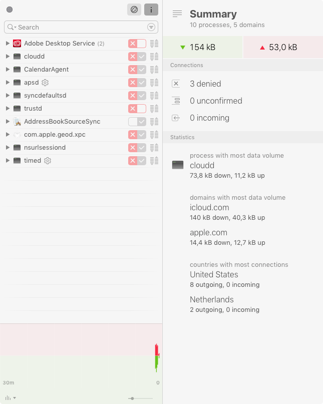

I checked the console and looks like trustd is retrieving information about signature revocation associated with this pkg from somewhere locally.
I doubt that something stored locally can cause the problems. In this case disconnecting from the internet wouldn't make any difference.
I've just finished unblocking all of the connections I blocked, one at a time, and my computer is still working. So yeah... I don't know if any of my blocking actually made a difference, something else may be keeping my computer from breaking right now...
Well, now i did just liek you did and blocked litterally everything that tried to make contact to the net within the first minutes after connecting.

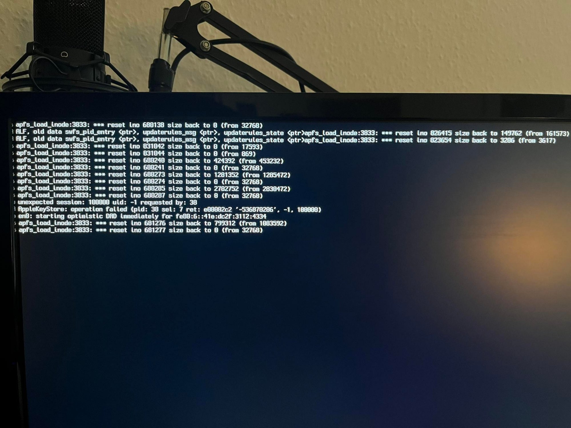

Actually worked for me. But after installing the webdriver, the system is only booting with "nv_disable=1".
Otherwise it gives me this.
Are you on a Mac or on a Hack?

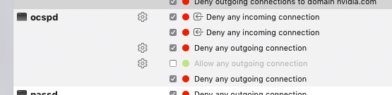

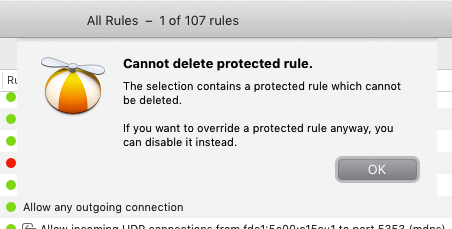

I followd all the steps, except i was unable to find ocsp or ocsp2 but but only ocspd. So i disabled any outgoing or incoming connection for that. For both, user and system.
The disabled "Allow any outgoing connection" could not be deleted as it's a system rule which cannot be modified.
Regardless of that, after two reboots with internet connection everything was dumped again!
Is there any setting to be made, making LS present durin bootup or at least load before the drivers? Otherwise i will have to try the „No Little Snitch“-Method.
unable to find ocsp or ocsp2, only ocspd
Means it is still working, fetching and caching the revocation stuff.
BTW, as the revocation status is apparently cached, it means that if you disconnect after a failure, it will use the locally cached result in the interim. Fits in with what someone posted earlier about something being stored locally.
will have to try the "No Little Snitch" Method.
You may have to amend that to the ocspd domain (or add this) if you can find that out from LittleSnitch.
Even with the Rule „Deny any outgoing connection“ for system as well as user just above and itself disabled?
This is what LS comes up with when trying to delete:
Sounds to me as if the protected rule is no longer valid if disabled.
I have just deleted any cache on my machine that i could find. User, System and Library. Will see if this helps.
Sadly could not find any domain it tries to connect to.

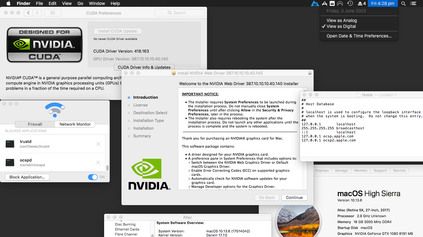

1 - The driver version I'm using is 387.10.10.10.40.140 and CUDA is 418.163.
2 - System version is macOS 10.13.6 (17G14042).
3 & 4 - The state of my computer at the time it broke was as follows: SIP enabled, gatekeeper enabled, web driver already installed. I did not have the CUDA driver installed.
When it broke, I followed Buggman's steps like this: I went into recovery mode, unplugged my ethernet cable, opened terminal, disabled SIP, disabled gatekeeper, set the date back to 2021, and reboot. As it rebooted, I held shift to enter safe mode. In safe mode I reinstalled the web driver (same version as always - 387.10.10.10.40.140), and then my computer rebooted normally, with everything working once again.
Now that I was back into my system, I opened Radio Silence's network monitor, and then plugged my ethernet back in to check what connections were being made. I blocked all of them, and restarted. It rebooted successfully, so I then tried unblocking each of connections, one at a time, rebooting in between each to see if the system would break like before - it never did, even with everything unblocked.
The next thing I did was just go about my usual computer activities for a while, then I went to bed, leaving everything unblocked still. Now I boot up my computer this morning, and it's broken once again like before.
So now what I've done is go through Buggman's steps again to bring my system back to a working state, but with a few differences this time:
- I set the date to 2020 rather than 2021.
- In addition to reinstalling the web driver, I installed the CUDA driver (418.163) for the first time.

EDIT: Just to further clarify what happens to my system when it "breaks"... For me I get stuck in a boot loop. I cannot get into macOS without going through recovery mode. The boot loop in verbose mode says the exact same sort of thing as in Stieber's post further up this page ("AppleKeyStore : operation failed", etc.). I expect adding "nv_disable=1" to my boot-args might get me back in as it did with Stieber, albeit without GPU acceleration.

Also, another thing to add... I've just noticed I'm able to run the web driver install package now. Even though the date is set to the present, the internet is on, no safe mode, etc... I'm not getting a prompt saying the certificate has expired. The package installs, and after rebooting, the package still works when I go to run it again. I haven't changed anything in my system since my last post.
EDIT - screenshot:
