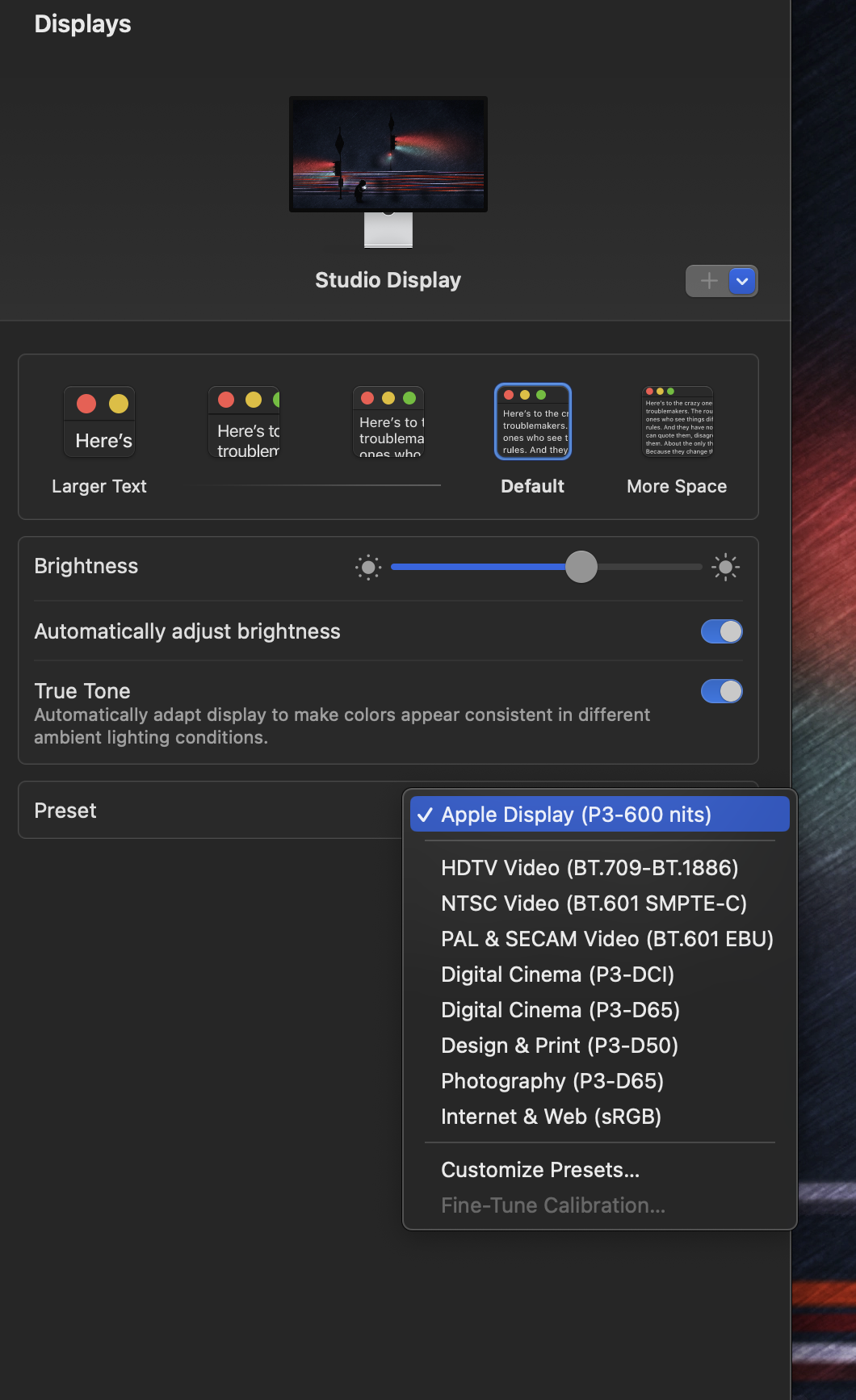

@Sowelu i dont know why you have the issue also on your studio display. I can speak only for me, but on the studio display i can use ANY color profile (also very old ones from my spider calibration tool) and it sticks forever, also after updating to a newer version of macOS Ventura. And for most of the time i am working on both machines parallel to get a good feeling on the color match. but is that why i bought a mobile computer if i always need to use an extra desktop to do my work properly? I do not think so and it makes absolutely no sense for me
Hmmm, that's not the case for me - my M2 Mac mini and Apple Studio Display shows this for Display Options (just like with my MacBook Pro):
Just presets, unlike my M2 MacBook Air, which shows the traditional 'Color Profile' instead of 'Preset'. So your Apple Studio Display shows 'Color Profile' in Display Settings?

Has anynone tried to add a fixed profil to start it up with the session ?
I guess we discussed this already in this topic and we could not figure out how to make the profile sticky, because we cannot copy the profile to the folder for the "apple presets"
Lem3ssie
macrumors regular
Aug 19, 2014
123
1
I meant, what about adding a profil to startup items in settings and see if it opens anytime you reboot.
Lomaxxx
macrumors newbie
Nov 8, 2022
22
6
Hi everyone. Being helped by some friends of mine, we managed to get a profil being loaded at startup.
First download https://github.com/timsutton/customdisplayprofiles then add the script to startup items. don't Forget chmod +x .sh and you're done. Or use betterdisplay pro.
