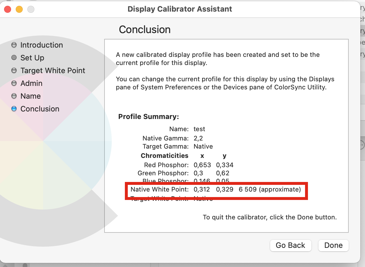

No.
Use this to Calibrate manually like this: https://forums.macrumors.com/thread...tton-calibration-option.2319627/post-30528601
Do not click Done when you come to “Conclusion”. Instead, note the values you get in Native White Point. Use those to enter in “Measured” as shown by ArtIsRight in his video.

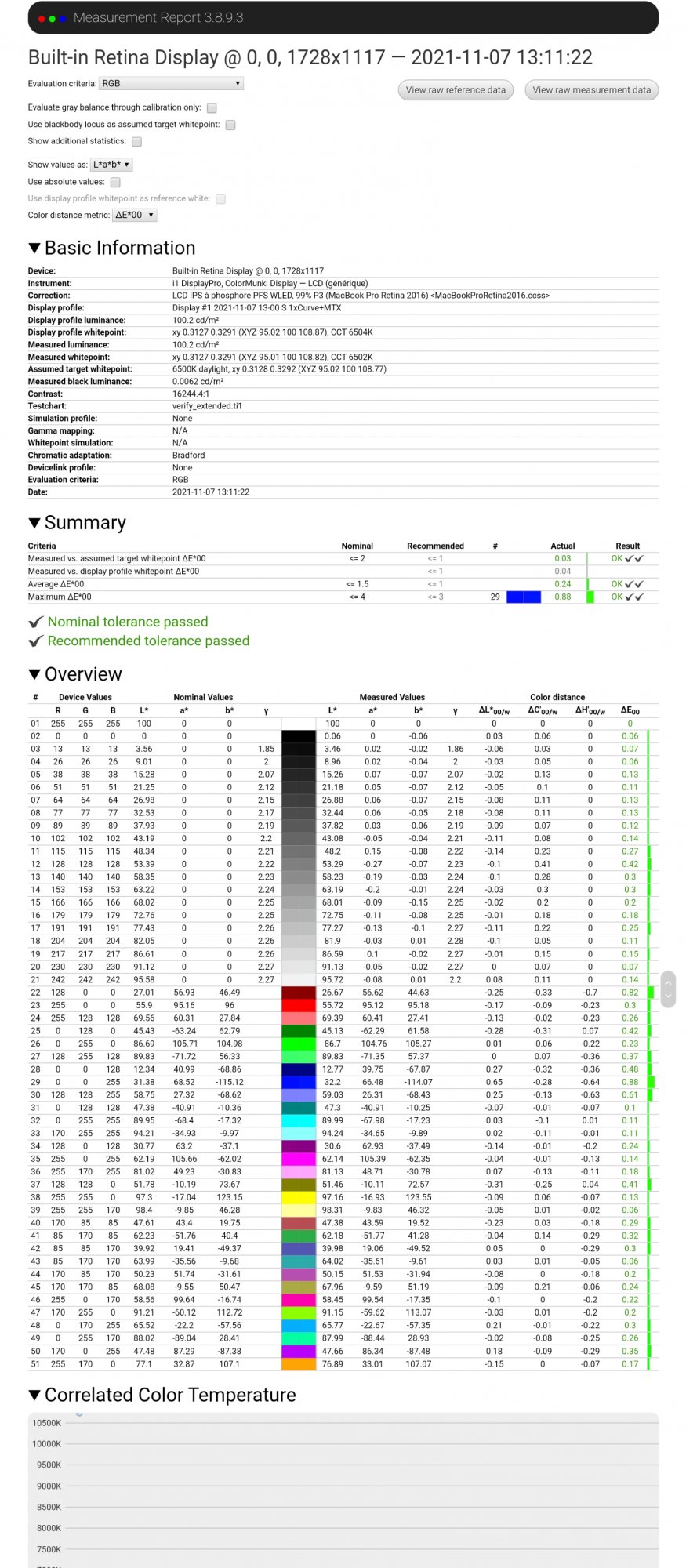

After watching the video and calibrating with displaycal with option like "measured on tone curve, luminance, temperature, I get this
No.

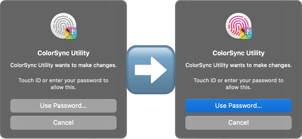

The system will bring up TouchID for authentication, but on my MacBook it just sort of hung there, so I chose ‘Use Password’ instead.
If you mouse over then click the ColorSync Utility confirmation pop-up window, it allows you at that point to use the Touch ID. It felt like it was hanging at first to me too, then I noticed when I clicked the window the colors came out and it was ready to except the Touch ID.

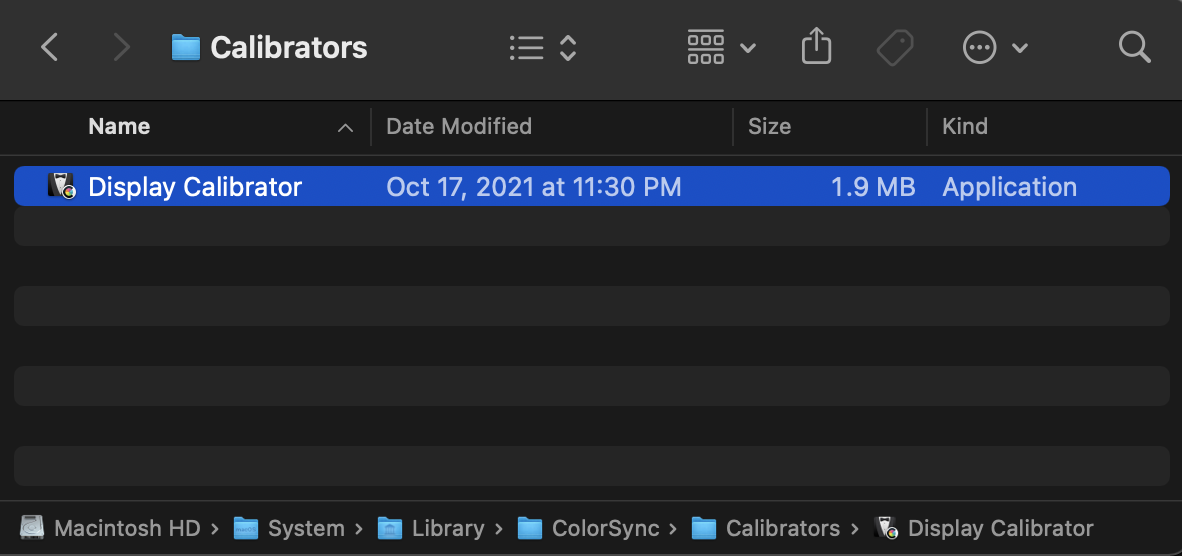

After tinkering around a bit, I think I found a workaround that will allow you to calibrate your MacBook Pro's XDR display using the built in Calibration Assistant…
The Display Calibration Assistant app is still sitting on your MacBook Pro's hard drive, and is located here:
Go to this folder, locate the Display Calibrator app, hold down the Option key, then right click on this app and select ‘Open’ (this will launch the calibrator in Expert Mode).
Calibrate and save the newly created color profile as you normally would using the Display Calibration Assistant.
Now, launch the ColorSync Utility app in the Utilities folder, click on 'Devices' on the tool bar, then click the drop down arrow next to 'Displays' on the left side of that window.
Click on 'Color LCD' (this is the default profile that your MacBook Pro is currently using), and then go to the right side of that window, and click the drop down arrow next to 'Current Profile' and choose 'Other'.
This will bring up the folder window where the default color profile (and now your newly created color profile) is saved. Select your newly created color profile and click 'Open'.
