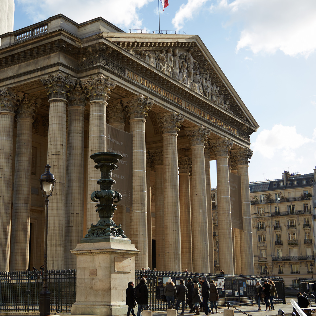

Here's an example of an image I shot in Paris recently (the facade of the Pantheon). It's got extensive dynamic range with what looks like blown highlights in the clouds and dark shadows in both the foreground and in the details of the facade. If all you had to work with, was Aperture, you'd probably bin this photo, because the adjustments you've got to work with aren't going to provide you with a satisfying result.
Now here's the image as it came out of NIK Viveza. As I mentioned, I dropped a couple of control points in the sky to control the highlights and saturate the blue, and added a few more on the facade of the building to brighten it up, add a bit of warmth and add some much needed structure. It's much better, but I may have actually overdone it a bit on the structure (the bas relief in the apex looks over-processed).

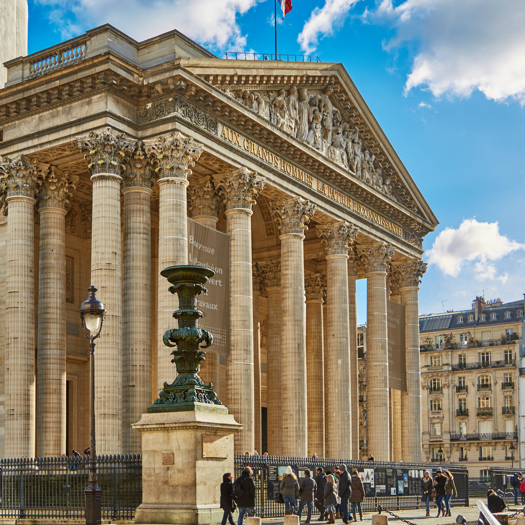

Now, here's the same image, I just edited this evening in Capture One Pro. It looks pretty much the same, but without a round-trip edit. I'm sure one could spend time making them look identical in both tools, but that's pointless... the fact is you could get the same result from either tool... and not having to do a round-trip, create a TIFF, and end up with destructive edits to that TIFF you can't tweak without starting over, is huge!
Here's what it took in C1 to get this result...
First off, I could almost call it a day after simply adjusting the shadows, highlights, and clarity sliders. They are amazing compared to what I'm use to with Aperture. The shadow slider leaves the darkest blacks alone and only shifts the shadows so as not to kill overall contrast. The highlight slider recovered an amazing amount of highlights and I could have gone further.
When I was done with highlights and shadows (and dialing in some clarity and structure), the building looked good - it was done.
All I wanted to do next was increase the saturation of the sky. Now, I could have used the color control to saturate all blue tones, and I tried that, but as you would expect, that boosted the blue jeans on the people in the foreground making them look unnatural, so instead, I painted in the sky using my new Wacom tablet/stylus which only took a few seconds with the smart edge detection of the brush. I could then use the color control on just that area or the global saturation which would apply to just that area. It was just liking having a NIK control point covering the sky but with even more flexibility.
The only thing left was the people at the bottom... lifting the shadows to reveal details in the facade had made them a bit too washed-out for my liking so I just painted on a crude slight opacity mask to the lower portion of the image and adjusted contrast and exposure to taste.
I then got carried away and painted a mask on the copper thing on the pedestal to adjust that to suit. Overall, it took me longer than playing with NIK, largely because I'm new to C1 and this Wacom tablet, but it's a rocking way to do local adjustments.
I may be done with NIK. That's huge!
ps. I forgot to mention the keystone correction. In the original shot, the building facade is leaning back due to perspective and it doesn't look like I corrected my final output in Aperture with PTLens. The sad thing is, you can't tell if you've round-tripped to PTLens or not. However, I did correct the perspective with the keystone tool in C1 which is as simple as applying a couple of vertical lines to what should be vertical lines in the photo and letting it do the correction. Much better than PTLens (and I'm sure equivalent to every other modern RAW editor out there).

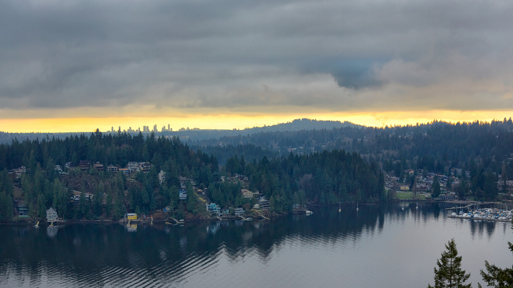

Here's another challenging photo I spent some time working on today from a hike last weekend up Quarry Rock near Deep Cove.
When we got to the lookout, the sun was peering through a gap in the clouds to the south... it was very dramatic. The dynamic range was extreme... I had to underexpose by 1 stop to save some of the highlights and this left the land very dark. The images out of the camera were not very satisfying...

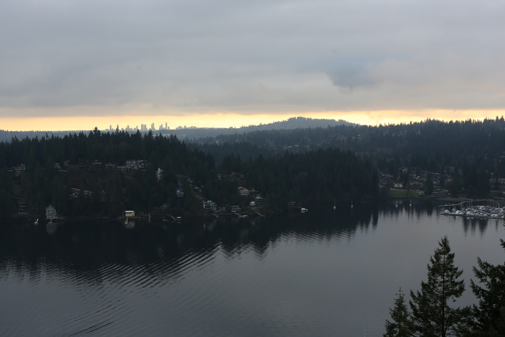

The in-camera JPEG...

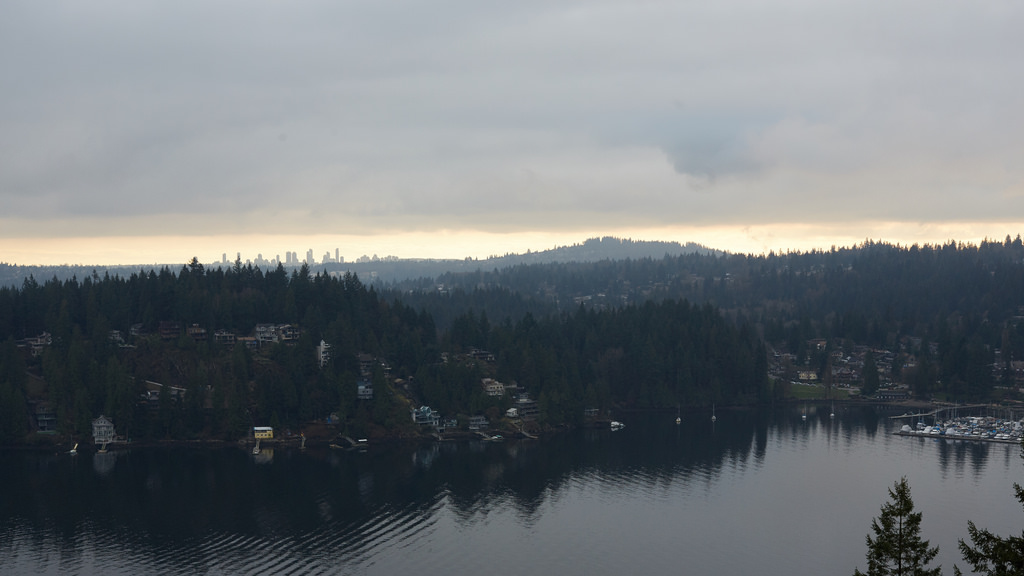

The RAW file output from C1... (nothing more than cropped) is even more bland and lifeless as expected...
Here's the best I could do in NIK/Aperture... It's much more like I remember it, but it was very challenging to boost the shadows on the land and add detail without making it look over-processed. Even as it is here, the houses look a little off to me - lacking contrast and a bit "cooked".

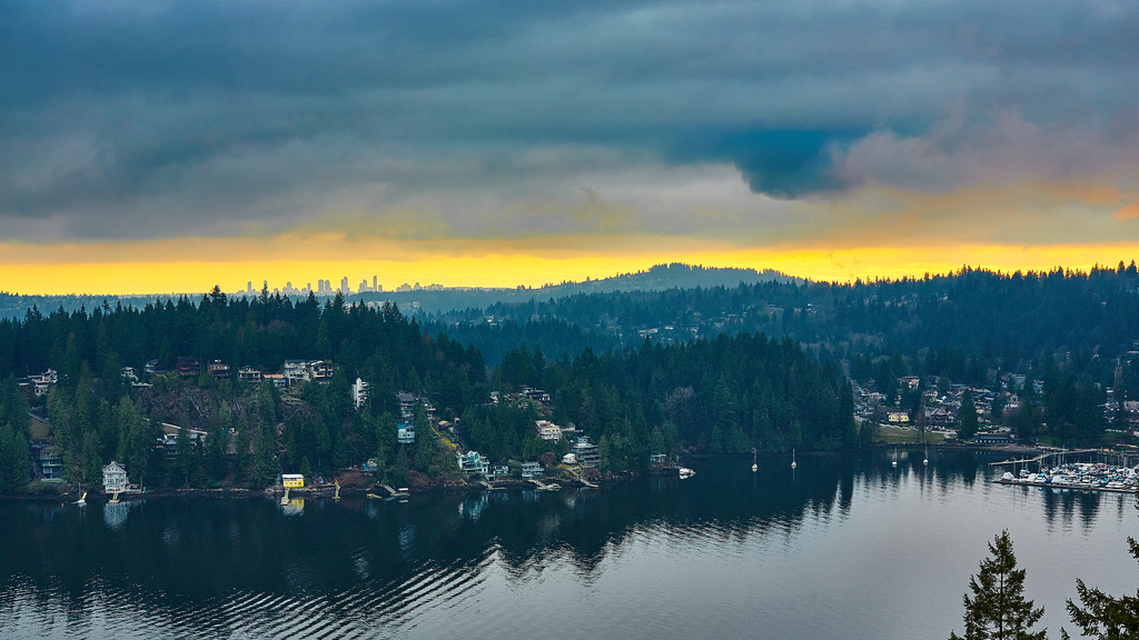

Here's the result after working on it in Capture One... Now this is how this image should have looked! :) (Ok admittedly, I may have gone overboard on saturating the sky, but the land is the best looking of the lot)
Global Adjustments:
- Boost Saturation and Contrast
- Recover highlights (sky) Boost Shadows (ground)
- Color Editor - Reduce saturation of green trees to compensate for added global saturation above
Local Gradient Mask on Sky:
- Boost Saturation further to bring out blue and orange colours in sky
- Add contrast to bring out cloud texture
- Reduce structure to reduce noise
Local Low Opacity Mask over Trees:
- Add Clarity and Structure to bring out detail
So, once again, Capture One not only matches what I could previously do in NIK, but in this case, exceeds what I could do - without a round-trip edit. I'm very happy about this.
