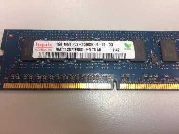

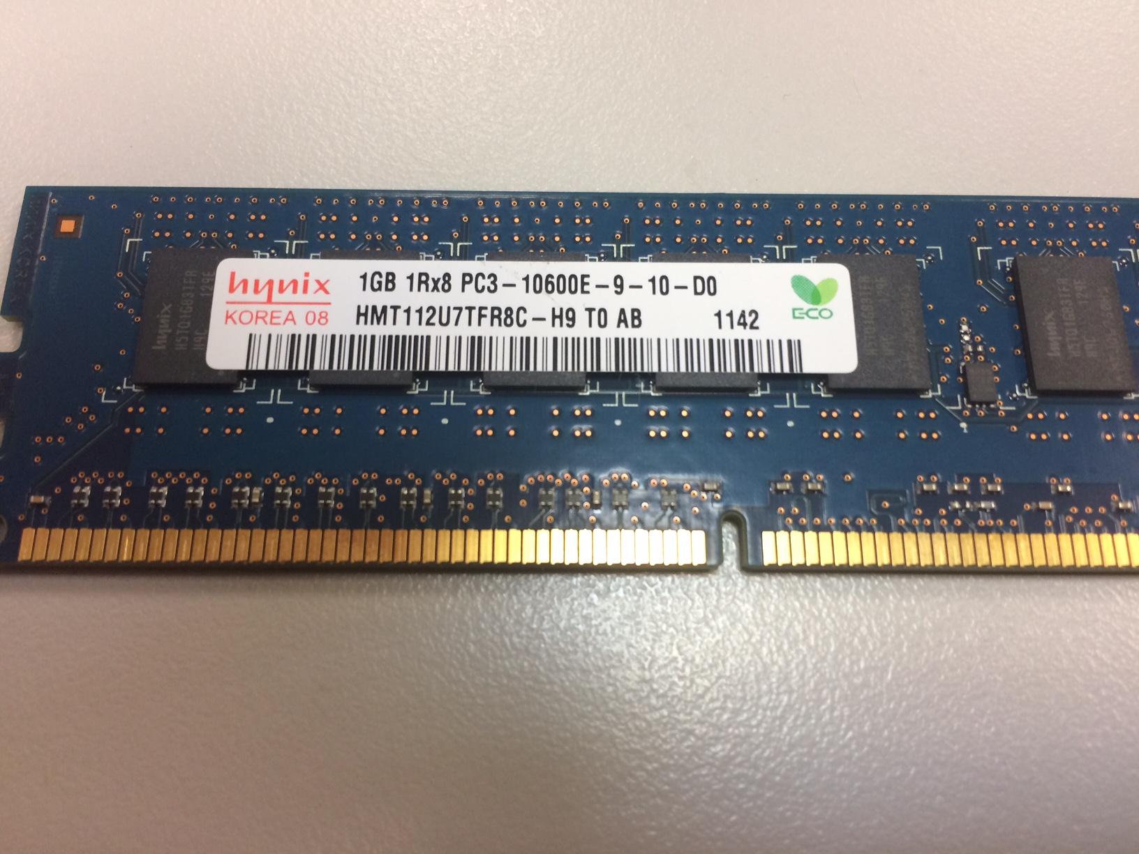

OK it seems that the CPUs or the equip is not the problem 🙂
I installed this RAM module (see picture) and it worked perfect.... 1333 speed 👍

Ok, what happens if you install only one of your ram?
Then two, and so on...
Btw you cannot mix this 1gb e-ram with your r-types.
