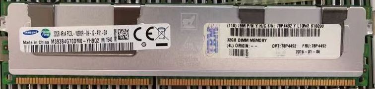

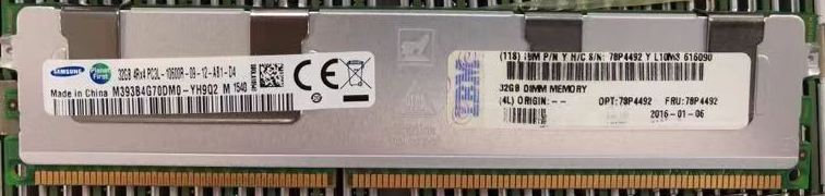

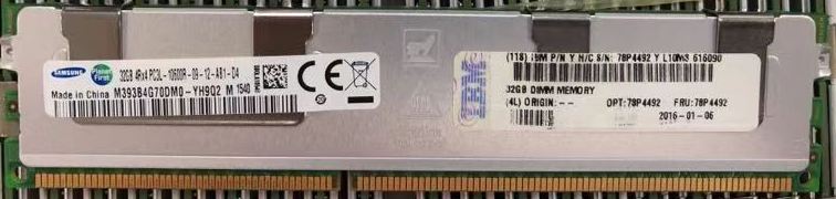

As Samsung M393B4G70BM0-YH9 are 4Rx4 @32GB, doesn't that mean they won't be identified by the Mac OSX? Did notice some Samsung M393B4G70BM0-YH9 2Rx4 @ 8GB for sale on ebay, which I assume would work though.
I bought Qty (8of) Samsung M393B4G70BM0-YH9 2R*4 @16GB on ebay for US$225 (accepted best offer) plus US$25 shipping to Australia. I'm only using Qty (6 of) to give me 96GB of total Ram, better bandwidth than using all 8 apparently. Works great. There's 2 more lots left if anybody is interested, although the seller has now jacked up the 'buy it now' price to $279.99 from $249.99
