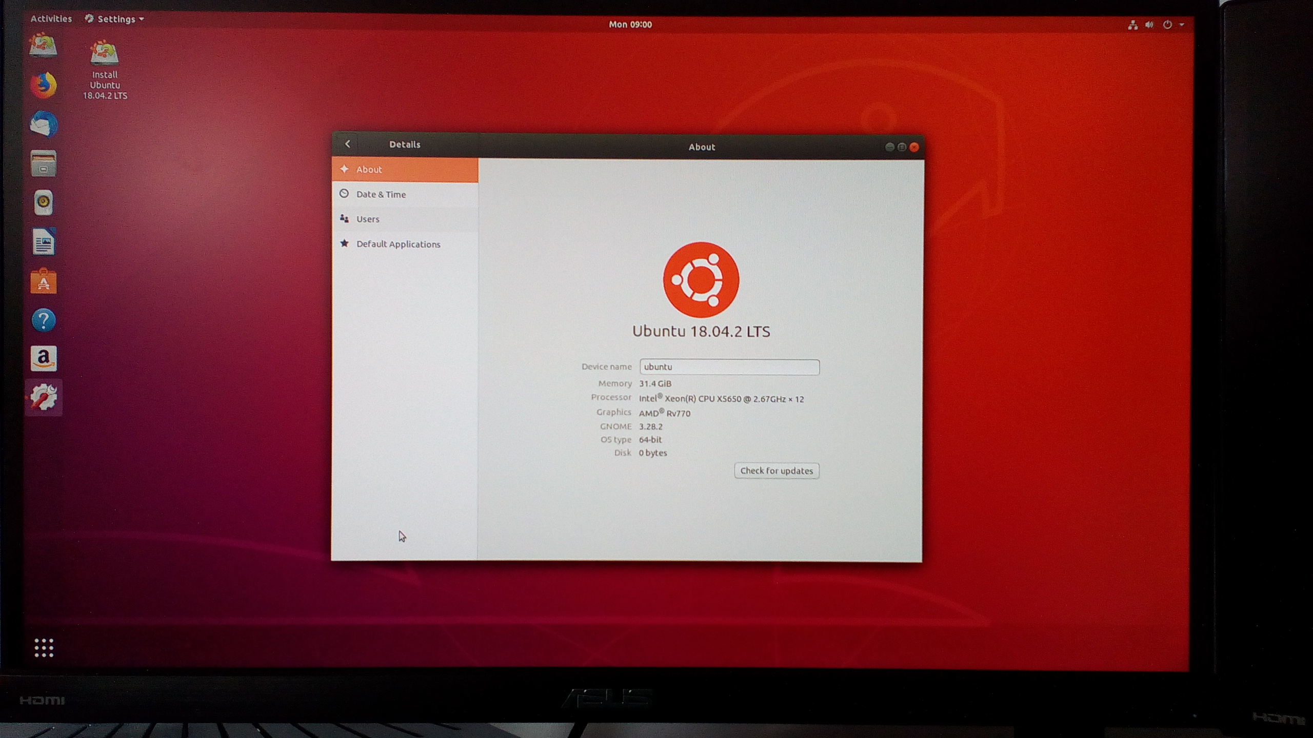

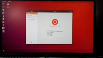

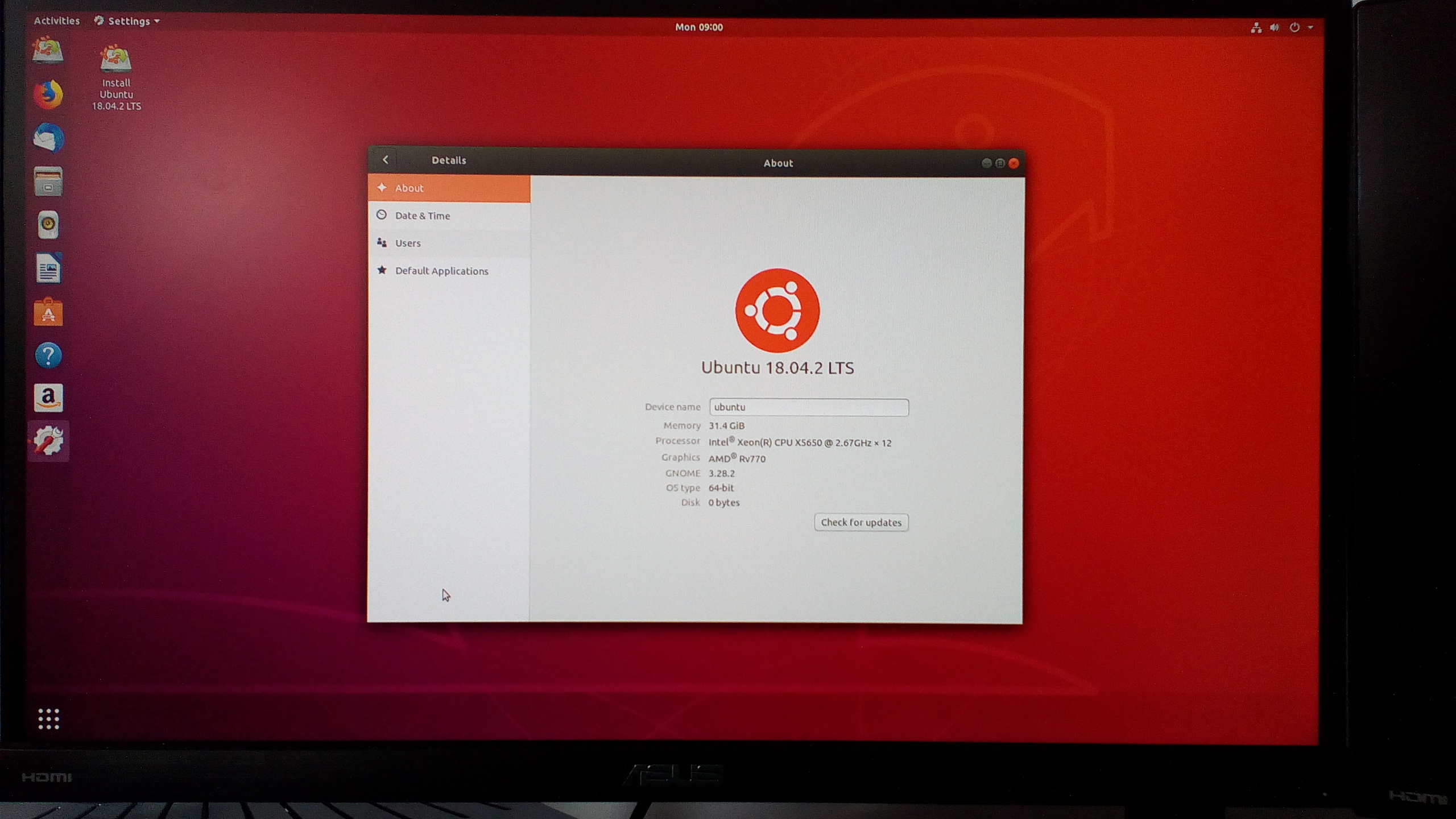

Make a Linux LiveCD, most likely your 32GB DIMM will work.

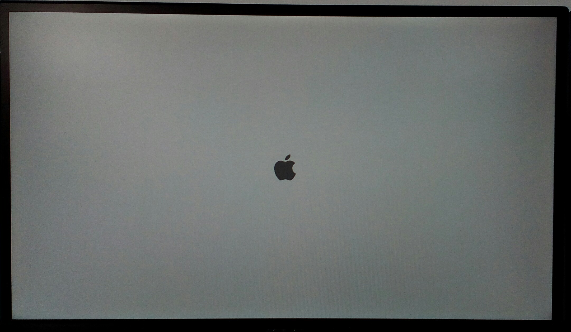

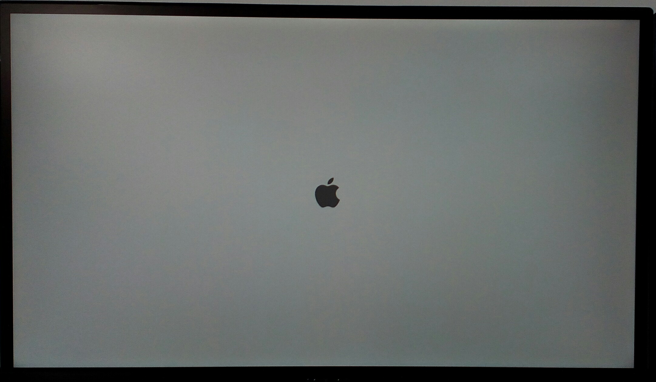

Hi, I've booted from a USB key, with a version of Ubuntu, with a Radeon 4870, it worked with the 32GB stick, but no progression bar when I've tried with Mac OS, the front led doesn't blink.
I've tried an NVRAM reset, no changes, on Mac OS.
That's quite expected.
Very possible due to only macOS use some data in NVRAM to initialise the DIMM, which doesn't really match your DIMM's spec. But other OS won't do this, so, can work without issue.
