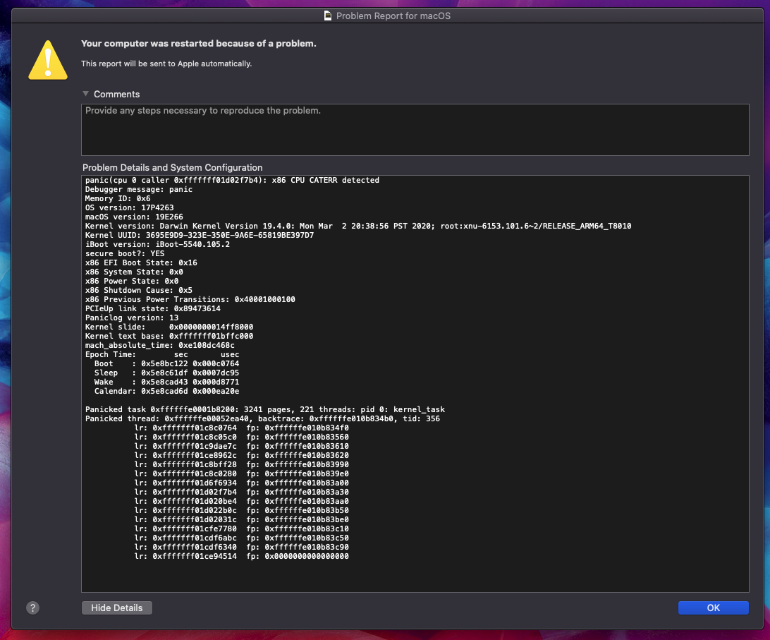

Brand new MBP 16 i9, exact same issue with a totally stock software config. Have done a total OS restore (wiping the SSD in the process) and the problem remains. Very frustrating.
I noticed in the crash log that SMB key text is being loaded. Are you connecting to a device over SMB. If so, maybe stop using that and see if the issue stops. Maybe also try a SMC and PRAM reset as well.
The MBP is asleep now with no SMB connections active. I’ll report back in the morning if that had any effect.
WRT SMC and PRAM resets, I’ve already tried those, and a complete system restore after formatting the SSD, none of which resolved the problem unfortunately.

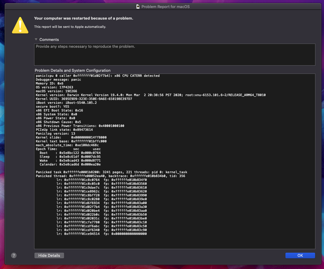

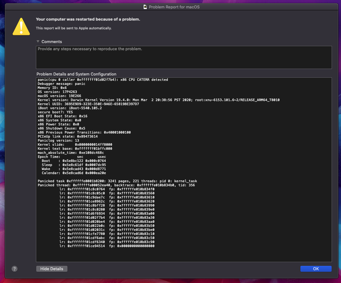

I just got a new MacBook Pro 16' about 2 days ago, and Ive noticed that every time I wake it up from sleep, the message that it had to restart due to a problem keeps popping up, and then it shows me this screen. Is this a hardware issue or a software issue?
That looks like a different Kernel Panic then the one discussed in this thread – yours don't mention "watchdog".
Searching the web for "CPU caterr detected" might give you some info.
Edit:
Might be hardware in your case:
I just noticed something interesting in your crash report. It states the release as RELEASE_ARM64_T8010. I could be wrong but it looks like the processor type is referenced? There is an ARM processor being used in the MacBook Pro?
EDIT: I just looked and the touch bar uses an ARM processor.
