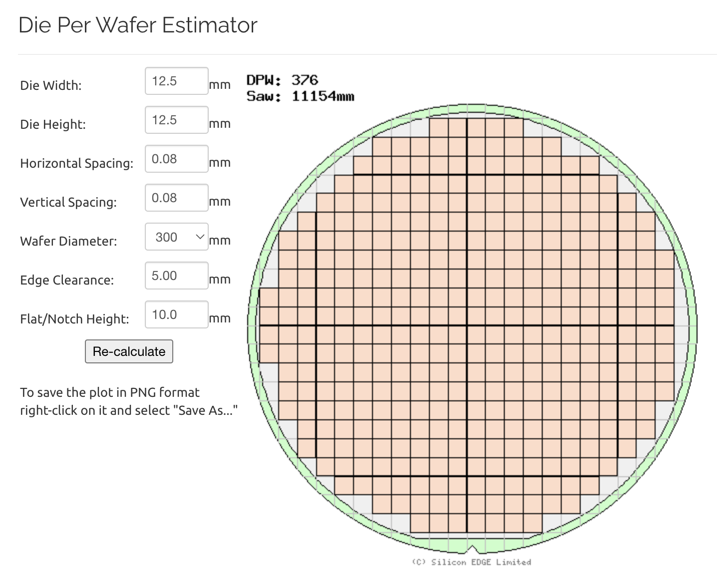

One 300mm wafer could produce around ~350 M3 chips assuming that the size will be similar to M2.
45,000 wafers * 350 chips per wafer = 15.7 million M3 chips per month. Apple sells around 7 million Macs per quarter. Hence, Apple only needs about 2 weeks of 3nm production to fulfill an entire quarter of M3 Mac demands.
This begs the question: What the hell is Apple making on 3nm since December 2022? There are reports that Apple is the only 3nm customer at the moment.
Edit: 4 months * 45,000 wafers = 180k wafers * 350 chips per wafer = 63 million M3 chips produced between December and now. Again, Apple sells ~7 million Macs per quarter.
If Apple is all-in on M3, we could see all M products get updated in quick succession. This means we could see enough M3 supply to update the 13" Air, launch 15" Air, iPad Pro 13", iPad Pro 11", iMac, Mac Mini all get updated with M3 relatively quick. We could also see M3 Pro/Max/Ultra chips come out sooner than expected.
This calculator suggests 376 M3 chips per wafer. Let's assume that defects knock out 26 chips. That's still 350/wafer.

Well, even though they are off by an order of a magnitude, it's still quite a lot of chips...

Think your calculator need new batteries. Haha.
yea, senttoschool needs new school :D:D
I didn't have my morning coffee. 😅
Point stands. What hell has Apple been doing with all the 3nm wafers?
Those numbers are also assuming that all of the SoCs being produced are the base M3. If they are also manufacturing M3 Pro and M3 Max, then that chip yield drops by a noticeable amount. Furthermore, given that every iPad currently sold by Apple (excluding the 9th and 10th gen base iPads) uses M-series SoCs instead of the A series, a lot of those chips could never even see their way inside of a Mac laptop or desktop.

reconciling! (for my own benefit)
To do 1M M1 dies per month is less than 3K wafers per month. ...
An A15 size die 10M dies/month is 23-25K wafers per month. 45K swamps that also.
Or:
3,000 wafers * 333 chips/wafer = 1,000,000M M3 dies
25,000 wafers * 400 chips/wafer = 10,000,000 A15 dies
Plenty of capacity
Also - Plenty of capacity
333 chips/wafer vs 350. Both high-quality educated guesses, and both noting that TSMC has plenty of room for A17 and M3 production in 2023 with their 45,000 wafer/month (and growing) capacity.
You can easily calculate it yourself if you know the dimensions of the SoC.
The yield % wouldn't drop by much because Apple has built-in ways to cut out a defective CPU/GPU core.
