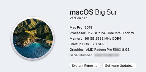

Hi! I'm planning to upgrade my 8-core processor to a 24-core one (from e-bay). Now installed Big Sur. But I read this thread, so the question is: what will i need to run the new processor? Is It tricky?
Hello everybody. I have successfully replaced the CPU - 8 cores with 24 cores. I bought a W3265M QS on ebay. It works perfectly, great performance and stability.
THANKS ALL for this thread, it helps me much.

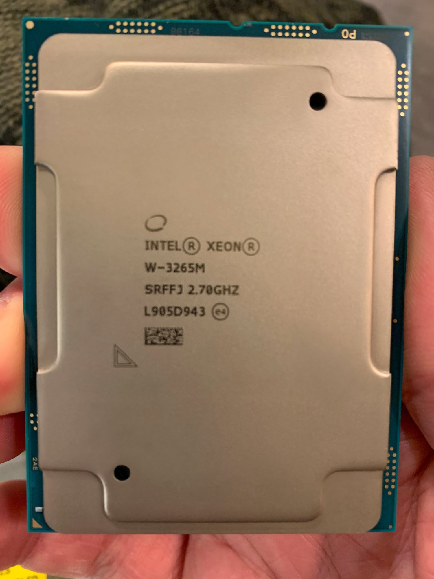

Hello!
First start with a new processor showed an amber SOS signal. So, I turned off the MP, connected the MacBook Pro (according to the instructions), then I performed all the necessary steps to revive the firmware.
There was an unobvious moment - the host computer must have installed Big Sur (if your MP have a new bootrom). Otherwise Apple Configurator 2 throws an "incompatible firmware version error" or a "network error" when trying to revive.
The revival process passed very quickly, less than a minute. After that MP booted from recovery volume and asked to choose from options. I have recovered my FileVault password and booted normally in Big Sur.
In my case, it was not needed PRAM or NVRAM reset - everything works well.

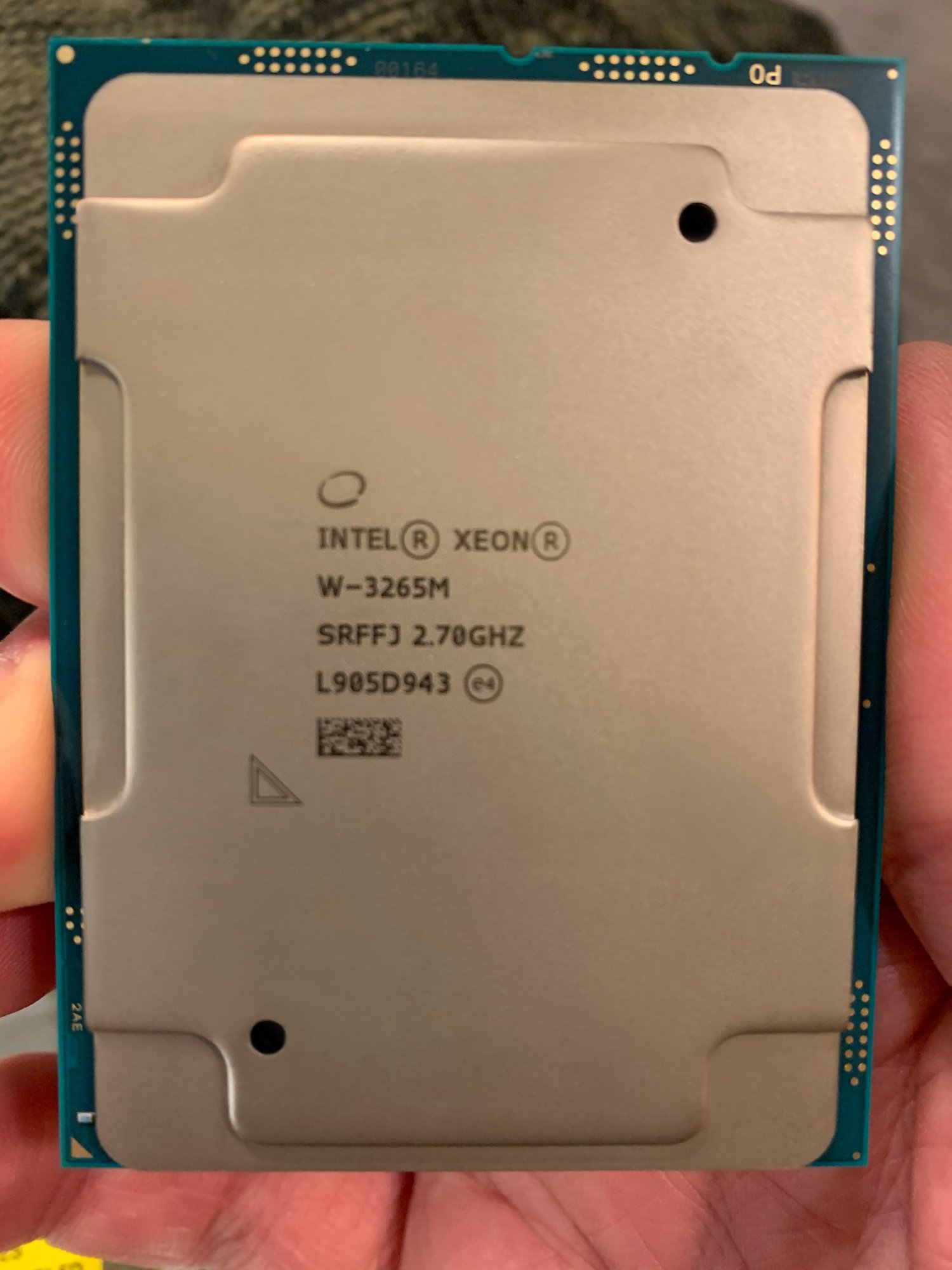

That's great to hear. I have also have a W-3265M arriving in a couple of days (to upgrade my 8-core). Pretty excited for it.

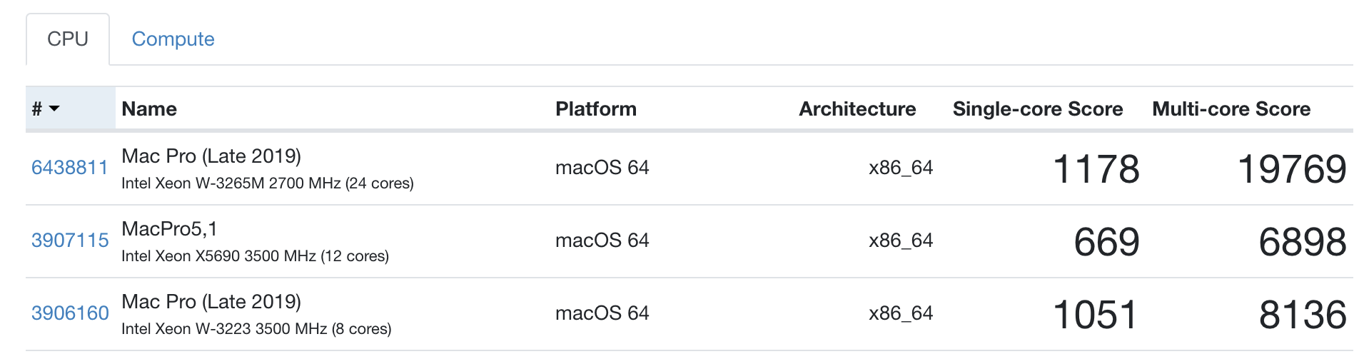

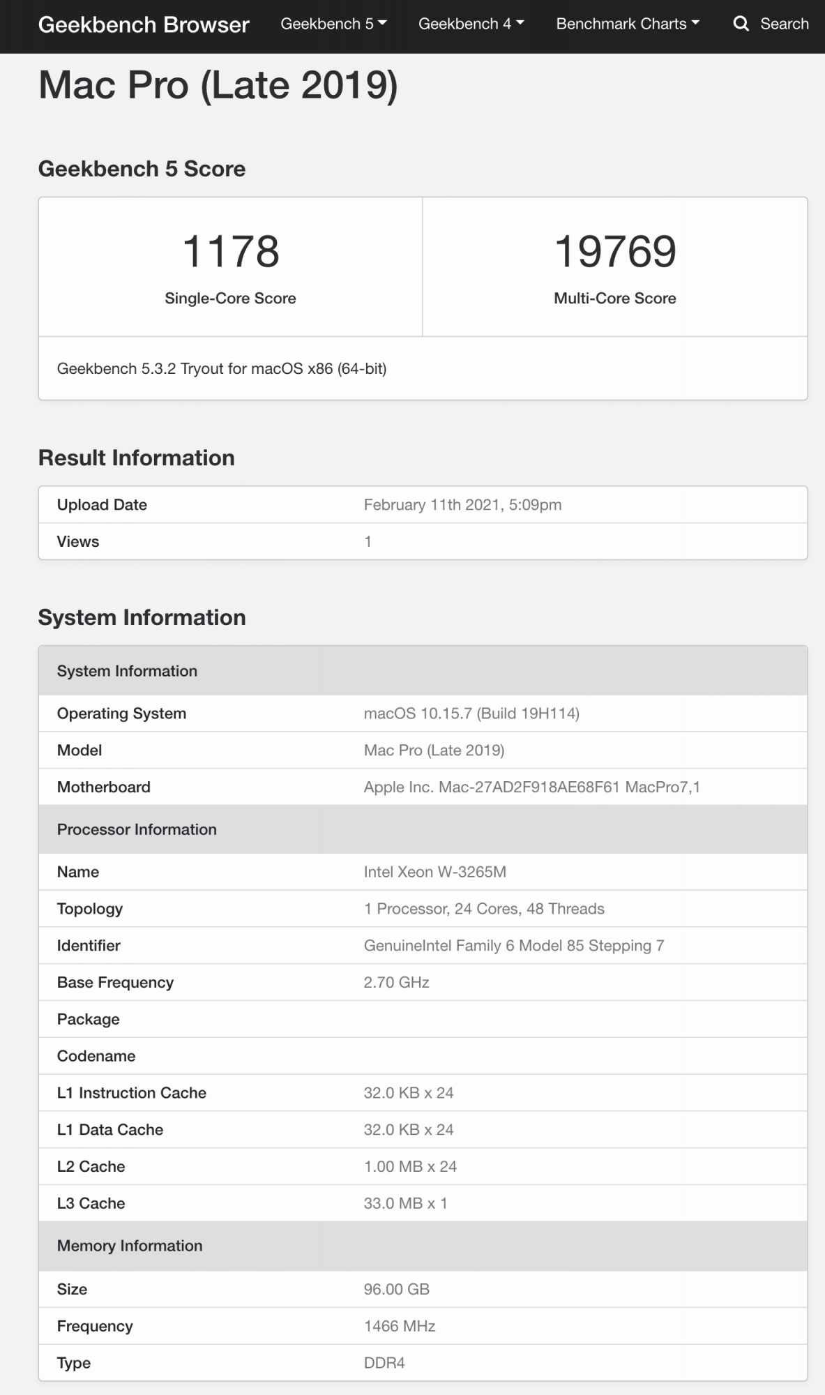

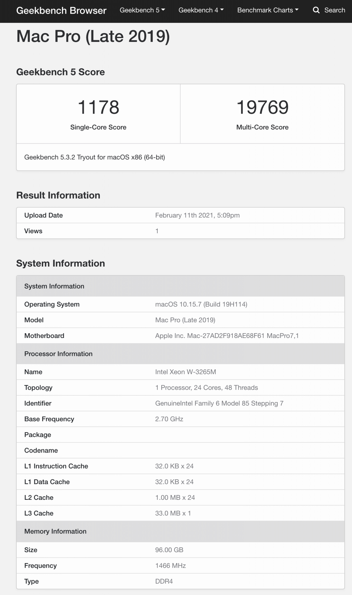

Well, I just did the upgrade from 8-core to 24-core on my machine. Running Catalina 10.15.7 it was actually a simpler process than I'd expected (having watched a few "tutorials" on youtube).
With the machine on its side (rather than upright) it was all pretty simple and painless.

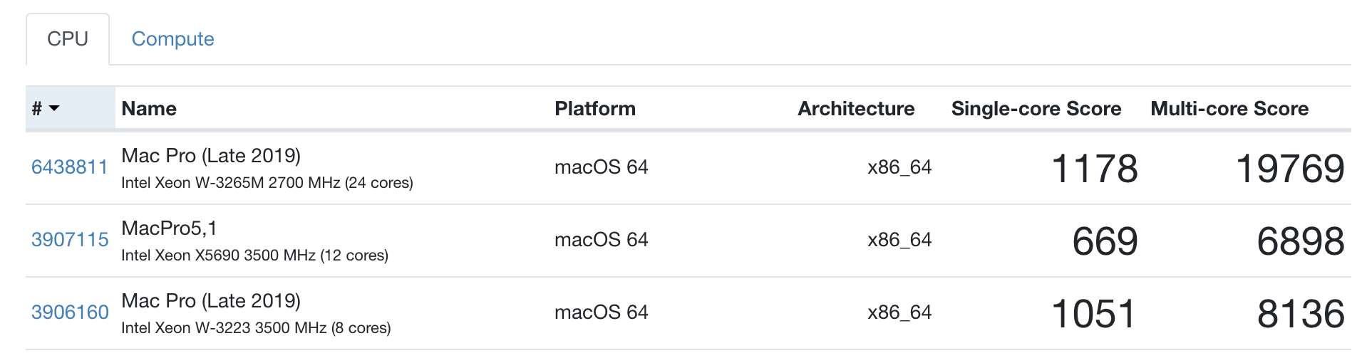

And the jump in Geekbench scores is pretty darn nifty (this is my maxed-out 12-core 5,1 vs the 8-core 7,1 vs today's new 24-core build):
can you link the youtube videos you followed? Very interested in this upgrade, but hesitant to get in there. I successfully did a swap on the 5,1. Do you think its easier?
Where did you buy the 24 core chip for upgrade?
I got lucky and found a guy in the US parting out some Xeon builds on ebay.
This one gives you all the details you need:
I wouldn't call it any more complicated than swapping out a CPU on a 5,1 (and simpler than doing a dual CPU upgrade).
The retaining clip for the CPU is simple to put in place, and there's little grooves that make placing the CPU in its tray pretty painless.
Just remember to get a photo of the CPUs orientation, before you pull your stock chip out (so you'll know which way to put the new one in, once you get to that).
