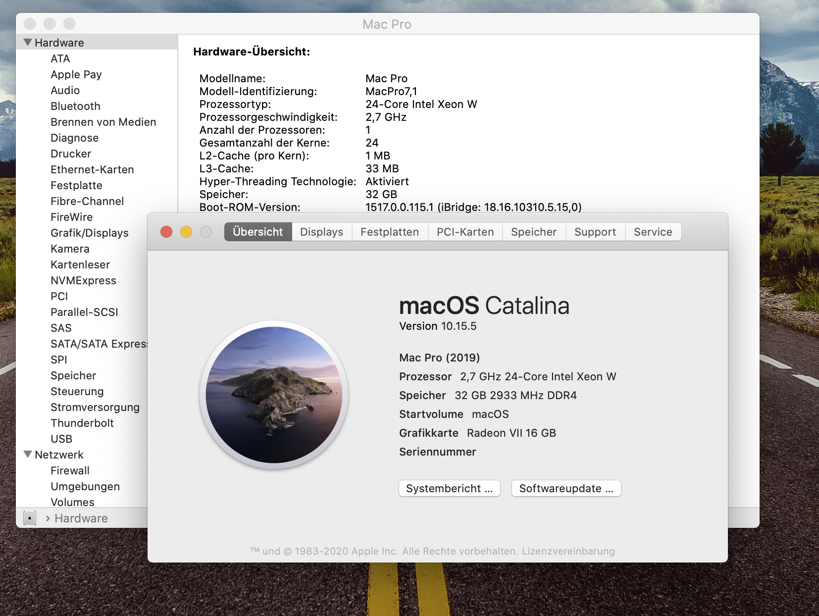

Basically : As long as the CPU switch happens before the bootrom update (Big Sur installation), it will also run after the bootrom update. If you already have the new bootrom installed on the 2019 MacPro, the CPU switch will only work if you reset the T2. @DSM2.Hackintosh told me the procedure via PM.
That is good to know, is your mac pro works again with new cpu after resetting T2?
I have 8 cores and ordered on the way 12 cores also I have already using Big Sur (Beta 4) , so will I able to switch the CPU? or do I have to reset T2? if yes is it the same method resetting SMC?
Surely this machine was made to be user upgradable? Is it really impossible once upgraded to Big Sur to change the CPU?
User upgrade in Apple's terms means PCIe slots and RAM, not CPU. In any case, per above work-around - you can replace the CPU after the upgrade to Big Sur by resetting the T2 chip.
