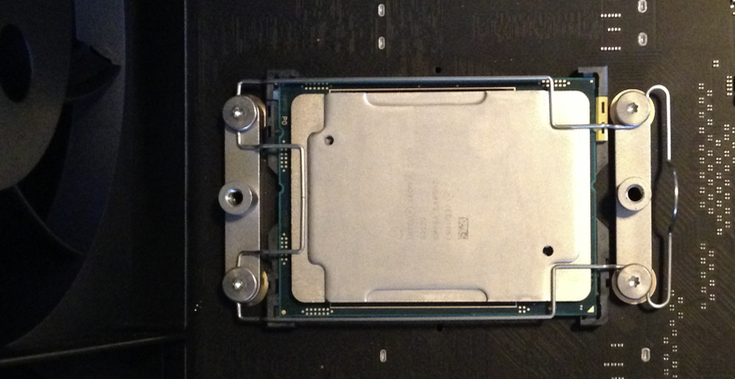

Good news is I figured out how to do the install .

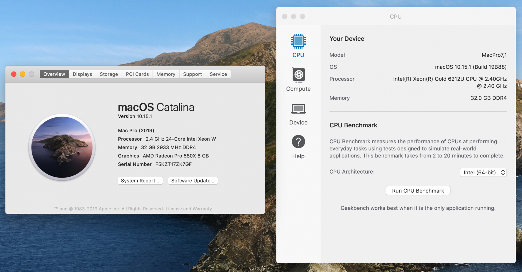

Xeon Gold 6212U 2.4 GHz 24 Core in a real Mac Pro 7,1 . She booted up right away first time .
For what its worth , I disabled SIP , Secure Boot and permitted boot from external drive before I began .

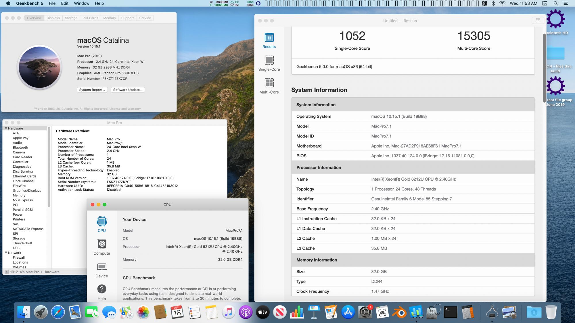

She's stable , ran a benchmark and let her idle for three hours .

the system is identifying it as a Xeon-W
this part im not surprised about since the Xeon W and Xeon SP CPUs have the same CPUID etc, its purely cosmetic
the "Xeon W" string in about this mac comes from an SMBIOS number of sorts that the firmware sets on processor detection, OS X software then reads this SMBIOS number and displays the correct string for it in about this mac
its why a MacPro1,1 displays "Unknown" for CPU model when you install Quad Core CPUs, because the firmware of the 1,1 does not set the correct SMBIOS number. so OS X has no idea what to display in about this mac
more modern mac firmware tend to default to the "Core i3" SMBIOS number when they detect an unknown CPU type
(its why a lot of prototype Macs show Core i3 in about this mac since those prototypes tend to also have Engineering sample CPUs etc, and why the LGA1156 iMacs display Core i3 in about this mac when you install a Xeon CPU into em)

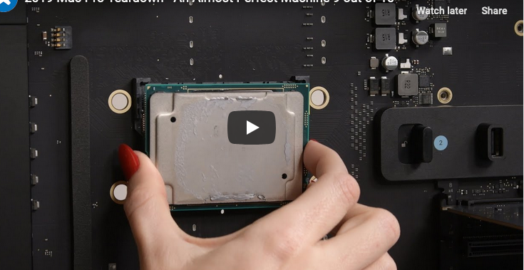

iFixit has it wrong . The new Mac Pro 7,1 does not deserve a Repairability Score of 9 out of 10 . I wish it did .
The processor upgrade score should be like -5 out of 10 , since it is very unwise to remove or install a large and heavy piece of silicon like a Cascade Lake Xeon from its LGA 3647 socket using just fingers . For those of you who've upgraded the Mac Pro 5,1's LGA 1366 socket processor , we now have three times the number of pins to worry about .
The last time we could get away with using just fingers for processor installation in the Mac Pro community was with the Ivy Bridge Xeons in the Mac Pro 6,1 .
So for anyone tempted to do this like the girl in that video ... just don't . You'll probably bend the pins in the socket .

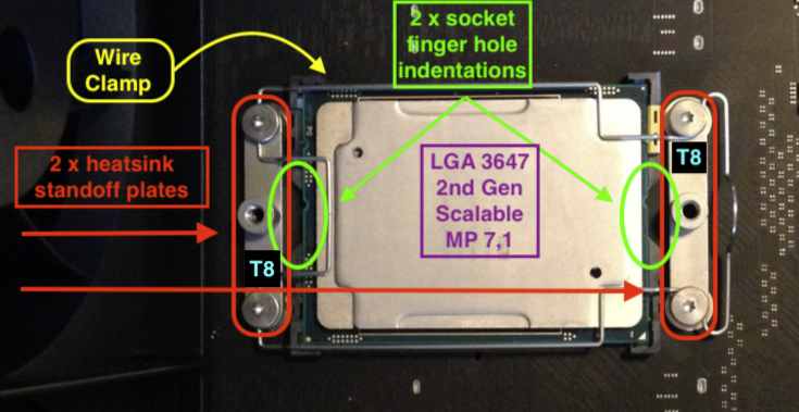

The guy in the video is using a consumer logic board with a liquid cooler that keeps getting stuck to his LGA 3647 processor , due to applied thermal paste . He isn't using a PHM and his socket has no ILM , of course . With his board , he could use a PHM but instead his processor simply rests on the socket unlocked . And then he complains about how many bent pins he has caused in his socket and why he keeps losing memory channels ... The point of the video is he paid a price for using a liquid cooler mounted on a LGA 3647 socket . Maybe someone should manufacture a liquid cooled heatsink for a PHM and his issues would be solved .
There's a very good reason the LGA 3647 workstation boards use PHM and why Intel's official processor installation video for this socket uses a PHM as well .
With regards to removing the Mac Pro 7,1's processor once the wire clamp has been removed , the two metal heatsink standoff plates on either side of the socket still prevent the silicon from being removed .
The socket has two indentations on the narrow sides that are intended for finger grabbing points , but those plates interfere with that .

I spent half an hour and half a dozen attempts trying to get enough purchase with my fingers and failed . And my fingers are small . If those plates could be removed , the processor might be removable using just fingers . Assuming its still a good idea to remove or install such a large chip with just fingers . Hint : It's Not .
And before you ask , I attempted to remove one of the T8 fasteners on that plate and also failed . It must have a ton of Loctite on the fastener's threads . I'm going to try to remove it next time with a T handle torx driver to see if that helps . But my straight handle driver couldn't do the job . For anyone attempting to remove these fasteners , remember to remove the wire clamp first .
The iFixit video showing the removal of the chip with just fingers has both those heatsink standoff plates removed . But they also completely tore down their Mac Pro 7,1 as well .
Maybe the solution to processor installation with the Mac Pro 7,1 is to find a way to remove those plates first , remove the factory silicon , install the upgrade silicon , reattach those plates and then finally reinstall the heatsink . But there should be a better way than to use just fingers for this . I think its an unnecessary risk and there are going to be a lot of bent pins in the sockets because of it .
One final note - because Apple didn't use a bolster plate as a part of their socket design , a LGA 3647 socket protection cover cannot be locked onto the socket . So while you're doing all this servicing , 3,647 unprotected pins are subject to being damaged and the socket the recipient of particulate contamination . This is not a trivial issue as every time you use a driver very small particles of metal get removed from the fasteners . I personally clean all my drivers after use - at least the ones I use for electronics work .

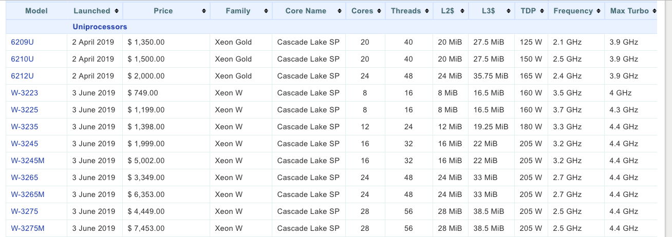

Interestingly , Apple has stated in their promo materials that the CPU socket will provide over 300 Watts of juice . That is just awesomely a lot and makes for some really seriously high end single processor configurations . This is the thing I love about Apple - the over-engineering and over-manufacturing of their top of the line computers .
For instance , no silicon Apple shipped with these machines uses a rated TDP of more than 205 W . On the PC side we'd need to worry Intel's printed specs are too conservative . Historically with the Mac Pros , our Xeons actually consume less juice than the printed specs when placed at full load . I suspect Apple must be under-volting them .
Here's a chart of the W series and the U suffix series Xeons . These are strict single processor system silicon . My 24 Core 6212U that I used in the upgrade absolutely sips power even at load :
Now for the bad news and I hate to rain on your parade .
The W-3175X , while consuming 255 W , has the wrong core stepping ( H0 ) . It doesn't match the steppings ( B1 ) of the Xeons Apple ships with the MP 7,1 . My 6212U also has B1 stepping , so I knew there was a reasonably good chance of compatibility . The thing I worried about was intel's marketing of their silicon . Would my Gold 6212U really be in the same subfamily of processors as the W series ? It seems it is .
Unless Apple really felt generous and plans future compatibility with this version , the W-3175X won't work .
