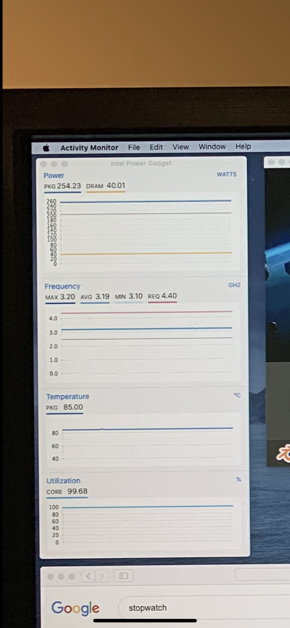

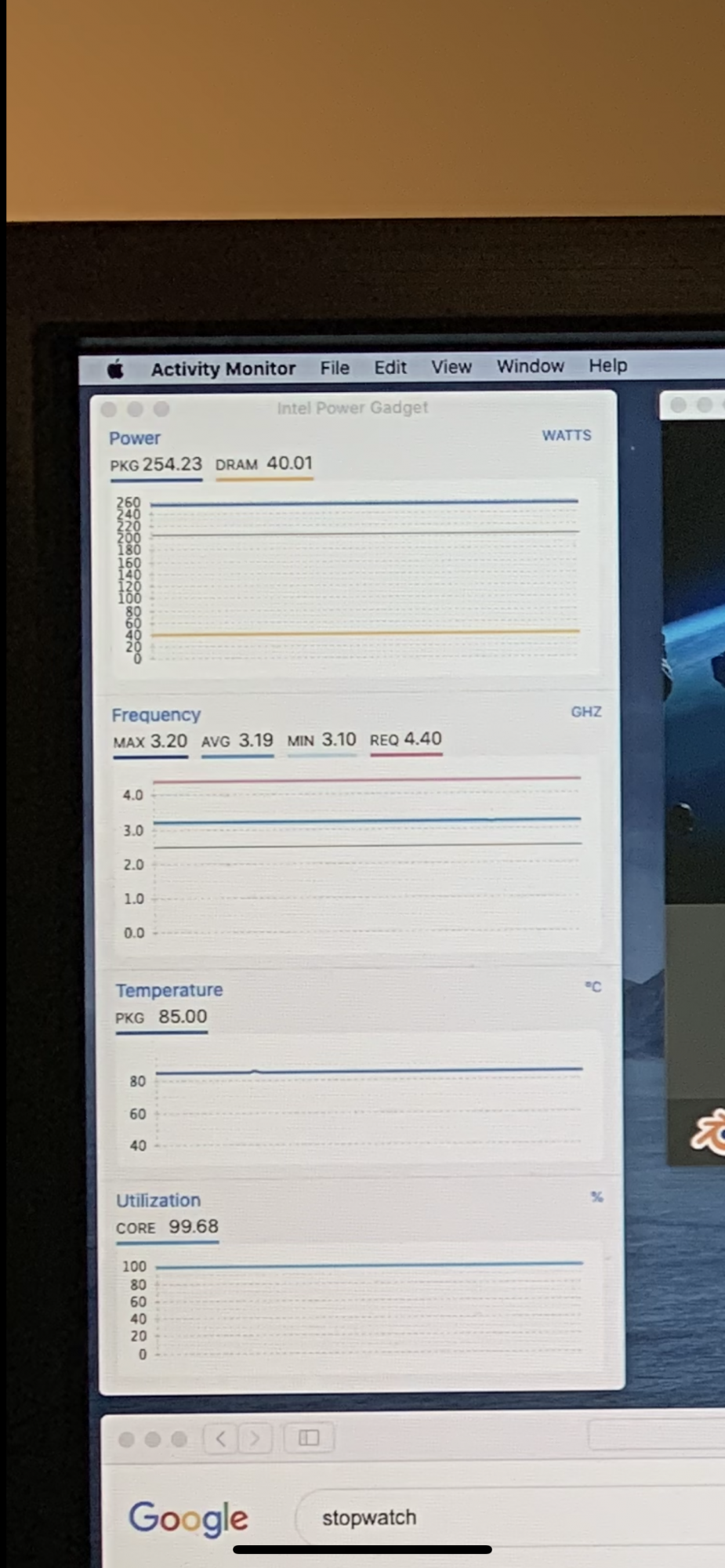

If you have a couple minutes can you please check core speed running Intel power gadget? You can use Cinebench to maximize CPU usage.

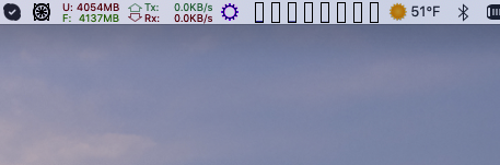

Download a copy of the modern macOS version of Menu Meters available here :
This utility will give you a visual feedback of thread and core activity of your processor in the menu bar of your screen . When all the thermometers light up , you know you are pushing your processor to the max .
