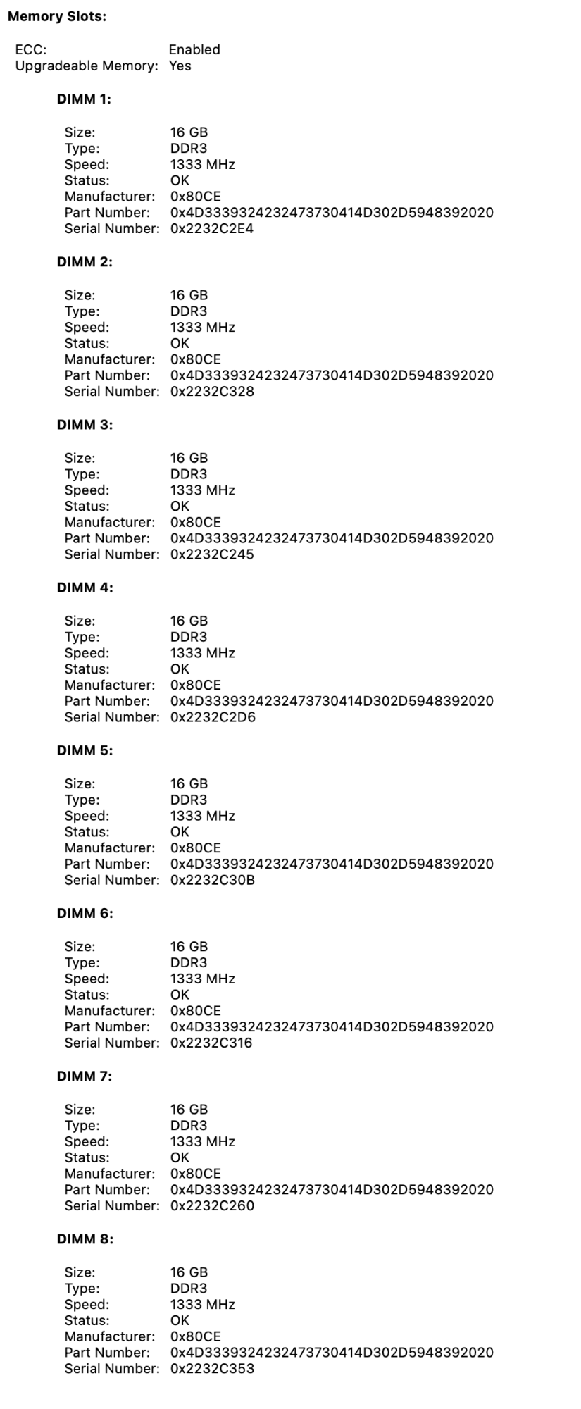

Hey Macrumors fam... I just successfully installed 8 x 32GB DDR3 10600-R ECCthat I purchased from OWC labeled as 2013 Mac Pro Memory...

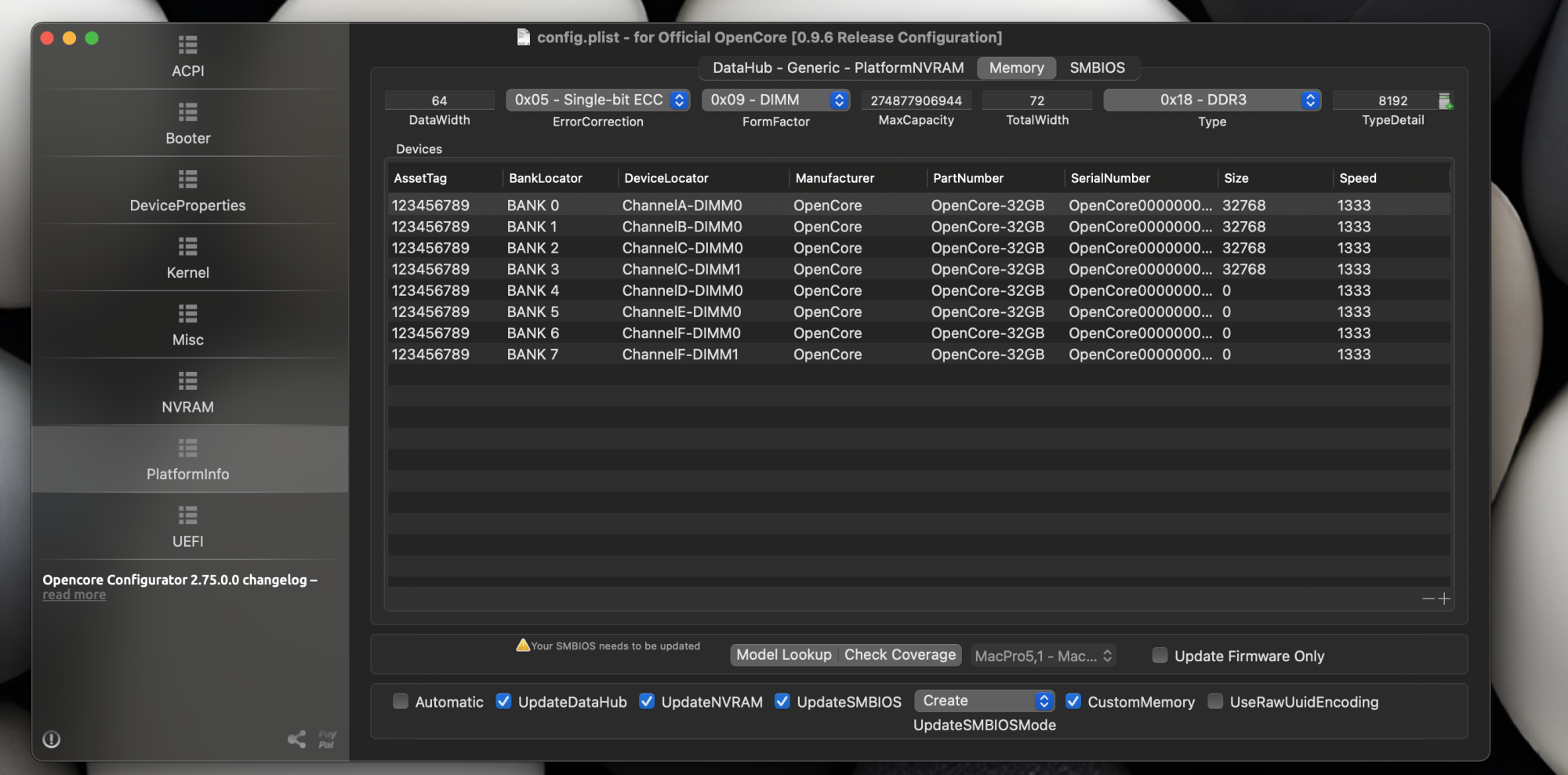

Hmmm, what did you do to your OpenCore config.plist that your DIMMs manufacturer, serial number and part number lists as "OpenCore"? Some special treatment for each and every slot? On my Mac (OC, 128 GB RAM) it looks different.
EDIT: ooh, OK, I see here https://forums.macrumors.com/thread...is.2046693/page-7?post=29717589#post-29717589

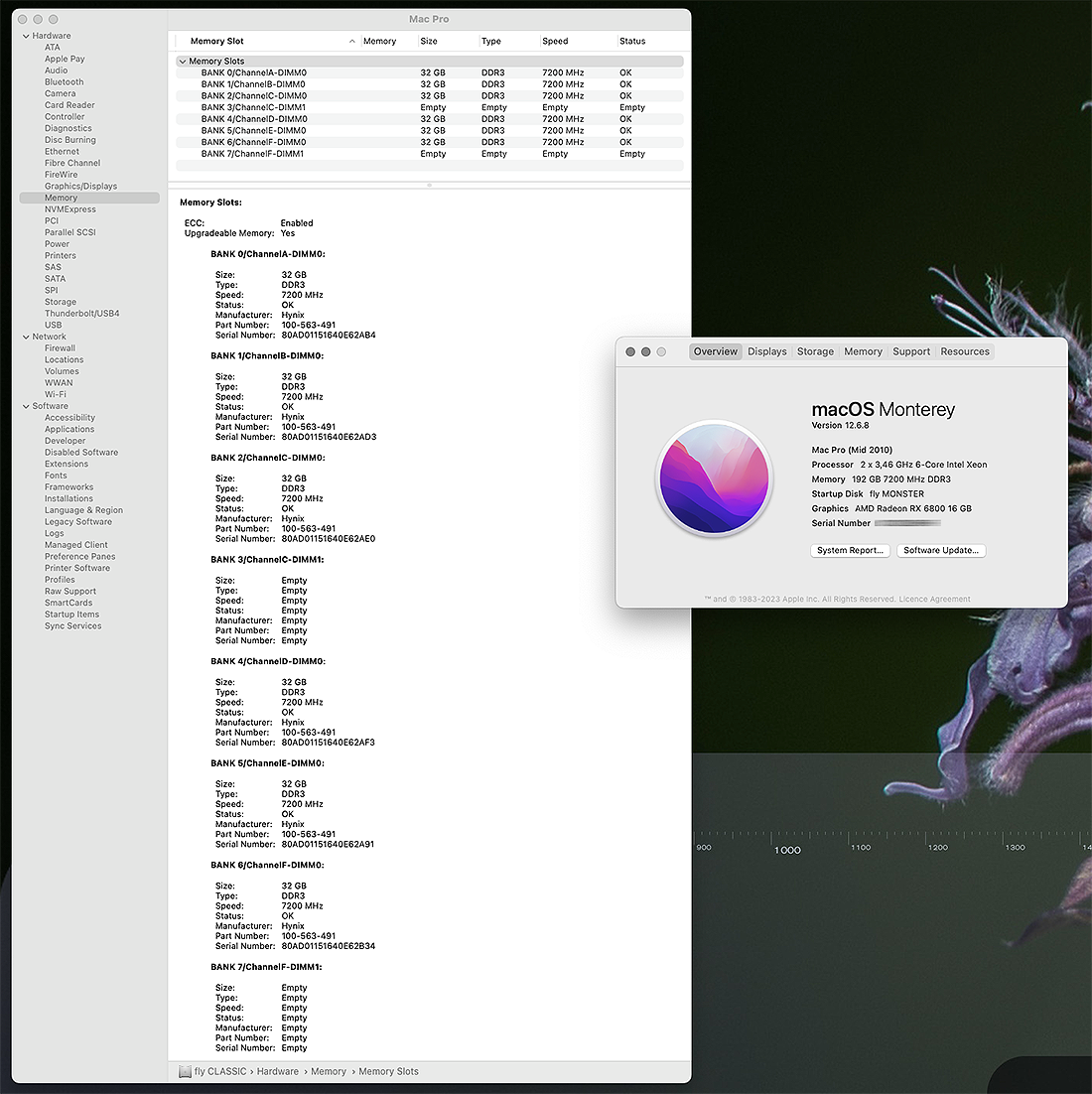

I am currently running 6x32gb modules for a total of 192gb in my cMP 5,1.

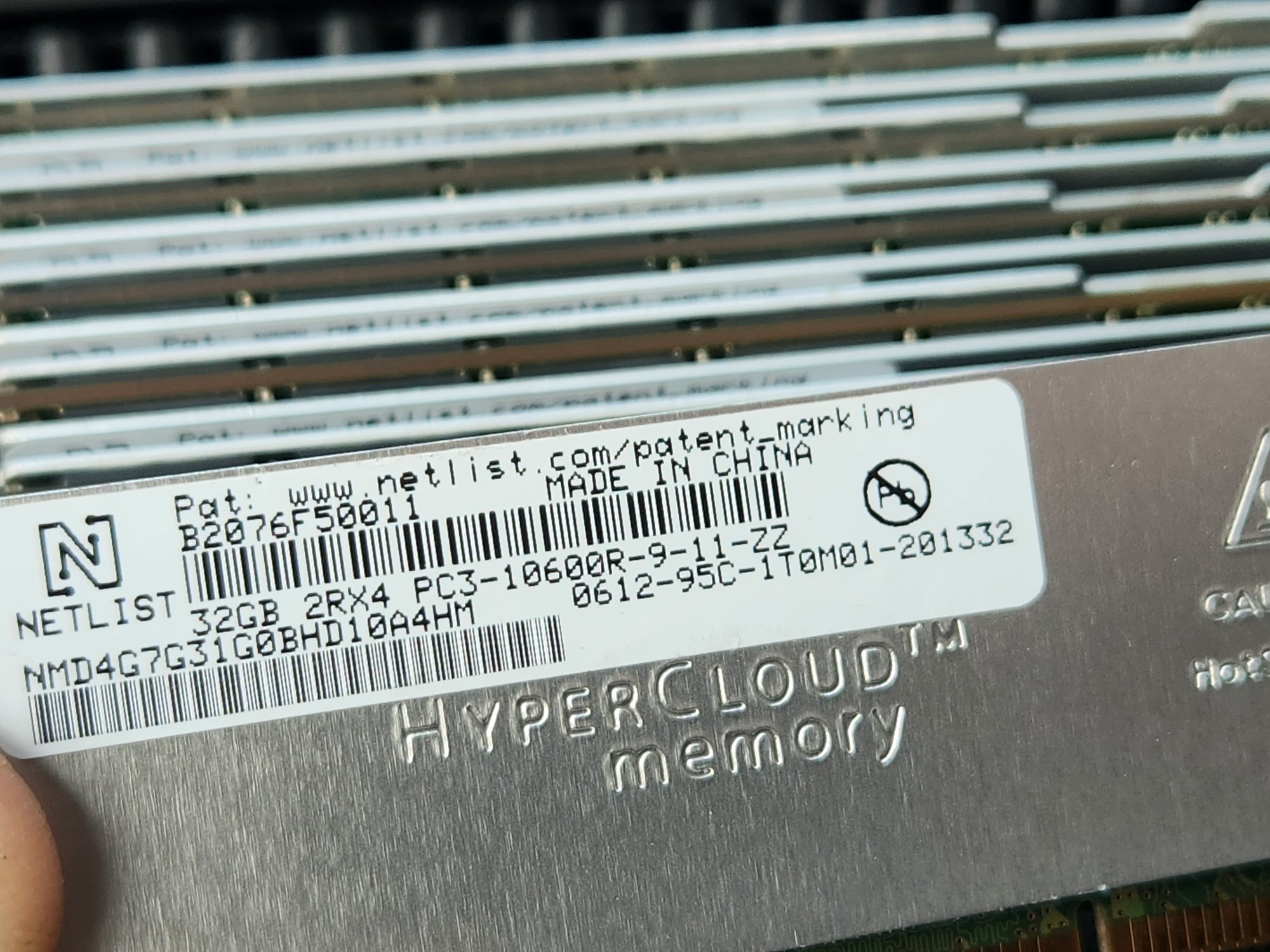

Found and picked up some seemingly rare dual rank 32gb netlist hypercloud ram for my cMP 5.1. Attempting to see if I can run 192gb @ the full 1333 mt/s speed! I searched all over but could find no one running 32gb dimms that we're not quad ranked. Most 32 GB sticks are quad ranked and push the speed down to 1066 when running triple channel.
So far these are not functioning and will not get past post. Ram LED lights up on the board. I have tried multiple sticks, to no avail. My quad rank 32 GB sticks work fine. My config in open core is set up for 32gb. If I add one of the quad and one of the dual ranked dims it will boot but only read the quad. And since they're not getting past post I can't see them in Windows either. It is already known that the 5.1 will not take LR dimms and these are somewhat similar as they use rank multiplication and a onboard controller, but I don't think they are going to workeven though they are 10600r and not 10600L.
It's a shame as i did a lot of research but couldn't find anyone running them on these particular systems. The netlist hypercloud ram is known to work with Xeon 5600 series CPUs though and is supposed to be interchangeable with rdimms with no changes needed to the BIOS. But again that is for Windows and we all know that Mac is different. I will attempt to do some further testing when I get home

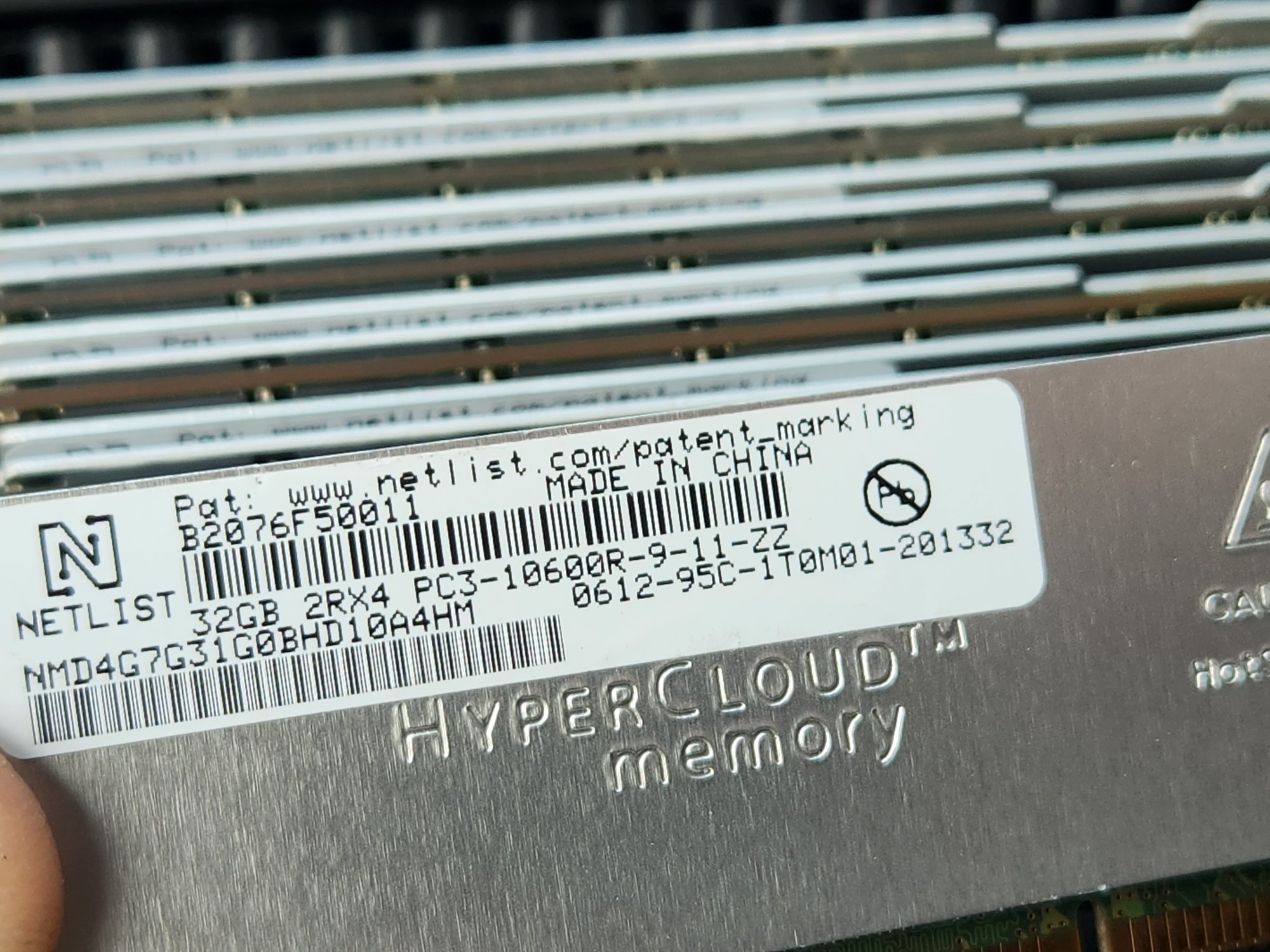

View attachment 2297290Found and picked up some seemingly rare dual rank 32gb netlist hypercloud ram for my cMP 5.1. Attempting to see if I can run 192gb @ the full 1333 mt/s speed! I searched all over but could find no one running 32gb dimms that we're not quad ranked. Most 32 GB sticks are quad ranked and push the speed down to 1066 when running triple channel.
HCDIMMs are not supported by MacPros. It's not a JEDEC standardized DIMM and, AFAIK, only some IBM/HP servers and some very specialized server motherboards had support for this type of DIMMs.
Wouldn't have been worth all the hassle after all.

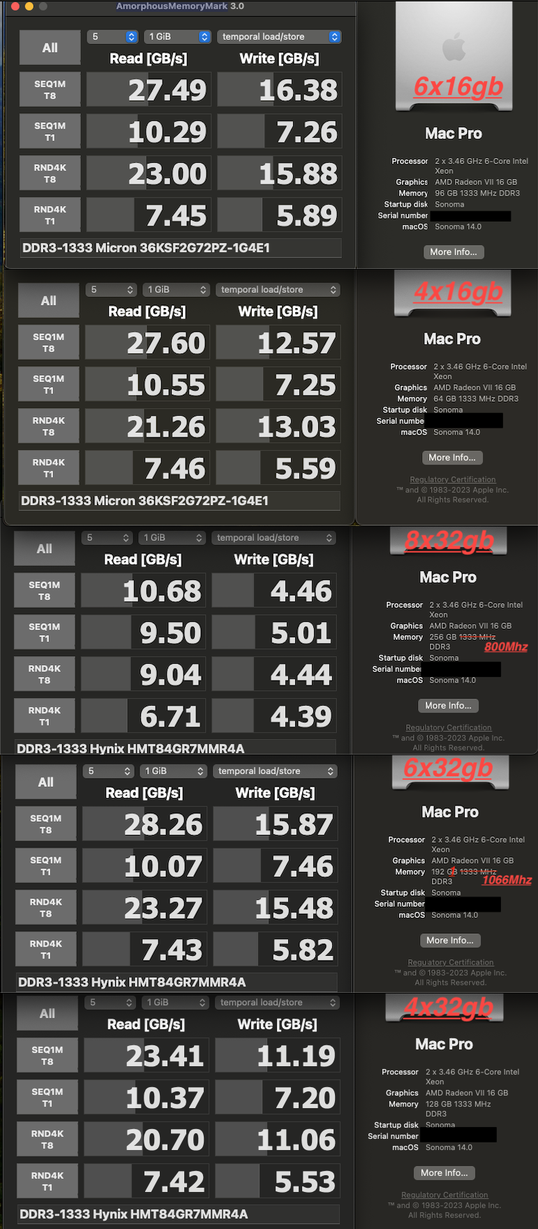

As extensive testing with 16GB modules showed, 1333 vs. 1066 is plain cosmetic if anything at all. More often than not 1066 have even been faster due to the shorter latency of 7 vs. 9. But it's absolutely marginal in benchmarks and will likely be even less in "real life".
Reactions: Jchimpo
Just tested all my ram configurations with dual-rank 16gb dimms and quad-rank 32gb dimms. Couldn't test 8x16gb as I only have 6 of them. The mhz is not correct in about mac for the 32gb setup with 6 and 8 as its just spoofed by opencore. I am suprised at the results though and thought that the 6x16gb @1300mhz would have been faster than the 6x32gb @ 1066mhz, but you thoughts on latency seem to be correct. Thanks for the input. Seems I will be sticking with the 6x32gb set up.
Reactions: Champagne_5S
Yes! You can enter whatever you like at the memory key in the config.plist So i have seen some nice speeds! 😝
I'm afraid it's only half the truth. Large sequential writes/reads should be faster for the faster frequency. But, as random access to small chunks of data is likely the more common situation, overall the quad-rank-dimms might be the faster by a very small margin. Not noticeable anyway.
