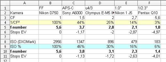

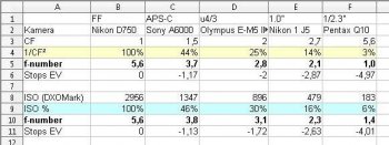

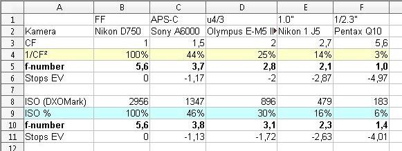

The quadratic Noise to Crop-factor relationship (1/CF²) is only an approximation. If you want to have the correct values, look up the accurate ISO measures on DXOMark.
With larger sensors until about 1" (CF 2.7), 1/CF² is a very good approximation, so actually you should multiply f-numbers with crop-factor for an approximation of equivalence. (see attached spreadsheet)
cropfaktor-jpg.595811
So the video is right after all:
25mm f/2.8 on MFT is equivalent to 50mm f/5.6 on FX
