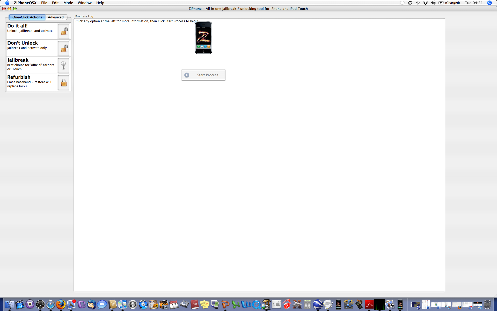

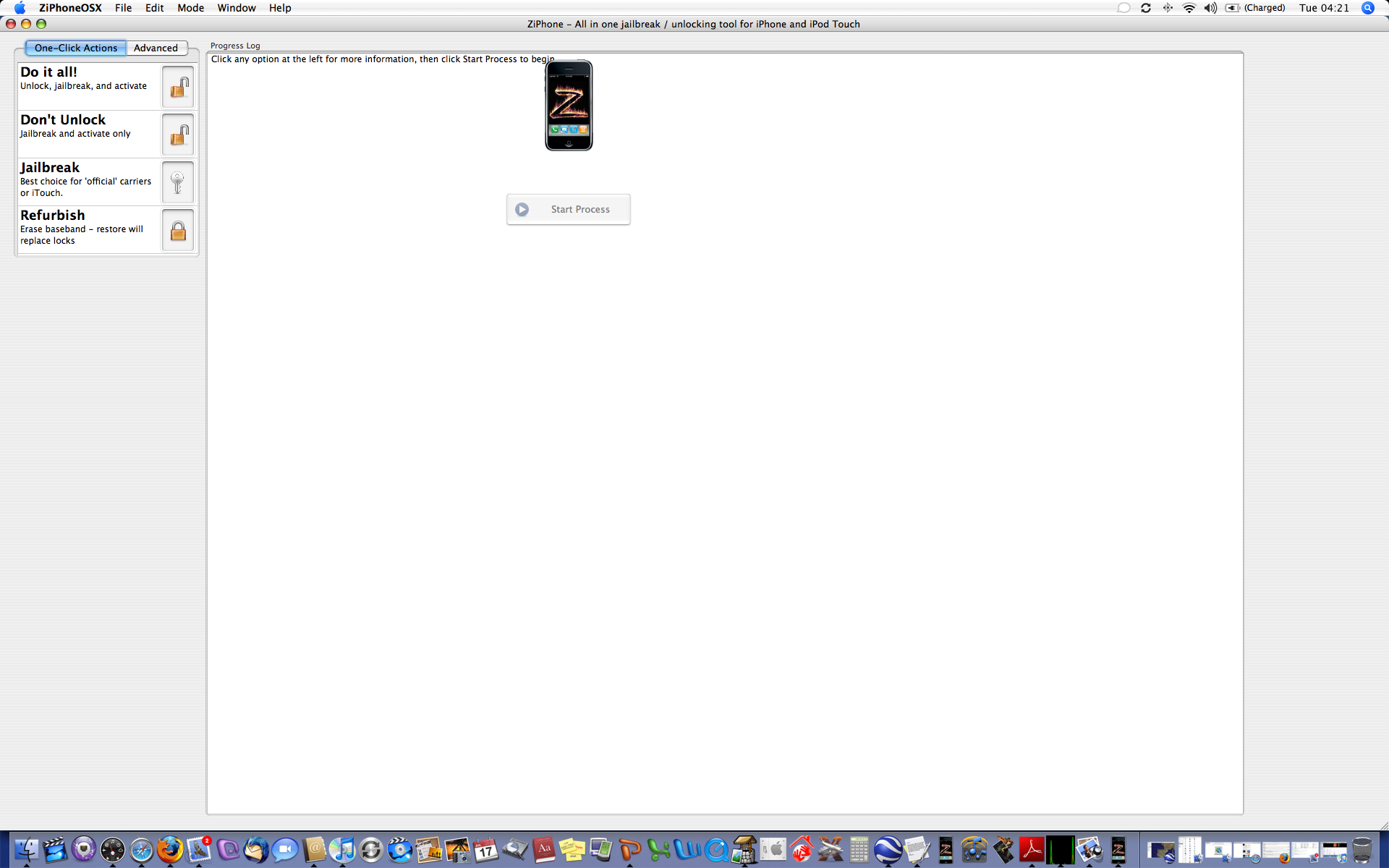

Easiest and quickest solution is as follows:
(1) Download and install latest version of ZiPhone from here:
http://www.downloadziphone.org/
(2) Restore your iPhone in iTunes to 1.1.4 (i.e. connect iPhone to computer and when iTunes recognises iPhone select 'Restore' option).
(3) Quit iTunes once this is complete then open ZiPhone and click on whichever option suits your needs (see screenshot below).
(4) ZiPhone will automatically complete the process within a few minutes.
I hope that this solves your problem. :)

Thanks, but it still doesn't install onto my computer. Once I click the button for installing it for OS X, it just loads a website with seemingly random letters and numbers (like a code or something), and I don't know how to actually download it. It seems like it should download when I click on the 'Z+:apple:+unlock' button, but what I said above happens. Please tell me what I'm doing wrong. I'm completely bewildered at why the download button doesn't download it.:eek:

This problem can happen sometimes when your browser doesn't handle the file type properly. You could try using Firefox as I suggested earlier or you could try one of the following two options:
(1) If you are using Safari select the url bar (website address bar at the top of your screen) and press option + enter and it should initiate the download of the problem file; or
(2) If the file downloads as text, let it finish then go to File then Save as, and save the file. Then remove the txt extension and you will have a .tbz file ready to be unzipped.

wow... it literally jailbroke my iPhone in less than 60 seconds... Thank you soooooo much!!!:D:D:D
