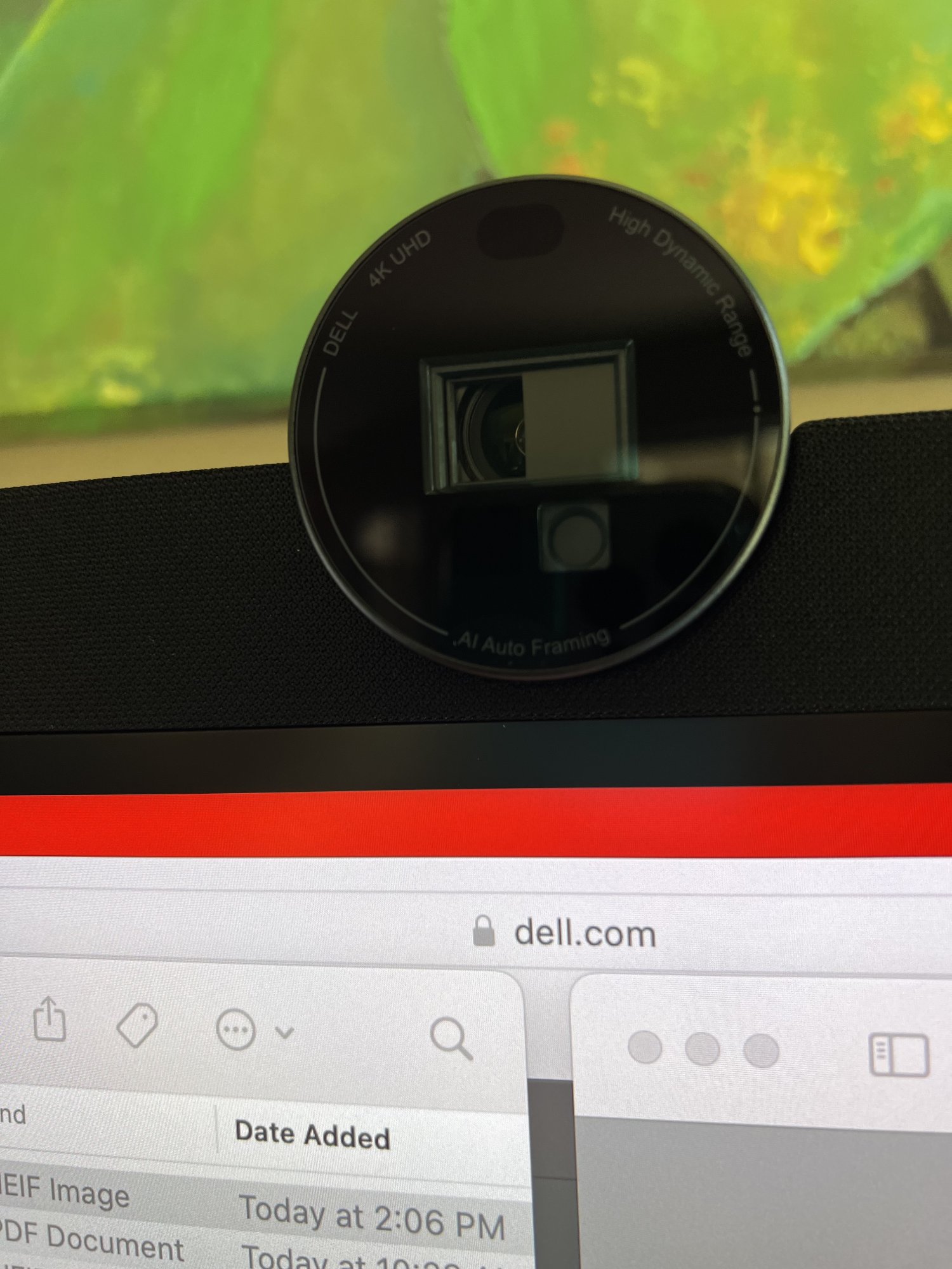

I cannot get the Dell's camera to be recognized by my Mac Studio though. Does anyone have any suggestions to fix that?

Did you manage to get the webcam working with your Mac Studio?
I'm really tempted to try one of these as having built-in speakers and webcam is a real plus for me which is why I love the Studio Display. But I really wish I had a larger screen... The Dell also allows for a second input which would let me use it with my MacBook Pro or even my HP laptop I need to use for one of my client's work.
Not yet. I wonder if it's broken because the closure does nothing when I turn if off on the controller. It appears to be halfway open. I bought it for the second input for my work Surface Pro which actually takes Mini DisplayPort. That works fine. I'm going to try to control the camera thru the Surface Pro and see if that works.
Sounds like something is wrong with the camera. Mine works as expected with both an Intel iMac and M1 Pro MBP.

This is the malfunctioning camera that's halfway closed in a permanent position. I sent in a ticket to Dell.
