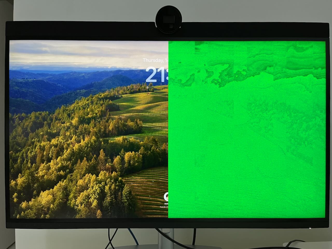

Hi, like some others here, I've recently decided to buy this monitor. Some things took me completely by surprise, though, as I don't recall them being mentioned here:

  • This is my third day with it, and for the third time the monitor woke up with half the screen glitched, in bright green (see attachment). The first time it happened I reattached the TB4 cable on the MBP's end; the second time I reattached the monitor's end, and this third time is making me worried it won't go away. Has this ever happened to anyone else?
Some of these issues make me wonder if I got a lemon. These problems, combined with some of the more well-known issues (like long wakeup times) are making me seriously consider returning it and getting a Studio Display; which is a shame, I had really high hopes for this monitor.
Have you tried a different TB4 cable? Does it only happen over TB4 or does the same problem also occur using DP or HDMI? A bad cable I think is the most likely explanation. Also, not to sound like a broken record, but what firmware does your monitor have and have you updated it?
FYI, many pages back, one or two people reported something similar, namely, that after wake, sometimes only half of the screen's backlight would turn back on. I also experienced that myself once or twice when I first got the monitor. But I believe this backlight issue was (silently?) fixed in an earlier firmware update as I haven't seen any recent reports of it, and I only had this issue before I updated to the M2T103 firmware shortly after I got the monitor. Not exactly the same symptoms as your half glitched screen but perhaps it is the same underlying issue or related.
I agree with the others here that you might have gotten a lemon, but instead of returning it, I suggest contacting Dell support to get it fixed. My monitor also arrived with (different) problems out of the box (possibly due to shipping), but working with Dell support was super easy and they quickly sent out a replacement and all has been well ever since.

Thanks for the reply. It's one more indication that there's something wrong with this particular unit. The number of people in this forum who had to request a replacement appears rather high, and I had hopes that after 6 months Dell would have improved their process, but I guess I wasn't lucky.
TB4 cables aren't exactly easy to come by 😅 I don't have any other than Dell's supplied one, and I'm always running it over TB4; I'll try using HDMI later, but since it's completely erratic, it'll be hard to know for sure.
Normally I'd agree with you that it's more likely a cable issue, but given the other problems I can't discard it's yet another problem with the monitor itself, i.e. no point in asking them to try a cable replacement first instead of shipping the entire thing back.
It came with M2T102 and I updated it to M2T105, to see if the sound and HDR issues would be fixed. (I also upgraded macOS to 14.2 between the second and third occurrences)
I tried DDPM, BetterDisplay and Lunar, and none of them have any effect. DDPM and the monitor's OSD menu disable the brightness slider; BetterDisplay and Lunar still let me send DDC instructions, but they are ignored.
It does sound like your unit has some hardware fault or two, but this particular symptom sounds like a software / settings issue. Are you able to change the brightness with the keyboard shortcuts using BetterDisplay when HDR is disabled? If so, that really suggests a software / settings problem. I don't use Lunar. Have you tried uninstalling it, in case Lunar is somehow having a negative side effect? I think for everyone here, changing the brightness with BetterDisplay "just works" with and without HDR. I'm not sure how many people here are running macOS 14.2 yet, so maybe that introduced some new issue? I'm still on 13.6, although I've quickly tested 14.0 and 14.1 on a separate bootable volume. I haven't tested 14.2.
Like every other company, Dell support has a troubleshooting process that they will ask you to go through before authorizing a replacement to be shipped out. For me, it didn't take much time and was just a bit of faffing about changing various settings unproductively in the OSD and macOS before tech support said, "yeah, let's ship you a replacement and give you a return label for the old one". If you truly like the idea of this Dell and are just unhappy your copy is not working as promised, I really do recommend calling Dell support to get their help as opposed to just returning it for a refund and going with some other monitor entirely. Again, I thought Dell support was really great; I was immediately put in touch with a helpful tech support person and it didn't take long to get a replacement.

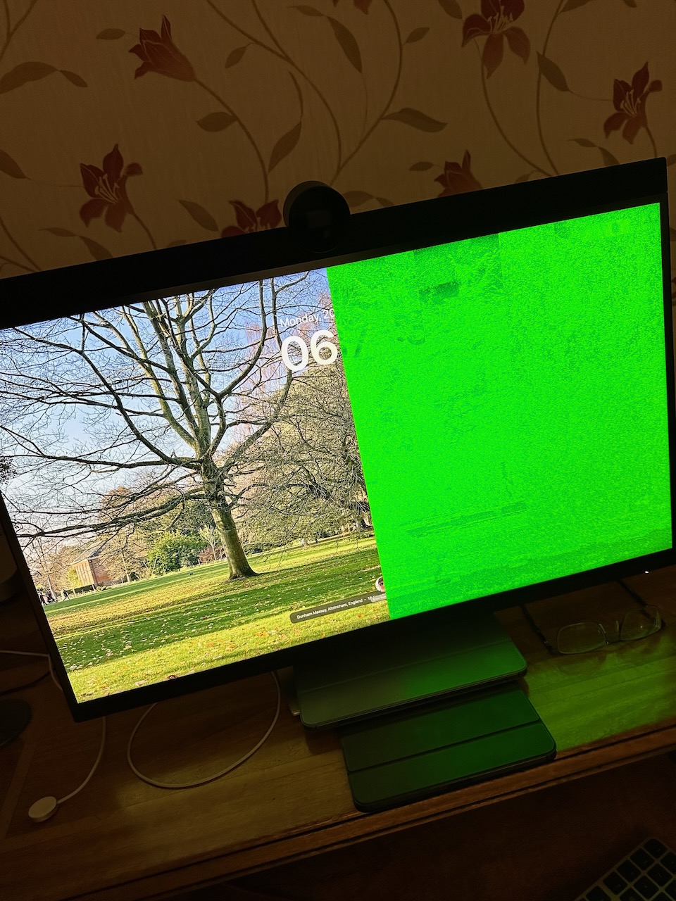

I am so very glad you posted about this issue (not been on the forum for a while). As you can see I suffered the same issue when connected to my Mac Mini Pro 2. I only seem to have developed the issue after a few months of having no issues at all.
The monitor was connected to the Mini using the Dell supplied Thunderbolt cable. I'm pretty sure the issue was seen shortly after the firmware was updated to version M2T104.
Since then I've looked to test by switching to using HDMI (no issues seen) and switching to a better quality thunderbolt cable. Since switching to the new TB cable (and 2 days later updating the firmware to M2T105), I've now not had the issue for nearly 9 days, prior to that I'd seen it around every 4-7 days. So it's early days yet I guess but I've got my fingers crossed that the cable change or firmware update have resolved the issue?
I hope one of those solutions clears this up. Fingers crossed - I've not had this issue (or any other) with the monitor.
I'm putting my money on the cable being the culprit. FWIW - My dell is connected using the braided TB cable that comes with the ASD. Guessing that's a fairly high quality cable.
I'm hoping so too! The braided TB cable that came with the ASD should indeed be of good quality. The braided one I'm now using is around 1.5 times as thick as the Dell supplied one.

Don't think so. @dluz reported having the problem both before and after updating to the latest firmware (M2T105). dluz also reported having the problem before and after updating to macOS 14.2, though I'm not sure what other versions of macOS dluz was using. What versions of macOS have you encountered the problem on? If anyone is running Windows, maybe they can chime in if they too have had this problem.
My bet is also on a bad cable, but who knows. It's even possible that this issue is some bug from Apple, e.g., in macOS. Whatever the case, I encourage both you and dluz to contact Dell support to both report the problem to them and to possibly get a solution, as Dell is in a much better position to help you both.
FYI, I'm running macOS 13.6 and have used all firmwares from M2T102 through M2T105 and I haven't noticed an issue. But I'm generally connected to M2 Pro Mini using HDMI. If it'd be helpful, I could switch over to using my Dell TB4 cable and see if I notice the problem on macOS 13.6. But I won't be updating to 14.x anytime soon.
Yep I wasn't sure myself as to whether the firmware made a difference or not. The combination of cable, macOS and firmware make it difficult to isolate the cause. I'm monitoring the situation to see where it goes on from here and if it does reoccur again I will raise a ticket with Dell over it. If changing the cable fixes it I'm happy, for various reasons doing a monitor switch out would be a major difficulty.
When I switched to HDMI it did indeed work well enough, but I found the monitor was much slower to respond when waking up and at times did not initially wake to the correct resolution, which it then changed a split second later which could cause odd window position / sizing issues.
