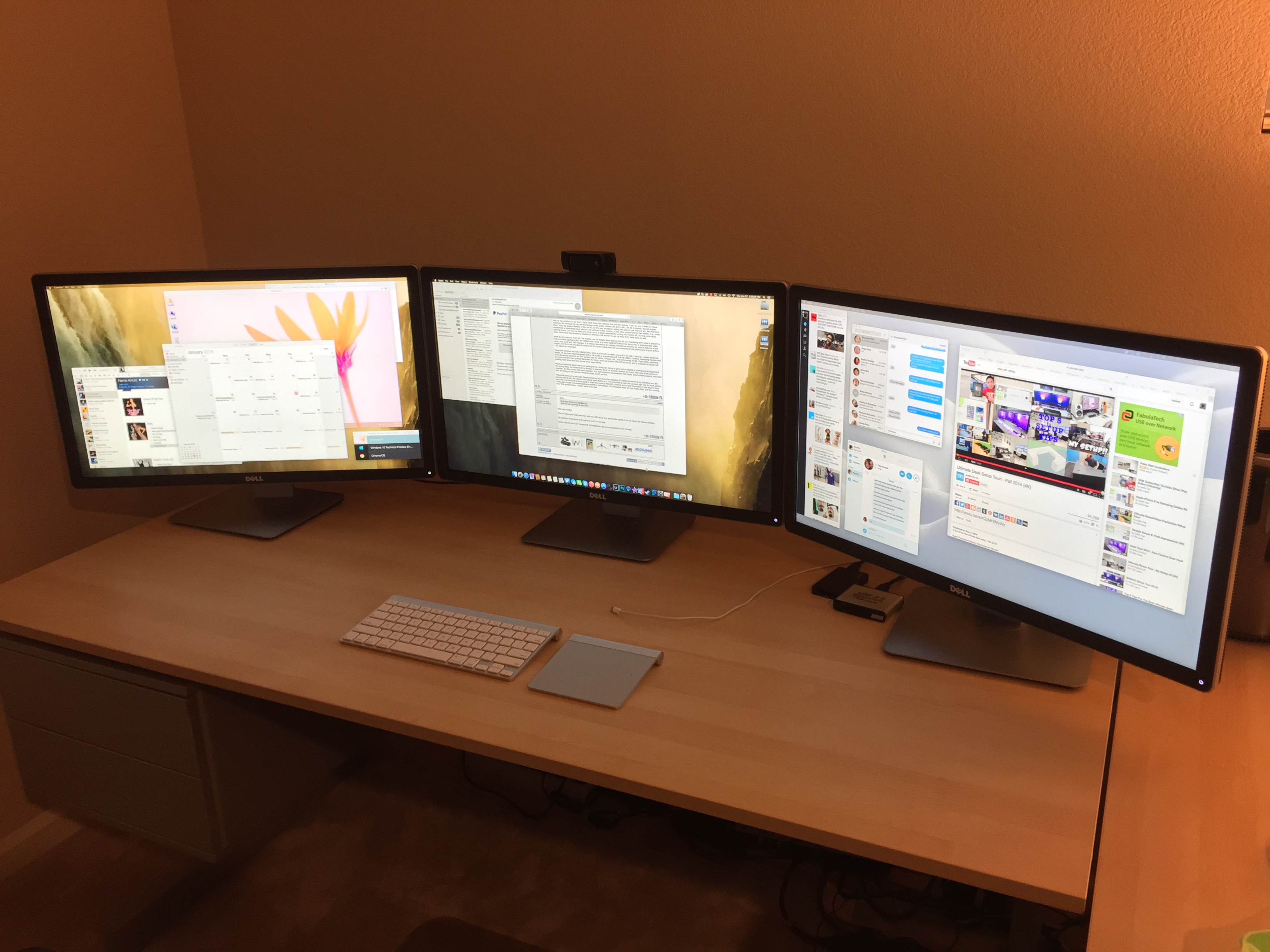

DP monitors are left and right running at 60Hz. Center monitor HDMI at 30Hz.
Ok, that's officially ridiculous! :p
