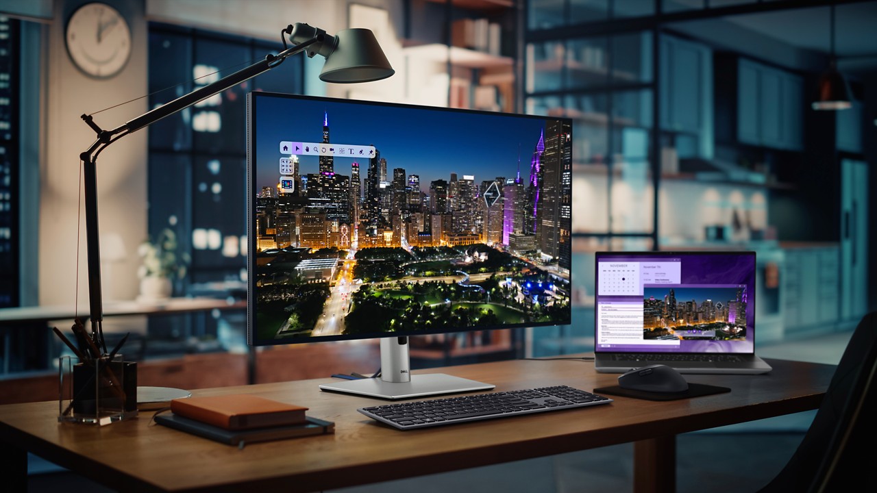

Dell has announced two new business monitors, the U2725QE and U3225QE, which join the UltraSharp series and introduce an interesting innovation. The 27-inch and 31.5-inch models feature a groundbreaking IPS Black panel. While previous versions achieved a contrast ratio of up to 2000:1, these new models promise an impressive 3000:1.

Nice to see the new. As we were discussing on another thread, the new line up raises some question. Dell's 2 IPS-based 4K new displays are 27" and 32", both at 120-Hz refresh rate, 3,000:1 contrast ratio, have Thunderbolt 4 and are 'hub monitors.' The 27" is around $700 and the 32" around $950.
Adding to the 'what to buy' confusion, Dell also announced the Dell 32 Plus 4K QD-OLED Monitor for roughly $800 - 32", 120-Hz refresh rate, USB-C but not Thunderbolt (near as I can tell), has 'spatial audio technology,' doesn't list as a 'hub monitor.'
Here's a link to a Dell page on them.
This makes the decision fork/tree for display shoppers in the $700 - $950 range complicated. I'll throw in a non-Dell contender; the roughly $800 ASUS ProArt Display PA27JCV 27" 5K. You get IPS Black panel, 3,000:1 contrast ratio, 60-Hz refresh rate but the lauded 5K resolution ('retina' resolution, roughly 220 DPI) preferred for Macs over 4K with 27" displays. USB-C, not Thunderbolt.
So, in that price range, what do you go for? The ASUS for 5K? The cheaper 4K Dell? If you're going to spring for the $950 4K 32" Dell over the $800 5K 27" ASUS, how compelling is the OLED and spatial sound option at $800?
If a key edge of the Dell is high refresh rate, how much is that because of gaming? A lot of gamers like OLED. In the 32" range, the new OLED is actually cheaper than the IPS black, plus you get spatial sound but lack Thunderbolt 4.
What do you guys think you would choose?

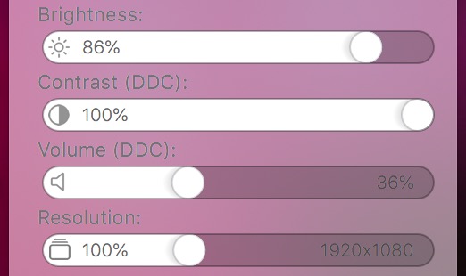

I have the Dell UE2723QE and am using it right now with my 2018 Mini.
The OS is Mojave (still) and I also have BetterDisplay running (free version).
I DO NOT have speakers connected to the display.
For sound, I use headphones connected directly to the Mini.
If I bring up the BetterDisplay pane on the menu bar, I see this:
You can see an entry there for "Volume (DDC)".
So it looks like BetterDisplay can control -something-.
Not sure if that would be speakers "internal" on the display or external speakers connected "through" the display.
