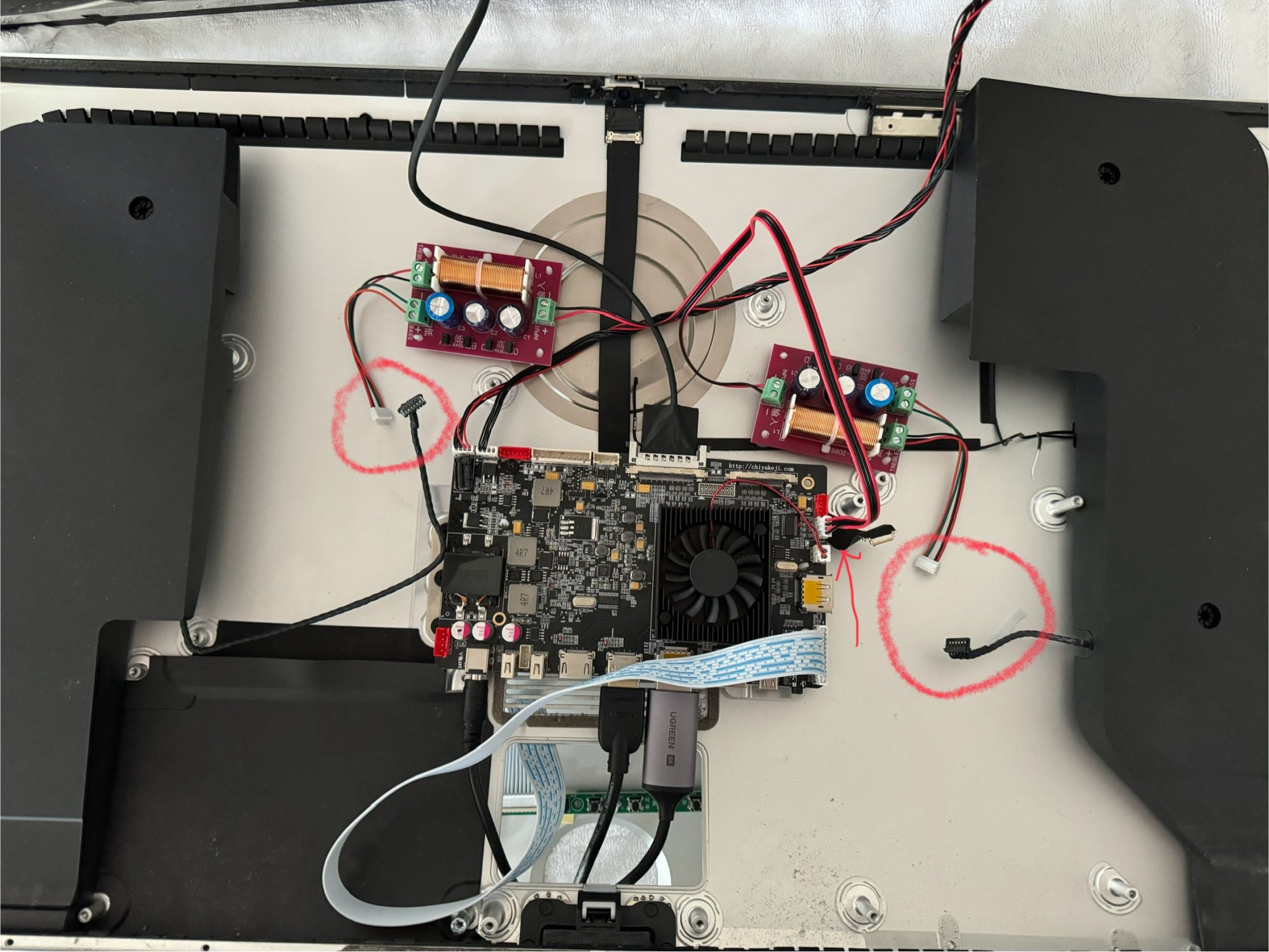

Hi, I ordered the same cross over kit as your post above for my iMac speakers for my late 2015 27 inch iMac. I’ve also got the same R1811 V4 board. Before I hook it up, just wanted to ask a couple of simple questions if you don’t mind:)
1. Does it matter which of the cross over ”units” that I attach to the iMacs speakers (ie is one for the right speaker and one for the left speaker? Or, they’re interchangeable?
2. Is there a specific way the cross over connector for each unit plug into the iMac’s speaker that I need to be aware of?
I’ve attached a picture of my iMac. I haven’t connected or mounted of it as of yet.
Thanks in advance!

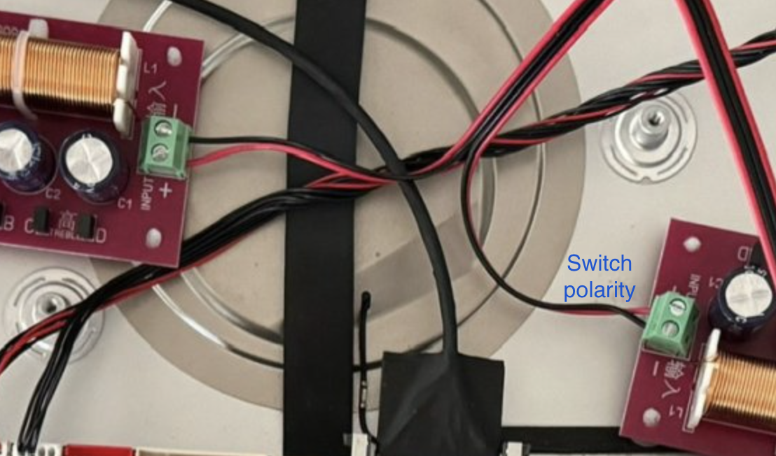

I have exactly the same setup.
1. Pinout is L+ L- R- R+, top to bottom. Correct crossover location on your photo.
2. I had to connect one crossover with reversed polarisation (switch + -),right speaker, to have the sound in phase.
This was discovered by PaulD-UK. The polarisation on the R1811 card is labeled wrong.

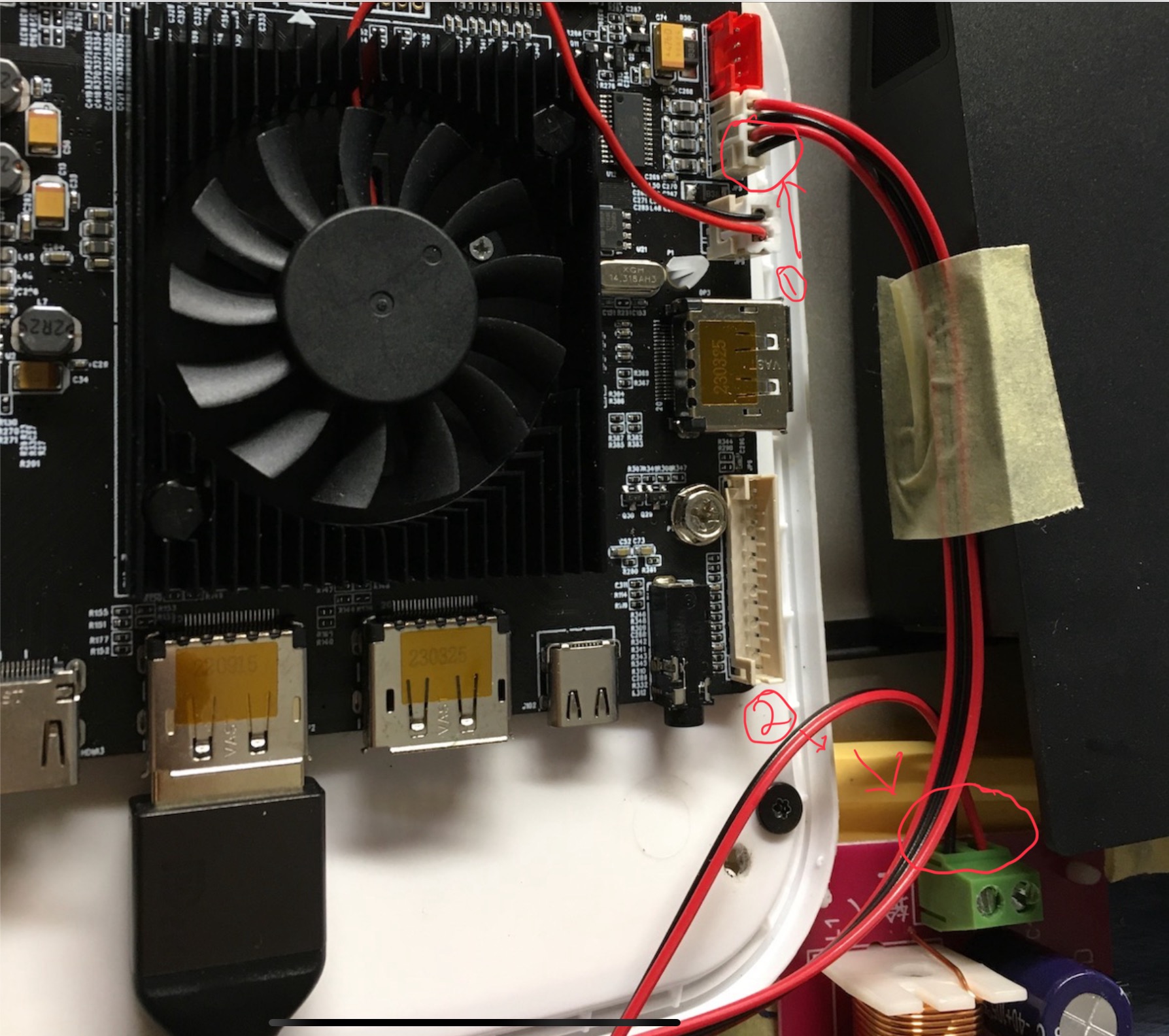

Thanks for this! I saw your posts along with PaulD-UK back in November but didn’t really understand when I first read it. It’s becoming clearer now. If my understanding is correct, what you and PaulD-UK are saying is:
- The Pin positions on the R1811 board itself are (from top to bottom) in this picture you posted in November: L+ L- R- R+ (See picture label #1).
The cables coming from the Cross over unit connected to the right speaker (see picture label #2) are correctly in the + and - position (ie red wire is connected to the + and black wire connected to the -.
- The problem is that when connecting the cross over 4 wire bundle into the R1811 board, the wires for right speaker (ie the two on the bottom (when looking top to bottom) are reversed in that: The black (ie negative) wire is on the bottom and is therefore plugging into the boards (R+) connection (* ie mismatch). And, the red (ie positive) wire (2nd from the bottom) is therefore plugging into the boards (R-) connection (ie a mismatch). Is this correct?
-The solution therefore is: Reverse the wires on the cross over unit connected to the right speaker (ie red wire in the ”negative” side and black wire in the “positive” side.
Is my understanding correct?
Yes, reverse the wires label #2. That is correct 👍
And for the record, I didn't understand it at first either ;) But the sound test made it very clear

A pleasure. I still have mine taped up. In case I will try to do something like PaulD-UK and Aiwi with port outlets
I switched the red/white wires on the right side crossover and plugged everything in and everything sounds good from the iMac:). So, I guess I got everything hooked up correctly. The only thing is that the volume is fixed at a certain level and I can’t change it.
