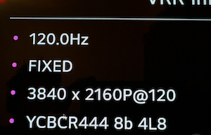

201388-A, VMM7100. Flashed => Only 4k120Hz YCBCR444 8b :(. Animations on MacOS are also very jittery withit (for example, switching desktops)

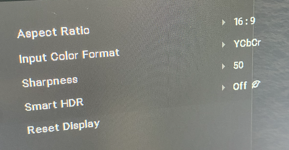

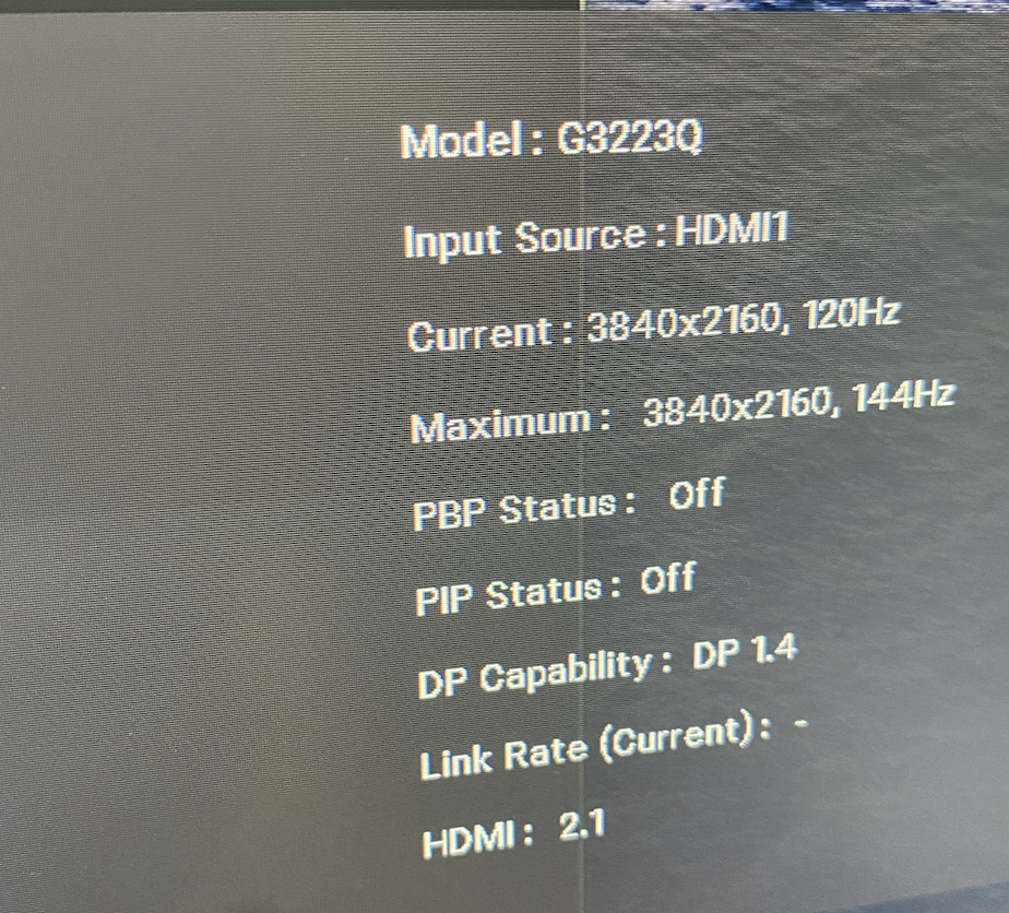

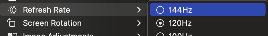

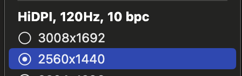

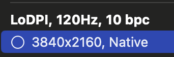

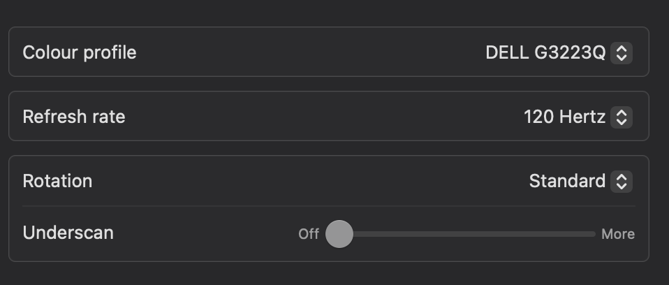

I'm not sure if I missed something but I'm using it with a Dell 32" 4K Moniter - G3223Q not a TV per say. I am still getting the same issue another person mentioned which is that after sleeping the display doesn't seem to pickup the connection till I unplug and plug it back in (this is on the firmware update I got from CableMatters).
I still haven't tried with the modified firmware but I can do if it's safe and won't destroy the display.
I'm currently running it at a lower resolution for HiDPI but it can go to the full 4k resolution.

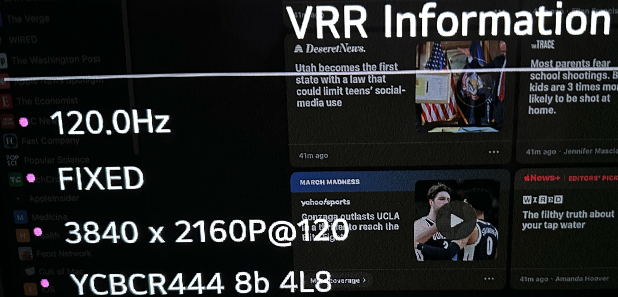

@AironMan here is my LG OLED C2 55" VRR report:
Mac Studio M1 Max ==> Thunderbolt 4 ==> Cable Matters 201388-A w/VMM7100 and Spyder_fw_USBC_CM_7.02.130forMac.fullrom firmware ==> HDMI 2.1 port on LG OLED C2. I'm also using your supplied EDID.

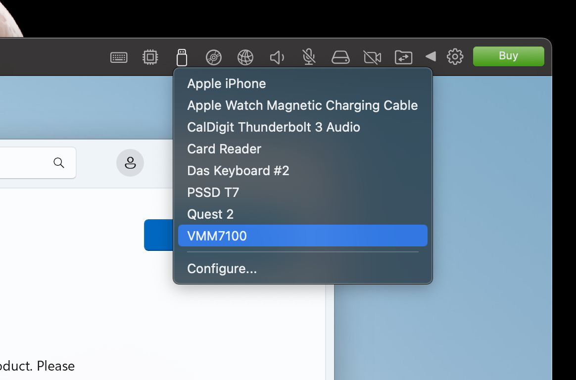

First of all: you CAN flash the cable with a Mac!
As mentioned by @Skowt (#291) Synaptics has a different tool for flashing "VmmHIDTool". It is available in MS Store: https://apps.microsoft.com/store/detail/vmmhidtool/9PDS6MLXXS7S and requires no MS account login to download. This tool can be used on a VM via Parallels with a standard Win11 install using the wizard in Parallels:
You simply need to make sure the USB portion of the adapter is passed to the VM. If it doesn't work immediately unplug the USB part of the cable and reconnect it. Then pick to connect to Windows directly.

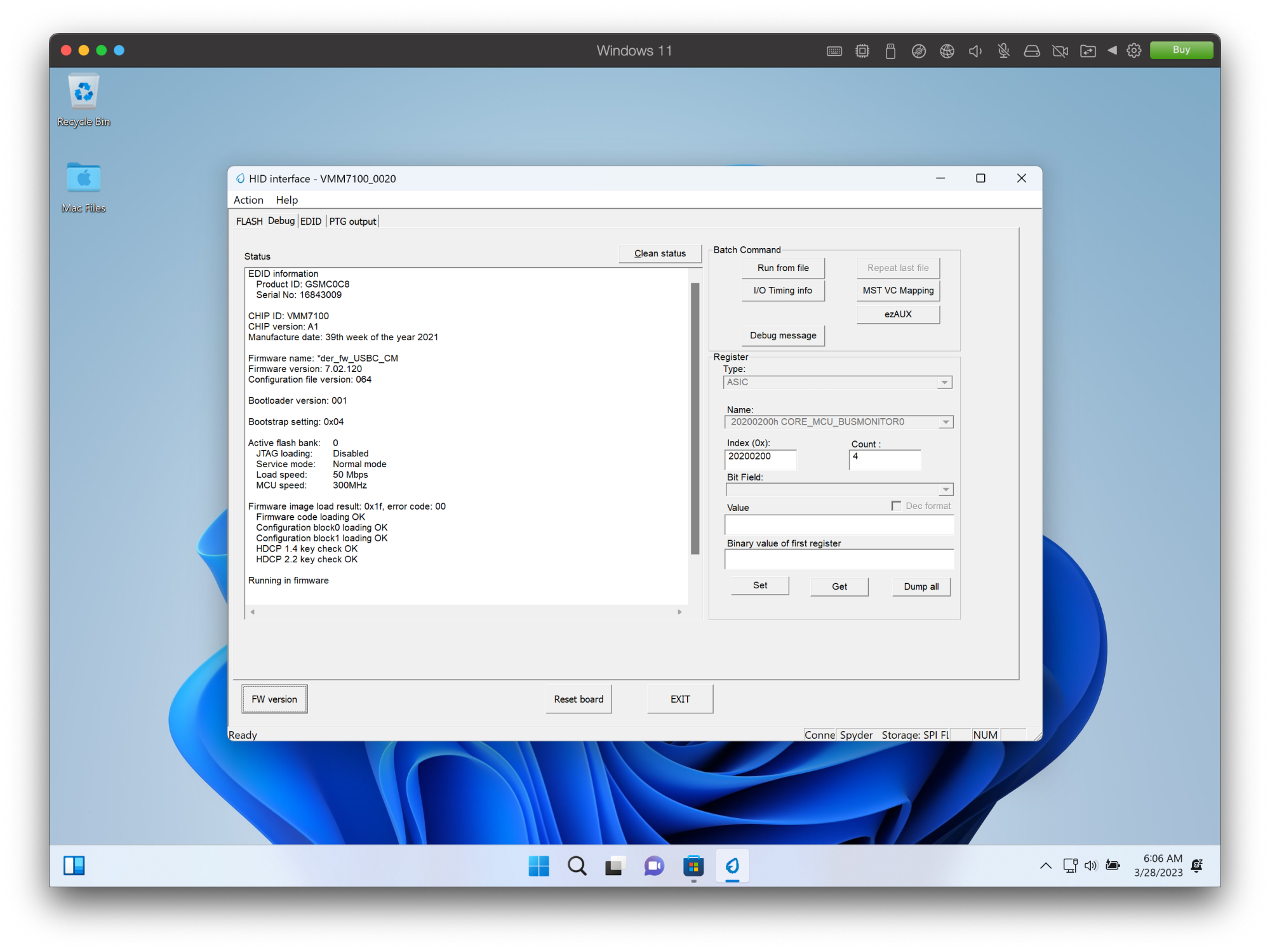

I played with the "Debug" tab in the Synaptic's tool and it has a very nice function - Dump All registers. On firmware .130 it shows more information than just "FW VERSION" button:
- SST 4 lanes HBR3
- DSC enabled on the DP side
- "DSC decompression enabled" -> suggesting that the chip is stripping DSC when needed, i.e. the lack of reported DSC on the display has nothing to do with Mac using DSC or not
- "3840x2160@119.99Hz YUV444 8bpc" for RX (i.e. DP) suggesting that Mac is using 444
- On the TX (HDMI) side thou: "HDMI2.1 FRL 3Lane 6GHz" ... "3840x2160@119.99Hz YUV420 8bpc" suggesting that negotiation on HDMI fails to reach 444... crappy cable from CM? Sometimes I see "digital snow" or green screen when connected.

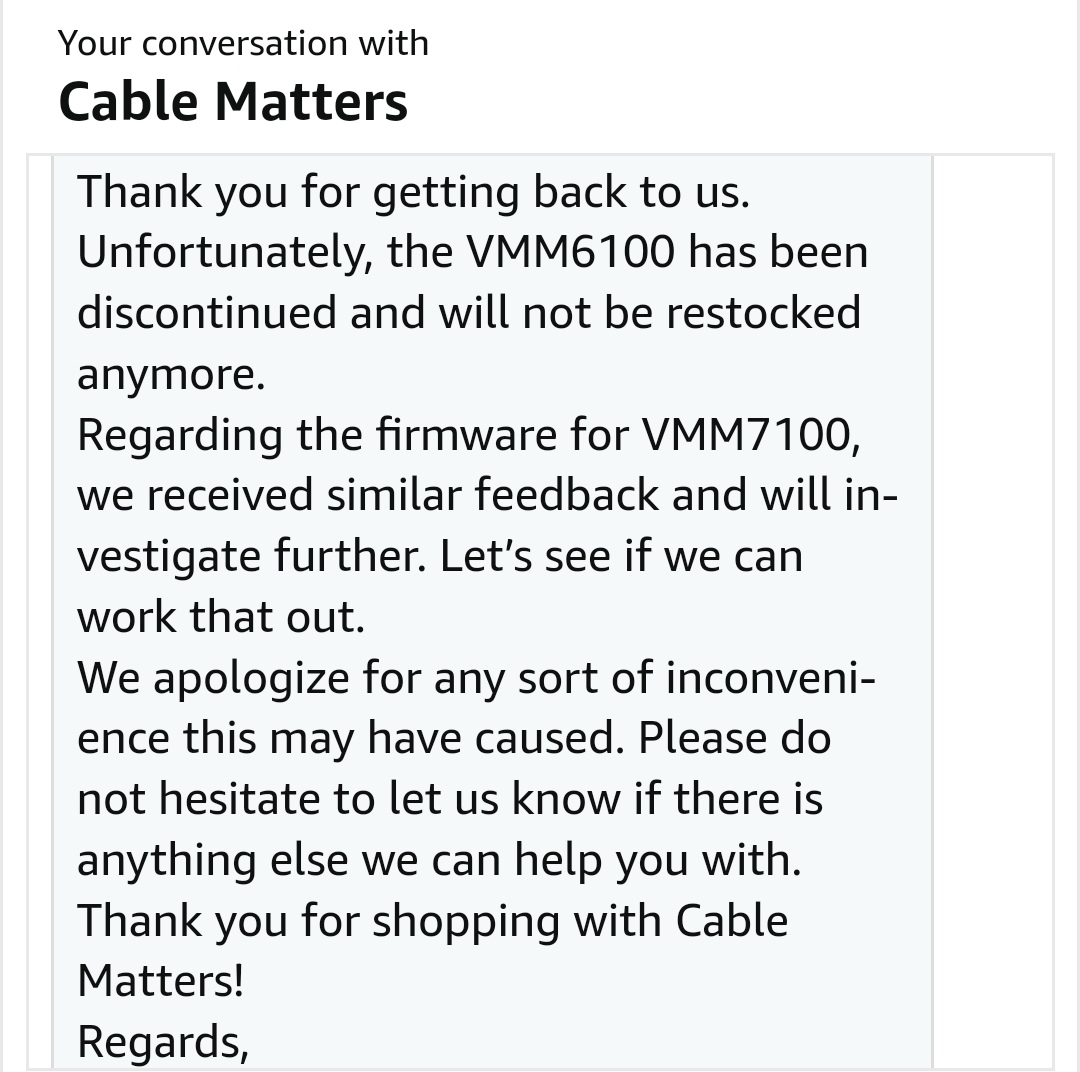

I contacted cable matters on Amazon regarding their USB-C to HDMI adapter asking for the VMM6100 chip, but they've told me that it has been discontinued and won't be restocked anymore which means they will only ship the VMM7100 chip adapters.
Screenshot_20230328_185650_com.amazon.mShop.android.shopping_edit_458512571805556.jpg
Reactions: dabotsonline
Can confirm that - got a similar response + they're shipping VM7100 from https://www.amazon.com/dp/B08MSWMXT4 (201388-GRY).

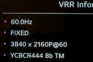

Ok, I've got it working with VMM7100; the connection is stable.
TL;DR:
  • You will get 4K@120 YCBCR444 8b 4L8 [more on the last part later]
    • 10b isn't supported and there's no HDR as of now
    • RGB doesn't work but 4:4:4 is identical
  • You need firmware v7.02.102 from #298 (released 2023/03/23)
  • Tested on CM 201388-GRY
    • It is the standard non-slim male USB-C => female HDMI
    • This does not work on 201362-GRY-1.8m-E (male USB-C => male HDMI) and most likely no firmware can fix that
  • No EDID editing needed on macOS
  • If it doesn't work replace your HDMI cable, even if it's "2.1 certified"
v7.02.102 is a debug build
Some of the options in the Vmm app are only available with special build of the firmware. The one shared to @AironMan presumably by the support seems to be such a special build. By default the chip offers a few interesting options:
  • Reading firmware details (Debug => "FW version" button)
  • Reading final negotiated TX and RX parameters (Debug => "I/O Timing info" button)
  • Reading EDID ("EDID" tab)
  • Following negotiation sequence (Debug => "Debug message" button); this one as the app warns isn't available in retail firmwares

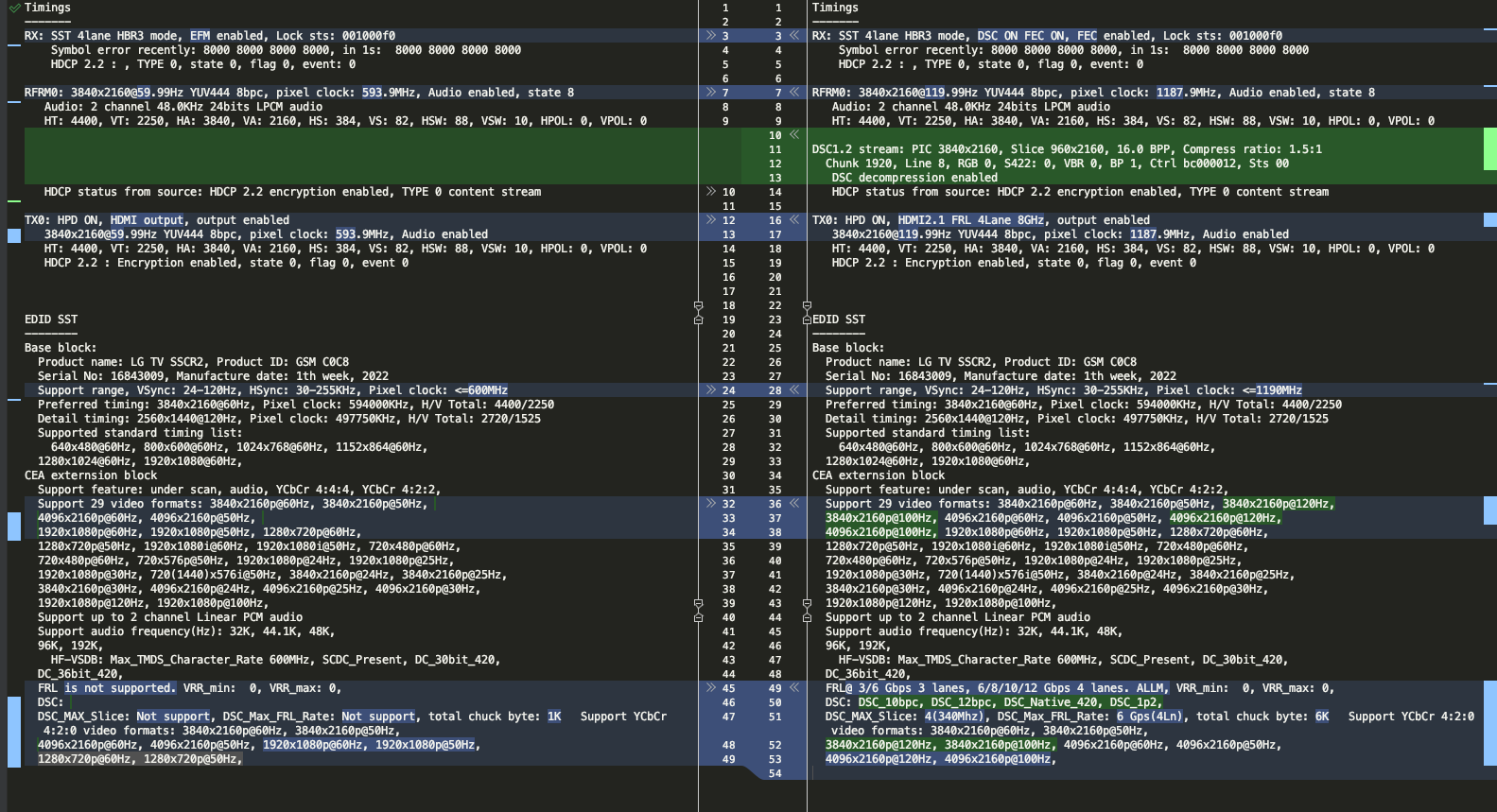

The timings dump gives some details about that:
Code:
RX: SST 4lane HBR3 mode, DSC ON FEC ON, FEC enabled, Lock sts: 001000f0
    Symbol error recently: 8000 8000 8000 8000, in 1s:  8000 8000 8000 8000
    HDCP 2.2 : , TYPE 0, state 0, flag 0, event: 0
RFRM0: 3840x2160@119.99Hz YUV444 8bpc, pixel clock: 1187.9MHz, Audio enabled, state 8
   Audio: 2 channel 48.0KHz 24bits LPCM audio
   HT: 4400, VT: 2250, HA: 3840, VA: 2160, HS: 384, VS: 82, HSW: 88, VSW: 10, HPOL: 0, VPOL: 0
DSC1.2 stream: PIC 3840x2160, Slice 960x2160, 16.0 BPP, Compress ratio: 1.5:1
  Chunk 1920, Line 8, RGB 0, S422: 0, VBR 0, BP 1, Ctrl bc000012, Sts 00
   HDCP status from source: HDCP 2.2 encryption enabled, TYPE 0 content stream
TX0: HPD ON, HDMI2.1 FRL 4Lane 8GHz, output enabled
   HDCP 2.2 : Encryption enabled, state 0, flag 0, event 0
This shows:
  • Separate negotiation with DSC on both DP and HDMI
  • The reason why YUV and not RGB is negotiated may be related to DSC optimization. Looking at the DSC & FEC overview docs it clearly specifies that RGB sources are converted to YUV at the start of DSC flow (see slide 14). Presumably converting it back to RGB for HDMI would be just a waste of resources (4:4:4 and RGB are functionally equivalent)
  • It clearly states that the stream is recompressed ("DSC decompression enabled")
What's the deal with EDID?
So, we're not the only ones editing EDID :D The VMM chips found in these adapters don't pass the EDID 1:1 from the HDMI side to DP. Depending on how the firmware is configured it will do different things. This makes sense as you cannot tell macOS that the display is HDMI as different things will be available with regards to DSC/HDCP/resolutions etc. So us editing EDID here is just patching an issues in the decision tree in the VMM firmware. However, ideally the chip should do the negotiation correctly, but it seems like it's not a trivial task with the number of permutations supported by both DP and HDMI.
Here's my original EDID as reported on the newest official software from CM (v7.02.120) by the VMM itself:
Code:
Base block:
  Product name: LG TV SSCR2, Product ID: GSM C0C8
  Serial No: 16843009, Manufacture date: 1th week, 2022
  Support range, VSync: 24-120Hz, HSync: 30-255KHz, Pixel clock: <=600MHz
  Preferred timing: 3840x2160@60Hz, Pixel clock: 594000KHz, H/V Total: 4400/2250
  Detail timing: 2560x1440@120Hz, Pixel clock: 497750KHz, H/V Total: 2720/1525
  Supported standard timing list:
    640x480@60Hz, 800x600@60Hz, 1024x768@60Hz, 1152x864@60Hz,
  1280x1024@60Hz, 1920x1080@60Hz,
CEA externsion block
  Support feature: under scan, audio, YCbCr 4:4:4, YCbCr 4:2:2,
  Support 29 video formats: 3840x2160p@60Hz, 3840x2160p@50Hz,
  4096x2160p@60Hz, 4096x2160p@50Hz,
  1920x1080p@60Hz, 1920x1080p@50Hz, 1280x720p@60Hz,
  1280x720p@50Hz, 1920x1080i@60Hz, 1920x1080i@50Hz, 720x480p@60Hz,
  720x480p@60Hz, 720x576p@50Hz, 1920x1080p@24Hz, 1920x1080p@25Hz,
  1920x1080p@30Hz, 720(1440)x576i@50Hz, 3840x2160p@24Hz, 3840x2160p@25Hz,
  3840x2160p@30Hz, 4096x2160p@24Hz, 4096x2160p@25Hz, 4096x2160p@30Hz,
  1920x1080p@120Hz, 1920x1080p@100Hz,
  Support up to 2 channel Linear PCM audio
  Support audio frequency(Hz): 32K, 44.1K, 48K,
  96K, 192K,
    HF-VSDB: Max_TMDS_Character_Rate 600MHz, SCDC_Present, DC_30bit_420,
  DC_36bit_420,
  FRL is not supported. VRR_min:  0, VRR_max: 0,
  DSC:
  DSC_MAX_Slice: Not support, DSC_Max_FRL_Rate: Not support, total chuck byte: 1K   Support YCbCr 4:2:0 video formats: 3840x2160p@60Hz, 3840x2160p@50Hz,
  4096x2160p@60Hz, 4096x2160p@50Hz, 1920x1080p@60Hz, 1920x1080p@50Hz,
  1280x720p@60Hz, 1280x720p@50Hz,
and here's my EDID after flashing the v7.02.102 from #298 (released 2023/03/23):

This is what e.g. LG reports in their "VRR Information"! When you see something like "YCBCR444 8b TM" you know that the HDMI operates in TMDS mode ("TM"). When the FLR mode is active the TV will report something like "YCBCR4448b 4L8", meaning 4 lanes of 8Gb/s each (FLR4 mode). It's worth mentioning that this bandwidth has nothing to do with Mac's Thunderbolt bandwidth.
vs.
The adapter, as you can see above can negotiate more rates as well: some slower (3L3, 3L6, 4L6) and some slower (4L10, 4L12). The means its capabilities are up to full 48Gb/s, that is the max bandwidth for current HDMI 2.1 spec. In FLR6 (48Gb, 4L12) the HDR is certainly possible, as we can get 4K@120Hz 4:4:4 12 bit. Even FLR5 (40Gb, 4L10) allows for 4K@120 4:4:4 10 bit. So far so good, but this is just the HDMI side - we know that adapter can (or at least reports) do it.

VMM7100 seems to be hard to brick as it uses two A/B flash banks. However, using "Save to file" and then "Load to FLASH" doesn't always work. Thus, restoring original firmware may not be possible in some instances.
I'm going to bed - if is screwed up something let me know ;)
TL;DR:
Code:
This shows:
Code:
Base block:
  96K, 192K,
  DC_36bit_420,
  DSC:
Code:
Base block:
  Support range, VSync: 24-120Hz, HSync: 30-255KHz, Pixel clock: <=1190MHz
  Support 29 video formats: 3840x2160p@60Hz, 3840x2160p@50Hz, 3840x2160p@120Hz,
  3840x2160p@100Hz, 4096x2160p@60Hz, 4096x2160p@50Hz, 4096x2160p@120Hz,
  4096x2160p@100Hz, 1920x1080p@60Hz, 1920x1080p@50Hz, 1280x720p@60Hz,
  96K, 192K,
  DC_36bit_420,
  FRL@ 3/6 Gbps 3 lanes, 6/8/10/12 Gbps 4 lanes. ALLM, VRR_min:  0, VRR_max: 0,
  DSC: DSC_10bpc, DSC_12bpc, DSC_Native_420, DSC_1p2,
  DSC_MAX_Slice: 4(340Mhz), DSC_Max_FRL_Rate: 6 Gps(4Ln), total chuck byte: 6K   Support YCbCr 4:2:0 video formats: 3840x2160p@60Hz, 3840x2160p@50Hz,
  3840x2160p@120Hz, 3840x2160p@100Hz, 4096x2160p@60Hz, 4096x2160p@50Hz,
  4096x2160p@120Hz, 4096x2160p@100Hz,
The differences become visible right away when diffed:
In other words, the new beta firmware enabled FRL signaling in addition to TMDS. FRL allows for proper DSC support... and guess what: FRL is optional in HDMI 2.1 spec. This is a big can of worms of everything-is-optional (see a good article about that).
Since the FRL is now reported correctly, along with ALLM as well which is a great bonus, eliminating manual game mode setting on many TVs, the 4K@120 4:4:4 is possible... and maybe more ;)
In addition, the EDID editing in AW EDID Editor isn't needed because the adapter applies exactly the same changes. If you export EDID on v7.02.102 from BetterDisplay and open it in AW the version will be at 1.4 with Interface: DisplayPort.
Can we get HDR & multiple HDMI protocols
Well, USB-C is a mess but HDMI isn't any better. With HDMI 2.1 we've got a new signaling protocol: FRL. A nice benefit of FRL negotiation is that the bandwidth is known upfront after handshake. There're also handy tables with FRL parameters available. In my example above the HDMI negotiates a full HDMI 2.1:
Code:
View attachment 2180522 vs. View attachment 2180523
To make it work the DP side, negotiated on the Thunderbolt port, must also be able to send such a signal. My VMM7100 reports "RX: SST 4lane HBR3 mode", with DSC being enabled and used on the v7.02.102 from #298. With HBR3 the bandwidth available (25.92Gb/s) allows for maximum of 4K@98Hz 4:4:4 10b when DSC isn't used (~26Gb/s). To achieve 4K@120Hz 10b either 4:2:2 or DSC must be used (~32.27Gb / 1.5 ~= 21.5Gb/s).
Thus, HDR with 4K@120Hz looks to be possible, if I'm reading tables on Wikipedia correctly.

CM adapter vs cable
Did I mention that "cables are everything"? Well, the CM adapter with HDMI cable doesn't seem to be very stable. Most of the time the CM cable will either fail HDMI training for 4L8 or will simply downgrade to 4:2:0. I was able to get full 4K@120 4:4:4 8b with FRL 4L8 a few times, but it was short-lived and ended up with "digital snow" after under a minute, multiple link retrains and a failure in the end.
CM adapter, running the exact same firmware, works perfectly and is stable given a good HDMI-HDMI cable. Thus my personal recommendation is to avoid CableMatters 201362-GRY-1.8m-E (male USB-C => male HDMI). The software side is working correctly, but the HDMI cable attached to the adapter doesn't seem to be good enough to work to the full potential of VMM7100. This obviously may change in the future.

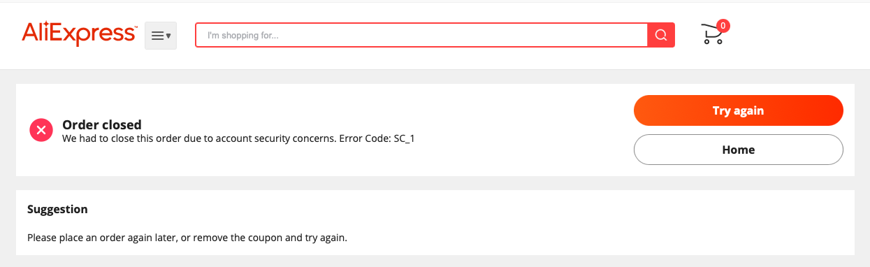

The Moshou only cost 20€ : Aliexpress LINK

The biggest problem seems to be that VMM6100-based cables/adapters are completely unavailable in any major retailers in the US. There're some for ~$25 on eBay but shipped directly from China, so there's no guarantees what we get - the situation may be similar like with the CM cables as VMM6100 is being discontinued overall.
I have an email chain with CM so maybe they can explain if 7100 & RGB isn't possible at all or that's a temporary setback.
Iam also in contact with them, but like I say before, they spend Month and it does still not work correctly. They dont know why the vmm6100(With special Firmware Version) works and why the vmm7100 not.
All right, ordered my 201388 adapter the other day, just arrived today - I received the GRY version. I don't feel left out anymore lol.
I just got another one.... -A.
Also, you may not want to force RGB color over 4:4:4 when DSC is used. This will cause internal color conversion and may result in worse results. You can learn a lot about the VMM chip capabilities from the HID tool itself.
