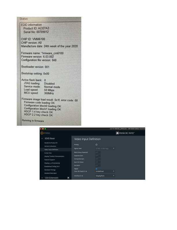

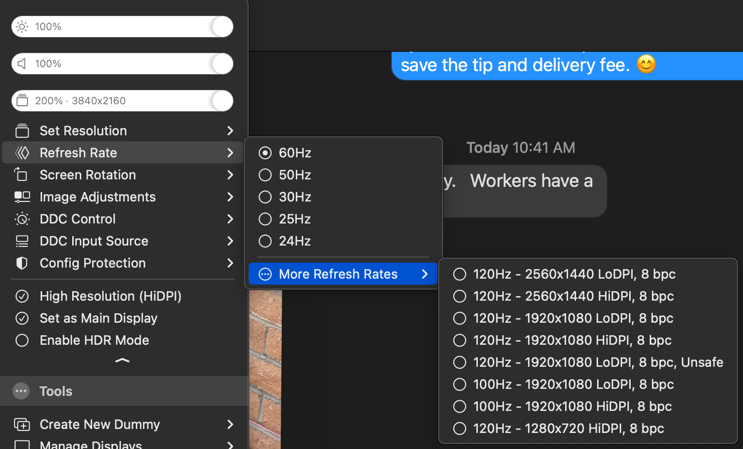

2023-03-20 Today I followed all of the instructions and applied the firmware to my Cable Matters adapter with the VMM6100 chip. See proof below. I edited and uploaded the EDID with the 'DisplayPort' setting. I rebooted my Mac Studio and when it still didn't include 120Hz options I unplugged and replugged the adapter several times. Still no 120Hz settings. See BetterDisplay resolution options below.
Any suggestions?
Any suggestions?

The checkbox in BetterDisplay Version 1.4.6 Build 14593 for EDID override options - Automatically apply custom EDID upon detection of this display is checked per step #6. I'm using Mac Studio M1 Max + LG OLED C2 55" + cable matters 201388 VMM6100 with proper firmware as supplied on page 1 of this forum.

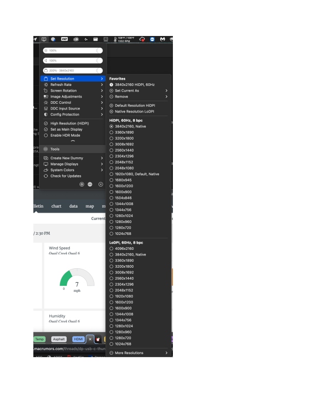

I redid all of the steps without any change. I should mention that my 60Hz is at 3840x2160. BetterDisplay offers me the below 120Hz options, but they are all lower resolution. Still not working for me.

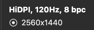

I can successfully switch to HiDPI 120Hz, 8bpc 2560x1440. However, that isn't what I want for a resolution.

Yeah that 2560x1440 max means you still have a problem.
At this point, the next steps you really need to take are to borrow another M1 Mac and/or Windows PC with an HDMI 2.1 GPU so you can confirm if the problem lies on the display end, or the Mac/adapter end.

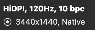

On the same Mac M1 thunderbolt/usb-c output, I am connected into my Dell AW3420DW monitor with DisplayPort at 4k120Hz10bpc. So I believe that my Mac M1 video signal performs as expected. I tried a different TV port and a different HDMI 2.1 cable between the TV and the Mac. No luck.

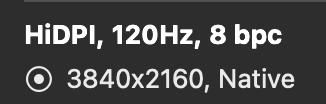

Wow! I used the EDID in the instructions rather than using my own edits. Now I am at 3840x2160 120Hz, 8bpc. Not sure why others have 10 bpc, but THANK YOU!!!
(from BetterDisplay)
(from the Mac Display Data)

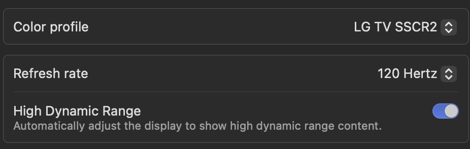

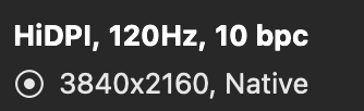

More info on my setup experience. Above I was setting up the Cable Matters 201388-GRY with the VMM6100 chip. The best I could do was HiDPI 120Hz, 8bpc at 3840x2160. With this adapter, I have HDR.
Since then I was able to get the Cable Matters 201388-A with the VMM7100 chip to produce HiDPI 120Hz, 10bpc at 3840x2160. I applied the firmware that @AironMan shared previously for the VMM7100. And I used his EDID file as well. With this adapter, I do not have HDR.

The 8b showing in BD are not correct. It is 10b. u can test this when pressing many 3-4 times fast the Green Button on LG Remote.

This is also present on my Pro Display XDR showing in SRX and BD 8b. On my LG C2 OLED some time it shows 10b but most of time 8b. I dont know what this issue in Display Color Depth is. I also ask some time ago @stevemr123 but he says that this information comes from MacOS. But it is 100% 10b because a lot of people, like me, test some patters and can confirm it's 10b. I report this also to apple, but nothing happened. But ure informations are very interesting.
Hi guys, BetterDisplay will show 10bpc if `samplesPerPixel` is 10 - for all other occurrences (even though the reported value is sometimes 16) the app will show 8bpc as I believe the latter result (16) is not real and I did not want to confuse anybody by showing 16bpc - but I did not investigate this further. The 8 vs 10 is solely about the framebuffer - the connection might as be as well 10bits especially as the dongle can do whatever it wants, the app won't take that into account. If the framebuffer depth is 8bpc then the TV showing 10bits is irrelevant, will not make the image any better. :)
(+ note: I think it is really difficult to discern the difference between 8 and 10 bits in any real life setting + I never saw anything else other than 8bit on my mini-LED 4K display@120Hz with direct displayPort or USB-C connection either - 10 bits shows up on my QHD test displays usually - so I'd be surprised if this would be any different for the LG TVs)

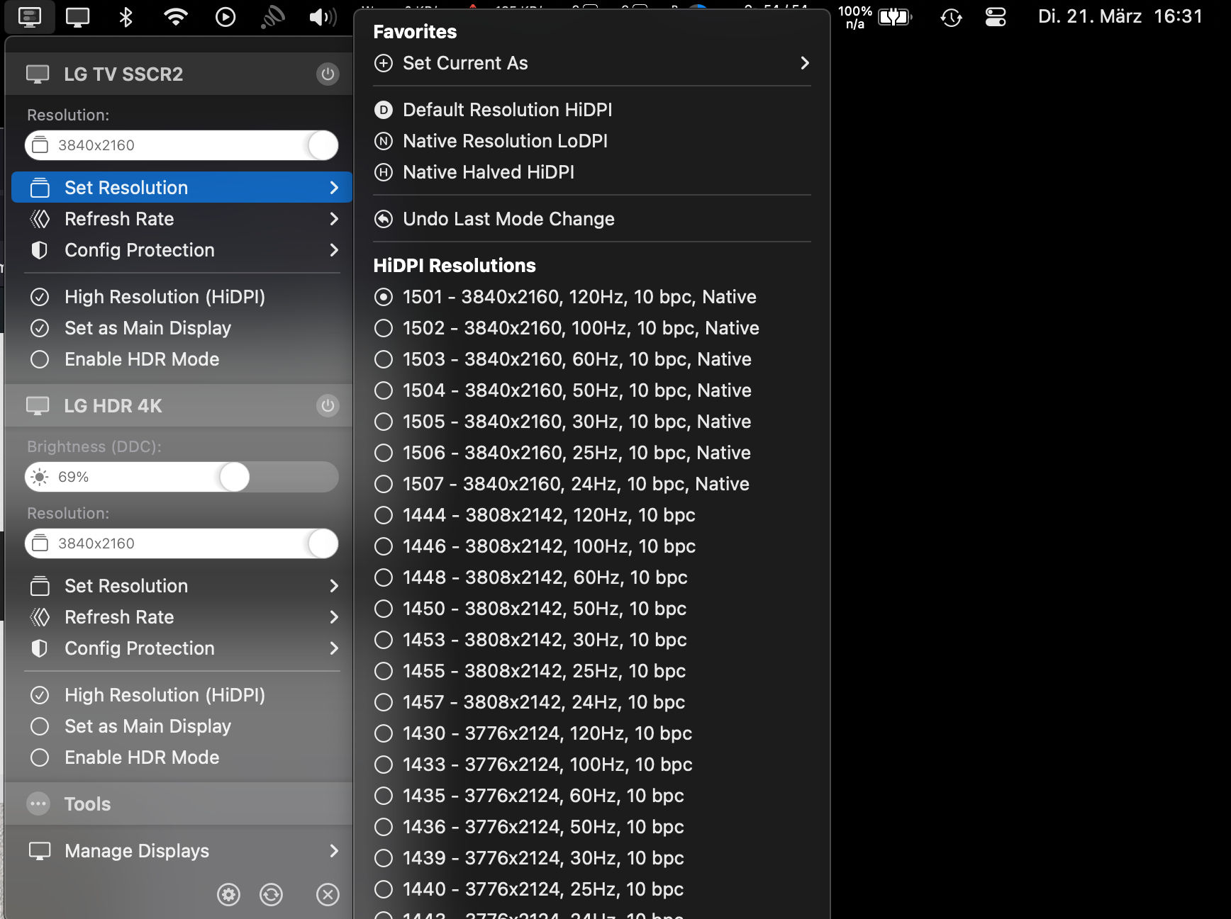

Yeah but the TV does not always show 10b. So if we can not reach 10b it almost show me 8b. Like i say my Pro Display XDR also shows me 8b. And there are some scenarios where i see 10b. And this scenarios it is like @joevt say, when using 2-3 Monitors, some time it shows me 10b when Macbook 16 M1 MAX Lid is open. Or some times it shows me 10b also when only 1 Display is connected.
Look here! Lid is closed but it's showing me 10b ! EDID is not touched...
