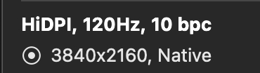

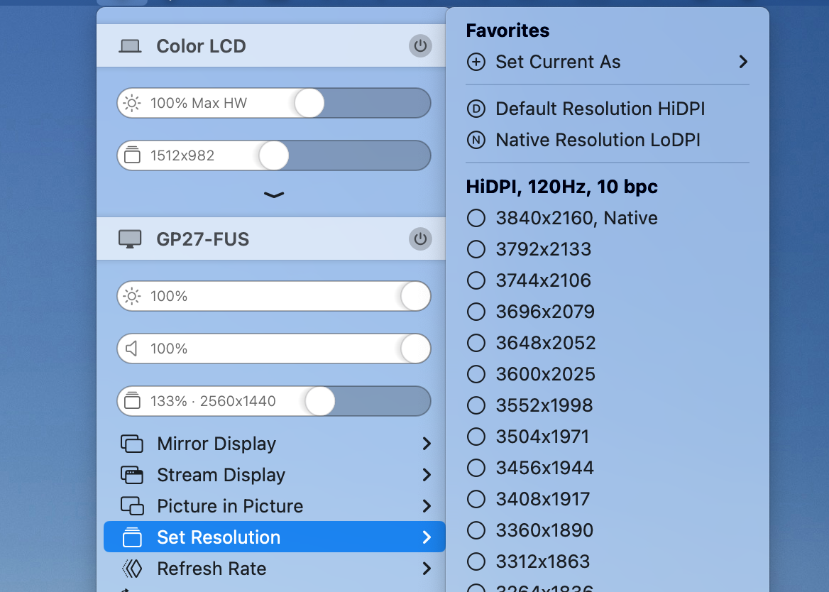

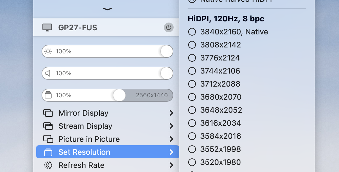

Hi guys, BetterDisplay will show 10bpc if `samplesPerPixel` is 10 - for all other occurrences (even though the reported value is sometimes 16) the app will show 8bpc as I believe the latter result (16) is not real and I did not want to confuse anybody by showing 16bpc - but I did not investigate this further. The 8 vs 10 is solely about the framebuffer - the connection might as be as well 10bits especially as the dongle can do whatever it wants, the app won't take that into account. If the framebuffer depth is 8bpc then the TV showing 10bits is irrelevant, will not make the image any better. :)
(+ note: I think it is really difficult to discern the difference between 8 and 10 bits in any real life setting + I never saw anything else other than 8bit on my mini-LED 4K display@120Hz with direct displayPort or USB-C connection either - 10 bits shows up on my QHD test displays usually - so I'd be surprised if this would be any different for the LG TVs)
Can u test with Ventura 13.3 RC ? I think its been fixed. I have 10b again today.
For me it's 8bits still with Ventura 13.3 RC. :) But as I said, I don't think it actually matters that much. You can't seem to change the setting manually and macOS does whatever it wants for no obvious reasons. There is also a slight chance that the reported bit depth is just not right. Framebuffer and connection bit depth can apparently can also be mismatched. 🤗
Note: after changing display modes a few times and closing/opening the lid like crazy, my external display just switched to 10bits (4K@120Hz, displayport). I don't really understand the logic behind it though and I am not sure if this is new or happened before just did not notice. 🤪 But there might be a change (improvement) in 13.3 after all.

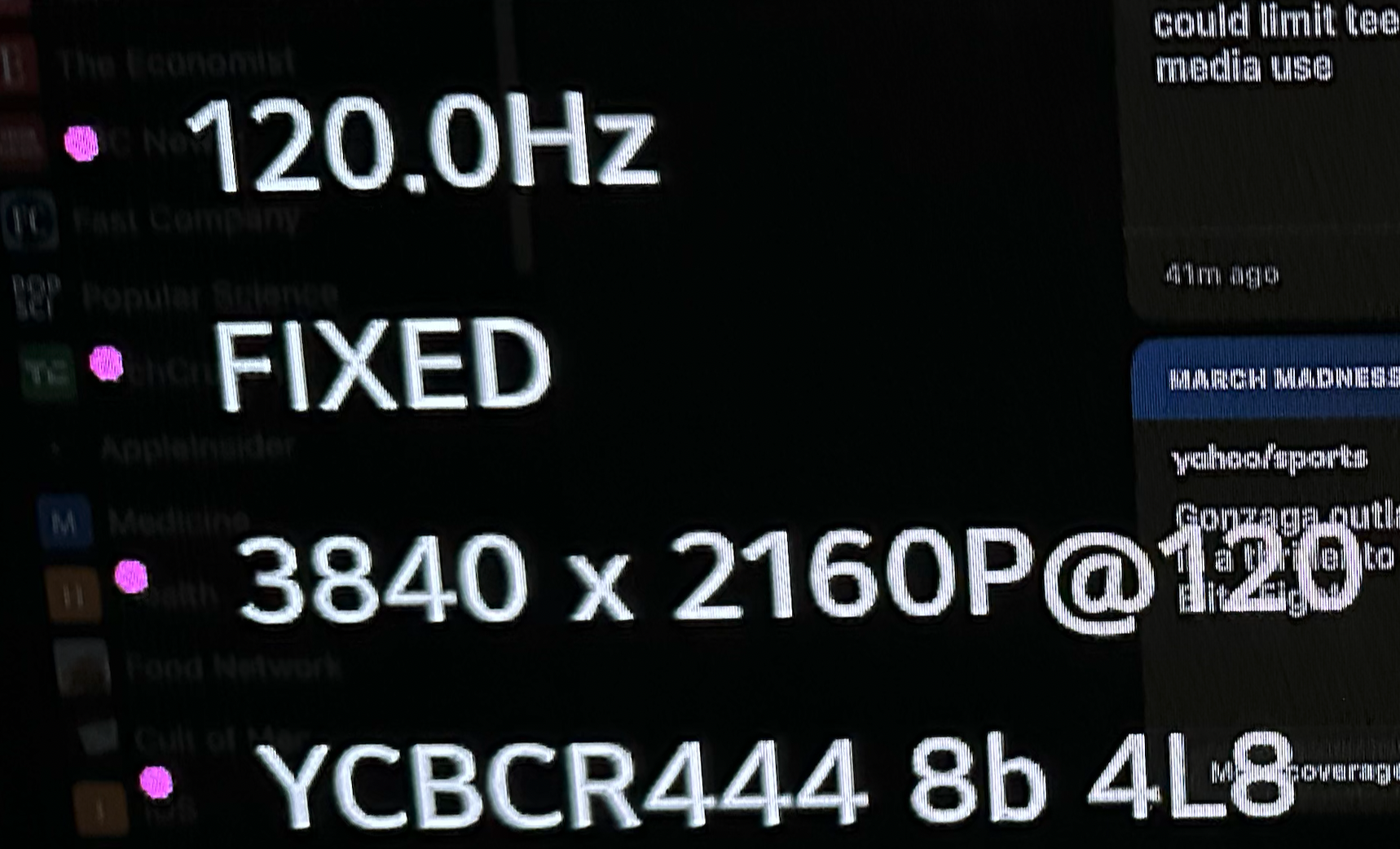

I was able to get BD to show 10 bit, but unfortunately it is not accurate. Using the VRR info on my LG I was able to get 24Hz at RGB 10 bit, but still the best I could do at 120 is YCrCb 444 8 bit.
@ASZ20 @davidawolf U guys have to check if ure on 4k@120hz RGB 4:4:4. Until now the VMM7100 can not get 10b and RGB4:4:4. @davidawolf have 4:2:0 so he can reach 4k@120hz. This disinformations are not good for this thread, so people can not understand what's going on here. Before post this type of posts plz check all specification on ure tv so u are 100% sure ure on 4k@120hz RGB 4:4:4. And if then plz post some screenshots or photos so we can confirm that u are on 4k@120hz RGB4:4:4.
Only the Anker VMM7100 with custom Firmware can reach 4k@120hz YCrCb 4:4:4 8b non HDR without EDID override. When u override the EDID u will only get 4:2:0 !
Ok. Now I know about the green button on the remote. Press 8 times and this comes up.
120Hz 3840x2160P@120 YCBCR444 8b 4L8. [Cable Matters VMM7100]
Would I do better with the VMM6100?

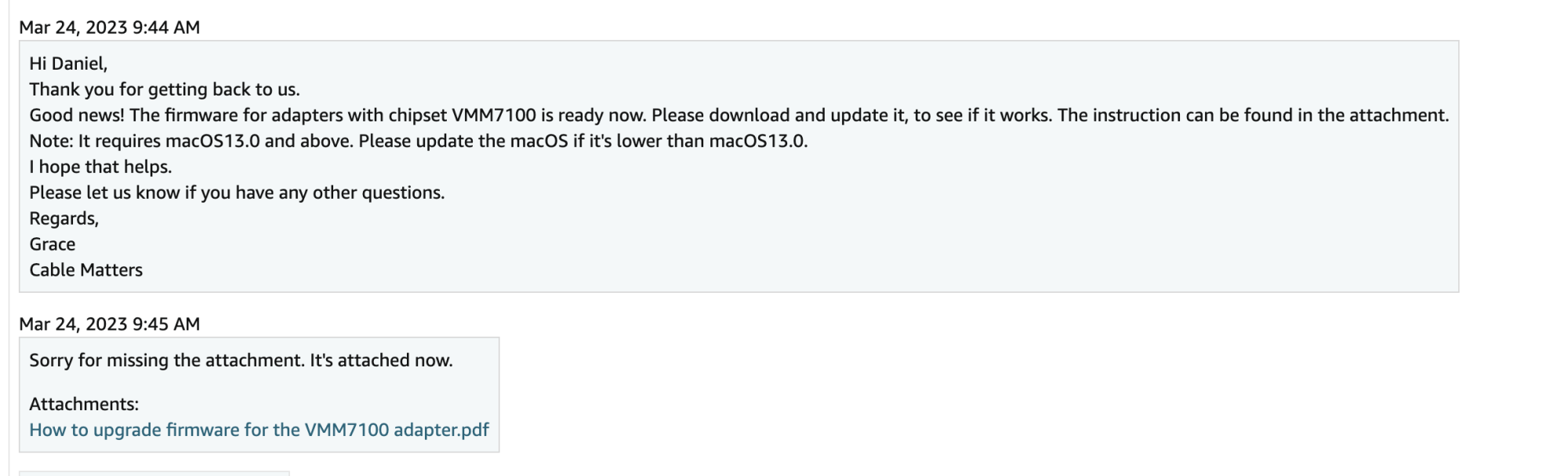

Registered to chime in here. I, like a couple of others on this thread, received a VMM7100 even though the Amazon listing indicated that I'd get the VMM6100. I reached out to them and this morning they sent me a firmware update that works for the VMM7100.
I actually ended up using Parallels to update the firmware via my M1 mac. The 'VmmDPTool64' exe didn't work but the 'VmmHIDTool' tool that came with it did! I backed up the firmware, then updated it and following that I now see options for 120Hz and 144Hz (which my monitor can go up to) although I haven't tested this with the adapter.
I'm not sure how to check but I am still getting YCBCR color codes although BetterDisplay reports 10bit 120Hz 3840x2160 resolution. So I'm not sure if the firmware now just needs to be modified like the others?
Let me know if this helps anyone! I'm happy for now, even if it's not 110% perfect.

The new Firmware does not work correctly, iam in contact with CM. The VMM6100 are still the best option.
The new modded VMM7100 Firmware are attached, but be carful it's only for testing. And plz confirm with screenshots and pictures if u can reach 4k@120hz RGB4:4:4. Normally there is no EDID override needed with this modded Firmware. But it does not work correctly on my setup.
