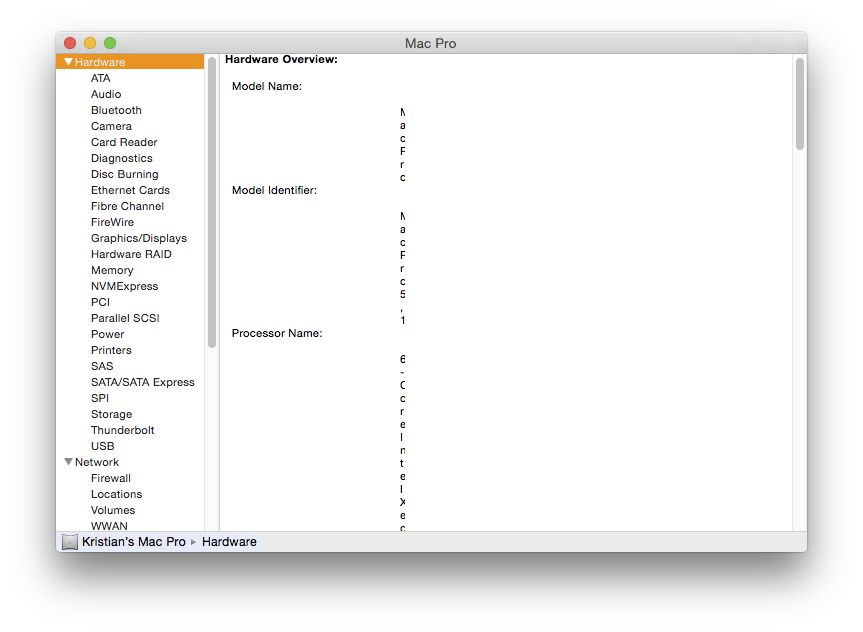

Edit: As a side-note: My System Report window sometimes look like this, with severely condensed table for the strings. Is there a quick fix for this problem?
