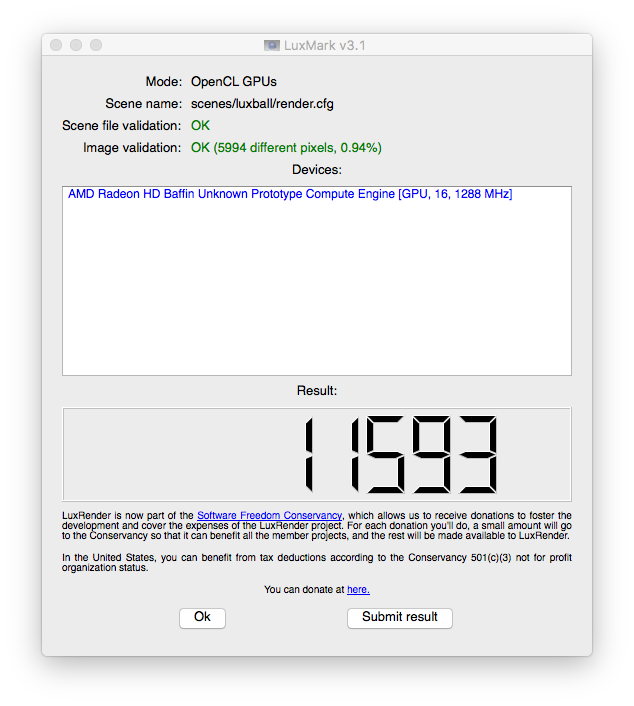

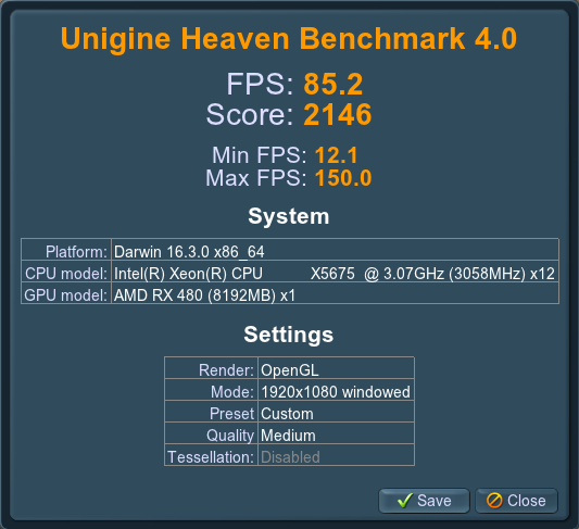

I've just installed an Rx 480 in my 5,1. All seems okay after the 4100 kext edit and the CU script from the r9 thread.
I've noticed during valley benchmark 'Extreme HD' setting, the motion stutters, like a okay for a second, pause, okay, pause...
it's fine on medium settings, all smooth. Is there a reason why it's stuttering rather than moving smoothly, but slowly?
This is my progress from an HD5870
