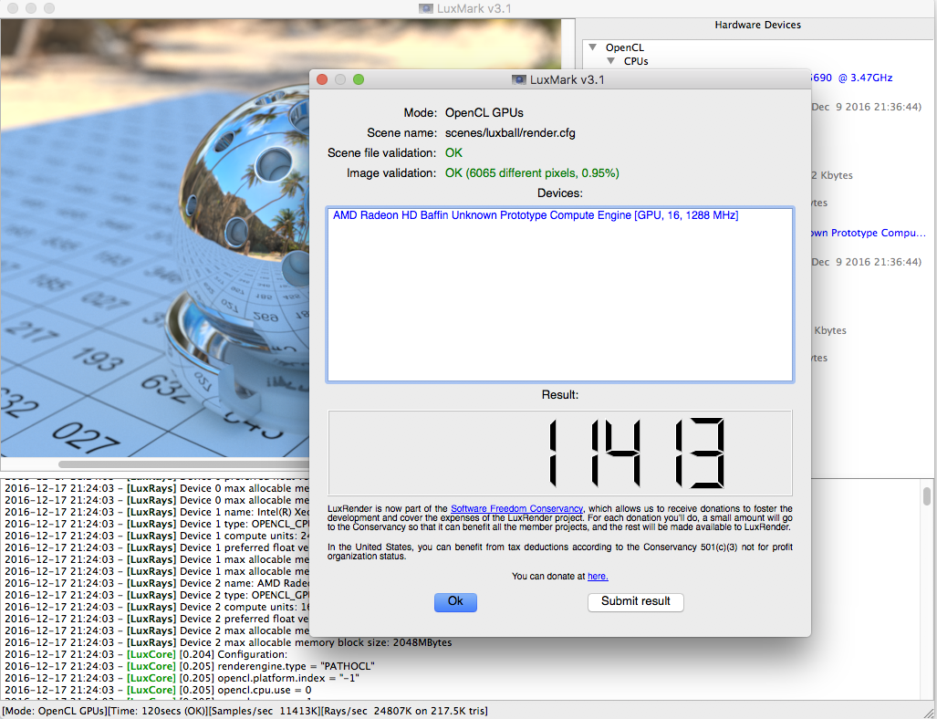

Here are my results after editing the AMDRadeonX4100.kext and the AMD9500Controller.kext as per the (tonymac) instructions. I do have 36 units active but my score seems a bit low. Maybe its because i'm running 2x Samsung 4k screens at 1440p. My card is a MSI rx480 gaming X 4gb.

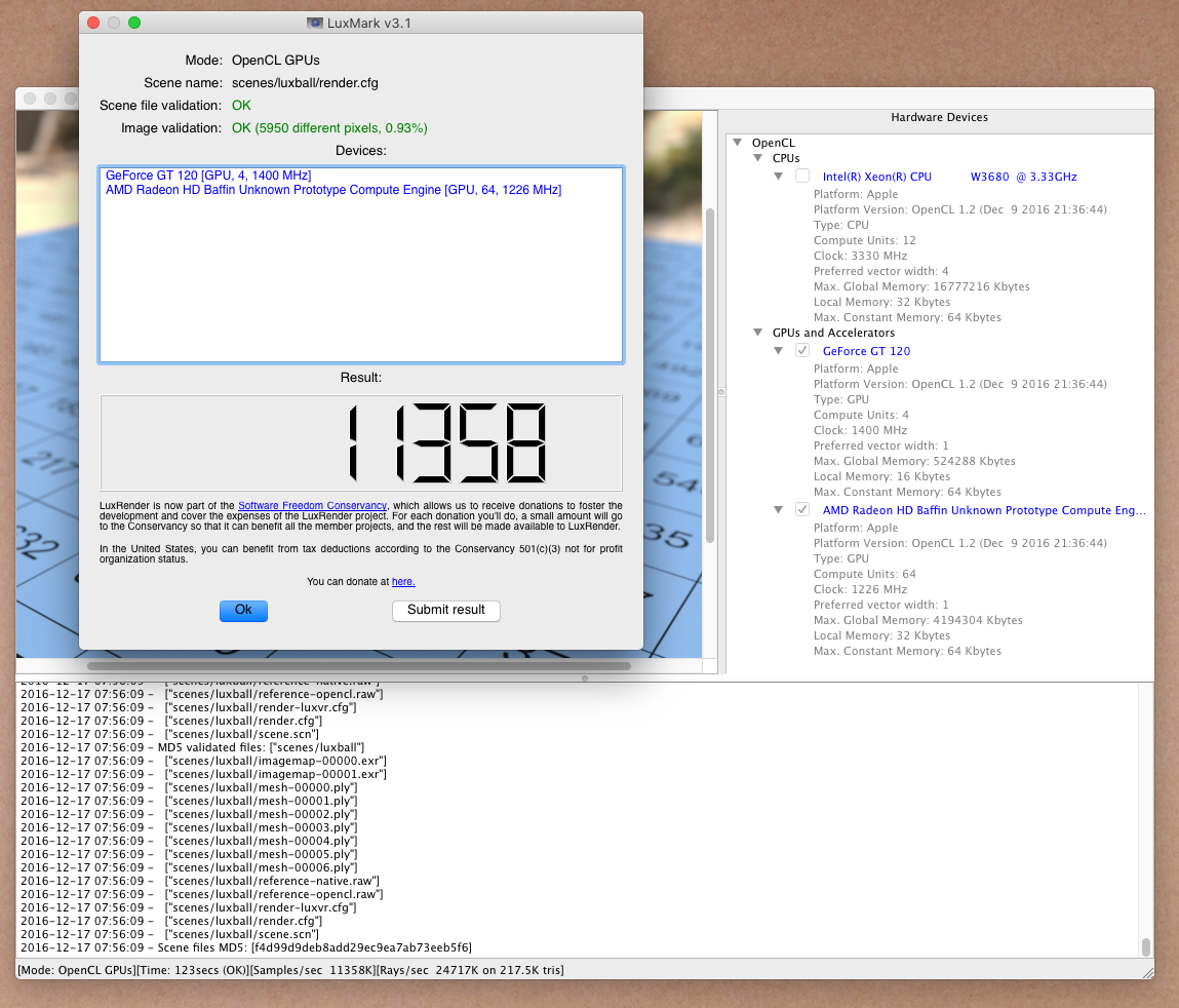

I have a xfx rx470 (RX-470P4LFB6). My luxmark score is 11358 after these three patch strings. I never did a before luxmark test.

I'm getting 64 cu's with the three patch strings. I don't know why.
Heaven benchmark (821) is the same. Secondlife feels the same.

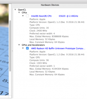

I just ran a LuxMark test with a single XFX RX 480 under MaxOS 10.12.2.
Is this an OK score?

Luxmark is reading 18 CUs. Scores are within 4 digits, not 5 as they should be. I wonder why people are getting different reported CUs with the RX 480...

The # of CU's reported in Luxmark doesn't seem to make a difference on the score. Shouldn't full 36 CU's from RX 480 put the score around 24,000?
Is this simply a cosmetic workaround?
If you compare to Windows result, obviously it cannot achieve 24000. However, it also doesn't shows a linear relationship as well (score vs CU count). Still very hard to understand what's happening behind the scenes.
The mod should increase the OpenCL performance by ~30%-50% (depending on benchmark) for RX 480 and even more than that for Fiji-based GPUs.
As for the question why the score doesn't improve linearly: I guess the answer is somewhere in the architecture of the GPU itself and/or power management.

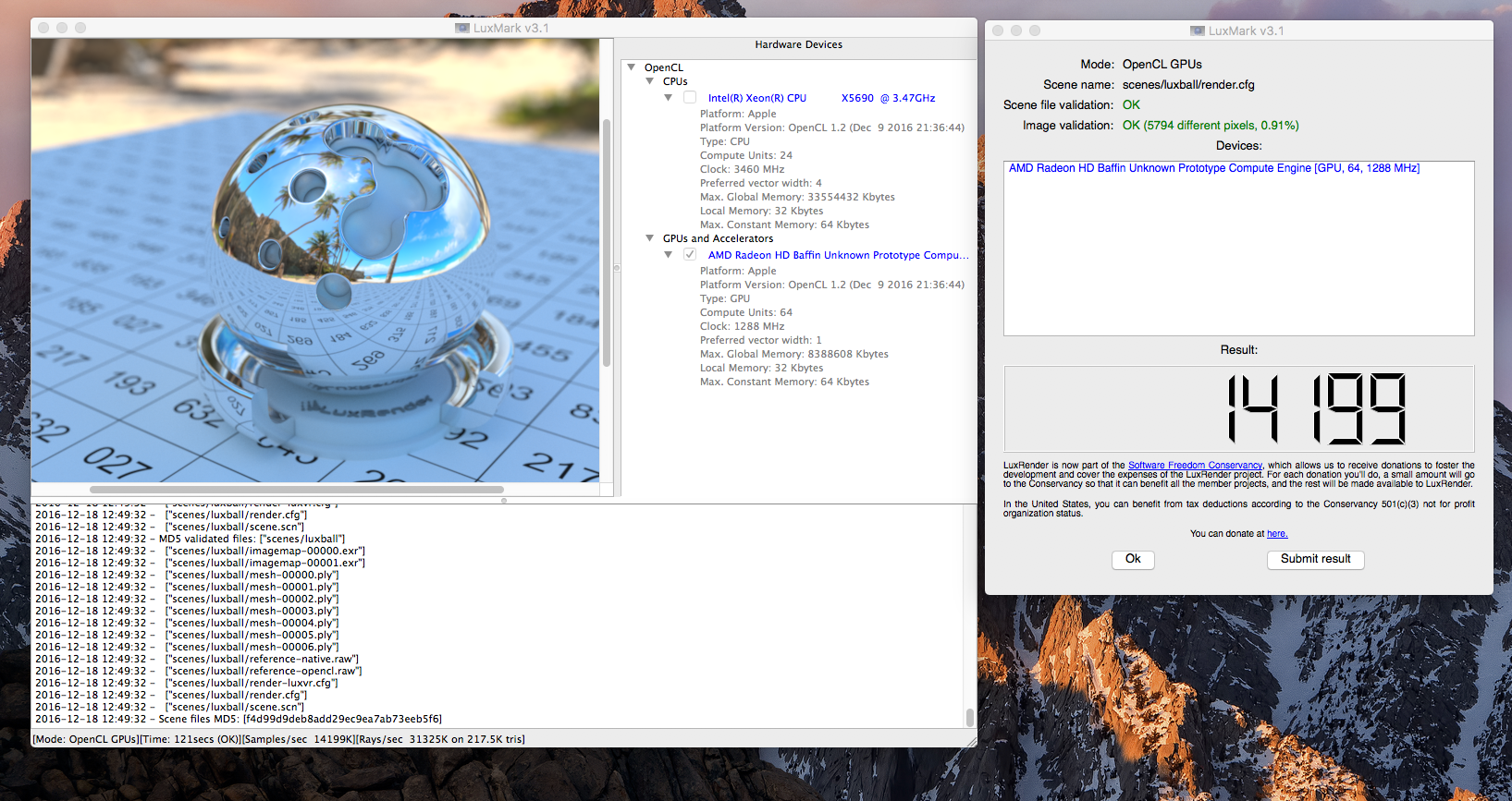

I just tried the HEX string edit by cdrhoek on Tonymac: https://www.tonymacx86.com/threads/enable-all-cores-r9-fury-cards.209892/#post-1393445 on a XFX RX480 8GB Reference Cooler.
I followed along with his initial post and edited the string he mentioned using iHex. When I rebooted acceleration was turned off so I ran the Kext Utility, rebooted and acceleration was back online. Overal I'm happy with the results, so far.
Before the Hex string edit I was getting a 11413 score in LuxMark. Now, my LuxMark score is 14199. That's nowhere near the 20k mark other users are reporting on Tonymac but it's a nice upgrade overall. Render times in Cinema 4D are also a lot quicker and LuxMark is also reporting 64 Compute unites. Don't know what that means as the card manufacturer states it has 36.
Anyone else getting results around the 20k mark?
EDIT: Running on macOS: 10.12.2

The hack you've used (and the results you're referring to) were ment for R9 Nano / Fury / Fury X users, not RX 480. Your score looks perfectly, although the amount of CUs is wrong.
Reactions: theitsage
LOL! I totally missed that. I assumed it would also work because it was about editing the 4100 kext. The same kext you edit to get the RX480 working. I'm surprised I even got 'better' results with the HEX edits. At this point, I'll try anything to get RX480 to it's maximum potential.
