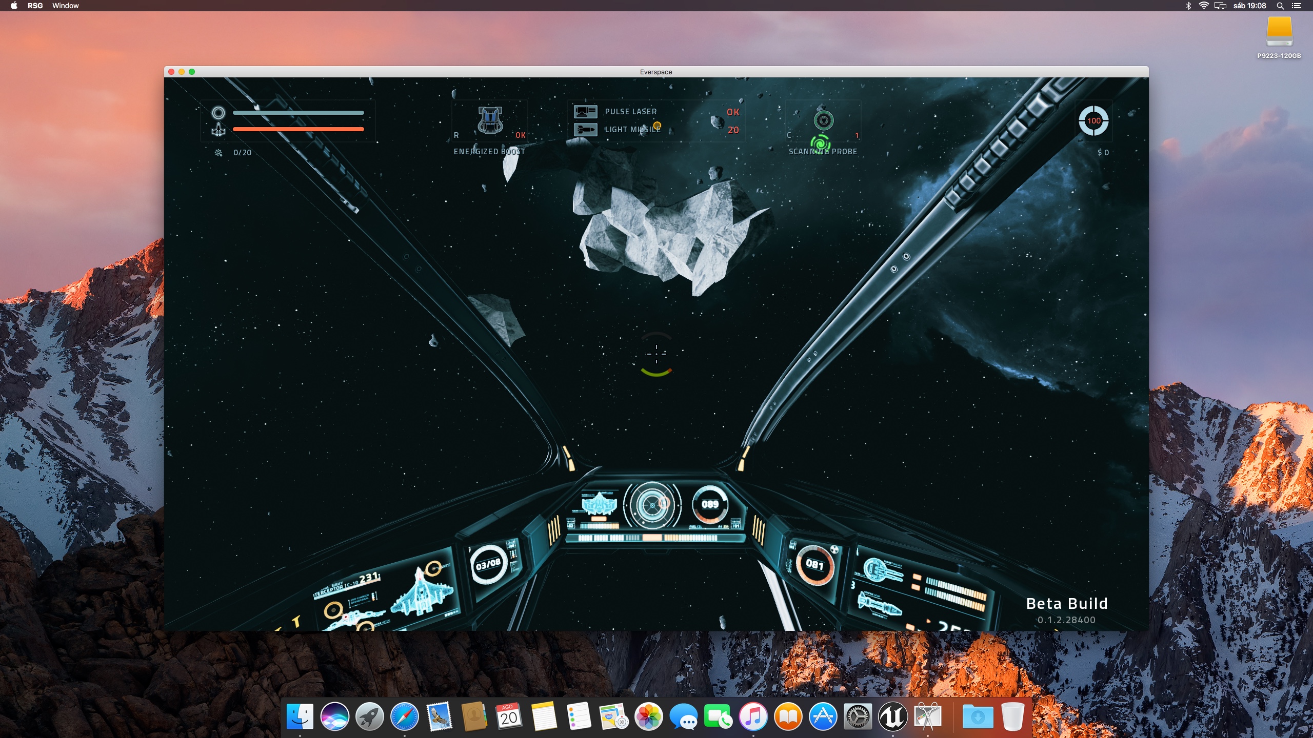

*macOS Sierra Beta + EVERSPACE Beta (metal) = Great fun!!!

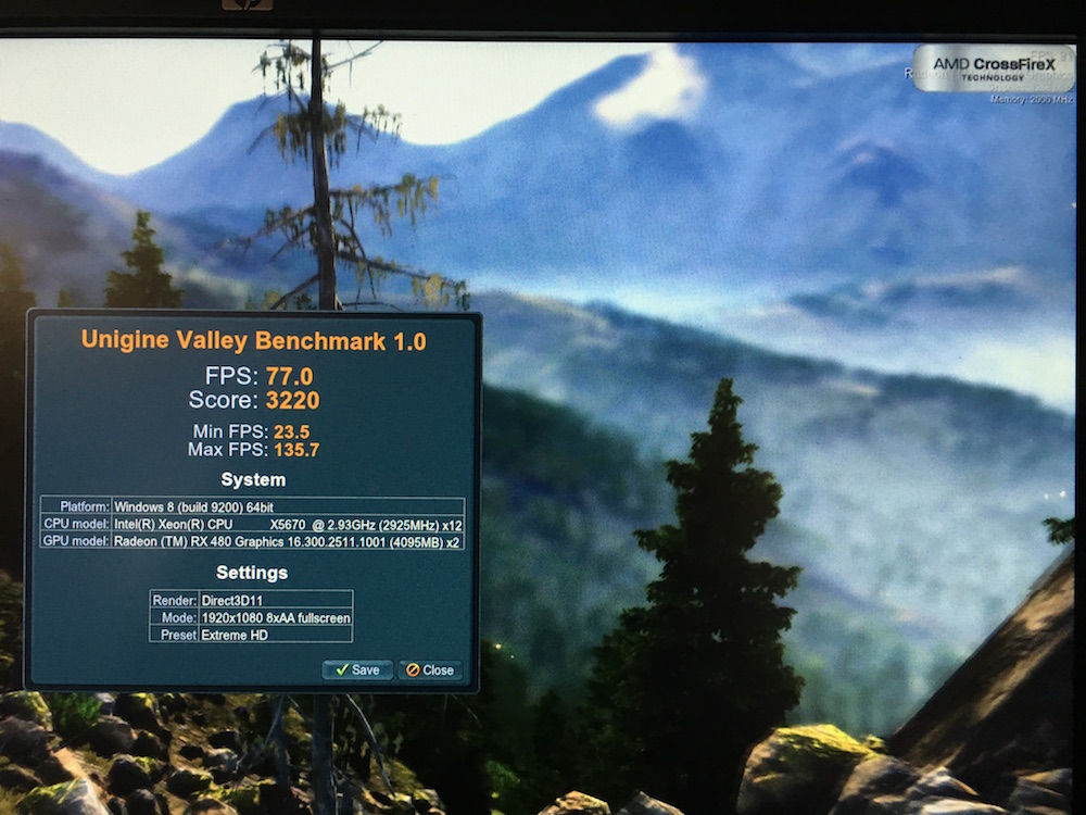

I was able to boot successfully into both MacOS and Windows 10 with the pair of RX 480 GPUs in slot 1 and 2 (for x16). Prior to this I could only use slot 3 or 4 for the second card. The culprit was an XFX RX 480 I had which is clocked slightly higher and has a different subsystem ID. I'm now using 2 identical Sapphire RX 480s.
As handheldgames mentioned, the drivers for RX series in MacOS is not fully functional yet. I did try an RX 460 in my 5,1 last weekend but that got no where. My Mac Pro could not boot with the RX 460. It's ironic because the RX 460 has its PCIe ID in AMDRadeon4000.kext.

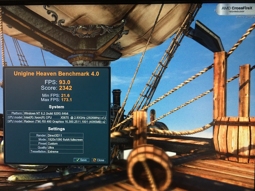

These RX 480s are working much better in Windows. With the latest Crimson 16.8.2 drivers in Widows 10 and CrossFire enabled, these are the results I'm getting. When I had older drivers prior to PCIe power overdraw hotfix, the system would crash running benchmarks.

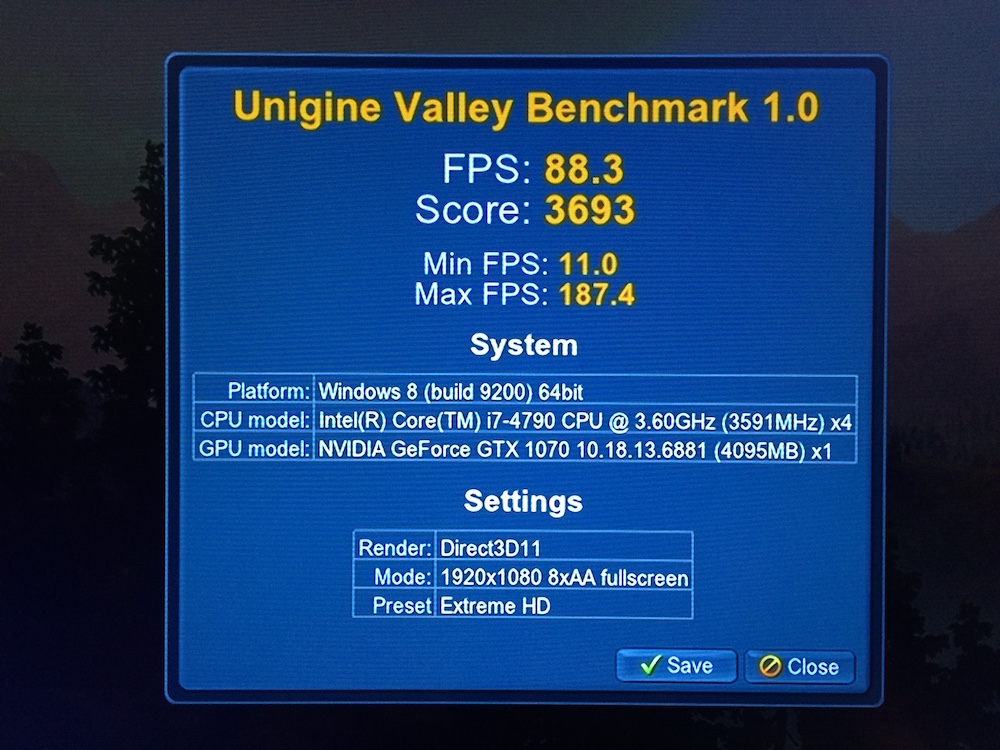

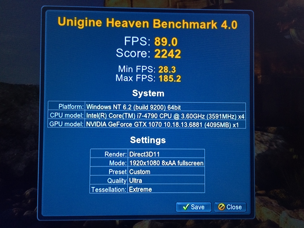

These are results for a GTX 1070 in my Asus G20AJ.
