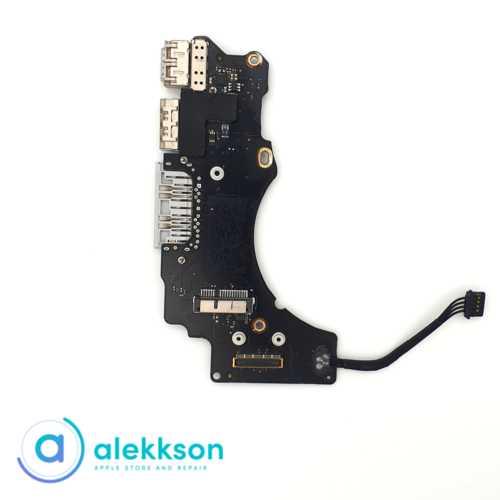

So if one wants to install Big Sure on a MBP 13 late 2013/mid 2014 (or to be sure any other model) I recommend to remove all SD cards.D
I had an external SSD drive attached via USB to the right IO board during updating. (Jetdrive could have been in there but not today :) ). So if anything is connected to th board during the update it will fry the board?
Macbook is back on running after unplugging the right IO board but i will try to reach apple support tomorrow morning again. i don't want to do the exchange myself even if that is not a big surgery.

P.S. My MBP with unplugged i/o board had Catalina re-installed and now Big Sur successfully installed. Still my i/o board seems to be fryed/ disfunctional so I will wait for the replacement board to arrive and I will exchange it to see if I am lucky on this path where it costs me a lot of time plus approx. 25 EUR for i/o board, thermal paste and appropriate tools to fix my personal damage.

I'm waiting for a set of small torx screw drivers to arrive today to disconnect my IO card. If I find I'm in the same boat as you and the IO card is fried is link below for the correct replacement part?

Got my replacement I/O Board. It's slightly different from the one it was shipped with the MacBook (maybe it's a 2013 edition, I have a mid 2014 MacBook Pro), but it fits and it works just fine. I'm still on Big Sur, I don't know yet if I will go back to Catalina, but I've disabled automatic upgrades just in case. It's seem that the board dies during installation, if Big Sur is already installed you should *but be careful* not have any problems. I've tried several reboot cycles, everything works. HDMI works, WiFi works (using my previous AirPort card), USB works. The process is quite easy if you follow iFixit.

You are now the fourth that I counted replacing the board did the trick.
Felipe Chelaut on the Apple Forum was not Lucky with replacing the I/o board.

@mknell can I just summarise what you've tried
- Disconnected IO card, that allowed the Big Sur install to complete
- Then downgraded to Catalina
- Installed Big Sur
- Reconnected the IO card and the laptop again failed to boot
That correct? Did you try the IO card when Catalina was installed?
Thanks
Hi
I/o card did not work on fully operational Catalina.
I am now fully upgraded to Big Sur
Waiting for the I/o card to arrive to replace it.

Sorry and yes that seems to be the correct replacement. I ordered the same in Germany via ebay, but I also locked at this one from the UK.
Thanks, that keeps me hoping.
I was quite confident because, as soon as I disconnected the I/O board, my MacBook finished the installation. So the main board was not affected in my case. Hope it lasts...

Same on my case, I put back another SSD with Catalina on it and no boot, even tried to power up without battery, press the power button for a 10 second while powered off, then try to power on only with the charger, and no results, the only positive results where with the i/o board disconnected, so i ssume that is fried

Just to keep people up to date with my woes
- I disconnected the IO board and that allowed the MBP to boot and the Big Sur update to complete
- I then powered down, reconnected the IO board and surprisingly the MBP booted again. SD card was working, bluetooth was working but WiFi was not, I could toggle it on and off but no networks were ever found
- I powered down again, disconnected the IO board and reconnected, powered on and black screen. No matter how many times I tried to reseat the IO card would it boot so everything points towards it being fried, no idea why it booted first time round
- Disconnected the IO card and again the MBP boots
I've a genius bar appointment Saturday afternoon, will see what they say about fixing and cost. Worst case will swap out the card myself.
