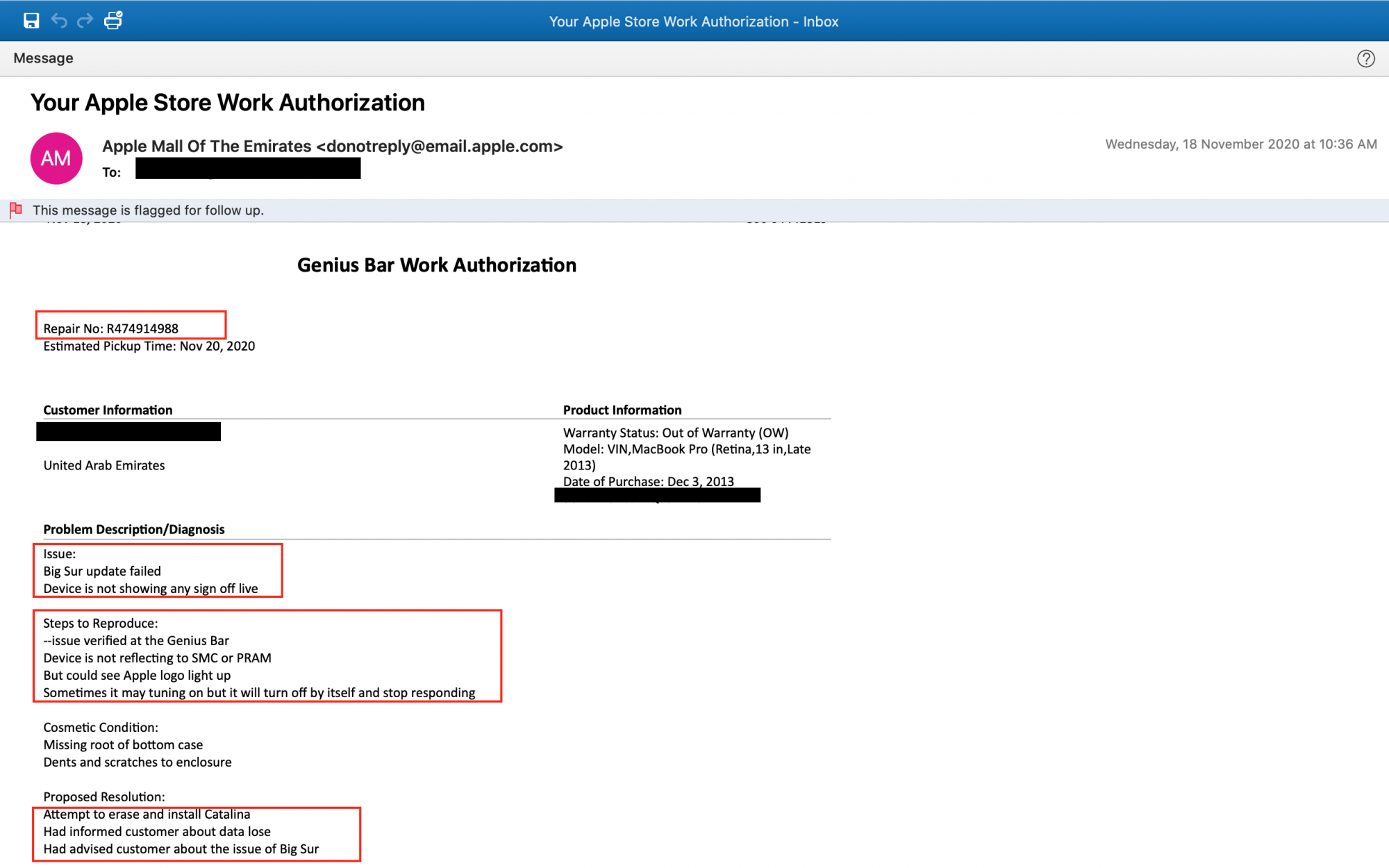

An update guys - Took my MBP to apple store. The lady at the genius bar immediately recognized the issue as I started to describe it and told me she has received 4 such cases in last 2 days. I left the machine with them, got a call the same day, telling me i/o board needs replacement and that will cost me $$$. I argued but in vain and asked to speak to supervisor. Got a call from supervisor the next day, and while he was sympathetic about what happened, he said he has no instructions from apple management to do a free repair. So I have given a go ahead to order the part and get it repaired and will eventually paying for it. However, I would keep the repair receipt just in case apple launches a quality program in few weeks/months so I can make a claim. Not happy at all - because apple clearly knows its their fault but refuses to accept it.
How much are they charging you for the I/O board repair? That's a good suggestion regarding the repair receipt.

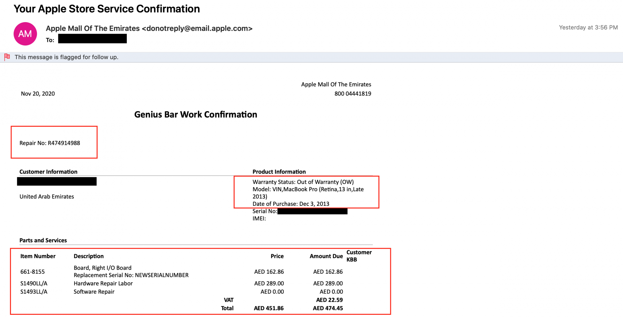

Update: Got my MacBook back from apple repair. I was charged AED 475/- and they put on Catalina on it. Below is the work authorization email as well as copy of the receipt I paid to apple for the damage done by apple.
You can clearly see in the work authorization notes that they were well aware of the big sur problem but still had a nerve to charge for the repair.
  • Angry
Reactions: SamSi and Bmju
What can you say. Its obvious that Apple have no respect at all for its customers. They are just items to extract $ from and treat poorly. So they put out a new update to stop the install from being possible but yet will not fix the damage done. I feel for you. This is the exact reason why i stopped doing any updates to my Apple MBP after it died with Catalina.
As the OS update has caused this, will Apple repair for free ?
unfortunately not in my case. Apple store in Dubai has charged me AED 475/- for replacing i/o board that big sir upgrade permanently damaged (see attached). Looks like Apple has learned nothing from battery gate...lawyers must be looking at this closely for a class action suit.
