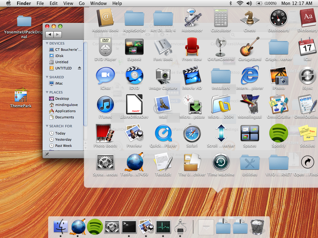

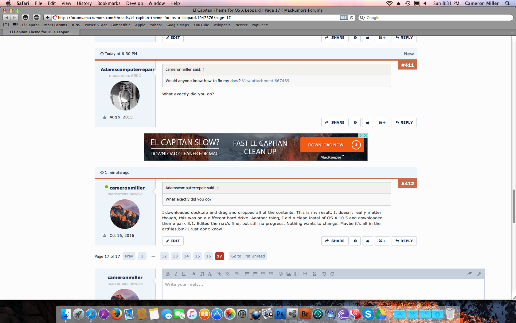

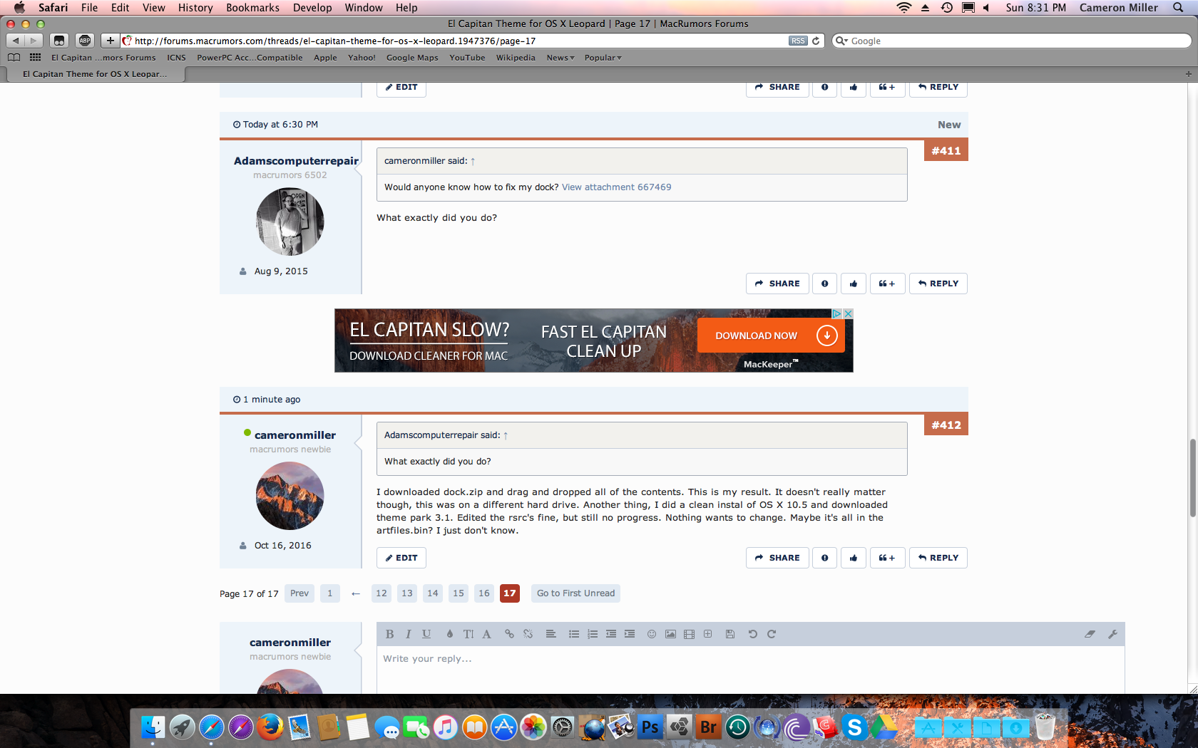

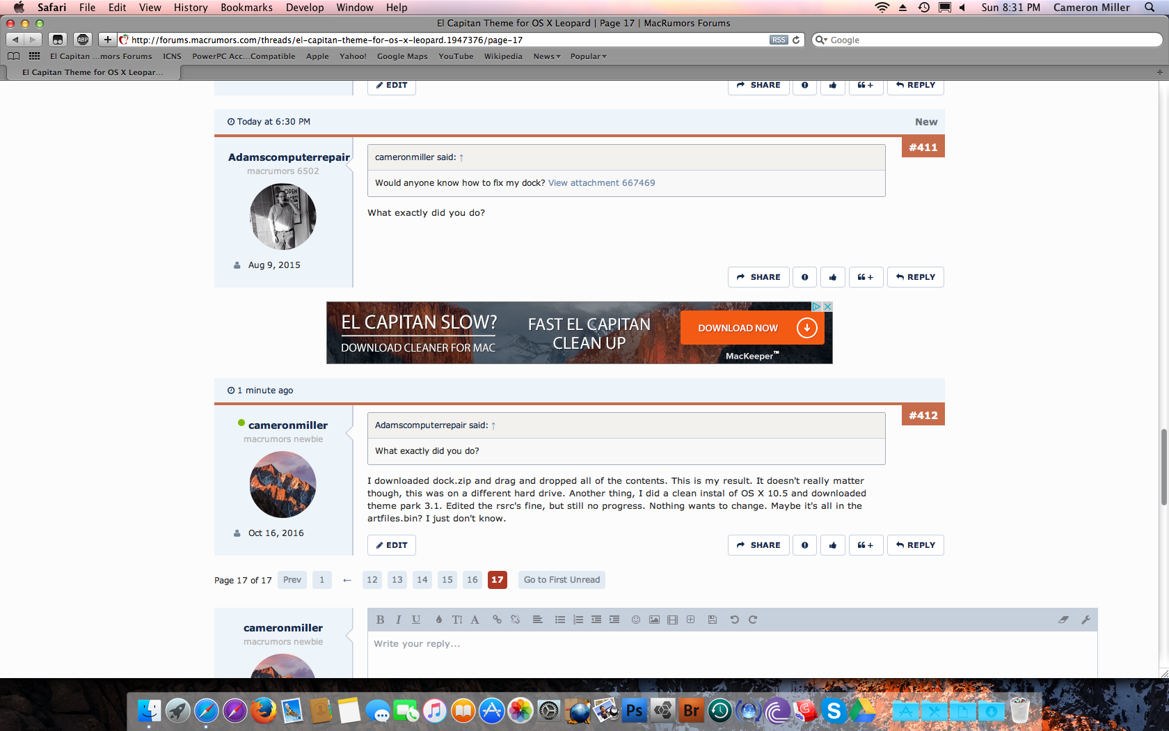

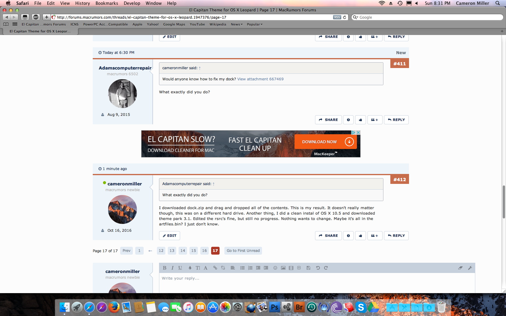

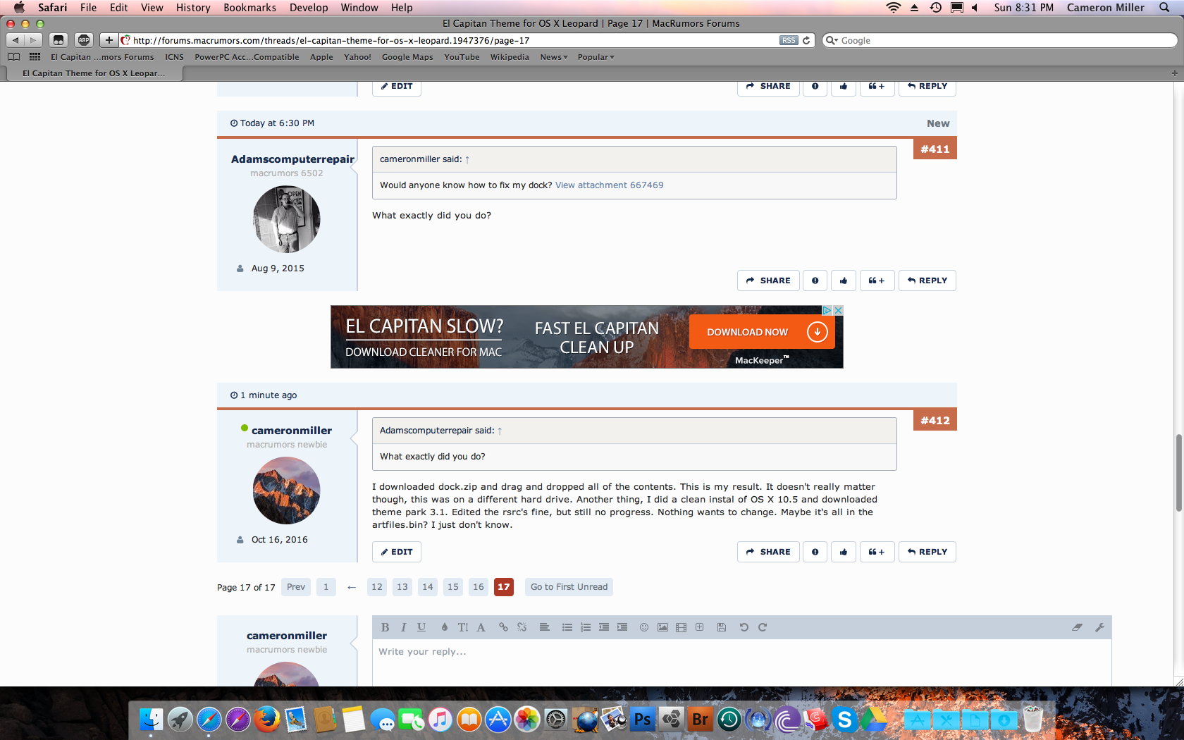

What exactly did you do?
I downloaded dock.zip and drag and dropped all of the contents. This is my result. It doesn't really matter though, this was on a different hard drive. Another thing, I did a clean instal of OS X 10.5 and downloaded theme park 3.1. Edited the rsrc's fine, but still no progress. Nothing wants to change. Maybe it's all in the artfiles.bin? I just don't know. This is my primary OS though. I used a command line from some website and it made all software that didn't come with the OS frosted, while making all software that did really dark grey, as in Safari.

You can try replacing the dock file with another from another mac running Leopard

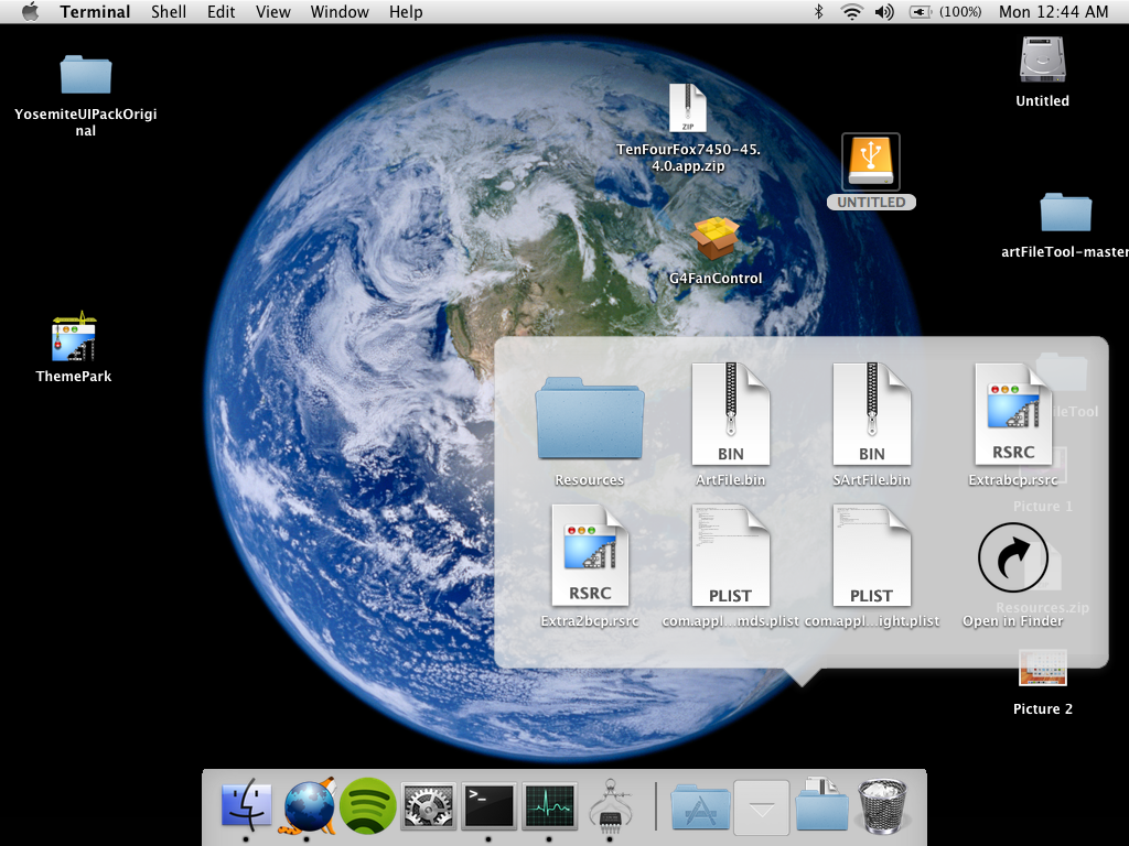

Yesterday after a bit of research i figured out that we need to replace Artfile.bin, not SARTFILE.BIN.
That was a problem because the tool provided in GitHUB wasn't compiled, so wouldn't be that simple. All the UI images are inside Artfile.bin, that explains what happend when i replaced the extras.rsrc files and disabled CoreUI via terminal, and yosemite the traffic lights appeared ( the command knocked out Artfile.bin and the system used extras rsrc file instead, just like Tiger used to).
So, Artfile.bin differs from Sartfile.bin and isn't used when coreui is disabled.
If we want something better we must Replace Artfile.bin, it must be decompressed with a different tool from the one used in Sartfile.bin and the tool was nowhere to be found Compiled. But after a long time searching it i found it.
[doublepost=1477758321][/doublepost]Its all a matter of patience now.
Download the tool here
With this tool we wont need to disable coreUI with that terminal command.
Backup Artfile.bin
Copy Artfile.bin to a new folder in desktop
rename it Artfile.original.bin
Copy artFileTool.jar to that folder
Open terminal
type cd and drag the folder, hit enter
type in
java -jar artFileTool.jar -decode ArtFile.original.bin artFiles
All the files will be decoded.
Now, open photoshop and edit file resizing each of the yosemite core pngs so that they fit in leopards.
After doing so, encode back the Bin.
java -jar artFileTool.jar -encode artFiles ArtFile.original.bin ArtFile.bin
Replace the file in system folder now.
Killall Finder

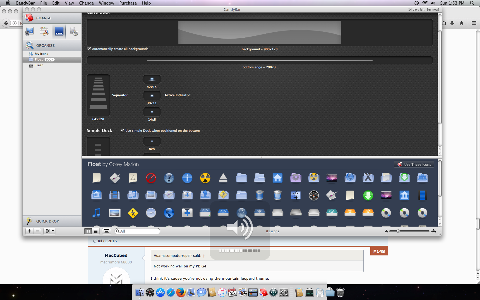

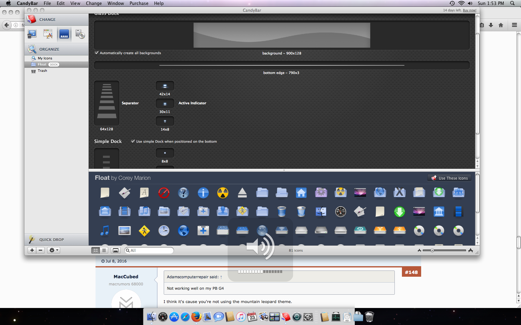

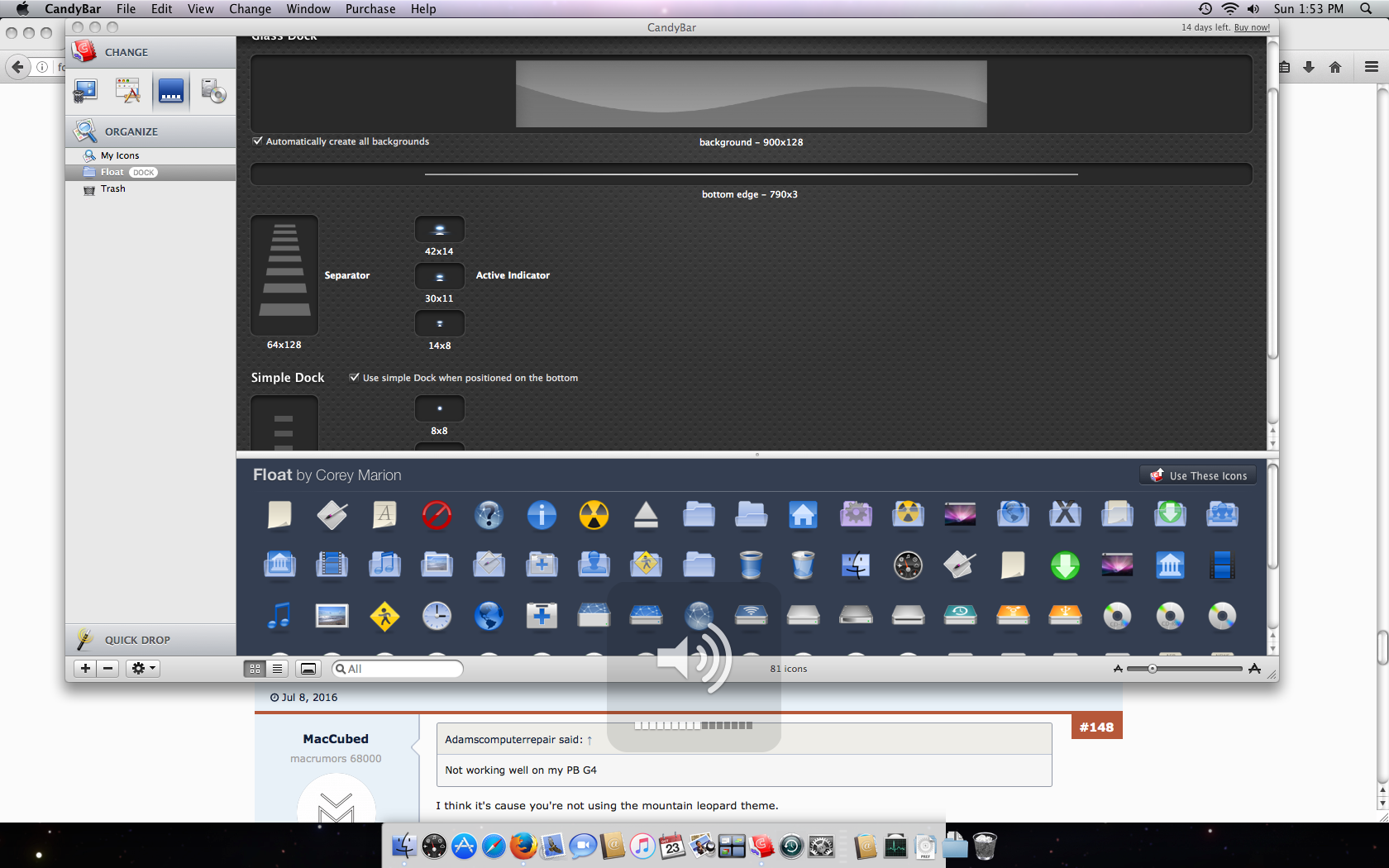

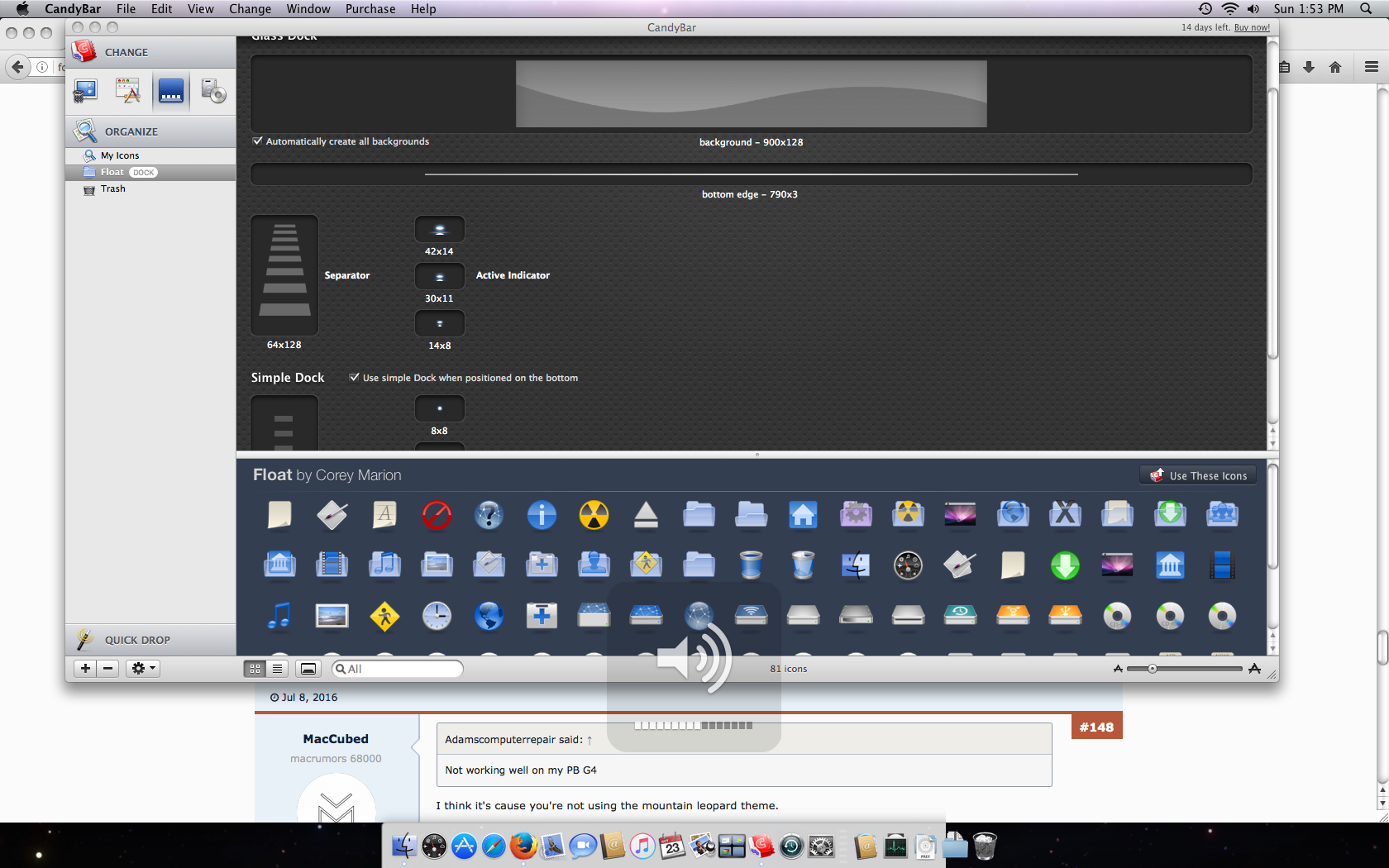

Not working well on my PB G4
Is my Resolution too low? Or is it a G4 thing?
These are very old posts, and I'm hesitating on replying. However, no one has answered this and I have discovered the problem. (By the way, the problem was that the new "About This Mac" screen was not showing labels correctly.) Anyway, it's not resolution, and it's not a G4 thing. The problem is that you have only one drive mounted. Normally, the About This Mac screen will not even show the "Startup Disk" section if you only have one disk. But if you have more than one disk mounted, it will show the "Startup Disk" label. So on Adam's PowerBook, he only had one drive mounted. So, due to the way the .nib was edited, he had this problem. The solution is to create a tiny partition from your main drive. Now you have 2 disks mounted, and the About This Mac window will display normally.
