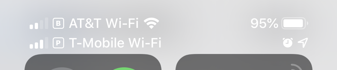

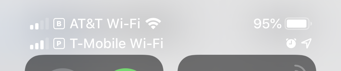

Yes. I have TMo One and I managed to move mine over to eSIM. Here's what I did:
- Yesterday I went to a local TMo store to get the EID thing done. Thought that by actually going and talking to a person I would circumvent the most certain refusal from phone/chat customer service. Dude at the store tried and it gave him an error. He was all condescending and "I told you it won't work" on me. Whatever...
- This morning I decided to try it myself so while I was connected to WiFi I went to Settings -> Cellular -> Add a Cellular Plan -> Enter Details Manually
- Here is where I entered that server address everyone knows about (cust-005-v4-prod-atl2.gdsb.net) and nothing else
- Hit Next and to my surprise I was prompted for a confirmation code. Well, I didn't have one, but I tried the last four digits of my phone number (carriers seem to like defaulting to last 4 of number when a PIN is required) and that worked. It activated my eSIM with no number
- I took out my TMo physical SIM and I tried to place a call. Any call. Because there was no plan on this eSIM, I was automatically routed to TMo's customer service where I asked the person to swap my SIM to the new ICCID that showed up in Settings -> General -> About under the eSIM portion
I don't know why the EID thing didn't work. Nor why just entering the server address did. All I know is that now I finally have the full iPhone XS functionality I paid Apple for. eSIM with TMo personal and SIM with AT&T business.
Hope this helps. Good luck.
Edit: Grammar & rephrasing. Still jet-lagged from a trip.
