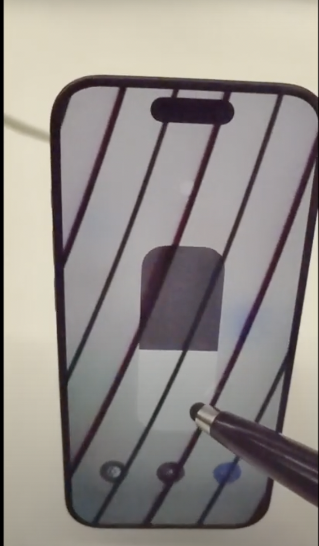

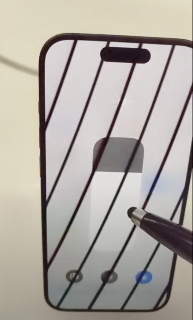

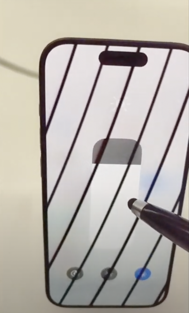

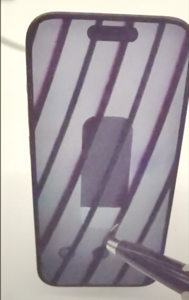

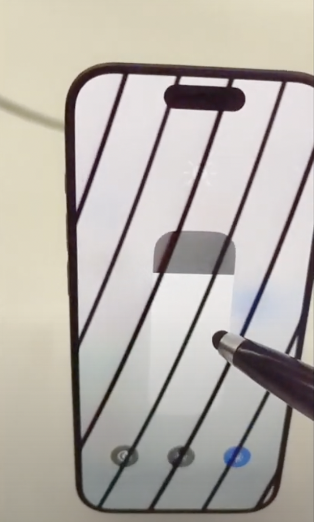

I don't pretend to be an expert but I don't think that 480 hz would be a fixed frequency. But rather that is the frequency used at max brightness and if you cut the brightness in half the frequency is halved. Thats what im seeing in Opple. Which would seem to make sense as pwm is used to regulate brightness.
Yes, that is absolutely the case with iphone 15 & 15 PM.
Apple locks the flickers frequency at 480 hertz when on higher brightness.
When there is no change in the thickness of the banding as one lowers the brightness, that is not PWM anymore.
It is called "hybrid dimming".

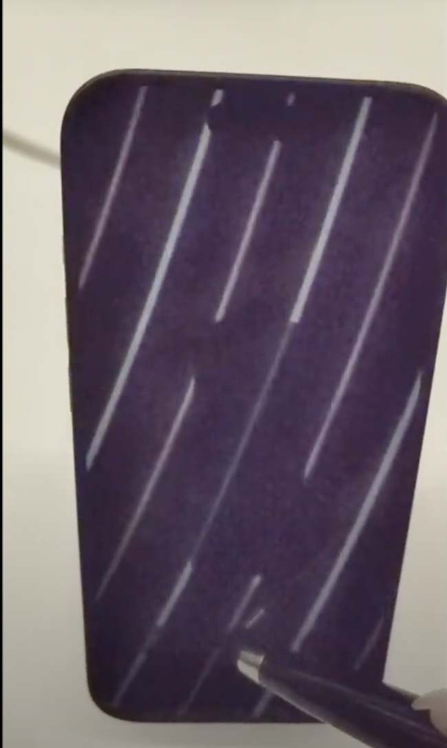

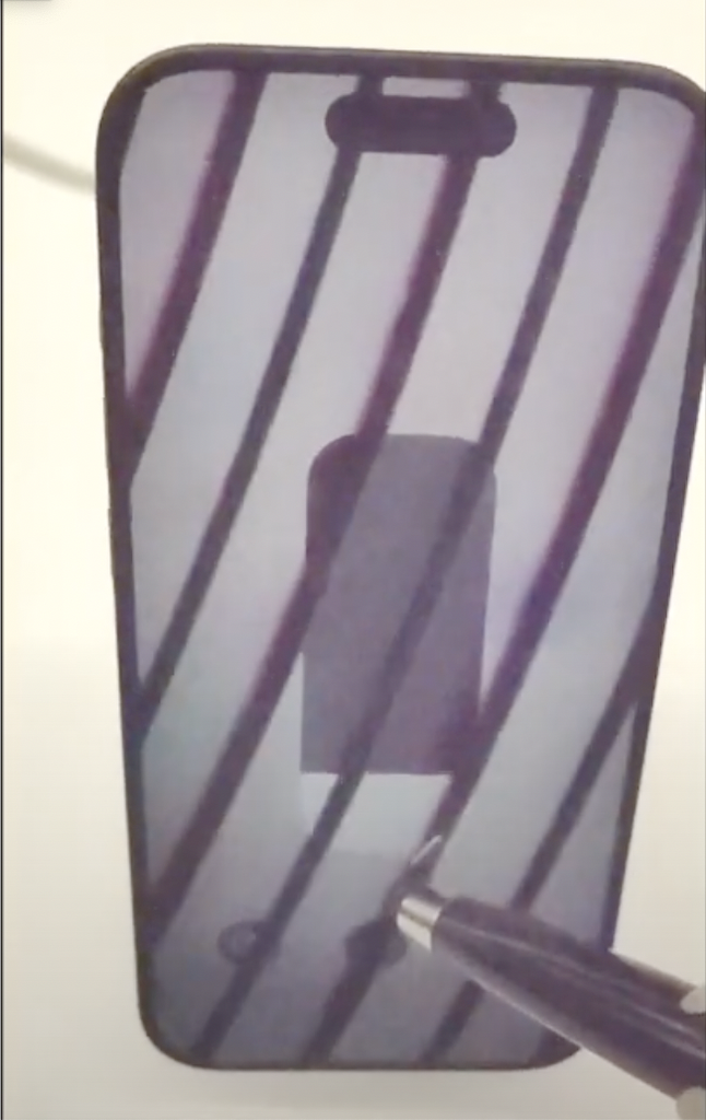

Here we see that at 75% brightness the banding size remained somewhat the same ~ as the banding size from 100% brightness. Hence PWM has yet to kick in.
Brightness 75%
When below 50% we start to see the banding artifact become wider. This is approximately the brightness where PWM of 240 hertz kicks in. Furthermore, we see 2 different alternating size banding here. We have a thicker one followed by a thinner one. This here is the overlapping (2x) 240 hertz of different timing intervals I was referring to.
Below data measurements supports the above
Brightness 50%
With brightness below 10% is where PWM is at its worst ; where you barely have any good screen on time.

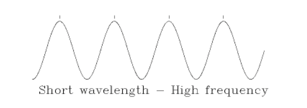

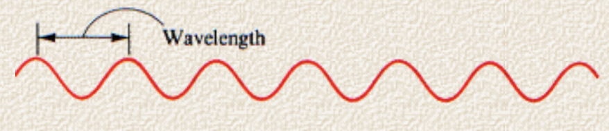

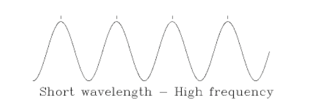

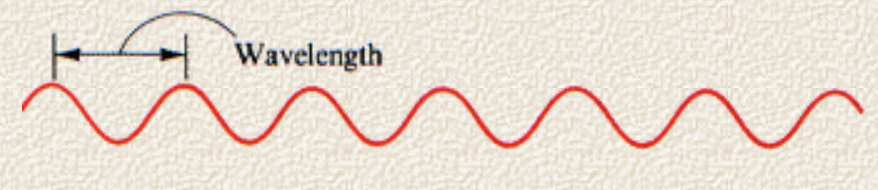

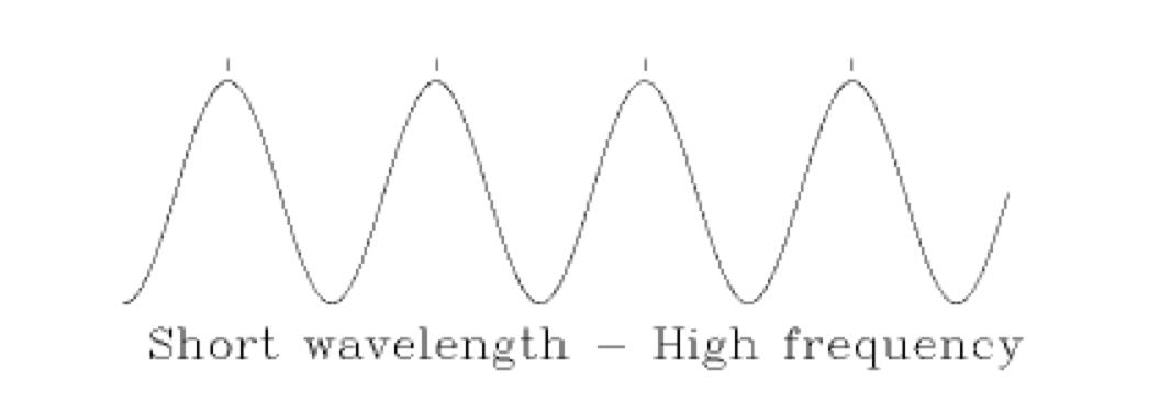

If time permits, I'll also elaborate on why Apple went with two very different implementation here.
The keyword is "longer wavelength vs shorter wavelength"
Longer wavelength (iphone 15 / 15 Plus)
Shorter wavelength(iphone 15 Pro / PM):

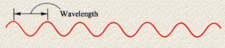

Ok I'll be delighted to know your experience with both.

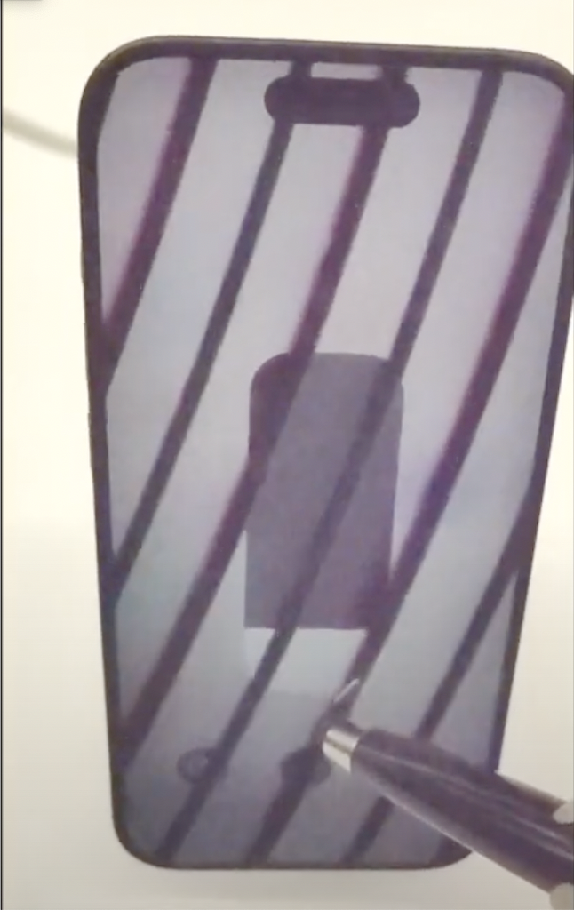

Sure. This brightness and below is where I think PWM is at its worst (while 10% and below would be highly dangerous for those that extra sensitive). I can't really tell what's the exact brightness based from here, but I imagine it looks about 20%-ish.
Reactions: MICHAELSD

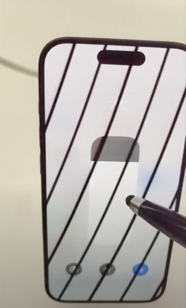

Sure. This brightness and below is where I think PWM is at its worse. I can't really tell what's the exact brightness based from here, but I imagine it looks about 20%-ish.
It’s hard to see the sun in that image. I raised it to 15%, just above the bottom dot on the sun, and it’s not unbearable. HDR content looks incredible. I’m growing more optimistic that there’s a lower PWM range where if it’s avoided it’s not nearly as bad as expected. 🤞
The flicker in slo-mo looks different than what I’ve seen before on an iPhone, but flicker is flicker. Then again who knew flicker could be so complex.

More takeaways to share tomorrow. Glad I bought this for testing. Cautiously optimistic.
Regarding that iPad Pro. I know it has no PWM, but I have read that there is still something called "ripples" in the display frequency, some sort of modulation- that some without technically having PWM still have ripples (I have heard the iPhone SE3 has that, for example- which can still bother some people).
Does anyone here who knows more about this stuff than I know if the iPad Pro has ripples, or if it is truly PWM-Free (as opposed to PWM-safe)?
That would probably must have been brought up by me in the pwm sensitive sub.
Though by pwm free, do you mean pwm free as defined by notebookcheck?
As engineers, when they meant pwm free, they meant it is free of the modulation technique used. They focused on the (M) noun within PWM.
For me as the end user, I focus on the (P) in PWM and only care whether if there are pulsing flickering.
Thus when I propose the concept of PWM-free in my post, I meant free of pulses. Not free of PWM modulation technique.
Back to the question; Ripples are not pulses but are subtle very rapid inconsistent trembles in the brightness.
No one is able to know unless someone test it with Opple and look at the graph.
