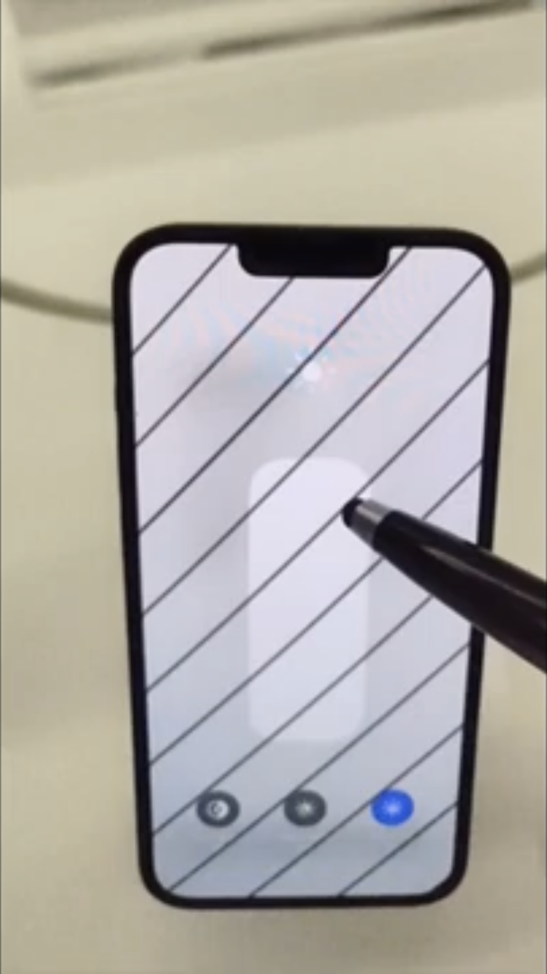

I couldn't use the iPhone 13/14Pro/Max for 5 minutes without any complaints.
I can use the iPhone 15 Pro Max normally without any complaints.
Something must have improved for me. I am not the only one.

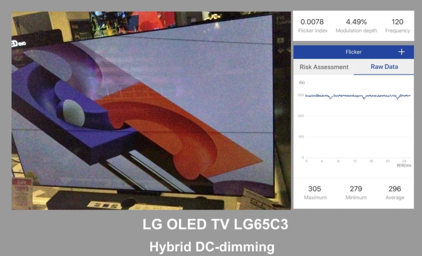

So what is the rationale for Apple, Samsung, et. al. not doing more? Is it the color distortion associated with dimming? Motorola warns of screen noise and color distortion by turning on 'flicker prevention.' I have not noticed any of that. Is it technically difficult?
Excellent question.
This question throws back to the first few iterations of OLED panels with true dc dimming.
Why did the first few galaxy S series use True Dimming dc? Why didn't they just continue using true dc dimming instead of PWM?
The answer always fall down to 1 thing. This.
images
Screen burn in.
OLED panels cannot stay 100% ON. They must shut down and rest for at least 25% time duration. If manufacturers forcefully make OLED stay 100% of the time, they'll end like deep fried in no time.
Even LG's OLED TV flicker free is no stranger to this problem. They too have to make their individual LEDs rest once every 120 hertz.
see the 2 grey bandings there in the LG OLED TV? Along with the brightness dip on the graph. That's the OLED "resting time"
This then brings to the question. Why LCDs do not have to "rest" to prevent burn in, while OLED have to?
The answer is because of the way they are designed.
For LCDs, the backlight and the screen panel are separate components.
OLED panels however do not have a separate backlight. Each individual led is each own light. Hence, having the LEDs stay ON 100% of the time fries them in no time.
Over 13 years have passed and we are still stuck with this fundamental technical limitation.
On the bright side, some chinese companies have found workaround for this problem.
Instead of what Apple is currently doing their iphone pro model
ON, ON, ON, ON, OFF, ON, ON, ON, ON, OFF, ON, ON, ON, ON, OFF, ON, ON....
What companies like Oppo are experimenting is a workaround to this "rest" issue, as followed:
ON,ON, ᵒᶠᶠ,ON,ON, ᵒᶠᶠ,ON,ON, ᵒᶠᶠ,ON,ON, ᵒᶠᶠ,ON,ON, ᵒᶠᶠ,ON,ON, ᵒᶠᶠ,ON,ON, ᵒᶠᶠ
ON,ON, ᵒᶠᶠ,ON,ON, ᵒᶠᶠ,ON,ON, ᵒᶠᶠ,ON,ON, ᵒᶠᶠ,ON,ON, ᵒᶠᶠ,ON,ON, ᵒᶠᶠ,ON,ON, ᵒᶠᶠ....
As we can see, the "off" is now more subtle and has way more "on" compared to "off".

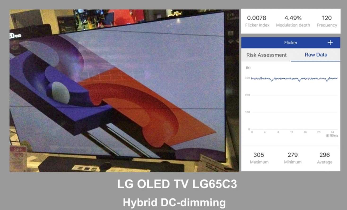

Excellent question.
images
Screen burn in.
