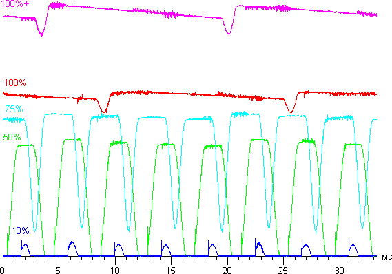

[doublepost=1521232554][/doublepost]If it’s any consolation, the PWM on the Galaxy Note 8 is worse at lower brightnesses as the display flickers on and off at up to 50% brightness while the iPhone stops flickering completely off at 25%.
Although, it doesn’t seem to be too bad at 100% brightness on the Note 8. Curious to see the PWM on the Galaxy S9.

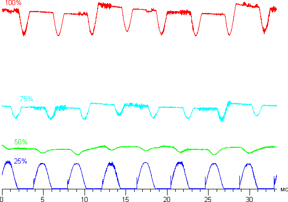

Again, here’s the iPhone X chart for comparison:
It’s a shame all the sites that measure PWM are from different countries so there’s a language barrier, otherwise I’d ask for advice.

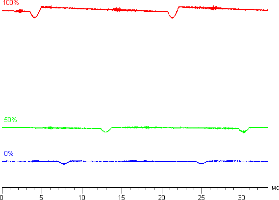

[doublepost=1521233905][/doublepost]For reference, this is what a flickerfree curve would look like on an OLED display. (The refresh intervals are necessary.) The Note 8’s PWM curve at 100% more closely resembles this.
[doublepost=1521234612][/doublepost]Actually, Samsung did a good job with the PWM on the Note 8... which was released before iPhone X. To Apple’s credit, this was their first OLED display. I’m curious to see if they further improved it on the S9.
https://www.notebookcheck.net/Samsung-Galaxy-Note-8-Smartphone-Review.249118.0.html
